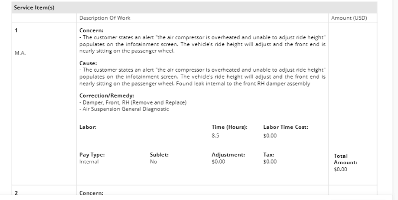

So update this afternoon.
Rivian service says there was a leak in the PF damper, they replaced it and the suspension is working now.
Hopefully I can get my truck back by the end of the week which would be awesome. They are also fixing a puncture in a rear tire unrelated to the suspension issue and adjusting my tailgate.
Despite the issue, the trip looked fantastic! Did Rivian mention what the leak was from? Normal wear and tear or just a loose fitting? Just curious...
From the description on my work order it sounds like the leak was in the damper assembly itself. That was what I understood from my phone conversation as well.
Rivian R1T R1S Broken Suspension on R1T 😫 during PNW Rivian group trip: WA BDR. 1662736899502
And thanks, definitely a cool trip meeting up with other Rivian owners, sadly I think the best parts of the planned route were in the next section of the trail that is now unfinished business.
