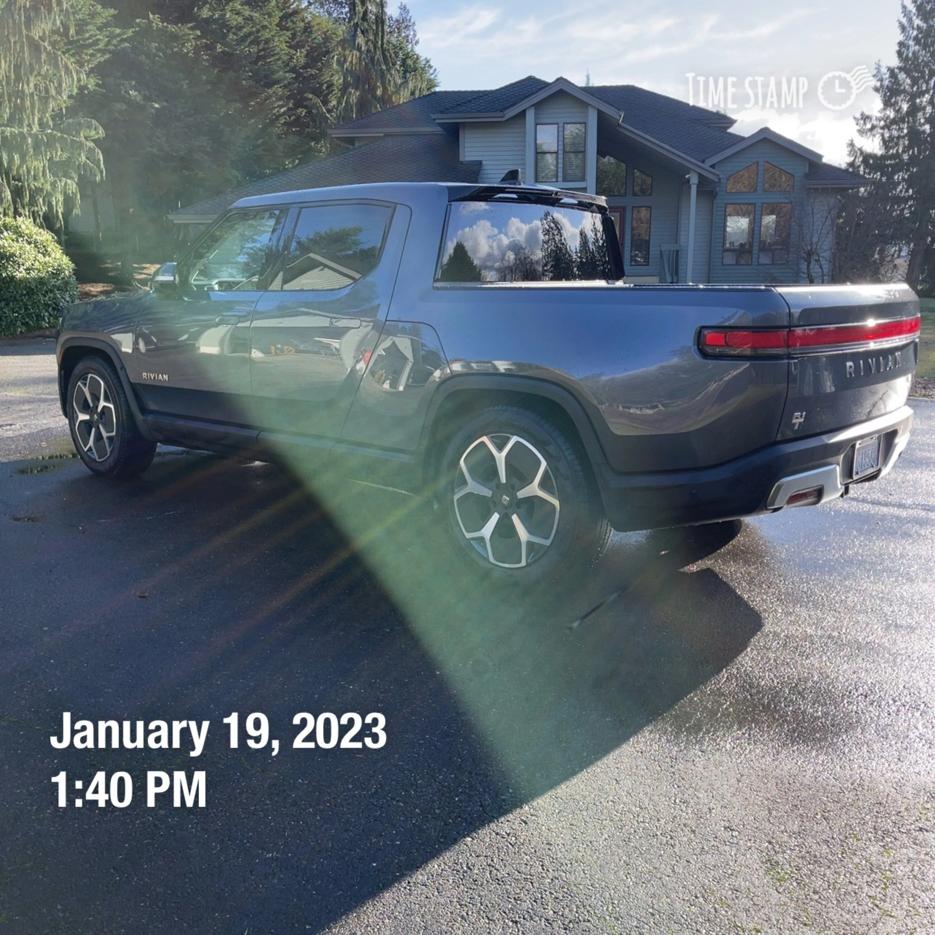

I'm preparing to tow my boat for the first time with my R1T. I'm somewhat nervous regarding the truck holding the boat and trailer on a steep angle while I prepare for launch. All we have is that little "P" button. No emergency brake. Anyone have expirence with this? I'm sure Rivian has thought of this and its probably fine, just thought I would ask the question.
thanks, Dennis
