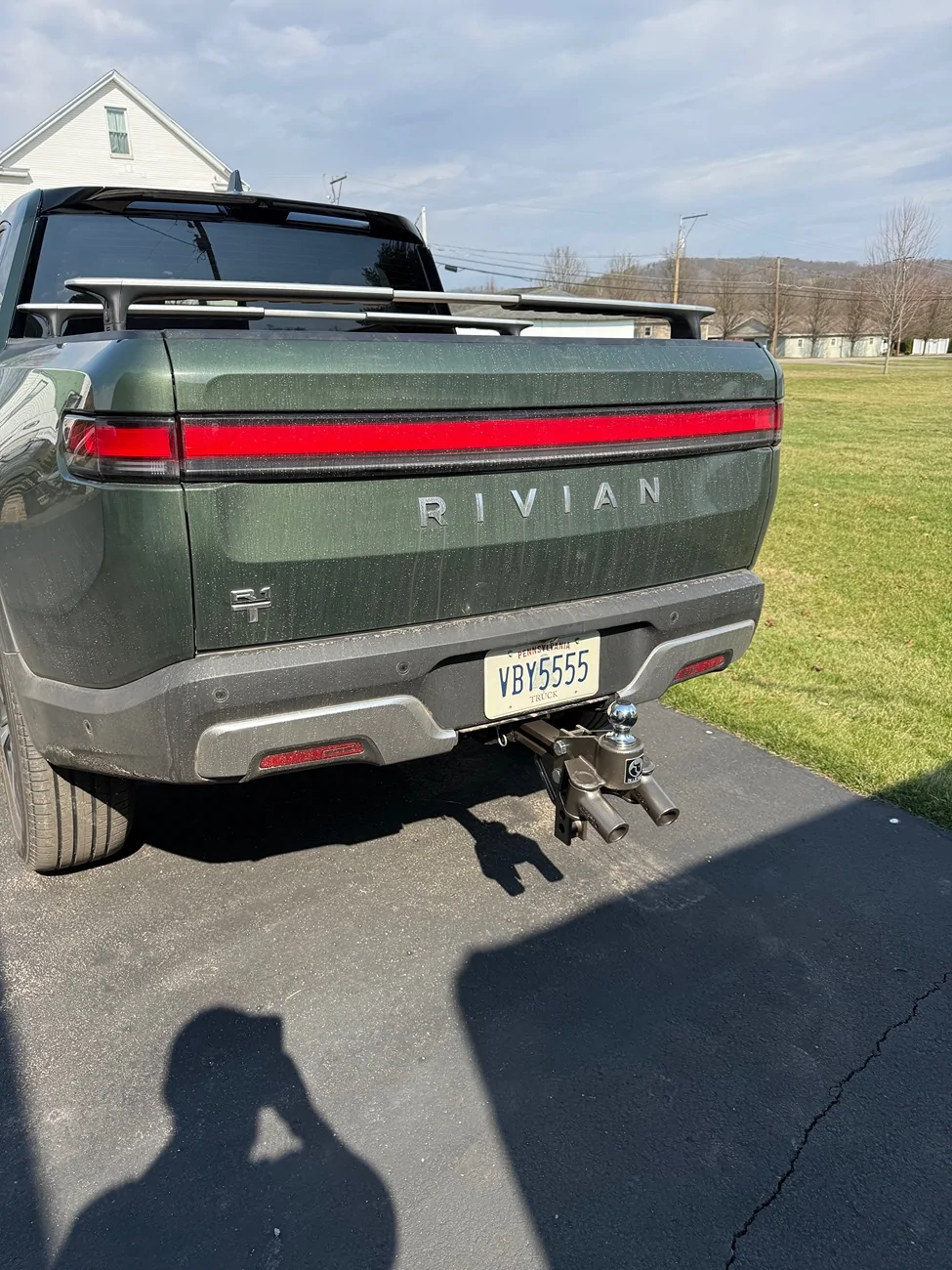

I’ve got mine set up but have not pulled the trailer yet. First trip is next weekend.
Mine sets at this height.
Just used our Blue Ox for the first time on my Gen 2 R1S with Airstream 22’ in tow. Worked great, although I think I might have set it for too much tension at normal truck height. Also had to use their biggest drop setting to get it low enough for the trailer, which has already had a 6” lift kit installed.
