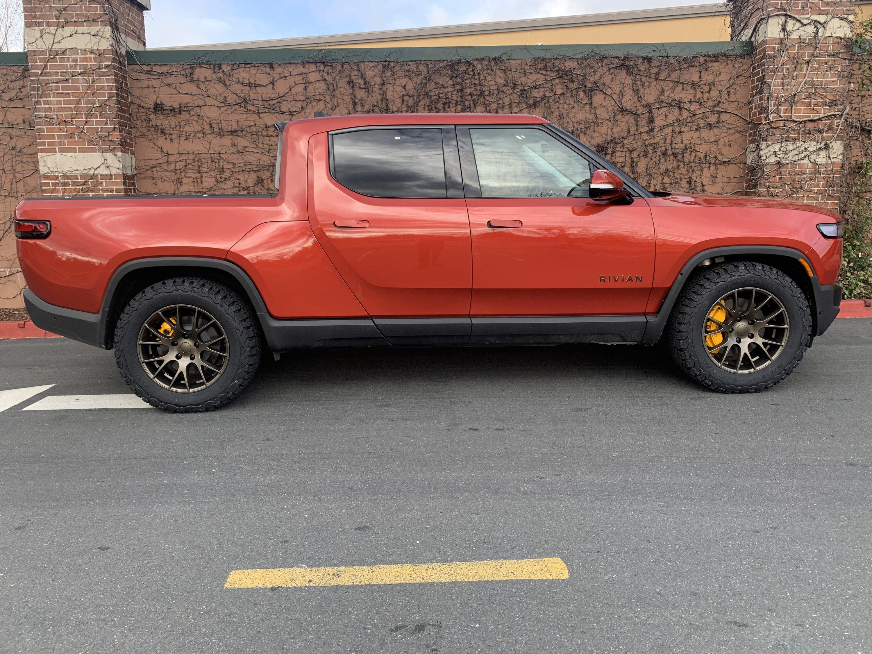

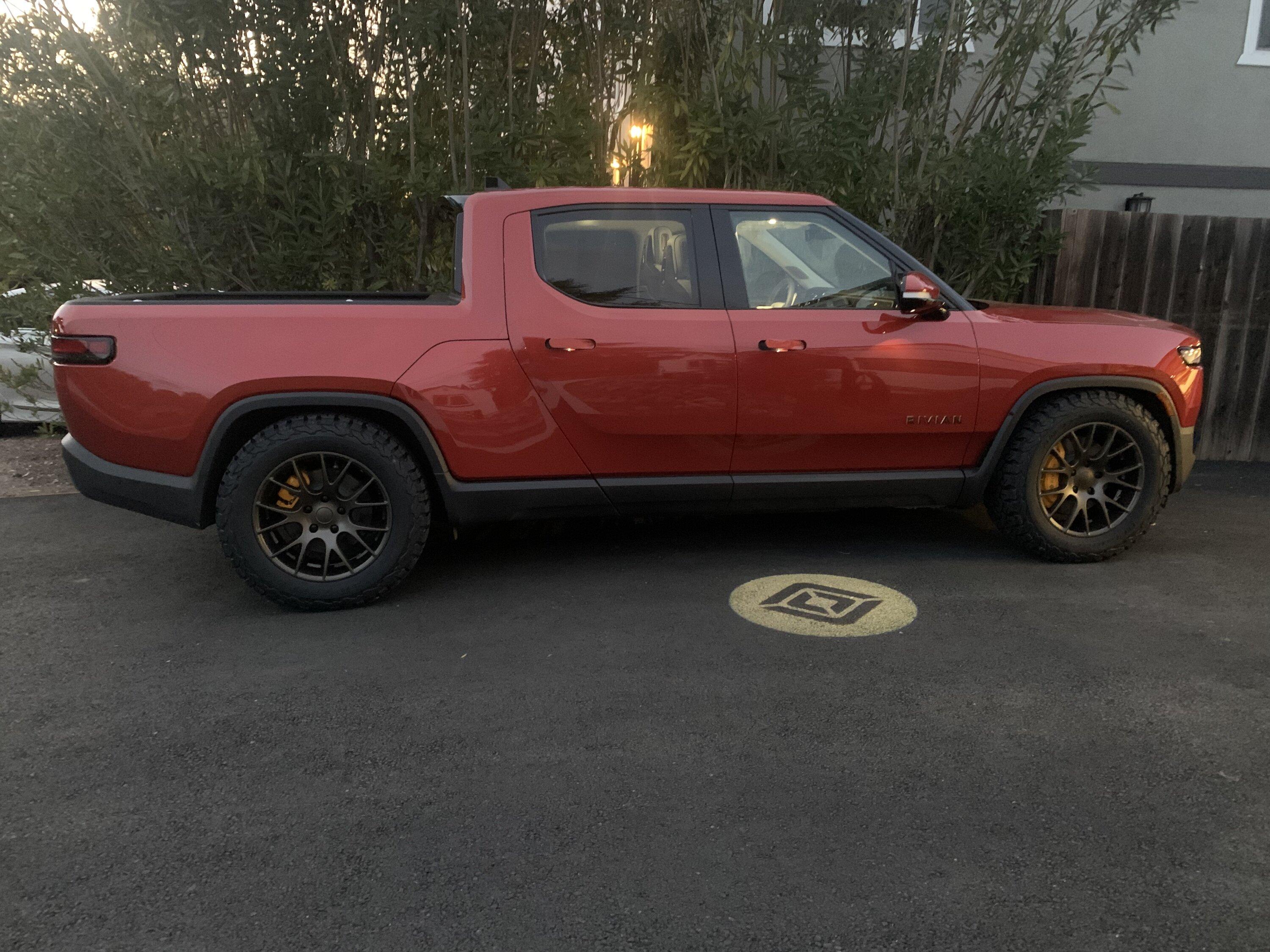

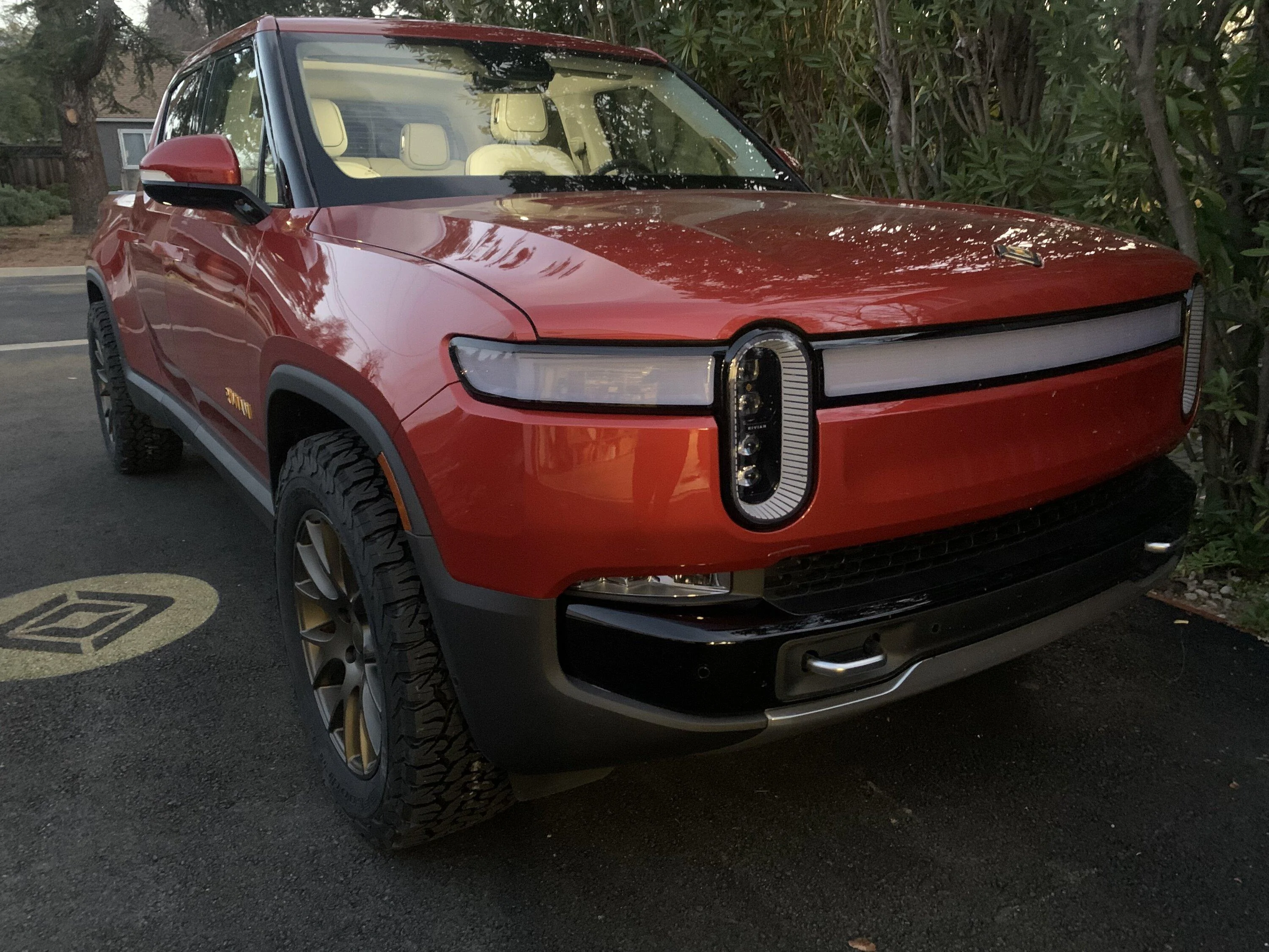

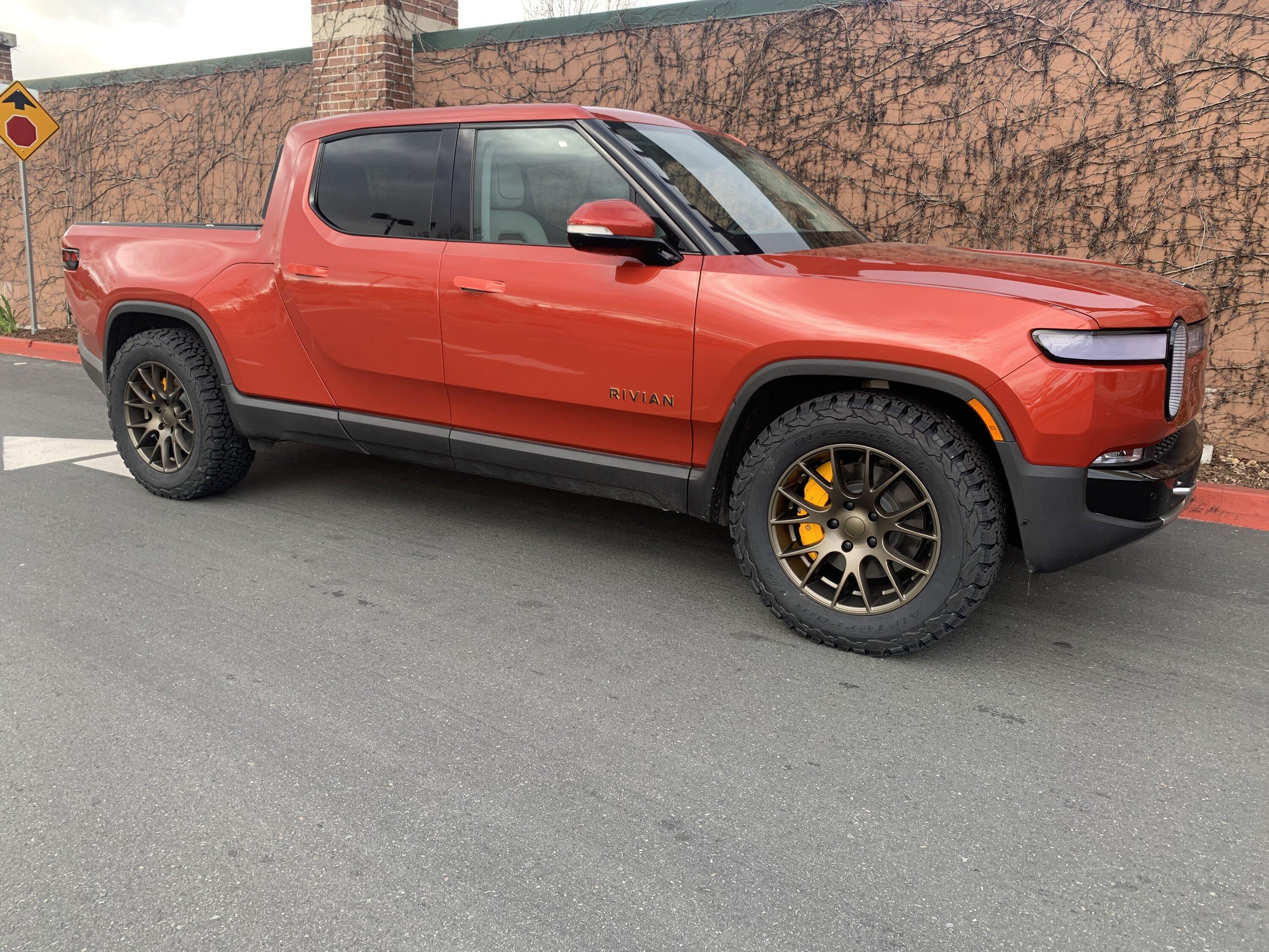

My truck came with 22’s, and I wanted another set of wheels/tires that would work in snow and off road.
I chose these 20” wheels because of their +25mm offset, decent looks and attractive price.
I wanted the biggest, widest tires that would not rub too much. I almost got 295/60/20’s because they have the same diameter as the stock AT 275/65/20’s, but I wasn’t sure how much they might rub with the wheel poking out almost an inch more than stock. So I decided to try 285/60/20’s, which are about 1/2” taller than my 22’s, about 1/2” shorter than the OEM 20” Pirelli AT’s, and slightly wider.
After considering Coopers, Falkens & others, I ended up getting the BF Goodrich All Terrain KO2’s. I’m sure all of these are good tires, with slight tradeoffs between on & off road performance.
I bought TPMS sensors from Tire Rack for $60 each. Tire Rack says these are the OEM Rivian sensors & won’t require any programming. I’ve only driven them for 10-15 miles and the sensors aren’t working yet. We’ll see.
Total cost was just over $3,000.

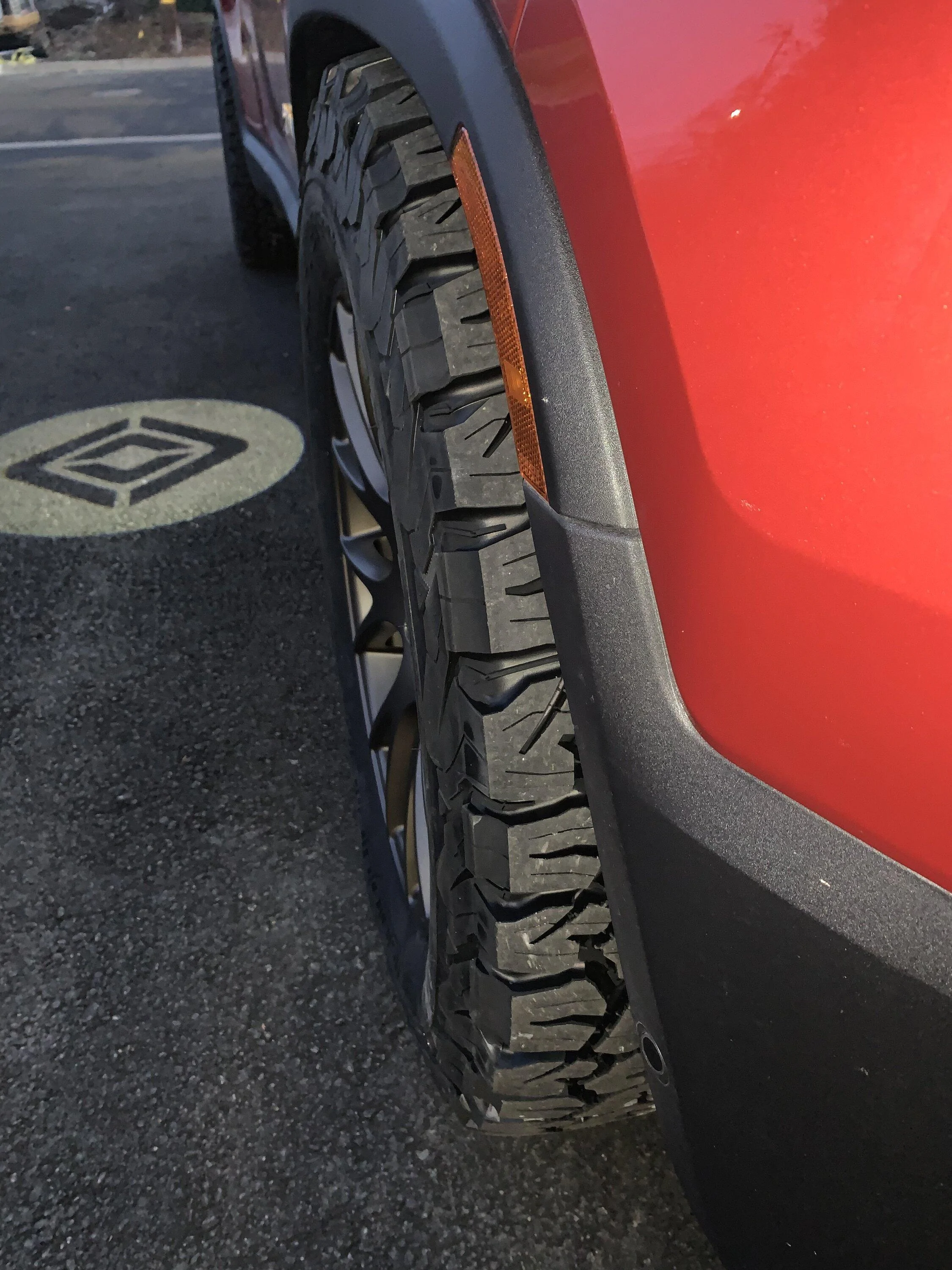

I’ve only taken it for one drive so far. I set the suspension on sport/lowest/soft at first, got on the freeway and tried to hit bumps. I found some big bumps, and the tires did rub. It sounded like it might’ve only rubbed on the left front. When I raised it to normal/medium height, it didn’t rub. But this is a very small sample.

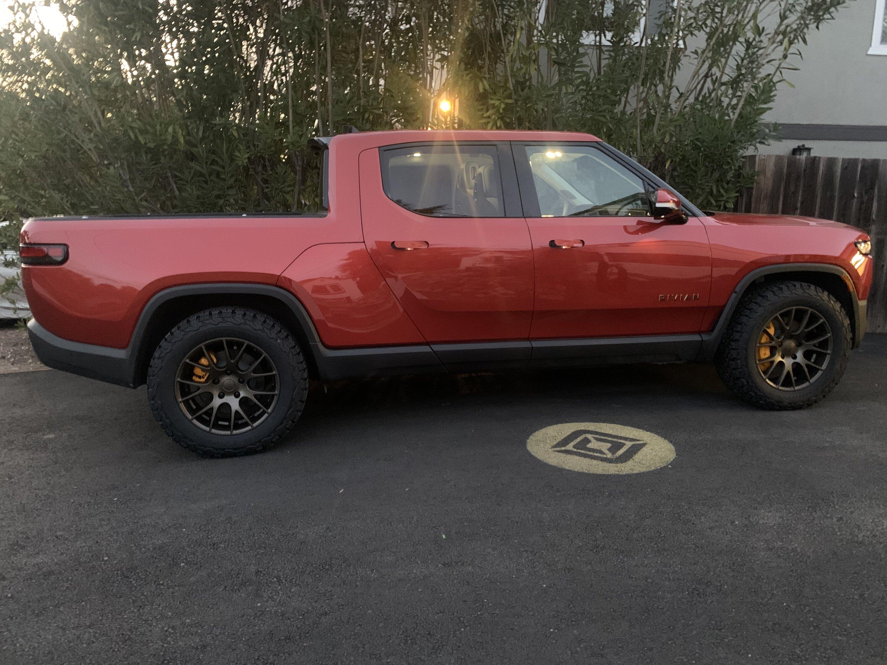

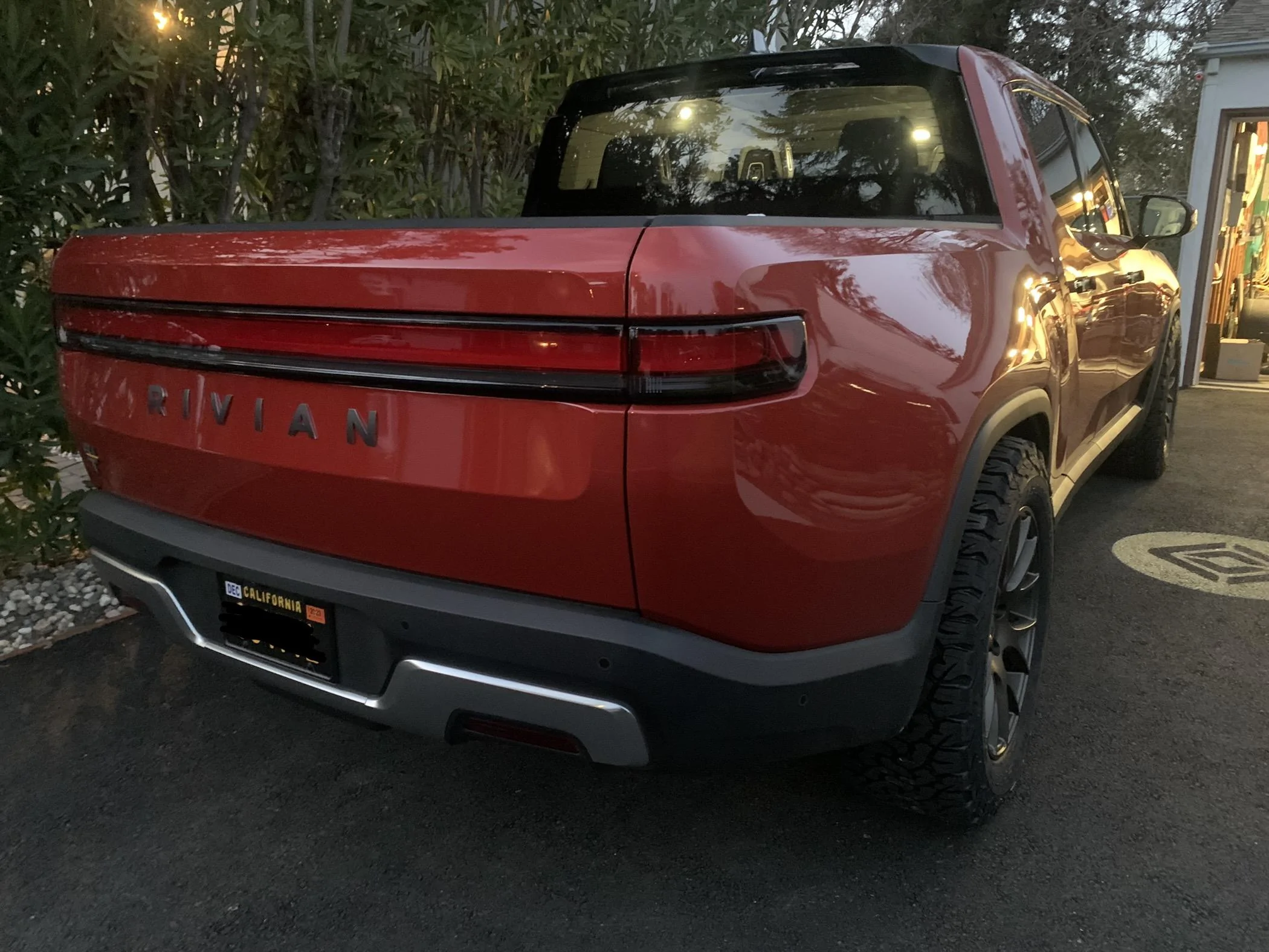

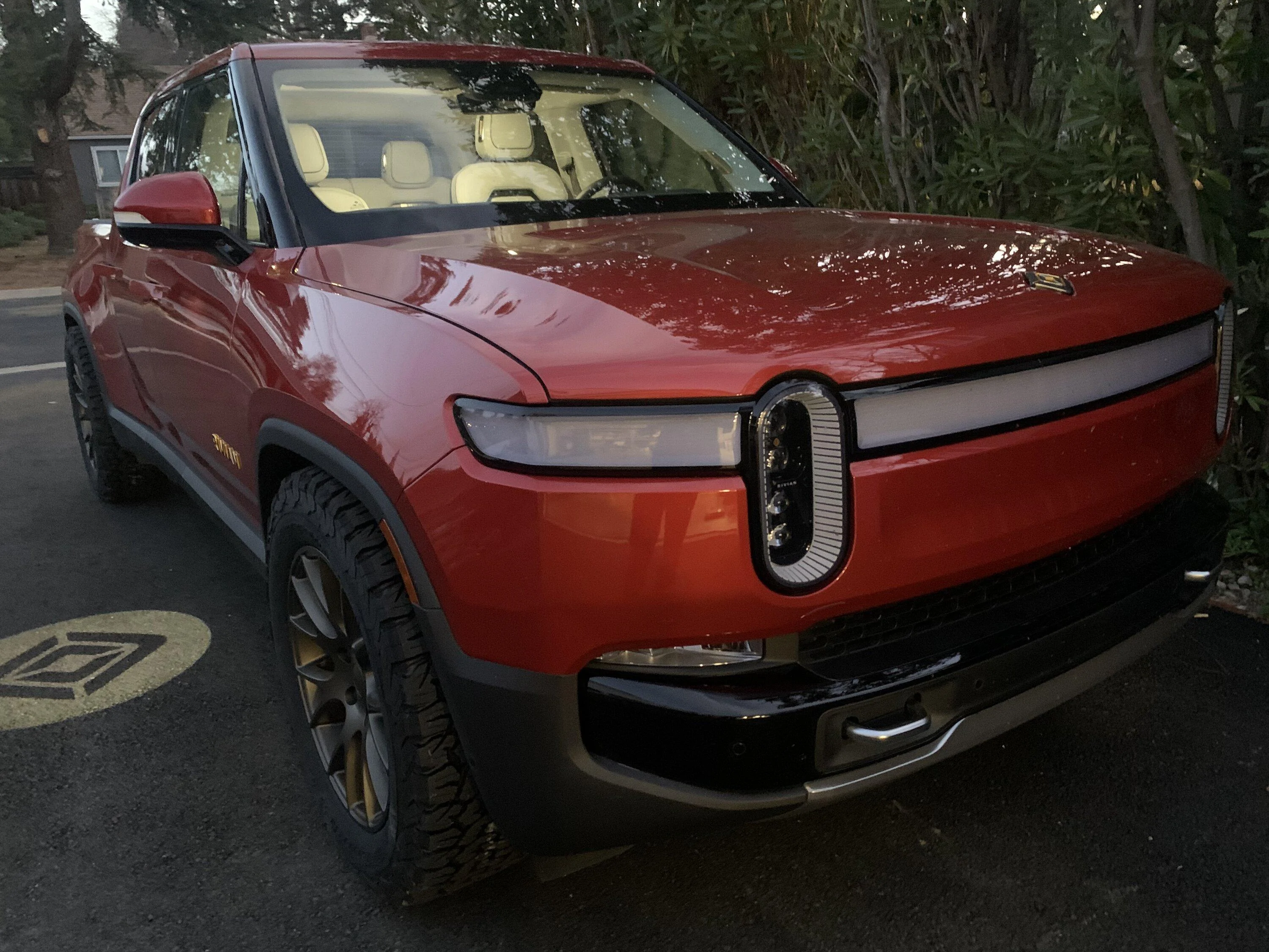

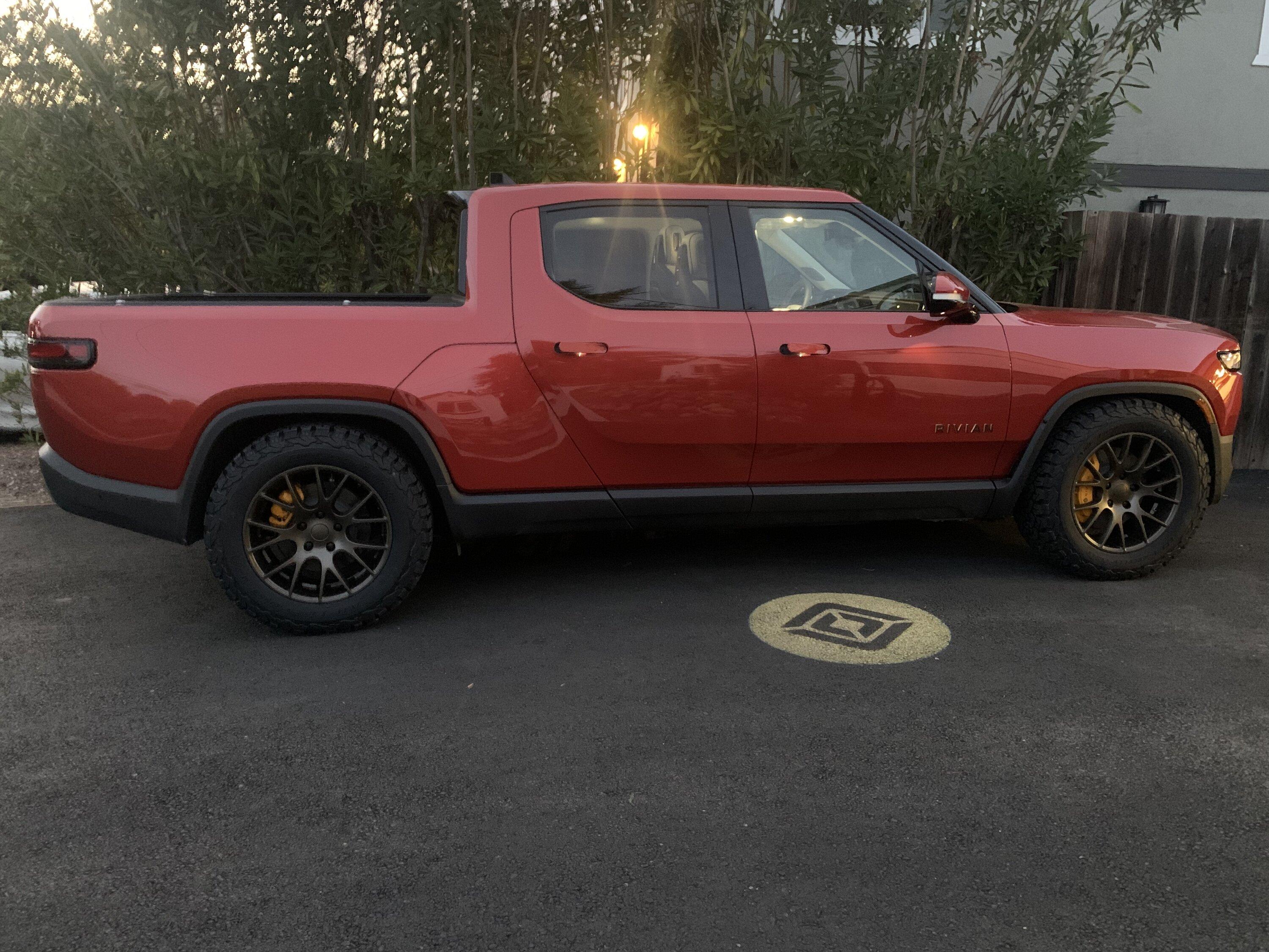

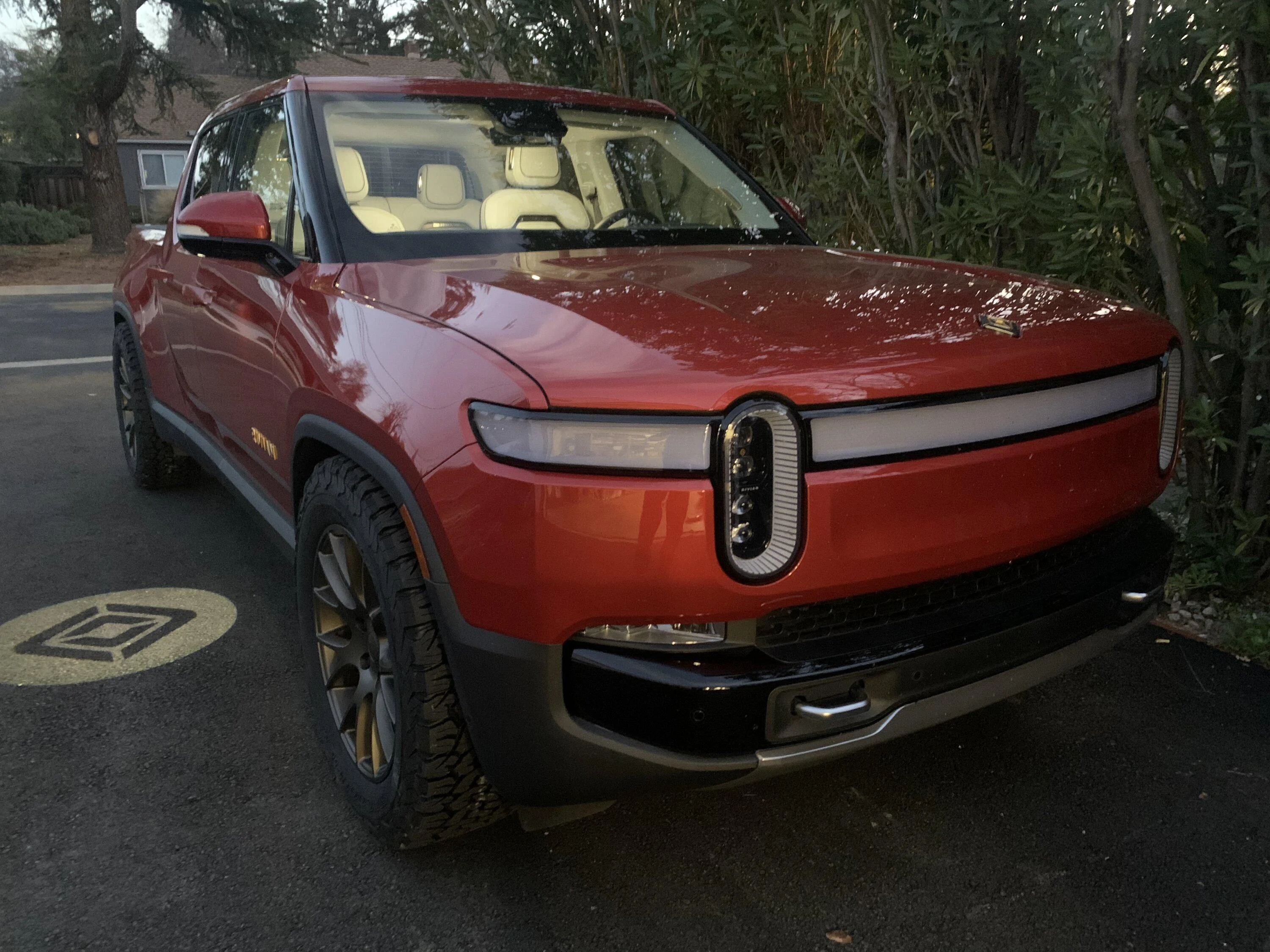

Here’s how it looks in normal, low, and lowest.
Rivian R1T R1S BFG 285/60/20 tires with 20" aftermarket wheels installed (+ blacked out badges & light bars tint) D73D3AC2-A057-4AD5-BEE5-AC3553DF8CE0
Rivian R1T R1S BFG 285/60/20 tires with 20" aftermarket wheels installed (+ blacked out badges & light bars tint) A1F34D12-36F5-4733-9778-AA5A72D2C0D4
Rivian R1T R1S BFG 285/60/20 tires with 20" aftermarket wheels installed (+ blacked out badges & light bars tint) C19530E3-8628-4402-8BD7-7BF4114D61A3
Rivian R1T R1S BFG 285/60/20 tires with 20" aftermarket wheels installed (+ blacked out badges & light bars tint) 6D2591A0-0531-4ACA-857A-1A8C98BDF475
Rivian R1T R1S BFG 285/60/20 tires with 20" aftermarket wheels installed (+ blacked out badges & light bars tint) 5E60B202-43AB-4DA6-B86A-E67CDF6FA602
Rivian R1T R1S BFG 285/60/20 tires with 20" aftermarket wheels installed (+ blacked out badges & light bars tint) 556B8F15-395D-40F4-89A7-1B8BA51CC05A
Rivian R1T R1S BFG 285/60/20 tires with 20" aftermarket wheels installed (+ blacked out badges & light bars tint) 7FE71E99-EE7C-4F7A-8704-DC85B643F994
Added:
Also have blacked out badges & light tint on light bars.
Rivian R1T R1S BFG 285/60/20 tires with 20" aftermarket wheels installed (+ blacked out badges & light bars tint) fc627e36-78f1-4ccf-905e-12e3e9727909-jpe
Rivian R1T R1S BFG 285/60/20 tires with 20" aftermarket wheels installed (+ blacked out badges & light bars tint) 77C2CB70-B624-457F-B4B8-40806CF70A86

So far, there’s barely an increase in road noise. But as these tires wear out I’m sure they’ll get louder.
The more noticeable difference is the improved performance over small, sharp bumps, like parking lot speed bumps. This is now the best performing vehicle I’ve ever driven over those types of bumps. It was very good on the 22’s, now it’s great.
Also, I lived in fear of curbing the 22’s, especially after I damaged one. Drive throughs were terrifying (I shouldn’t be eating that crap anyways). Now I laugh at those situations.
