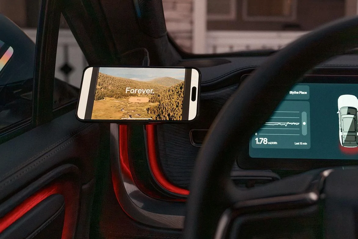

I did extensive research on all the available phone mounting solutions for my 2025 Rivian R1S even before delivery, and I believe I’ve found the perfect setup. If you’re searching for a clean, rock-solid solution that supports MagSafe wireless charging and doesn’t obstruct your view, keep reading!

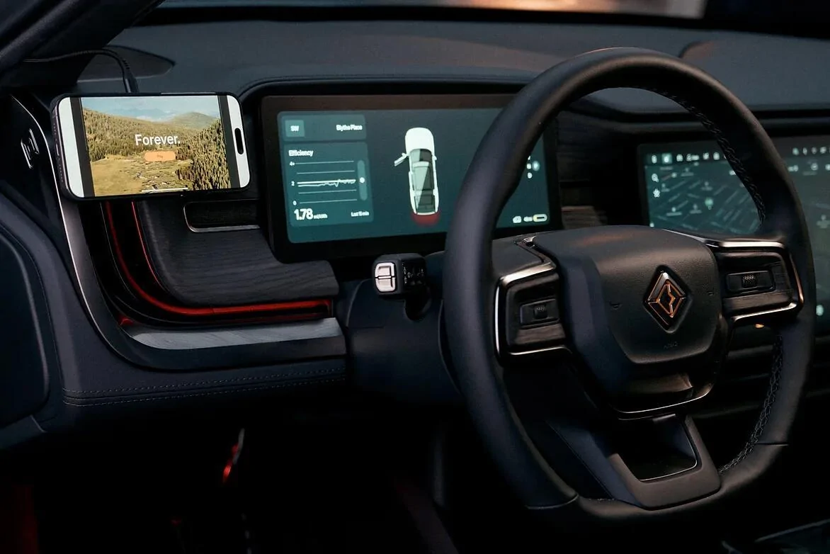

When it comes to phone mounts, my requirements are pretty straightforward. First and foremost, it needs to be stable and should not obstruct my view for safety reasons. Navigation apps or other apps can drain a lot of power, so wireless charging is a must. I also want to avoid having my steering wheel block any part of the phone. Most importantly, I can’t stand hanging cables. I’ve spent a lot of time ensuring my home office has only one visible cable powering my standing desk, with the rest neatly hidden. I want that same clean, cable-free look in my cars.
I started by watching YouTube videos and searching on Amazon, Google, and the Rivian owners’ forums. I even bought a few generic phone mounts to test out. Unfortunately, none of them met the requirements I mentioned earlier. They either didn’t fit Rivian’s unique air vent design, used adhesives that could eventually damage the interior trim, or were positioned poorly, often blocked by the steering wheel. Then I discovered the Open Source EV Parts site and found my perfect solution—the NextGen Phone Mount HD. At just $13.95, it’s incredibly affordable, especially compared to some 3D-printed mounts on Amazon that go for $69.
Rivian R1T R1S Best Phone Mount/Charger for Rivian R1S/R1T 785ef3_1db139907feb40638336fbfbb24290da~mv2

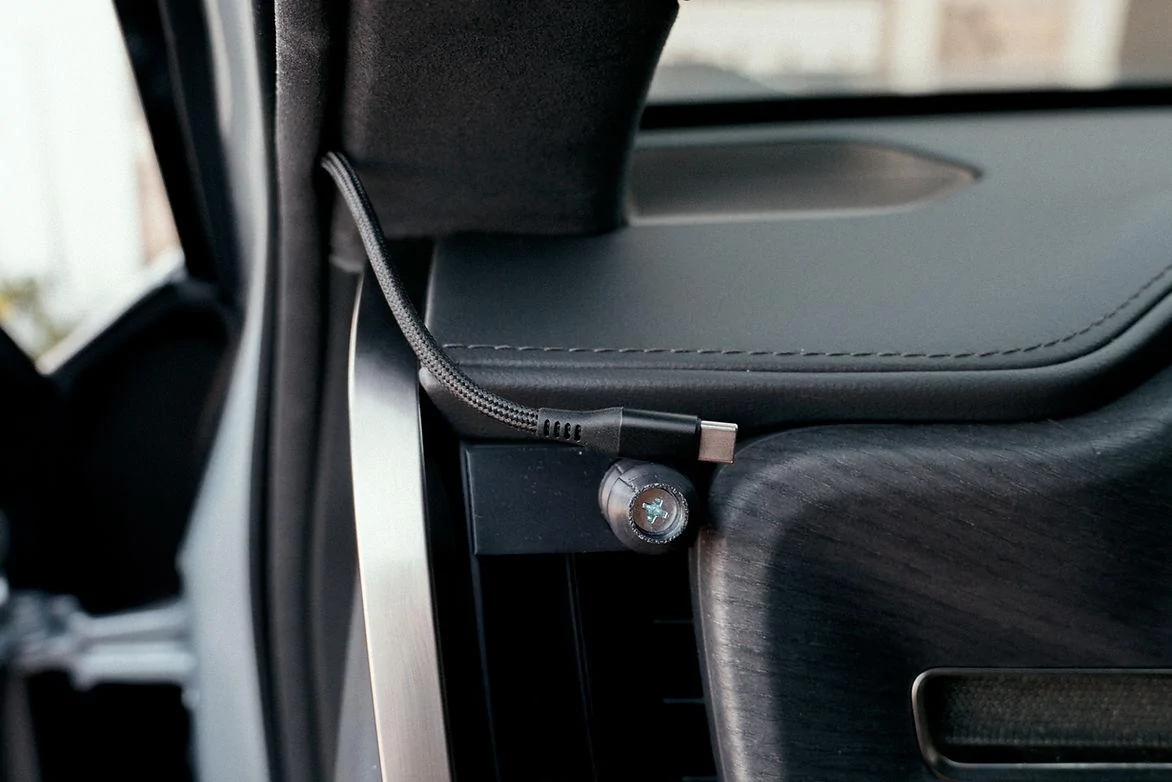

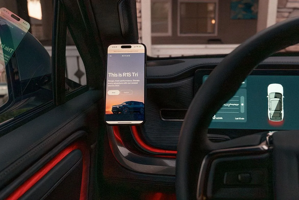

To be honest, I’m not a huge fan of 3D-printed products. While I love the concept, the look and finish often don’t feel premium. They're more like prototypes to me. The NextGen Phone Mount HD, however, is too good to say no to. It offers two options—Driver Side or Passenger Side—and I went with the Driver Side mount to keep my phone to the left of the steering wheel. The mount installs at the very top of the driver (or passenger) side outboard vents. The best part? It’s positioned outside the shadow of the steering wheel. The mount comes with a 17mm ball, which allows easy swaps, making it compatible with almost any phone holder on the market.

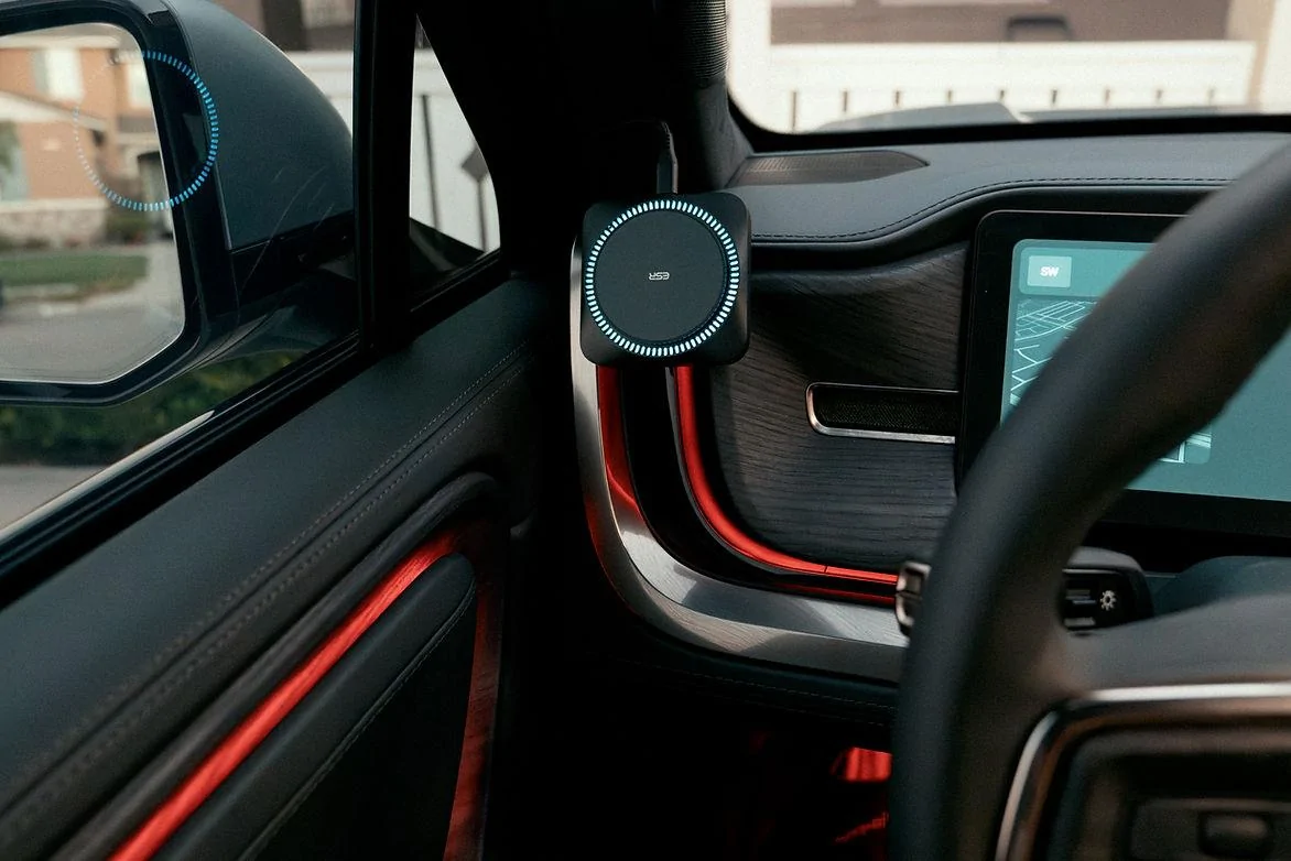

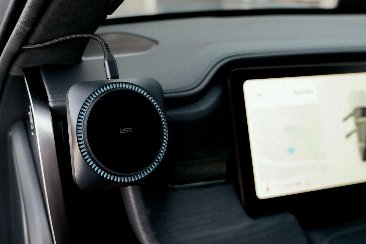

Installation is simple and takes about five minutes. Once assembled and tightened, it’s rock solid. They’ve even uploaded an installation video on YouTube for guidance. For the phone holder, I went with the ESR model featuring an LED ring light and CryoBoost (a built-in phone cooling fan). It mounts seamlessly onto the 17mm ball, and I think it looks sleek (though the logo could be less prominent, but it doesn’t really bother me). Once powered, the cooling fan kicks in. It’s noticeable but quieter than the AC, so it’s not disruptive.
With the mount and holder in place, the final step is powering it. You’ll need a power cable, and Rivian offers several power sources. You can connect the phone charger to the USB-C ports in the center console, the second-row display ports, the power outlet, or the seatback ports. If, like me, you want a clean, cable-free look, you’ll need a long cable—at least 15 feet. I opted for a 20-foot braided cable for extra durability.

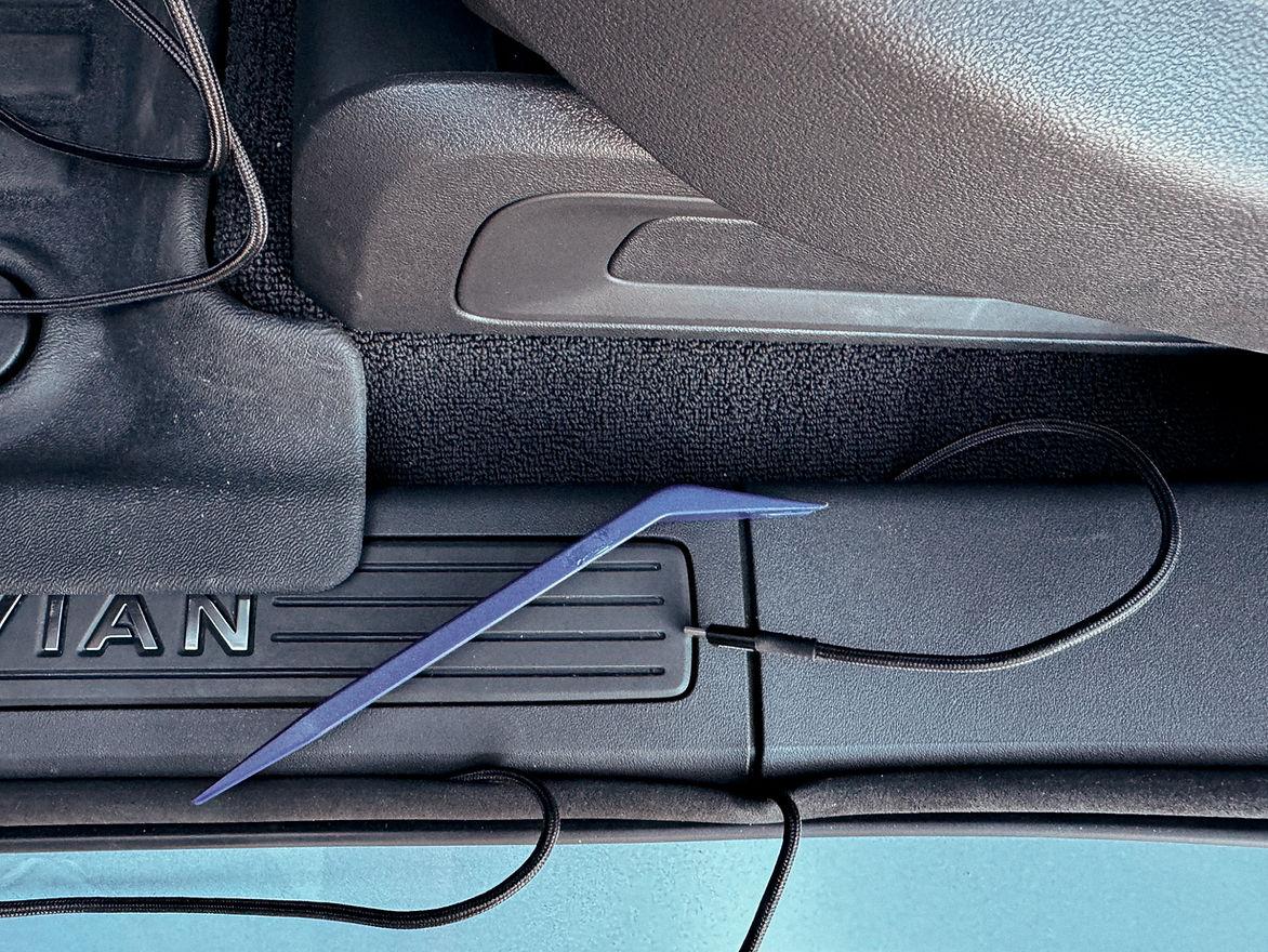

Cable routing and management can likely be done without tools, but I recommend using a pry tool to save your fingers. I rotated the charger so the USB-C port was at the top, then connected the cable at both ends (charger and power source in the center console storage). It’s best to connect first, ensuring the cable works before you start managing the wiring.
Rivian R1T R1S Best Phone Mount/Charger for Rivian R1S/R1T 785ef3_8a8072f1f9ed42b59bb3e414edd16654~mv2
After that, you can start routing the cable. First, tuck it between the rubber seal strip and the headliner, then run it down to the floor and through the door sill entry plates. This is where a pry tool will really come in handy and make the process much easier.
Rivian R1T R1S Best Phone Mount/Charger for Rivian R1S/R1T 785ef3_b2f8d78db3d84835b8f8b0c20ff9b42a~mv2
Don’t worry too much about damaging the trims—they’re more durable than you think, and there’s usually plenty of room to tuck the cable in. Once you’ve run the cable through the door sill plates, you can continue tucking it along the other side, underneath the plate to the second row. When you reach the floor mat, simply hide the cable beneath it, and bring it out near the center console, running it up the right side of the driver’s seat.
Once everything is set, the only visible sections of the cable will be at the top of the charger and between the driver’s seat and the center console. When your phone is mounted and you’re sitting in the driver’s seat, the cable is practically invisible.

Now you can easily mount and charge your phone while driving, whether you prefer horizontal or vertical orientation. The setup is clean, and the experience is fantastic. I hope you like my setup and find this article helpful. If you do, please share it with your fellow Rivian owners. You can also follow my journey by subscribing to my newsletter and following me across social media. Adventure forever!

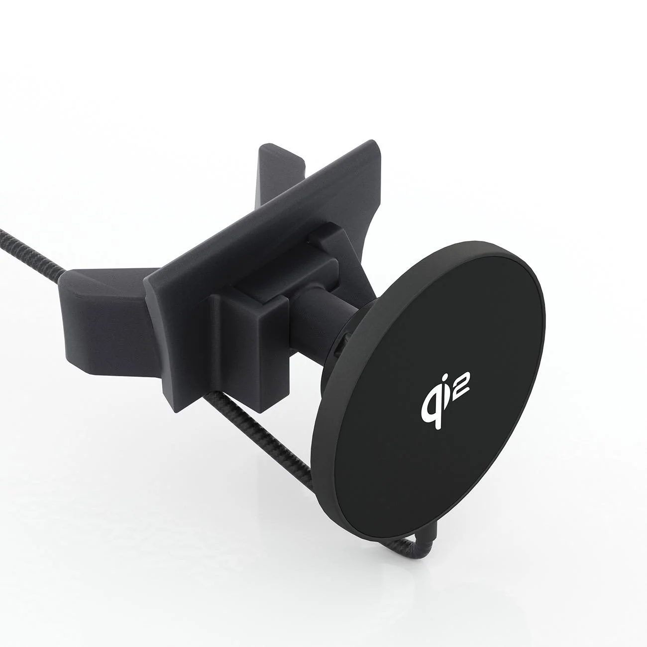

Why not use the ESR Qi2 cryoboost charger? Should be faster charging.

I like the left side mount but it blocks the vent when the phone is docked. This is the only vent that the air will actually reach my face.
I'm looking for a mount for a Foldable phone that allows me to run waze and a radar app side by side.
The mount itself doesn't block any of the vent as it installs over the blank section at the top of the vent opening. The phone also sits far enough in front of the vent to not block any of the air coming from it.
If you're concerned about the phone deflecting the airstream coming from the vent opening, there are a few different options that address that:
ATB 720 Degree: https://opensourceev.com/products/atb-720-degree-17mm-magsafe-phone-holder
Qi2 Charging: https://www.amazon.com/LISEN-MagSafe-Wireless-Charging-Magnetic/dp/B0D93X5QNJ
MagSafe: https://www.amazon.com/LISEN-MagSafe-Car-Wireless-Magnetic/dp/B0C23PQK9Z
MagSafe w/ Fan: https://www.amazon.com/LISEN-MagSafe-Charger-Cooling-Wireless/dp/B0D66MHWTK
