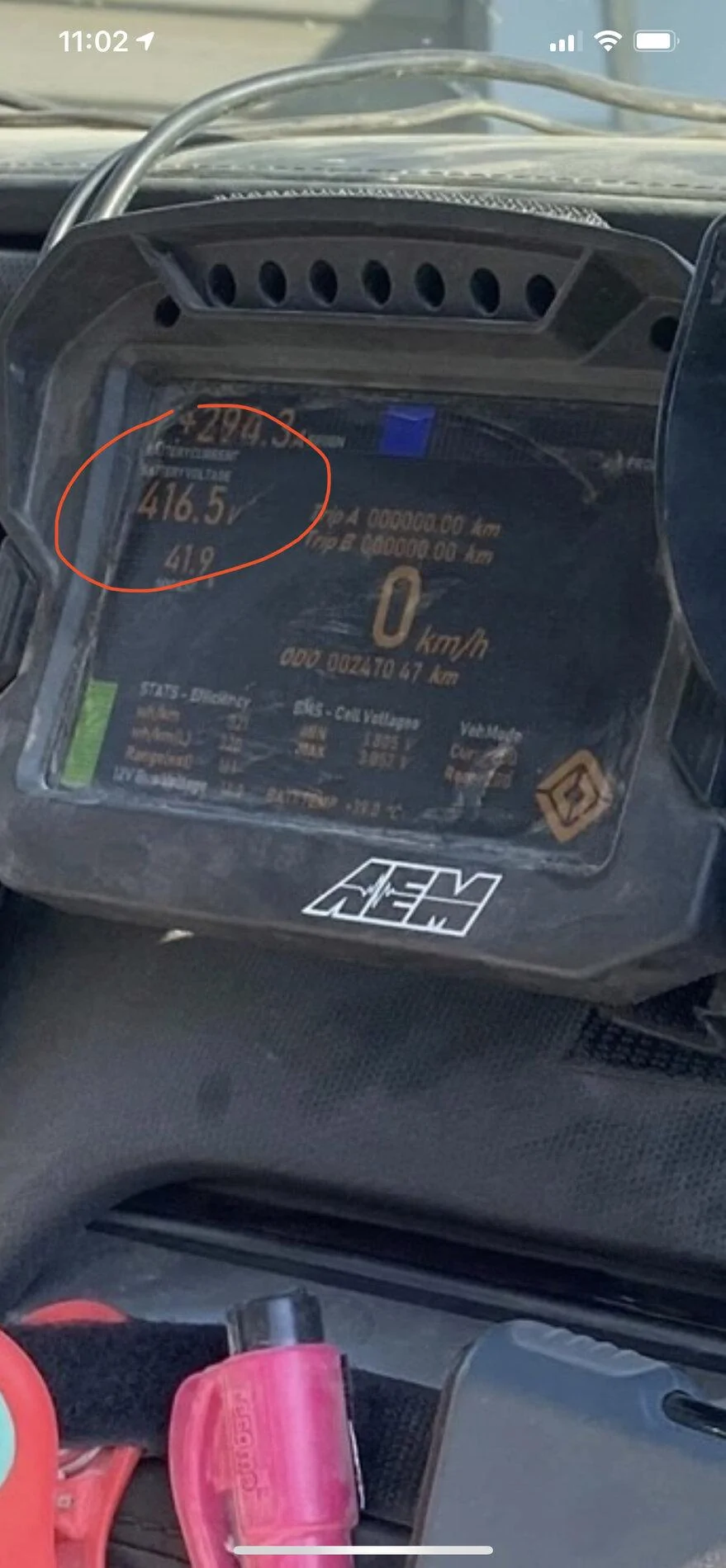

Apologies if this had been definitively confirmed elsewhere - I seem to recall some debate about 400 vs 800v batteries.
I saw this snap from the Rebelle R1T (via the auxiliary display manufacturer). Seems to confirm 400-450V.
Rivian R1T R1S Battery voltage confirmed: 400V-450V 1437D4A7-973D-4F81-8B53-49FFBCA46F39

I do appreciate that things can change, but if they’re changing configuration this close to production, that would be pretty surprising.
I think it’s reasonable to assume they locked suppliers and major component decisions like this last year or earlier, and the Rebelle car seems pretty close to production intent in most respects - enough so that they permitted extensive write ups and reviews of the experience.
Emme Hall’s write-up literally said they had a R1T with an “extremely pre-production” version of the battery that was not final production-intent.
Maybe this is another “clue” on the final voltage, but I would not use the word “confirmed”

All the numbers Rivian has published in writing so far, 140miles in 20minutes, are a sure indicator of 400V/200KW charging. But I have some ocean front property for sale in Arizona for those who do not want to believe that.

The second data point that confirms 400V is the story on the cold weather testing. They stated in the video testing at 400A and going next to testing at 500A. 500A is not possible with 800V charging.

We all keep quoting the 140 miles in 20 minutes figure that is a reference to the RAN, but the website also just says 200kW charging:
Both of those figures line up with the likely pack structure of 108 cells in series with a nominal voltage of ~400 and a max charging voltage of ~450.
It may well be the case that the pack is only 400V and maxing out at 200kW, but the language used, rally photo, and omitted info doesn't actually rule out the 400V/800V switching technology. If they can switch, why couldn't they charge in either 400V or 800V mode if one is deemed more advantageous than the other for winter conditions?
There is no point in implementing 500A charging if the vehicle is capable of accepting 800V.
200kW @ 800V is 250A versus the 500A needed for 400V. All equipment currently installed (EA, etc) and/or on the market (including the proposed RAN in Saldia) that can do 200 kW at 400V can also do it at 800V. The beefier everything needed to handle double the amperage means they did not implement 800V charging.
400V vs 800V charging is not a factor in cold weather.
