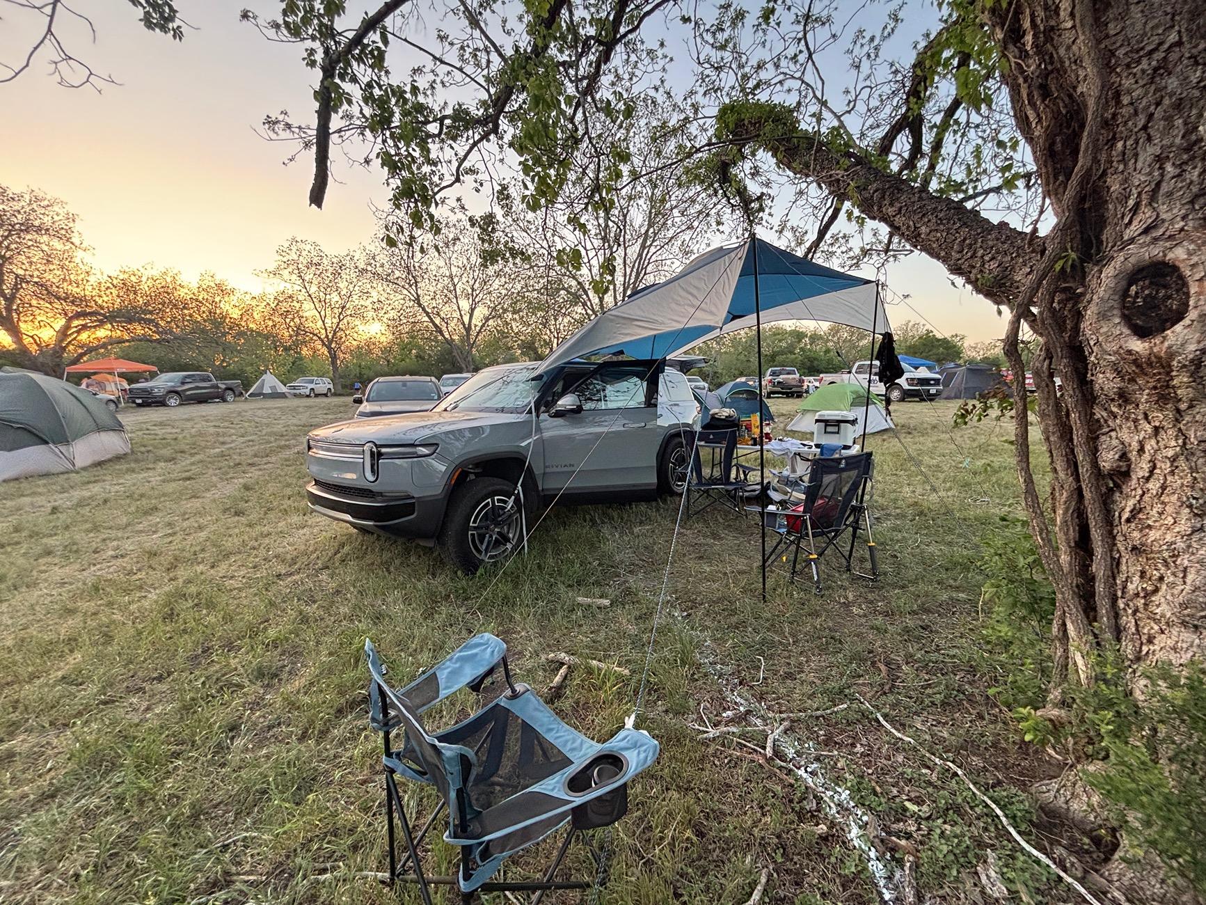

Camped 3 nights in mild temps. Ran the AC a couple hours one day. Ran the fan one night with no AC. Brewed a bunch of coffee with a Keurig (1475 watts). Only used about 19 kw over the thee nights.
Rivian R1T R1S Battery saving while camping IMG_9129
