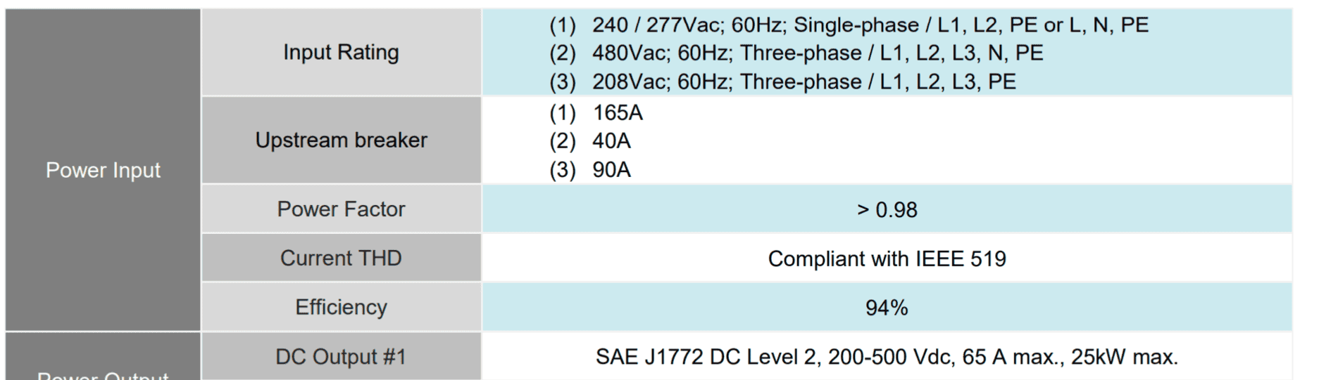

I know some people are anxious about the AC charging speeds with the Rivian. This may be a solution for some folks. You'll obviously need to do your own research on if it would work for you, but United Chargers (Grizzl-e) is coming out with a 25kW charger that they say will be the most affordable on the market. Just figured I'd let people know of a potential option.
"store will be updated with all prices and configuration details next week. 25 KW DC Fast charger is the fastest DC charger you can get WITHOUT paying demand charges to your Utility for power availability, with great price point it makes economic sense. "

Would be interesting to see what the specs are...
Rough calculations, 25kW DC, assuming you drive it from AC 240V with a 90% inverter, would need 150+ AC Amps.
Most houses only have a single 200A service panel, a single circuit taking over 50% of the capacity wouldn't seem to be a good idea...unless you only charge when there is low demand (e.g. at night).
Probably a better solution for people with 300, 400 AMP service.

"Most affordable" could be $10K for the hardware as a frame of reference.
The electrical service to support it is also a consideration - you will need the capability to add a 165A circuit/breaker to your panel.
That is a considerable amount of juice... I would recommend taking the feed from the neighbors panel if possible.

just makes me wish for 600v 3 phase to my house.
Yeah, it'll be curious what their specs are. I think someone found a 25kW charger that didn't require 3 phase. Guess we wl see in about two weeks.
