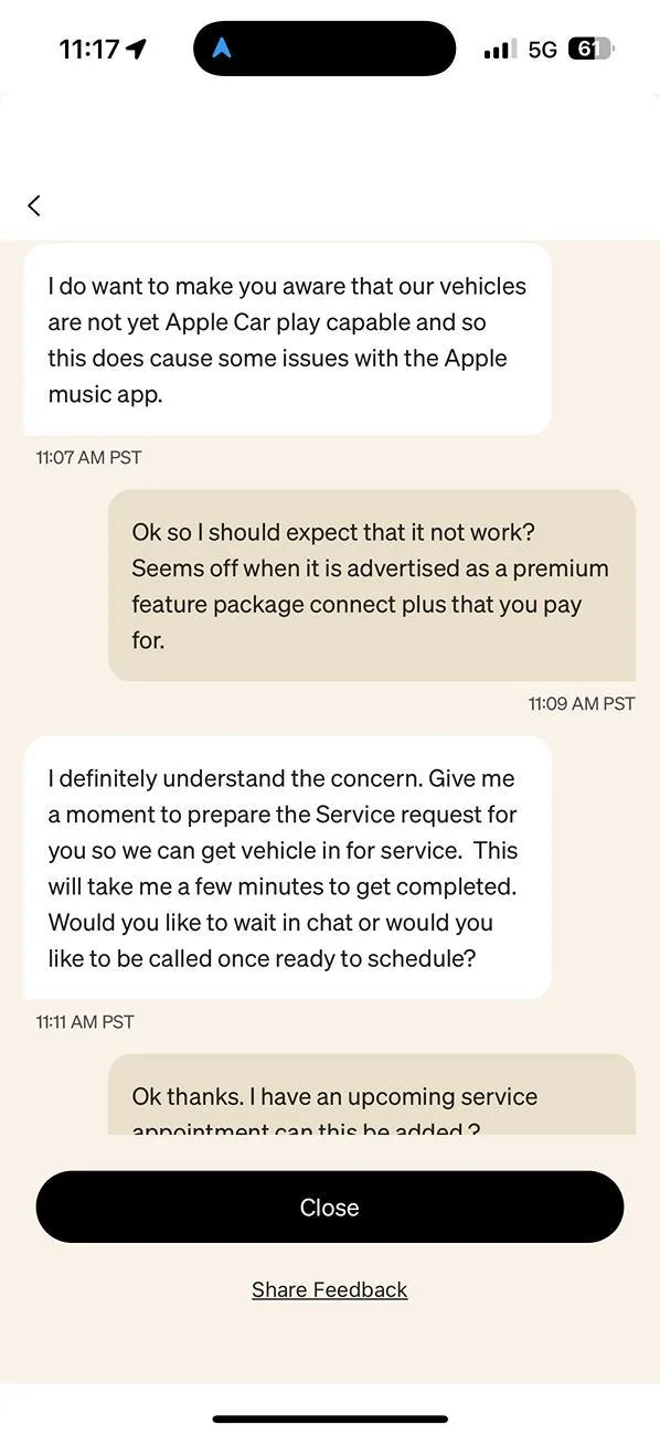

I have the same issue with Apple Music as described above. Contacted Rivian multiple times and they advised to perform the 3 levels of reset. Have also tried to log out and in of Apple Music multiple times. Issue remains. Contacted Rivian again and their response was quite interesting. A portion of the chat transcript is attached. Paraphrasing I was advised that Apple Music is not stable on Rivian pending release of Apple CarPlay.
Take care to avoid misinterpretation. It doesn’t mean ACP is coming and pending release. It just means there is no ACP and implementation of AM, as a standalone app, comes with challenges. Also bear in mind customer support generalists may not be as savvy as those who actually work in technical positions and may not have the knowledge or information to communicate tech info accurately. At the very peak of their software hierarchy, Wassym has said very bluntly that there will not be ACP in Rivians. That horse has been beaten and reduced to atoms.
And on point implying link between issues with AM and absence of ACP, I call BS. On OSX and iOS platforms, the AM apps are standalone applications… not tied to any other application, other than their respective operating systems. The root of issues with implementing in Rivians is quality of internet connection (which could be network coverage, or hardware/software) and getting the [ported] AM app to play nice in an Android Auto OS environment (which is what Rivian’s infotainment is built on).

Yeah I am not here to argue the point about Car Play integration just sharing what Rivian told me about the issue. I agree BS.

Just to close the loop I was able to get my Apple Music Issue resolved by Rivian Service. The invoice from the service indicates that they replaced a multi function control module and did a firmware update to resolve. Hope this helps others
