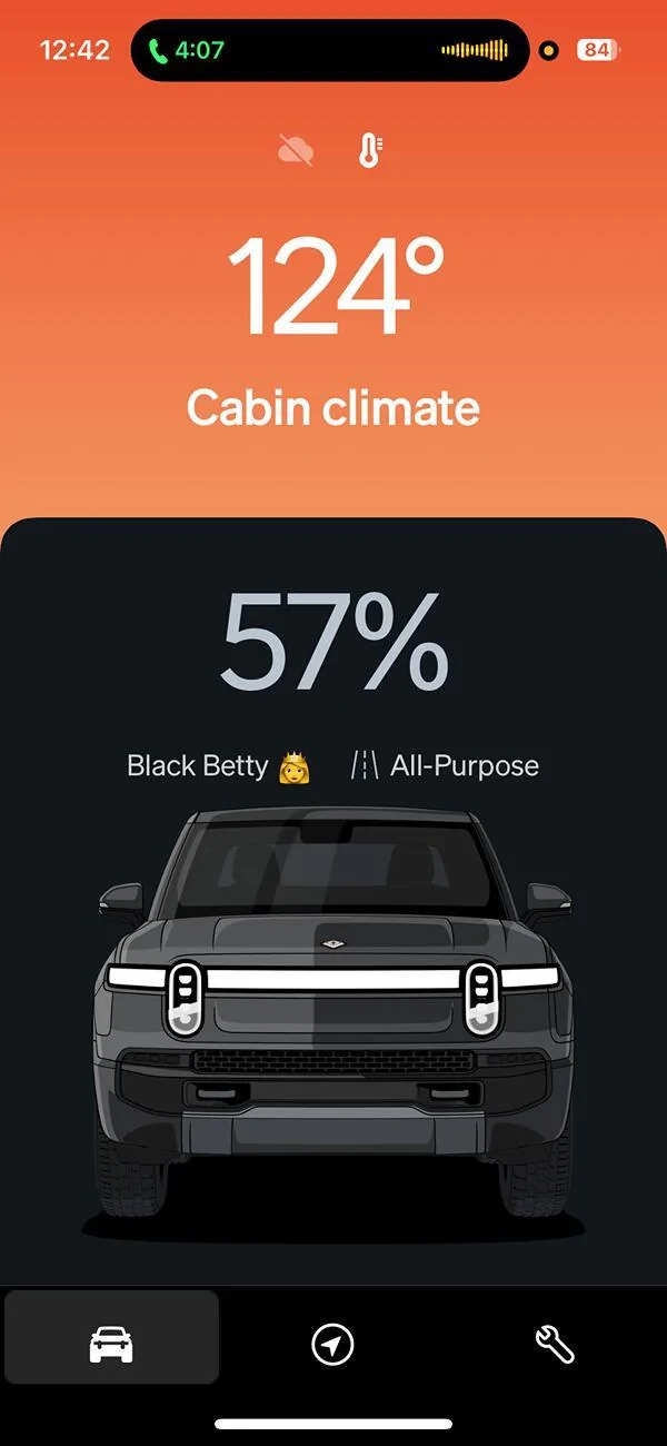

Update: I took my truck to the Denver SC on a whim. A tech plugged into my truck with his laptop and said my bluetooth module needs to be replaced. Scheduled for August 22. In the meantime, I'm using my fob.

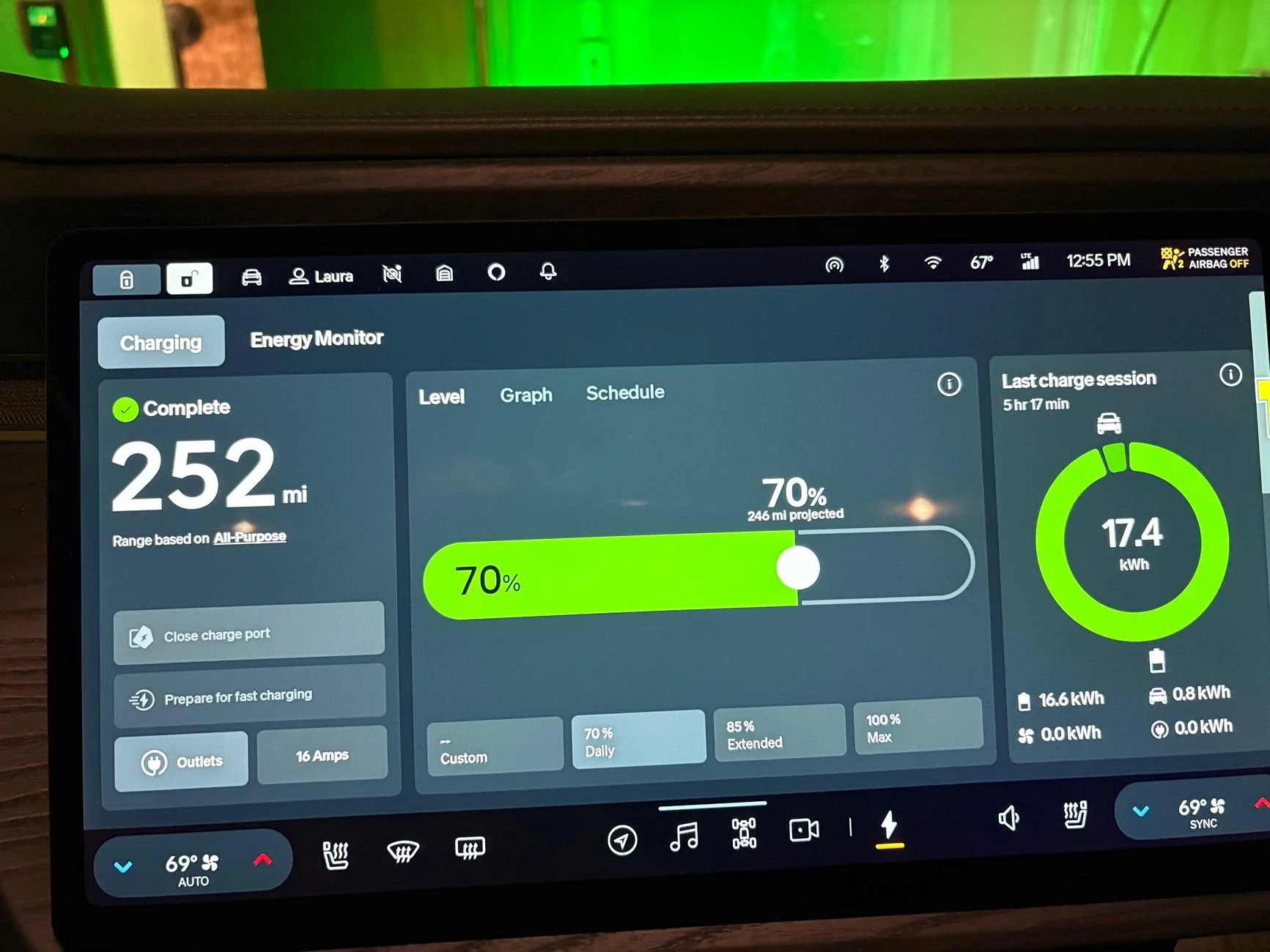

I noticed my app is stuck showing data from 3 days ago when my truck was parked at the airport. At the time it showed cabin temperature is really high so fans turned on to cool it down. At that time, my battery was showing 58%. It has since been recharged up to 70% but still shows 58% and super high cabin temperature. I tried restarting my phone. I tried logging out of the app, deleting it and reinstalling it. It works fine until the app asked me to pair my phone, and then it represents back to 58% with high temperature in the cabin.

The app shows "no cloud", something is mixed up. Your center screen photo shows it has cell and WiFI access, so yeah, something goofy with the app.
To find out if it's "local to the app on your phone" or something strange in Rivian's cloud/API, do you have your Rivian linked to A Better Route Planner? If so, check what it says your current charge% is. If it says 70%, then it's firmly the Rivian phone app; if it says 57/58%, then something is wonky with Rivian's cloud services.
(Although I will mention that connection appears fine to me, so if it is Rivian cloud, it's something specific to your account apparently.)
Thank you.
I am linked to ABRP. It shows 70% SOC. I called Rivian support who is sending a mobile tech out on July 31. Not sure they will be able to do anything.
