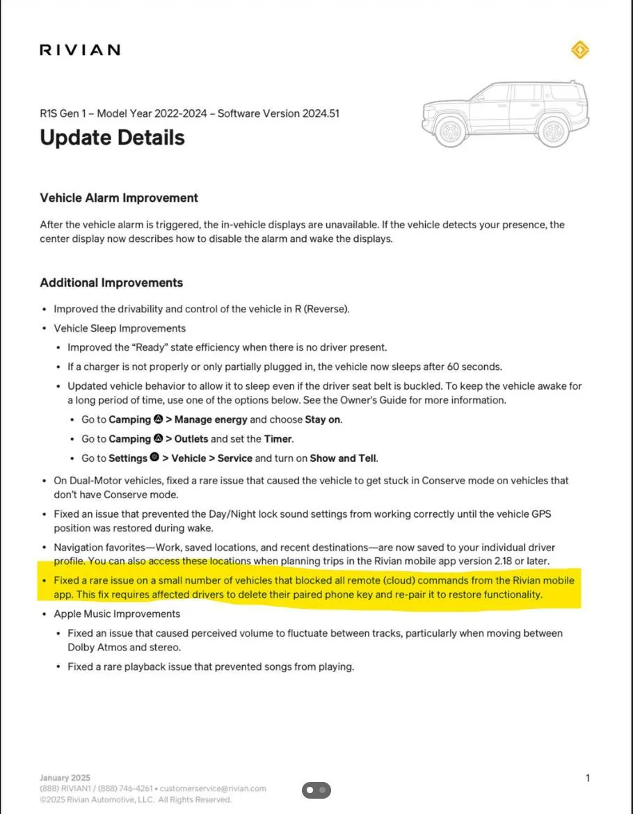

Latest update has mentioned an issue over remote commands. Hopefully this fixes your guy's problem.
Has anyone verified that this works?
I’m running the update this morning & will report results

I did the update this morning. Then deleted both phone keys set them up again. App controls are currently working!

I don't have the fob but after the last update, the app works again and even the unlocking at home (I have it set to lock only at home) is much much quicker 👍👍
I still have the same issue of the car randomly unlocking and locking in the driveway. Sometimes I'll walk out and find the car unlocked and more often, I'll hear random hoots. Don't know how to troubleshoot this (was hoping the update would fix this too) but I'll probably just change the lock setting to off at home.

I used to have this issue on my Gen1 but the last update actually fixed it
