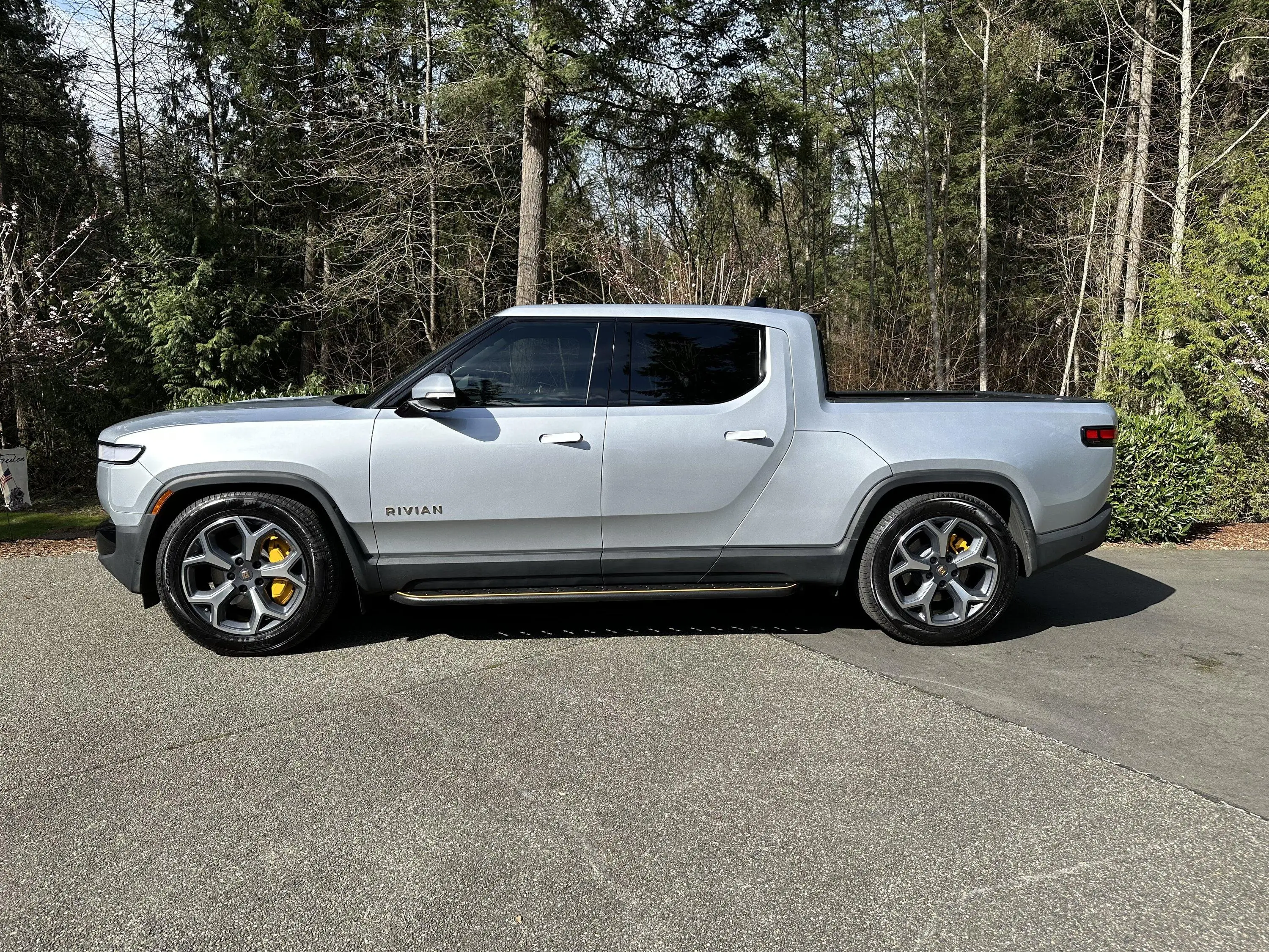

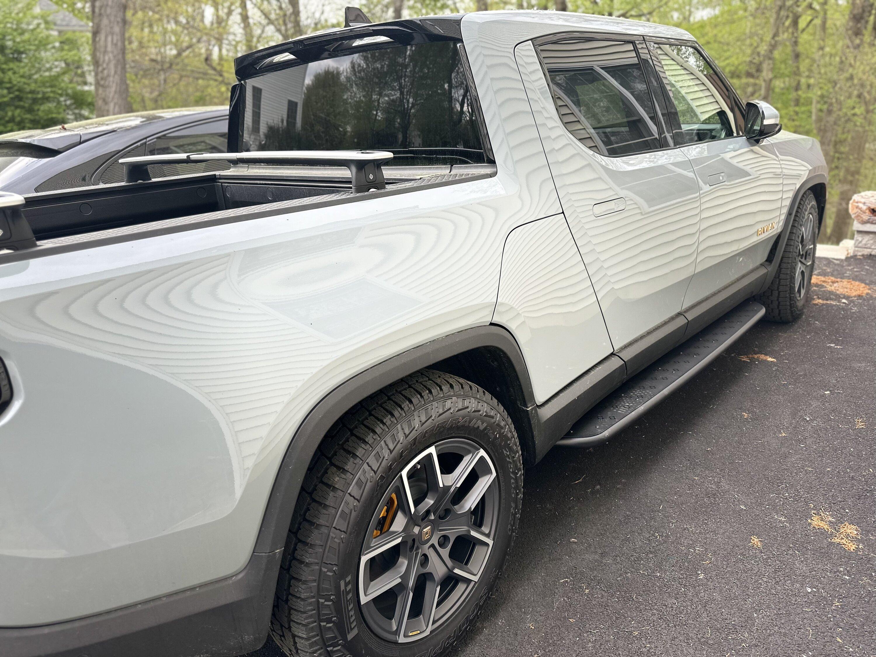

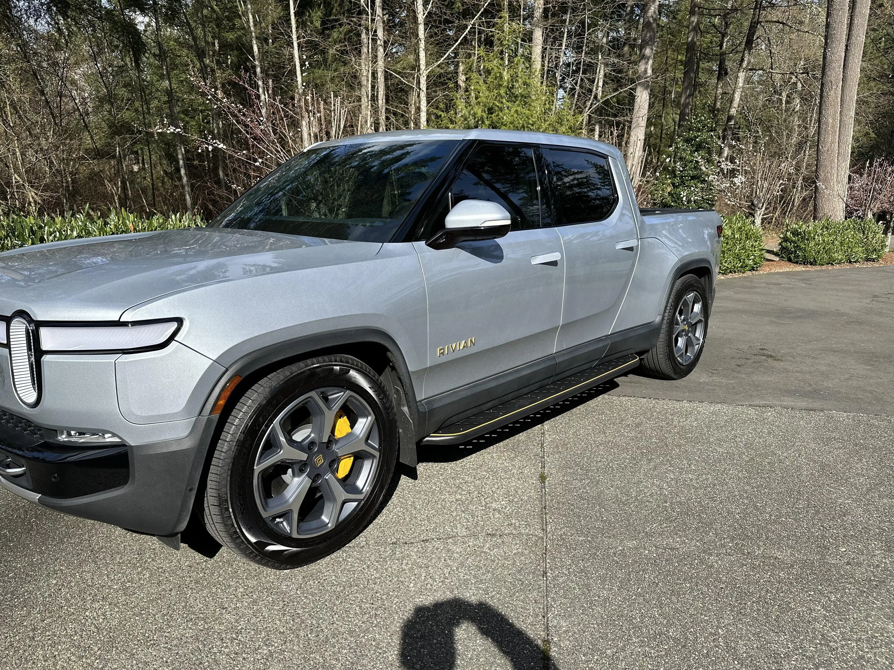

RMaxx installed today, pic included if useful for comparison.
First time I see one installed with the triple slots slotted in the other direction.:)
