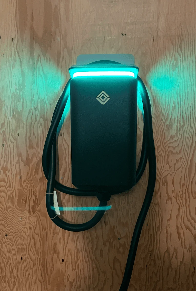

My delivery window is "First half of 2023" but I ordered it the day the gear shop opened up for my model Y.
Nice! So, direct wired? or NEMA 14-50 plug? Dip switches inside for setting amperage? Can you share the manual?
It's direct wired. Not sure about switches inside. But it's running 48A to my Tesla no problem
Is it showing up in your Rivian app? If so, what info does it give you when using with a non-Rivian?
It shows up and I started to connect it, but at the end it fails. I'm guessing it's because I don't have an actual Rivian. But on the positive side, it works fine without using the app
