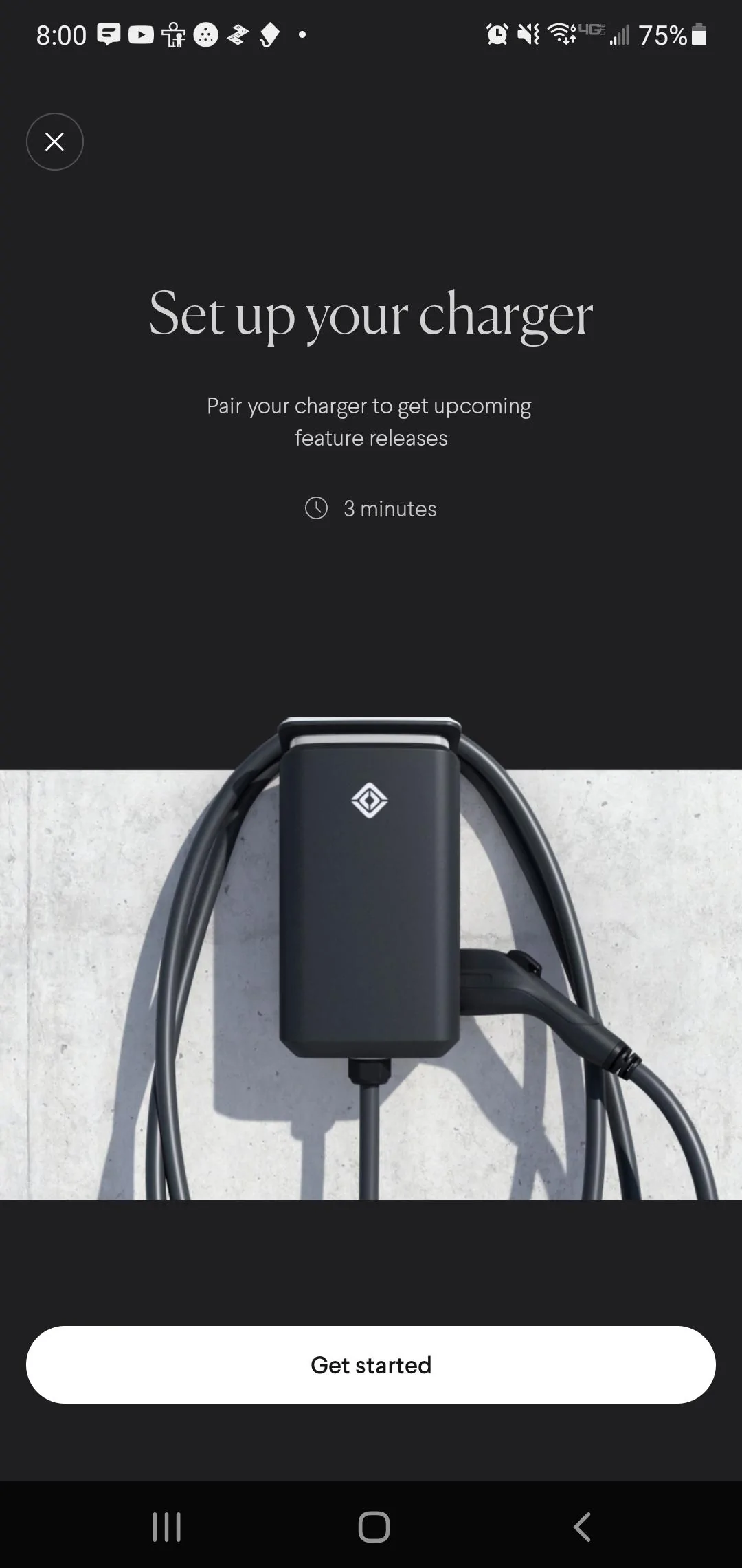

But, if I ONLY had Rivian (vehicle and wall charger) - would it be "both" or would there just be one app to interface with?
Likely just one app - the Rivian app. I think they way to look at it is that the Car app - whether it be Rivian, Tesla or any other EV - is where you are going to be setting all your charging limits and monitoring how much charge your car is getting.
If you have a 3rd party charger - you might ALSO have another app that allows some other settings like limiting charging to certain hours, interfacing with your energy provider, etc.
But for the most part you are always going to be using the vehicle's app as the primary interface.
(this could all be wrong if the Rivian charger has it's own app, but I assume it's like Tesla and it's just integrated in the Rivian app)

It's all in one. Look in the app under "add a Rivian product":
Rivian R1T R1S Anyone buying the $500 Rivian Wall Charger? Screenshot_20220103-200027_Rivian
