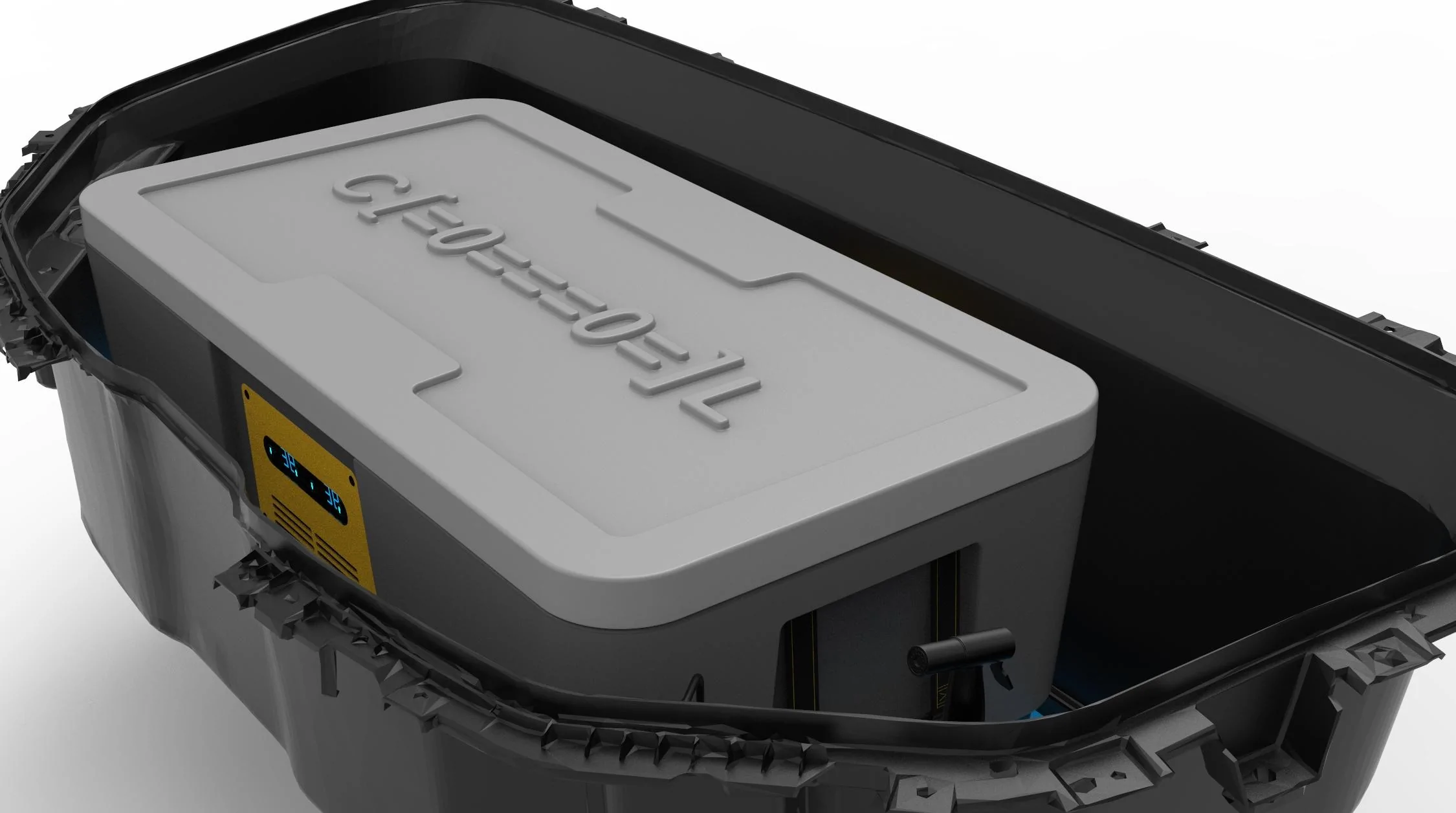

Check out the custom C [=0===0=] L 40 quart 12VDC frunk cooler/freezer being developed by the @BoxGods team! We need like 50 more folks onboard to get this project into production. It pairs well with the frunk water tank too!
Here's the Rivian forums link: https://www.rivianforums.com/powere...12-gal-water-tank-w-washdown-sprayer-concept/
And a direct link to the project: https://rivian-aftermarket.proboards.com/thread/10/12vdc-frunk-cooler-freezer-project
