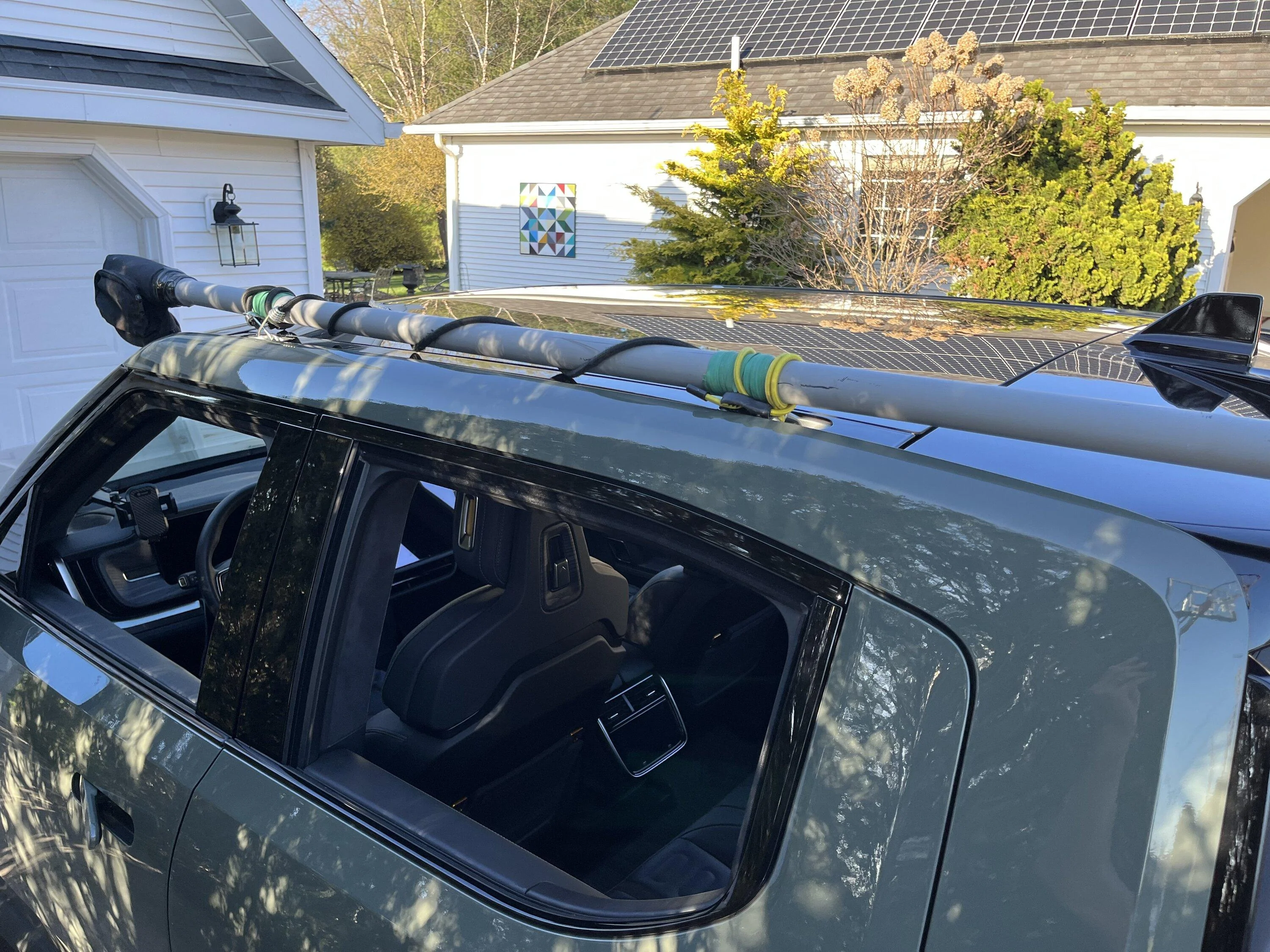

this is my flyfishing set up. I used old PVC scrap to make the rod holder (since been upgraded to make it longer). Glued a chopped off old fly rod tube and glued that to PVC to protect the reel. It is fastened to the roof cargo anchors
Can you give some close up picks? I'm particularly interested in how you mounted it.
Thanks.

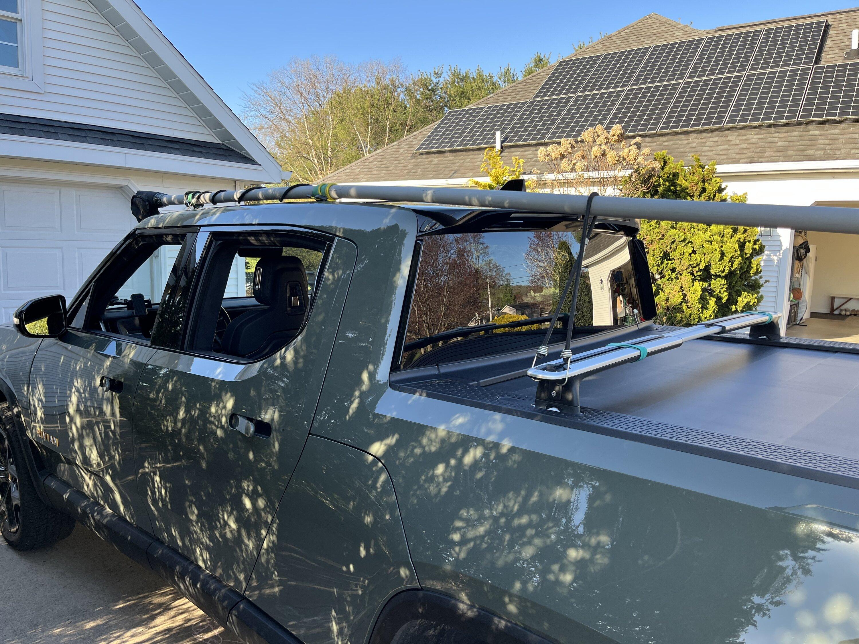

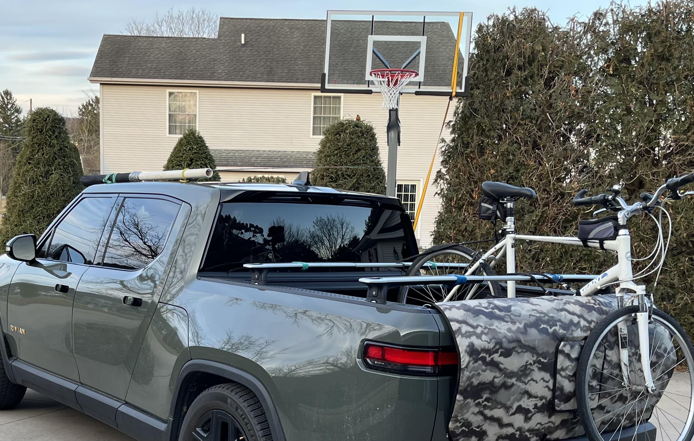

yes sure - closeup of upgraded pvc rod holders. I actually made two. Those rubber moving straps are glued on to provide grip and a bit of separation to protect the truck’s finish .

After fiddling some more I would avoid standard bungees with metal hooks. Medium duty with plastic fasteners. rubber or velcro straps will be much less likely to ding your truck .
These look perfect:
https://clutchstraps.com/
