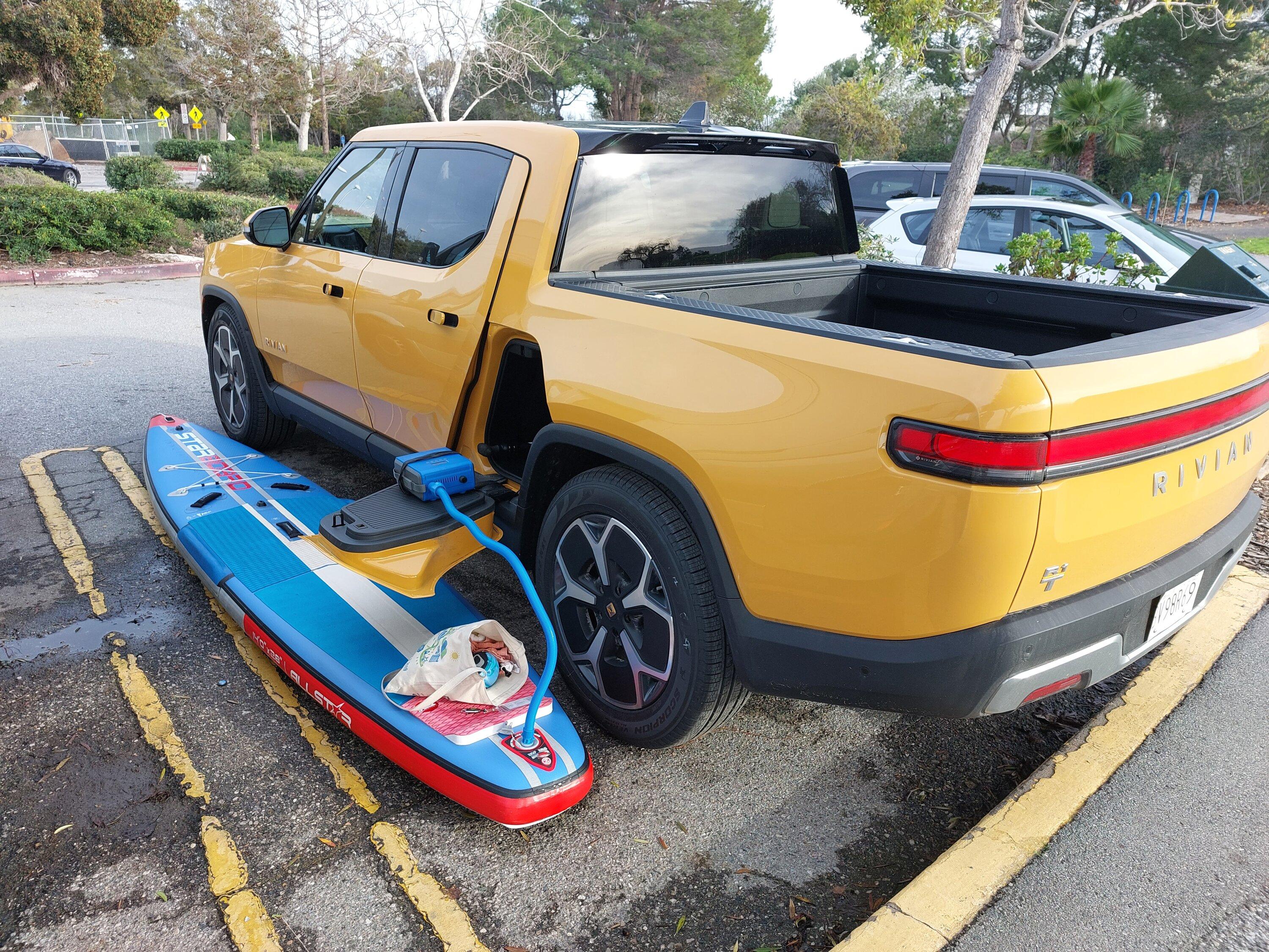

I wonder if anybody converted the air compressor to inflate an inflatable Standup Paddle-board and can share their experience, i.e. how they attached the Halkey-Roberts valve on the iSUP to the air compressor's hose?
Right now i am using a 12V electric pump, but would like to switch to using the air compressor.

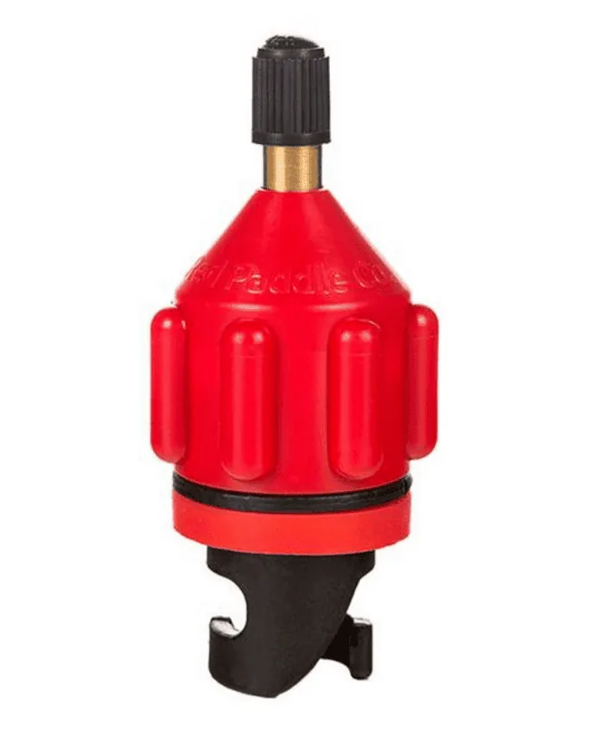

I was wondering something similar. Red paddle co makes a Schroeder valve adapter that may work. I’ve never tried it with the air compressor, but it works well enough to adjust pressure with a bike pump for fine tuning. It could be what you’re looking for. My paddle boards are all boxed up for winter but I can test it out in a few months.
Even if it works, though, with the volume of air required for the SUP I wonder if an electric SUP pump that can switch between hi volume / low pressure and low volume / high pressure may still be preferred or at least faster?

So @cashen, the configuration would look like this: Rivian hose with Schrader adapter connected to another Schrader to Halkey Roberts adapter that then goes to my iSUP?
Do i need to worry about male/female on the Shradder side?

I have such a paddle board adapter. I haven’t used my R1T air compressor to inflate but I have used a smaller Dewalt air compressor.
As others have said it will be very slow but one option is to use the hand pump to fill the bulk of the air but when it starts to get near full and difficult with a hand pump use the Rivian compressor to get that last 5-10 psi. That has been my strategy in the past.

I tried to use it to inflate my sup with the adapter but it would have taken about the same time as a hand pump I think. I was getting concerned about running the compressor so long. It actually shut off a few times during the process. 12v purpose built inflator was much easier. Plus getting air hose to fit back in the rivian gear tunnel door is a pain.
sounds like you have found an adapter for the Halkey Roberts valve fitting on the iSUP--can you share what you bought exactly?
i realize it is going to be slow to use the compressor, but it would be helpful to have it as a fallback option
