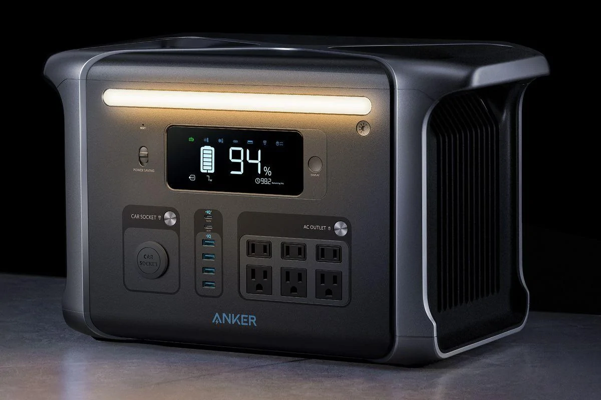

What do you all think of this? I think it would be awesome to camp with!
Six AC, 100W USB-C, 1229Wh LiFePO4 battery
Sean HollisterApr 12, 2022, 4:25pm EDT
Rivian R1T R1S Anker’s biggest battery pack ever is a 43-pound power station with impressive specs Anker___757_PowerHouse___15.0
When the power goes out or you’re visiting the great outdoors with gadgets in tow, you might carry a portable power station — and Anker might have just released the most advanced one yet. The new $1,400 Anker 757 Powerhouseoffers 1500W of power and 1229Wh of capacity from a Lithium Iron Phosphate (LiFePO4) battery, which it promises is faster to charge, longer-lasting, and might even be safer than the lithium-ion battery packs you’ll typically find in the market.
LiFePO4 batteries aren’t anything new in the battery space. You’ll find them in some electric cars because they don’t need to be replaced as often and because they don’t turn into a raging inferno when hundreds or thousands of them are badly damaged in an accident. The downside is weight: most consumer electronics don’t use them because they’re far heavier than lithium-ion at the same capacity. The Anker 757 Powerhouse weighs 43.8 pounds, nearly twice as much as a 1000Wh Jackery power station but with only around 20 percent more capacity. Jackery has a 1500Wh power station that weighs less, too.

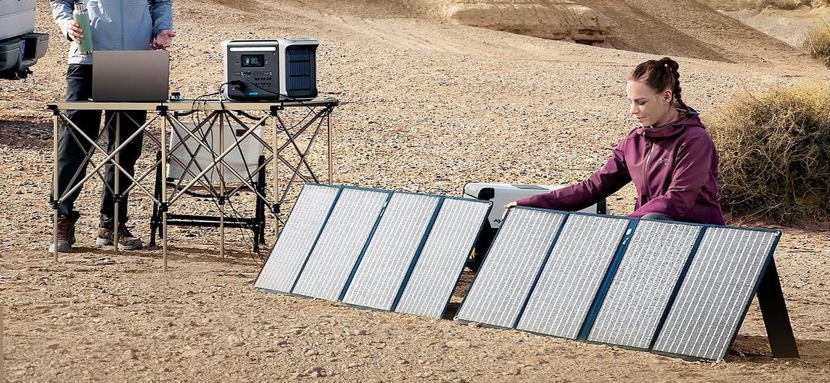

Anker suggests its battery may be faster to charge from the sun than most, too — it’s able to get to 80 percent in just 3.6 hours with a 300W, triple-solar-panel array Anker will be selling for an undisclosed price soon. TechRadar writes that the Bluetti can technically charge in under three hours from 700W worth of panels, and CTECHi says its battery takes nine hours to fully charge from a set of 500W panels, though both allow you to combine solar and a plug if you need to top up faster.
Rivian R1T R1S Anker’s biggest battery pack ever is a 43-pound power station with impressive specs Anker___757_PowerHouse___06
You need a bunch of solar panels to truly charge a battery this size.Image: Anker
