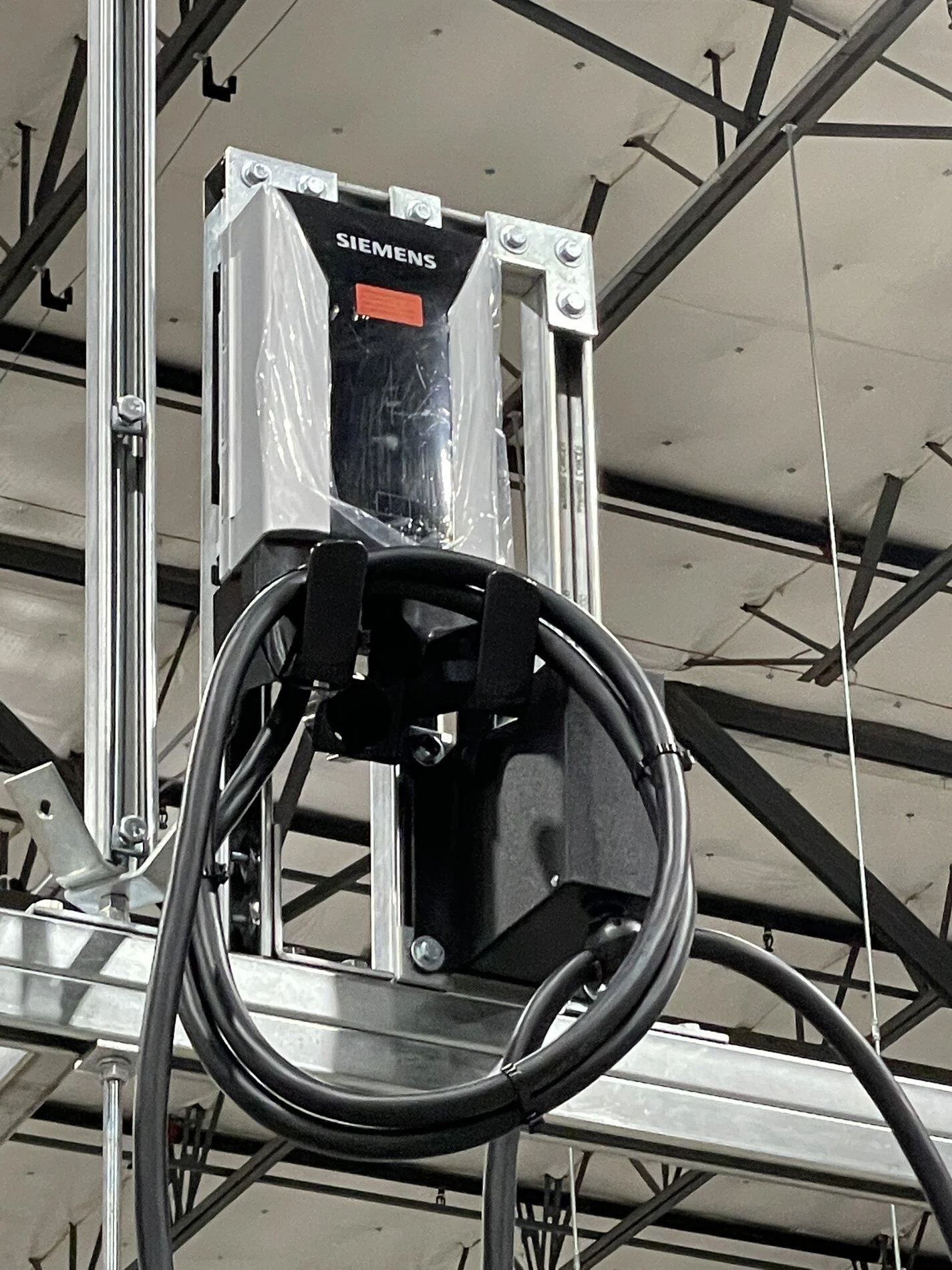

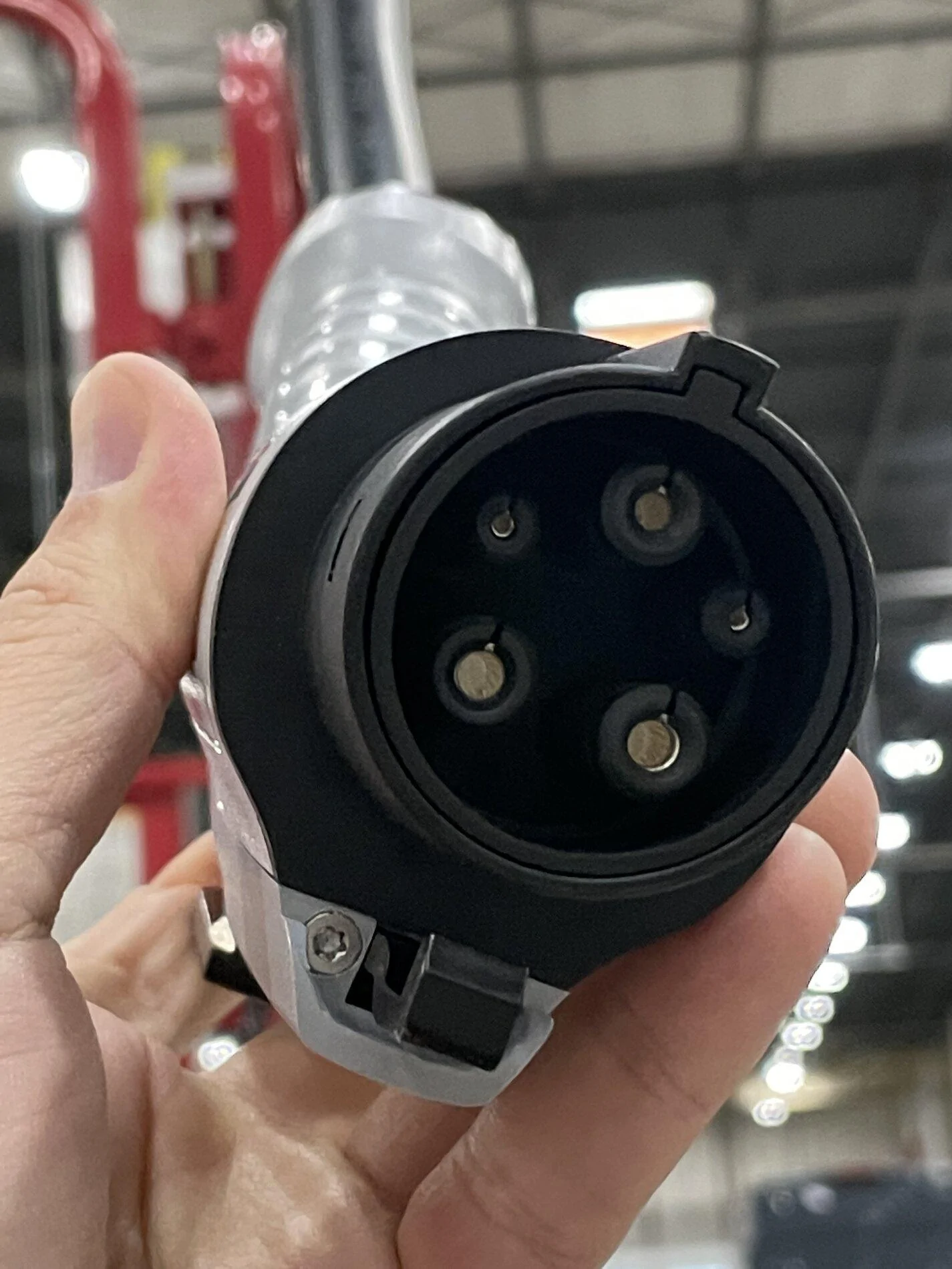

I saw this evening what is going to be the charger for the new Rivian Delivery vans at an Amazon delivery station. I am no expert when it comes to the different options to charge an EV, nor I own or have owned an EV. My LG R1T will be my first EV. So having said all that, what do you expert fellow Rivian future owners think about this charger? Is is better, worse, more or less powerful than the Rivian charger? After a quick Google search I think this it's a Siemens VersiCharge commercial unit.

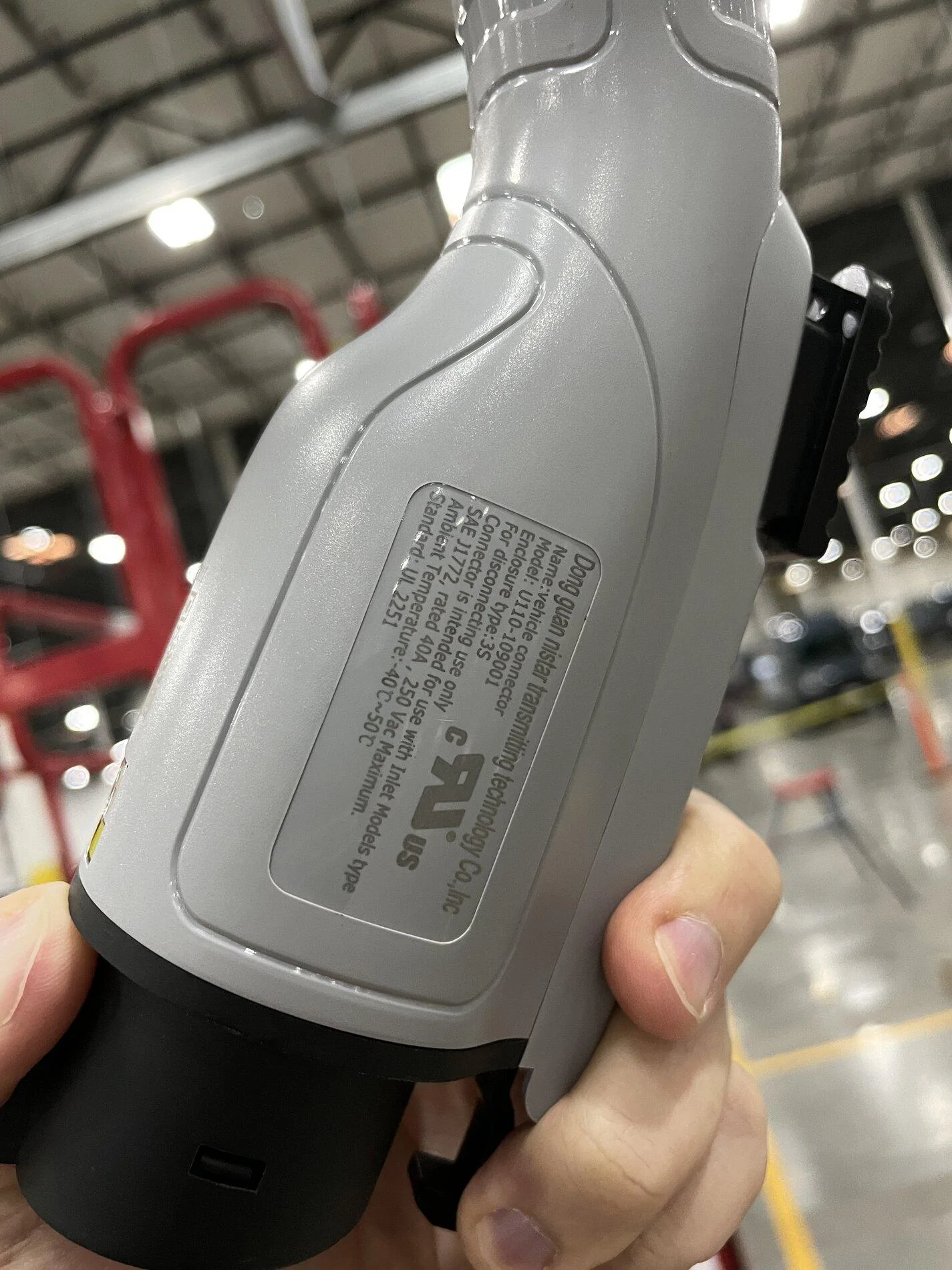

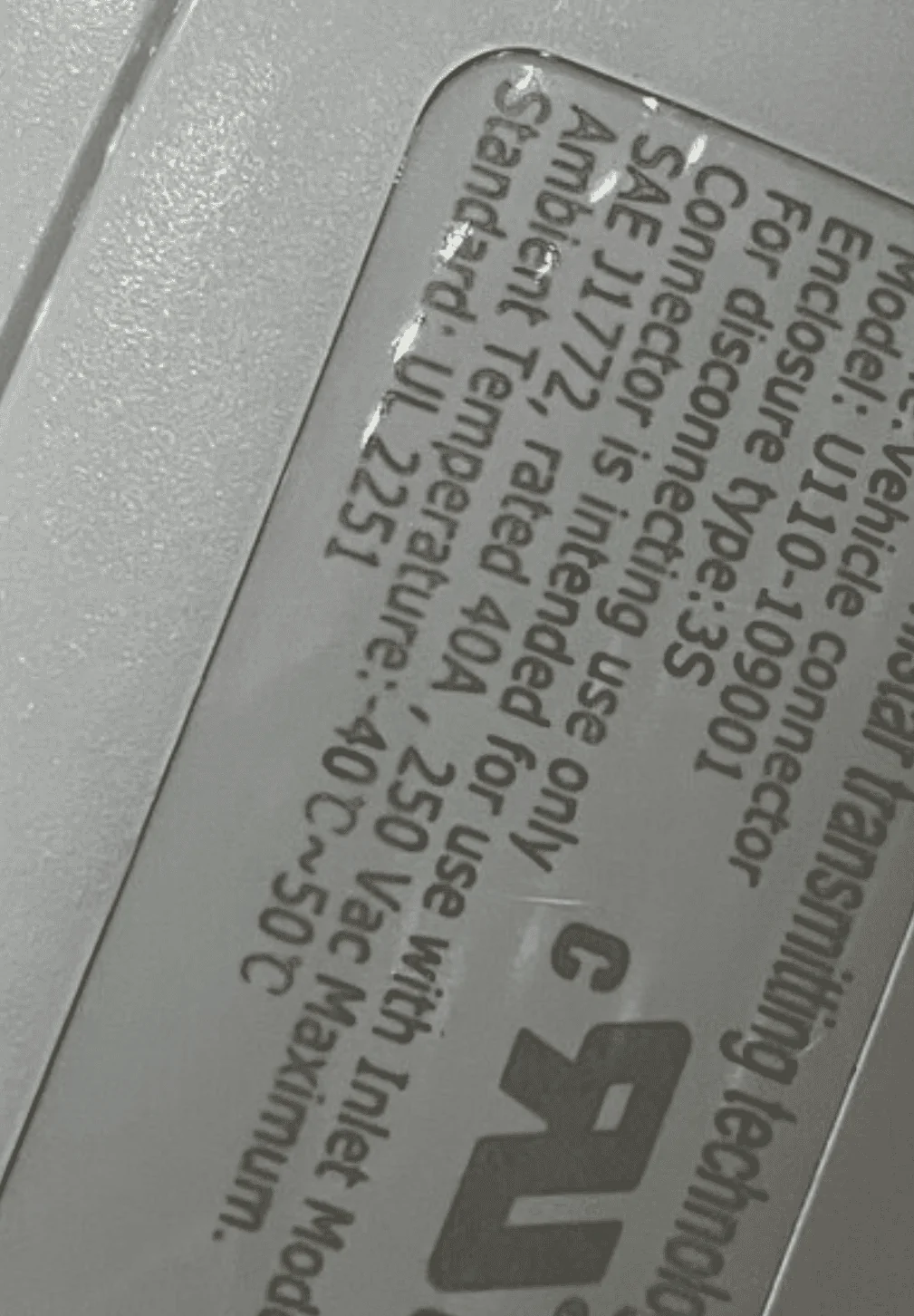

According to your 3rd picture, that charger maxes out at 40 amp.
That is faster than the charger that comes with the R1T/R1S (32A), but slower than the optional $500 hardwired charger that Rivian sells (48A).
Nothing terribly special, they're most likely planning to have a charger for each truck and leave them plugged in overnight. Siemens also sells a home version

That's a J1772 plug good for up to 80A if installed on a 100A circuit. You would only be able to charge your R1T or Tesla up to 48A with it but if the van has an 80A charger this EVSE will feed it.

This particular plug is only rated for 40A
Rivian R1T R1S Amazon Rivian Delivery Van Charger 1633727338565
The J1772 standard allows for up to 80A, but this unit maxes at 40A

Indeed it is! Should have checked the fine print.
