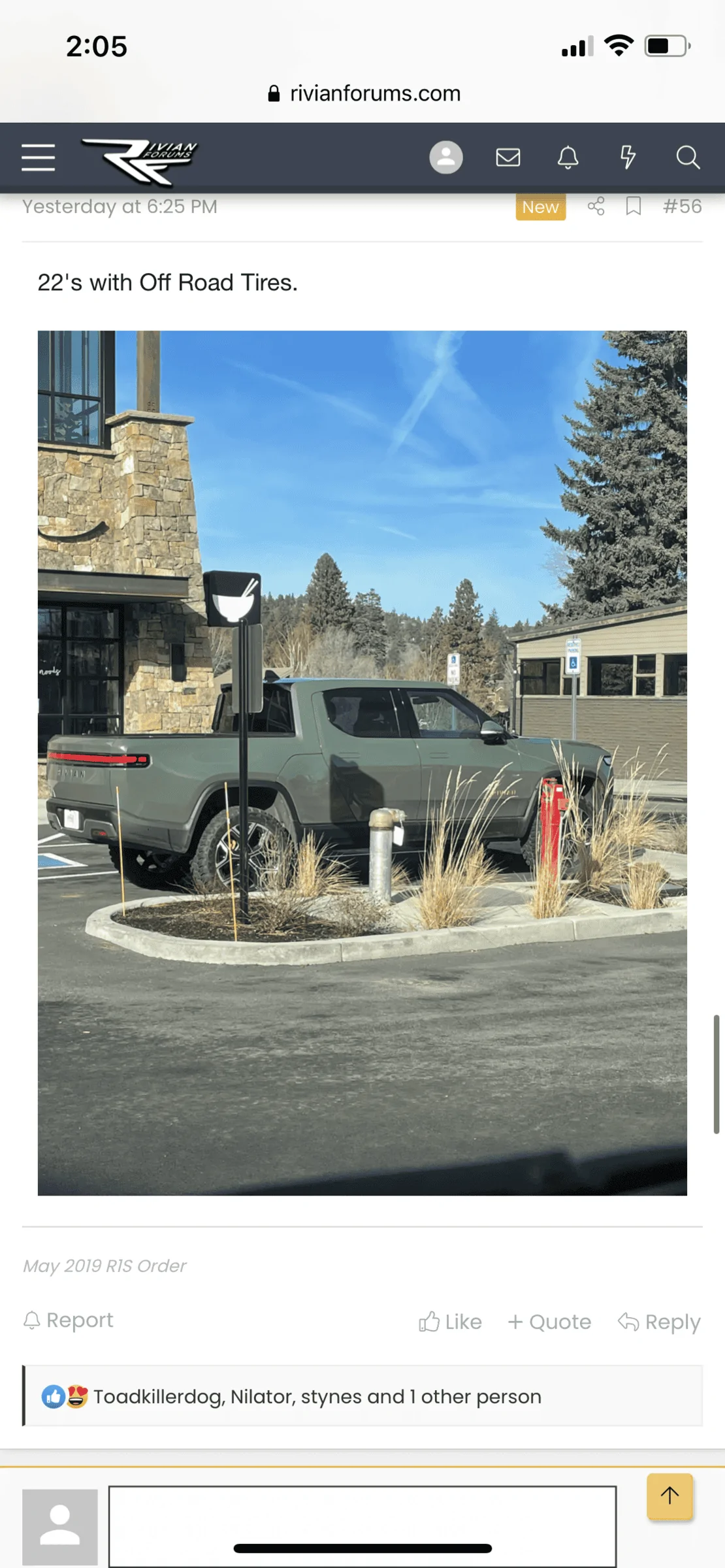

This was on a thread somewhere……
Rivian R1T R1S All Terrain Tires on 22" Wheels? FC54F7EF-E0FE-4FA0-A14A-9AC288EC0110
