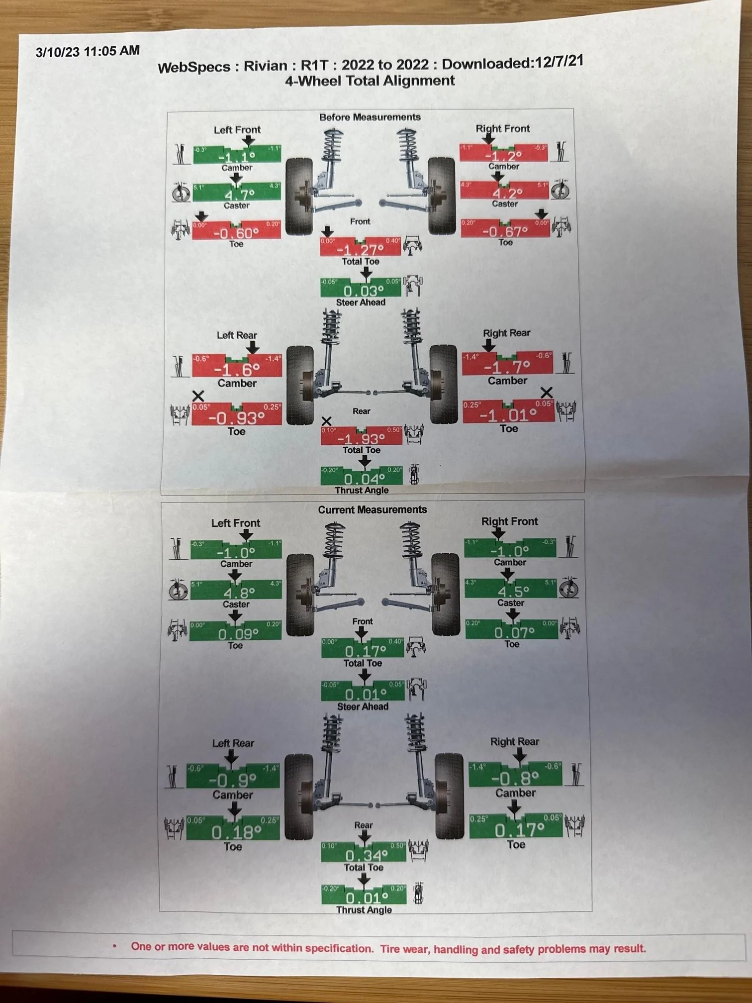

post your alignment sheet if you can. the "violent shaking" sounds like a problem, perhaps something is not torqued properly. this is where words fail us because it is really difficult to fully describe symptoms like this, really need a test drive to understand the problem.
Here are the results they gave me from the first alignment. I should have asked for the same thing on the second....
Hard to say based on the alignment alone without confirming there are no other mechanical issues, but with the amount of cross caster (and with the right side being less than the left), I'm not surprised the truck was pulling right but got a little better after the initial alignment. And the original toe was pretty far out of spec in a way that would not contribute to a stable steering feel (toe out, front and rear). That amount of toe would also chew through tires more quickly relative to a proper alignment. Camber is still a little high, not what I would consider problematic, but reducing it a little might make the vehicle feel a tad more stable. I still don't believe the shaking is normal or attributable to the alignment, regardless of how bad it was from the factory, and could be a sign of a bigger suspension problem.
Would be interesting to know if 1st alignment "after" was identical to 2nd alignment "before" or if alignment specs had changed in between (indicating a suspension problem).

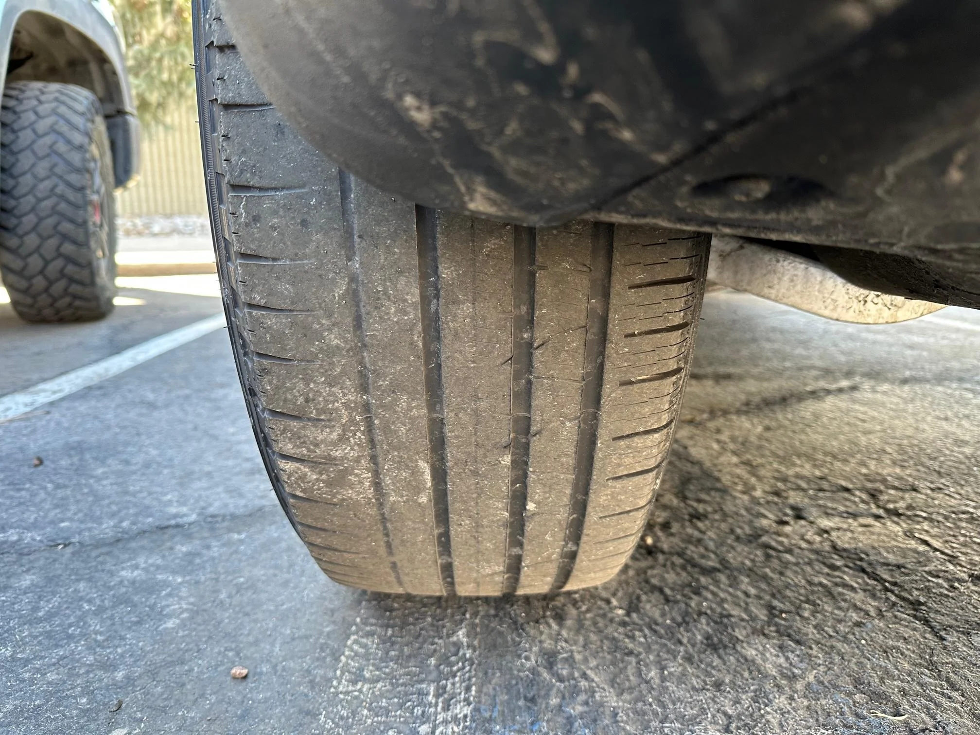

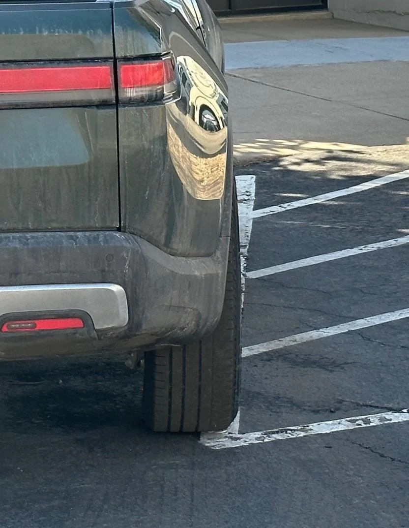

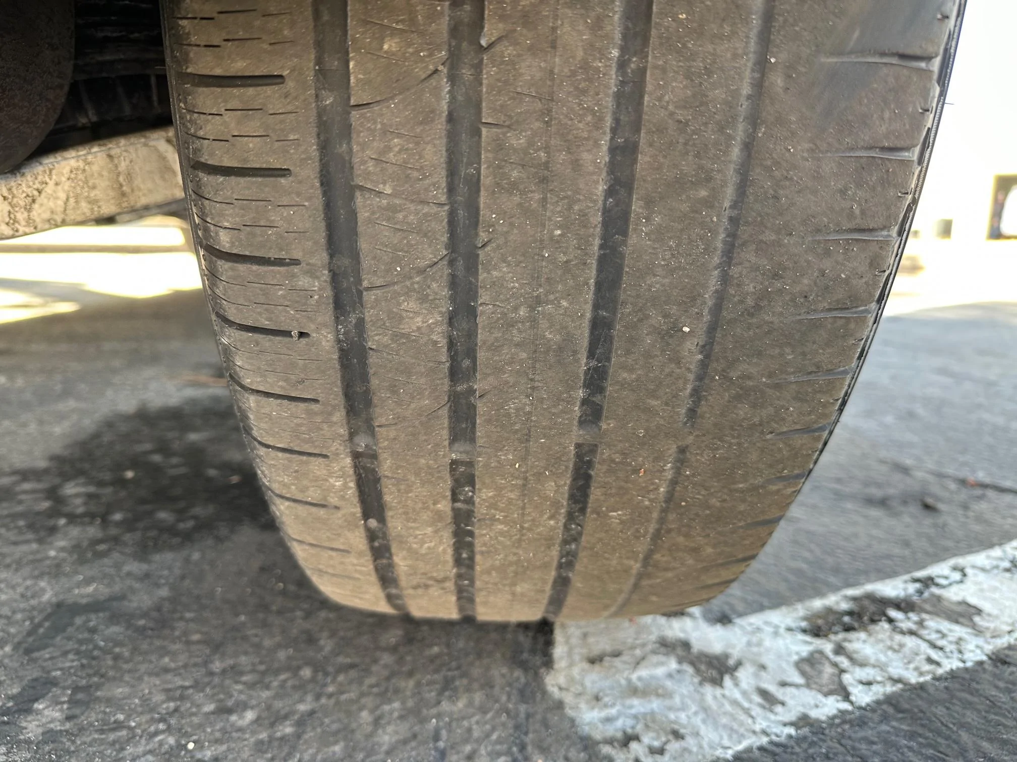

Update 4/6:
While showing off my truck to a few coworkers, one noticed my rear tires are half bald. 2,400 miles on it. 2 alignments. This could be my issue with the off center wheel, drifting, 0 traction on just a tiny amount of snow and slush, and violent shaking side to side hitting bumps... Another ticket submitted...

Your alignment is borked. I just got my truck back from the 4th, and successful, attempt at alignment, which required the intervention of a corporate expert on the topic.
There are 3+ reasons why you are having such a hard time with the alignment:
1) The tech they keep putting on your truck to align it is simply not able to do the job. Apparently, the alignment racks are a little tricky.
2) You have a borked suspension component somewhere, which will require inspection to eliminate as a cause
3) You have a borked subframe - front or rear - that needs to be addressed. This is apparently more common than we thought (still a small percentage of trucks, but non-zero).
I’d get Service on the phone, have them walk you through every possible source of alignment problems, and get it in to get it dealt with.
Like I said - it took them 4 tries to get it right, and then it was only due to having an in-house corporate tech (“roaming expert”) that they finally got it pretty much right.
