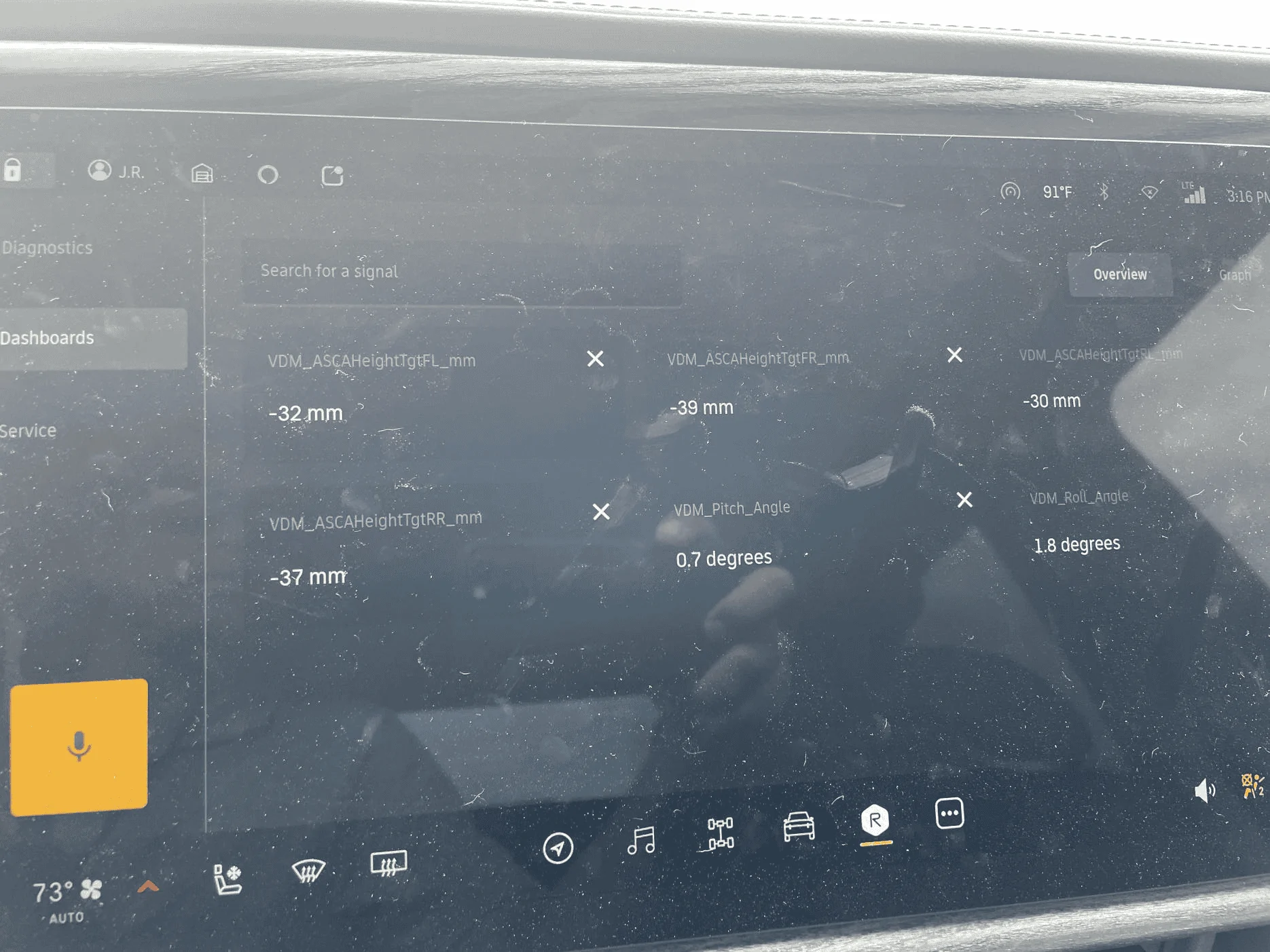

I'm in the same boat. Been in and out of SC because alignment is crazy since the first time they returned it. Looking at the suspension values and the roll angle, it seems as if it is leaning into any grade in the road. I assume this would cause the pull to the right to happen, and the actual behavior should be the opposite (lift the side that is canted so that it seems level and straight), unless turning.
