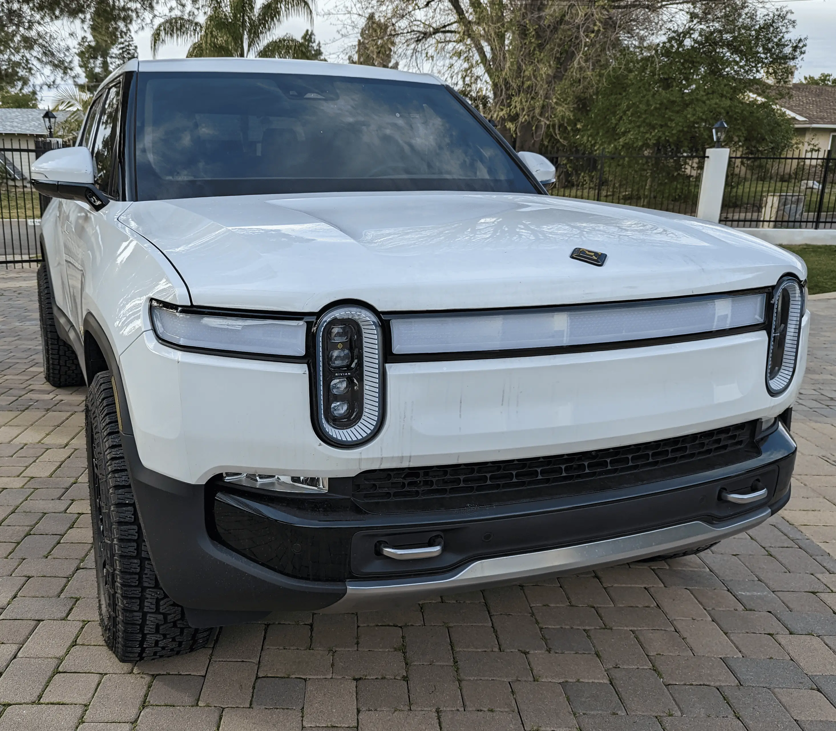

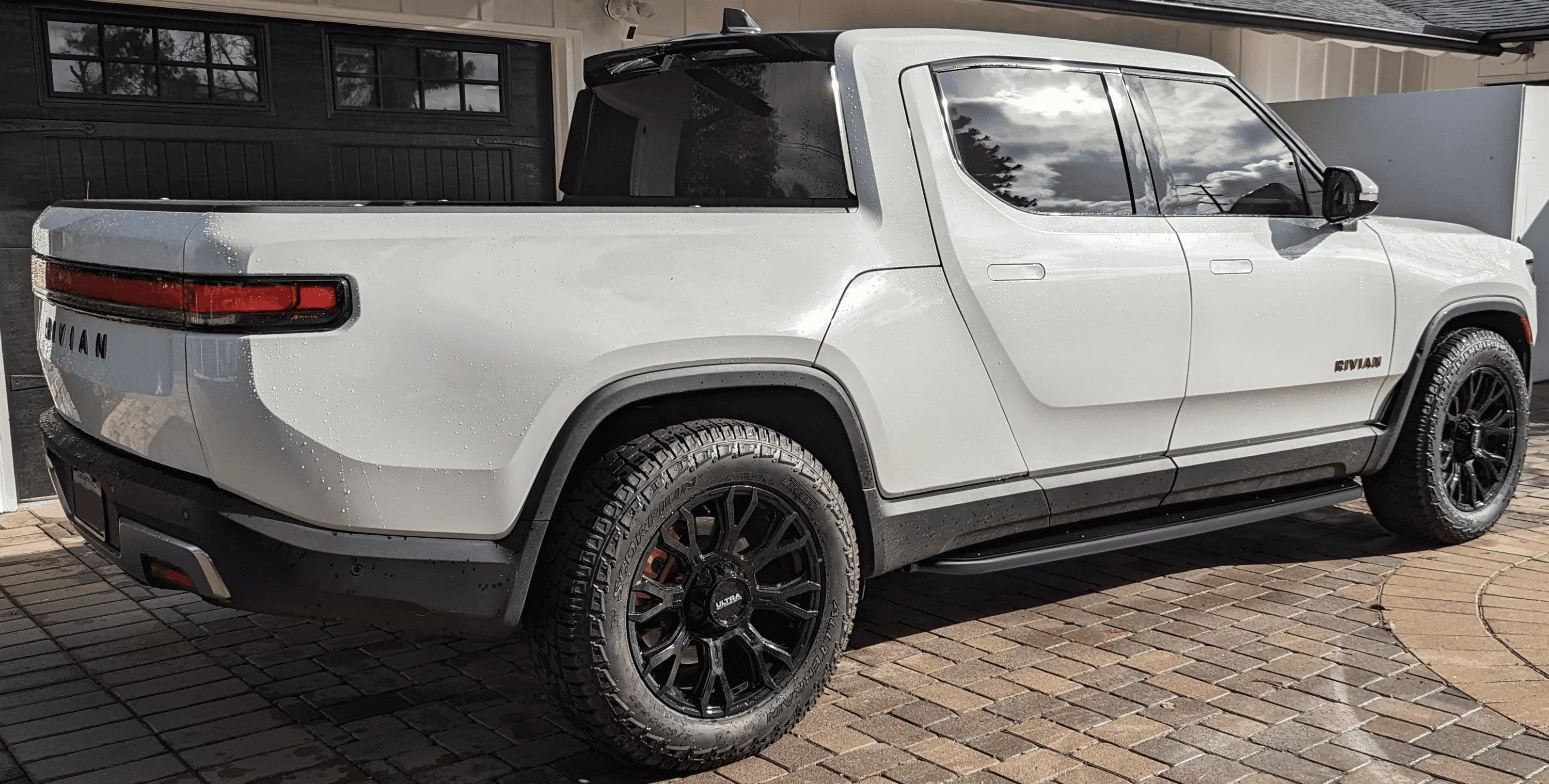

Not sure which wheel you were referring to, but with Rivian's air suspension and the fact that it can lower itself, need to be careful about having them stick out too much. I have a thread in this forum where I spent a ton of time trying different wheel sizes and offsets. Found that -18MM was the most I could get. Reminder that lower offset numbers mean they stick out further. At 18mm, I'm right at the edge. I tried a little more on a different wheel and they rubbed. 18mm was the most I could go without rubbing them. So my recommendation is to get a wheel with 18mm or less offset (meaning a higher number). 17mm, 15mm, 10mm, 1mm as I think the OP used, stick out way too much and will rub the fenders.
This is where I'm at with 18mm....

Correct, my wheels at +18MM offset, stick out toward the fenders by 30mm from the stock wheels with +48mm offset.

I have no rubbing issues with my current set up, as shown above. 20x9 wheels with 18mm offset. Down one tire size to 275/60/20. I am right at the limit. Another millimeter on offset and they'd likely rub a little. Bigger tire size and they'd likely rub. After 5 different sets / wheel / tire combinations, this was what I landed on as the best fitment for my tastes and no rubbing.
