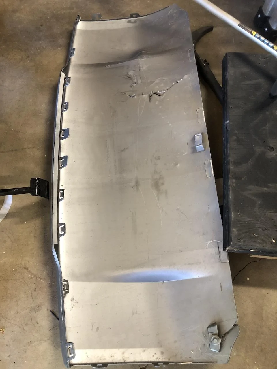

So I was off-roading the other day and approached a rock shelf that was just a bit too high… that silver front skid plate got a nice dent and some scratches and even a small hole. It is surprisingly thin plastic and doesn’t provide much protection for whatever is behind it, so it seems like a great opportunity for an aftermarket product. Has anyone thought about it?
Also curious if anyone has made a similar boo-boo and approached an obstacle that is just a wee bit too tall just wee bit too quick? I have a service ticket in to find out what an OEM trim piece costs, and how much it might be for them to install. I also tore some of the plastic holes on the front of the wheel well as the skid plate pushed back.
I’d love to try something stronger out and even better if there is a potential aftermarket winch mount, but the market is probably too small and immature, unfortunately.
On the bright side, this truck was amazing at tackling a trail rated 7/10 and kept doing things with ease that I didn’t initially think it could do. I didn’t even notice this happened until after a wash with all the mud we went through.

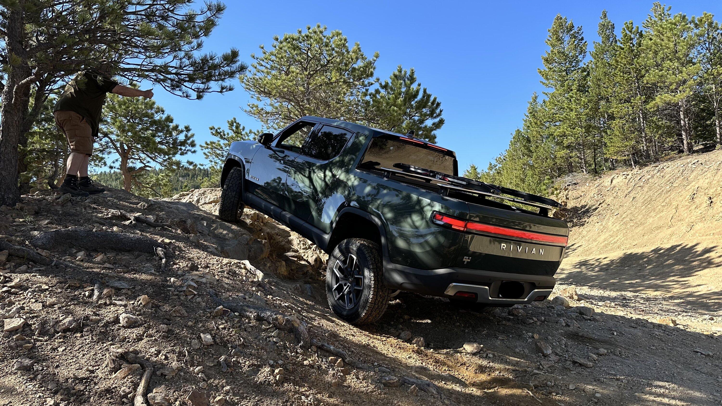

I'd be in for a proper skid plate. I managed to put a few scratches in mine while trying to climb a rock wall along with almost tearing off that little aero bit in front of the tire. What trail were you on, out of curiosity?

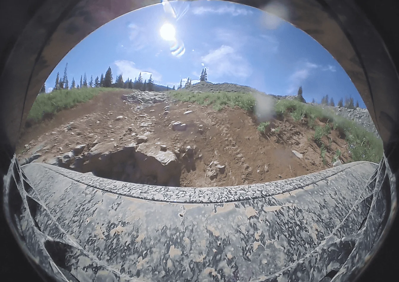

Pretty sure it was this pointy rock right here. It looked totally doable, but there was a bit of a hole in front of it that was hard to see in shadow. Pretty much went right over it, but I remember a bump that felt like plastic being squished though...
Rivian R1T R1S Aftermarket Front Metal Skid Plate Needed? Screen Shot 2023-07-29 at 12.13.50 PM
(Does anyone else wish there were more keyframes in the Rivian's video files??)

The silver is very much plastic. Here’s what they look like when met with a stiff bush.
I have metal skid plates for the front and rear subframe/driveunits in development. These bumper ones will be a bit more in depth, and likely req a full replacement bumper. Working on the details.
