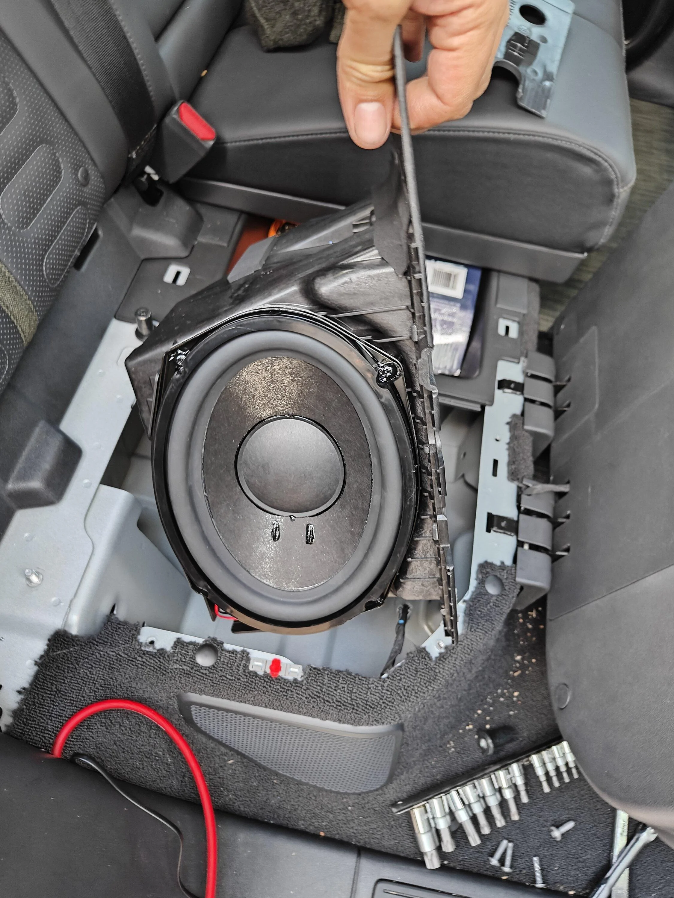

I've had my R1T for a few months now, and as many have noticed the subwoofer performance is subpar in the in-house audio setup. I had really hoped to see an OTA update with a subwoofer gain added to the EQ, but got tired of waiting and decided to experiment with upgrading the factory 6X9 Subwoofer.
There are not really many options for a 6X9 Sub, but I decided to 1st experiment with a Rockville RVL69W 150W/300W "subwoofer". Not sure I really consider it a subwoofer, but figure for the price I'd give it a shot.

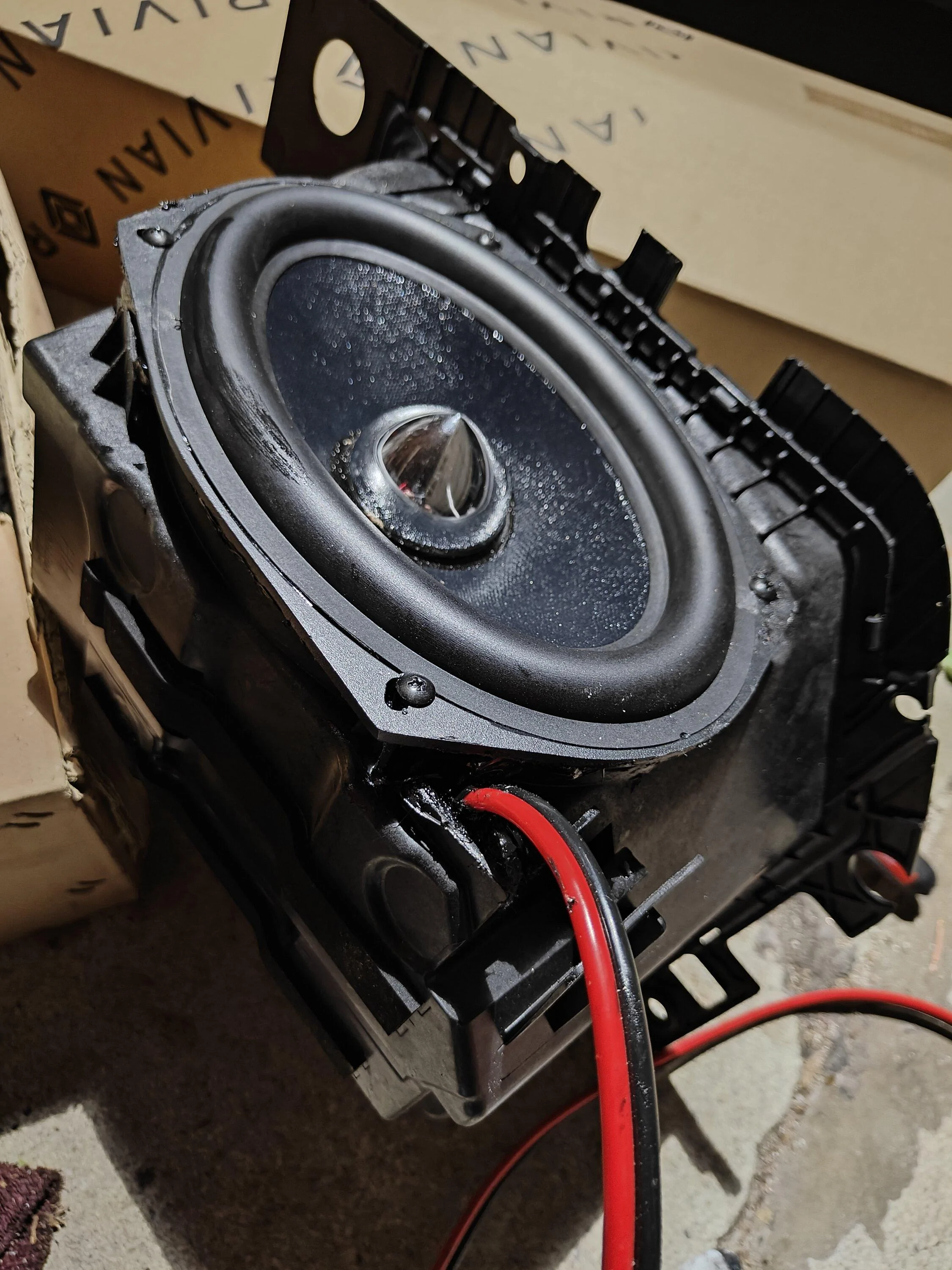

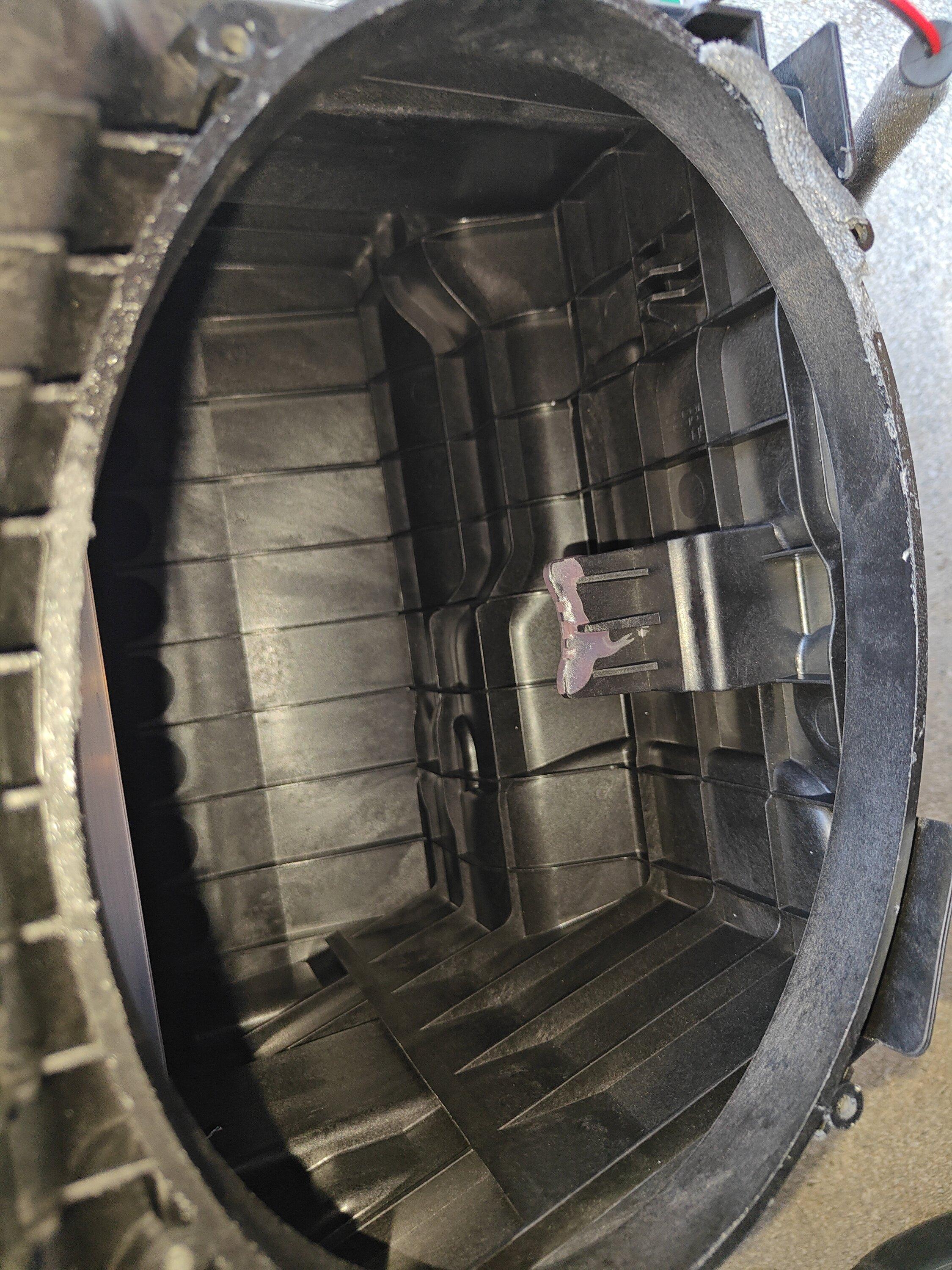

I was able to get the RVL69W to fit in the factory box with some finessing.

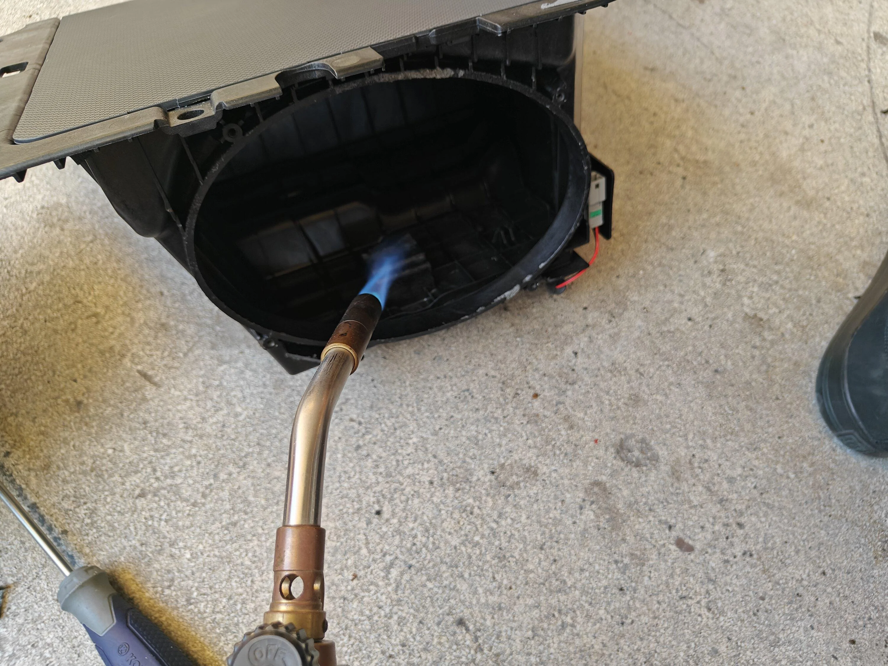

Inner tab needs to be cut, and box needs to be heated an press downwards:
Rivian R1T R1S Aftermarket 6X9 subwoofer experiment in a 2023 R1T IMG20240208164440
Rivian R1T R1S Aftermarket 6X9 subwoofer experiment in a 2023 R1T IMG20240208165300

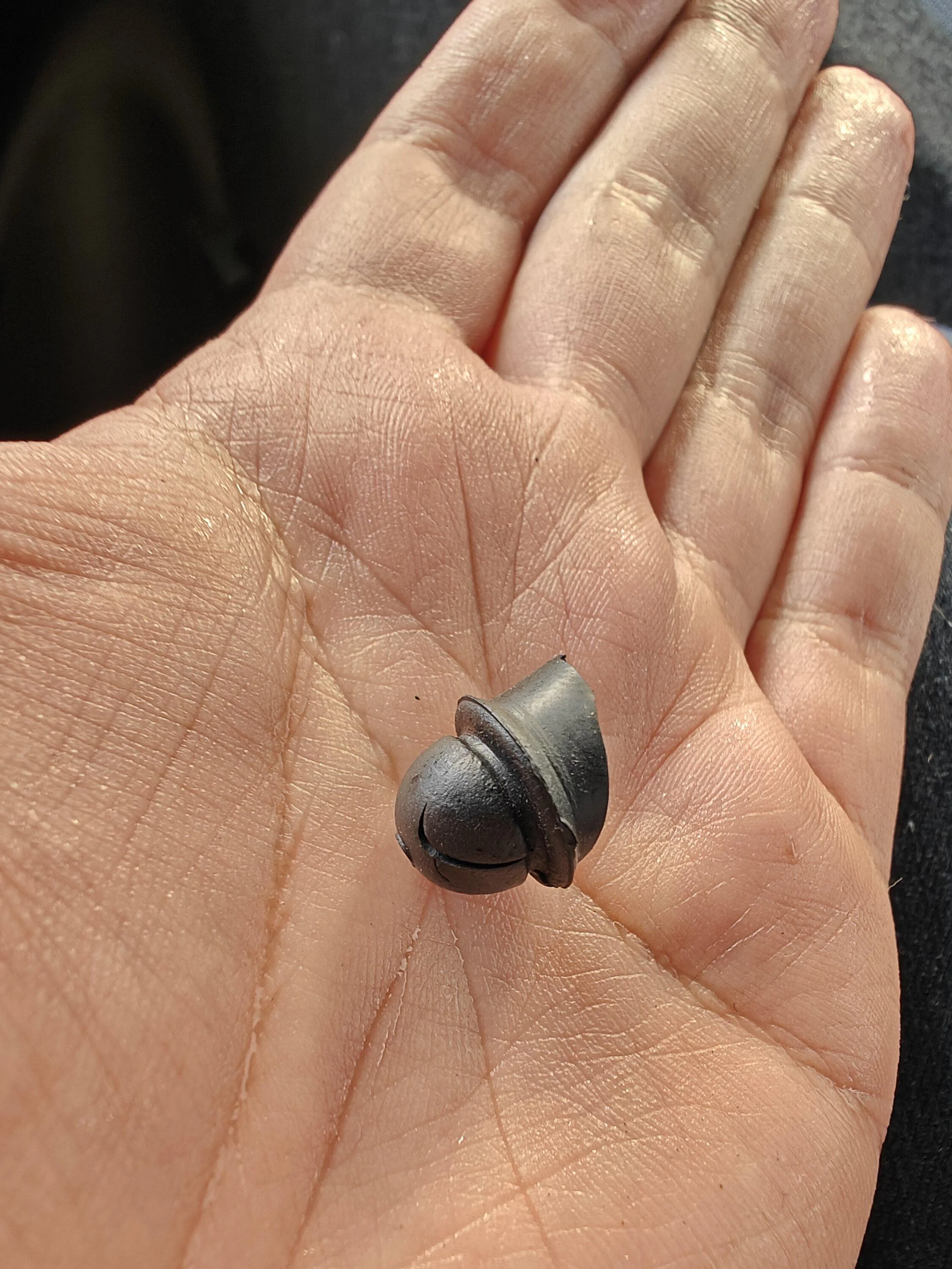

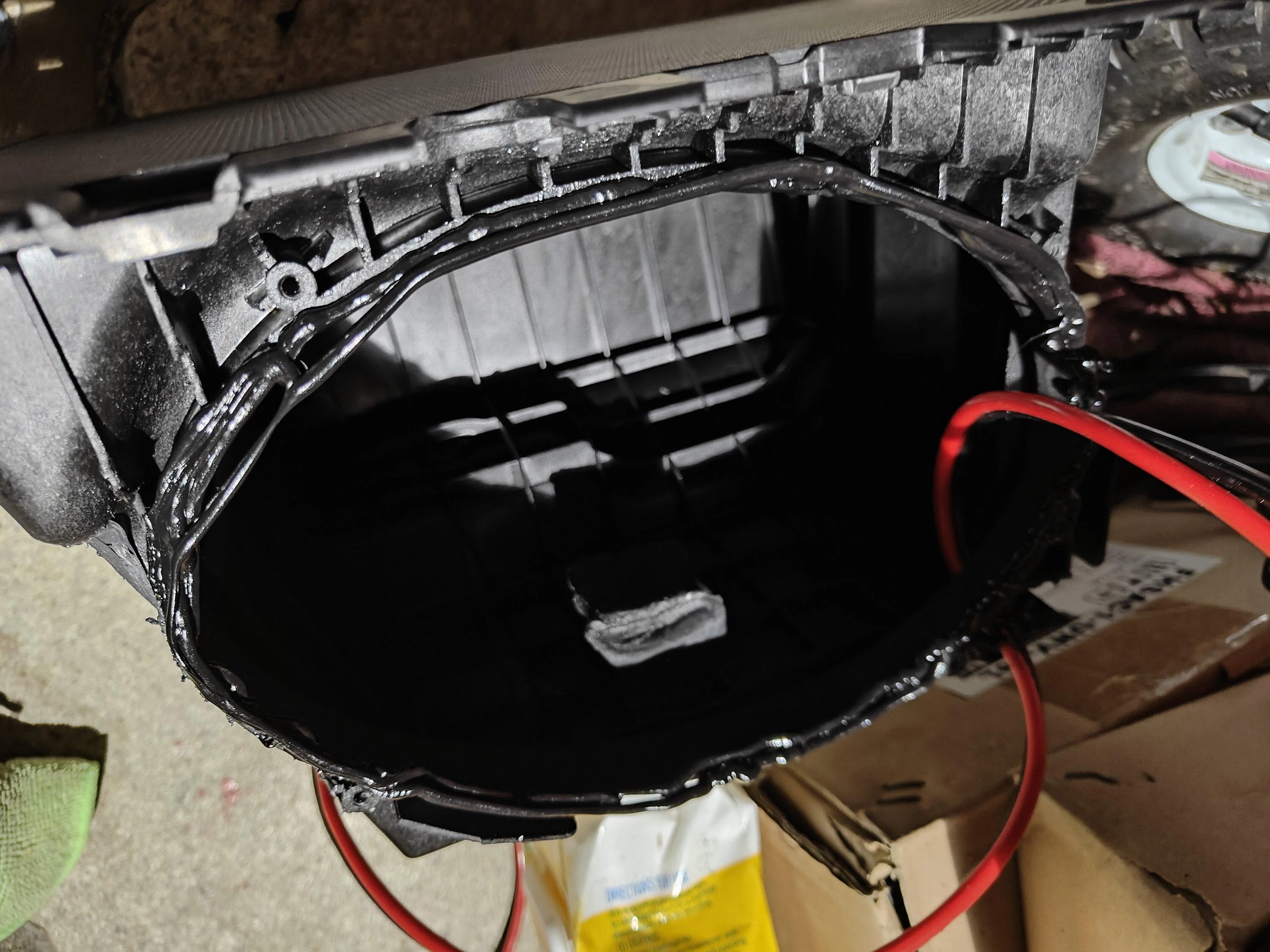

Subwoofer fitment was also off in which the OEM box is slightly more narrow than the RVL69W speaker, so I also had to heat the oval edge to get the speaker to sit inside. I had to grind two of the speaker holes to align with the OEM box. and then used some urethane caulking to seal the speaker to the enclosure.

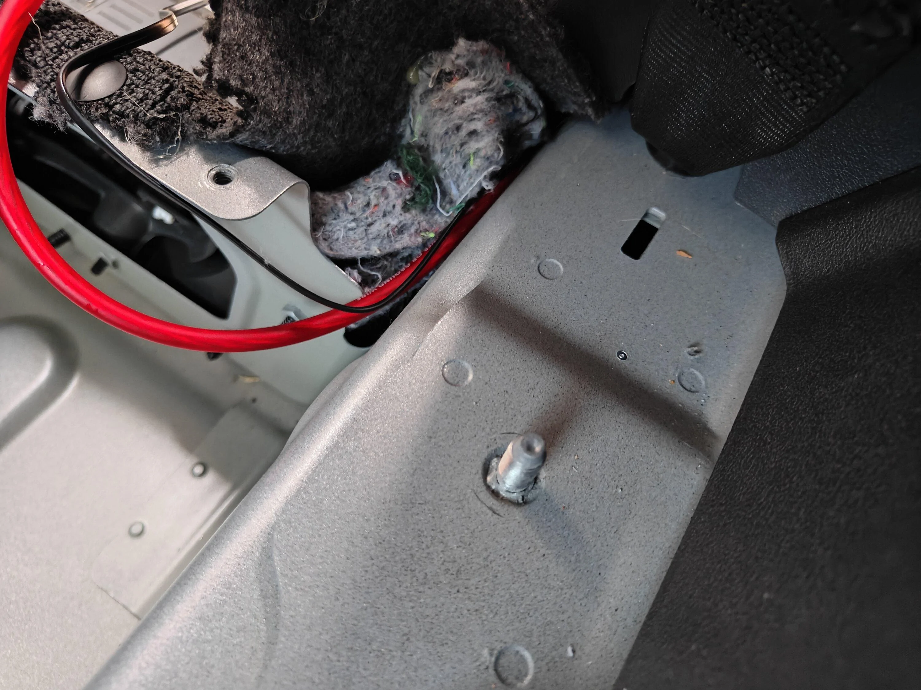

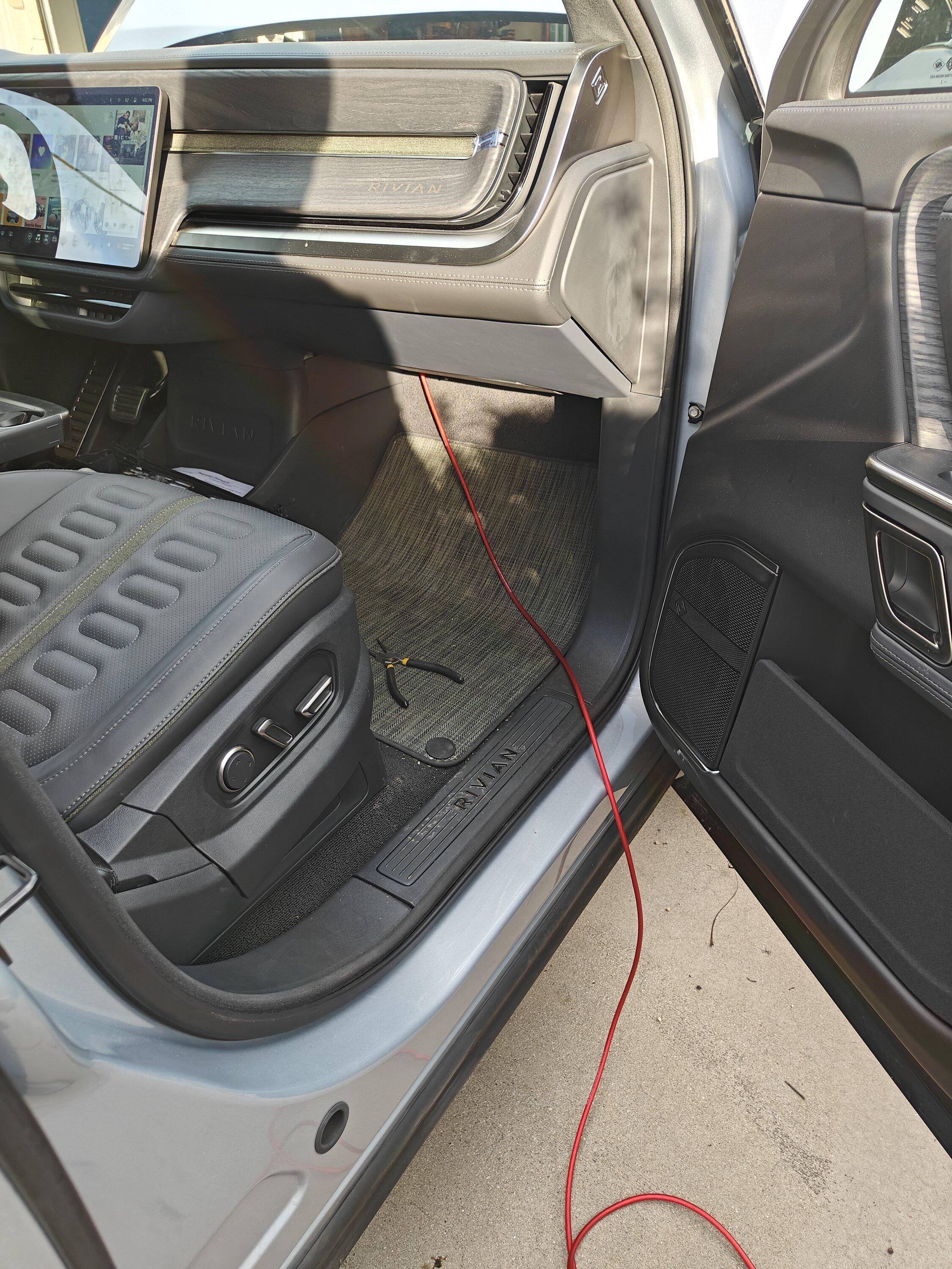

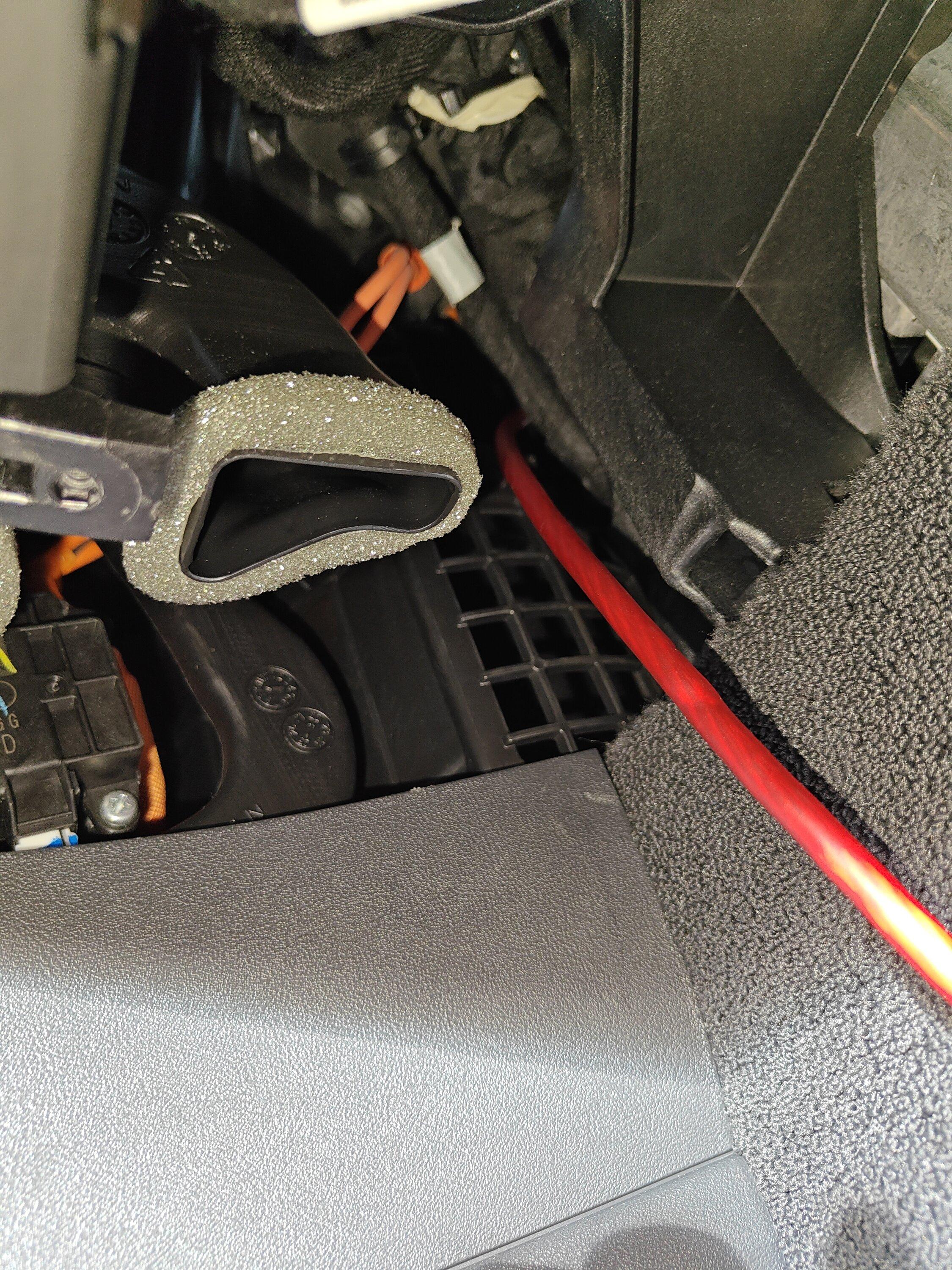

Routing power was pretty straight forward, used a grommet on the firewall to route the cable. Trick for me was to pull out the grommet itself, and cut the end off to allow me to feed the wire:

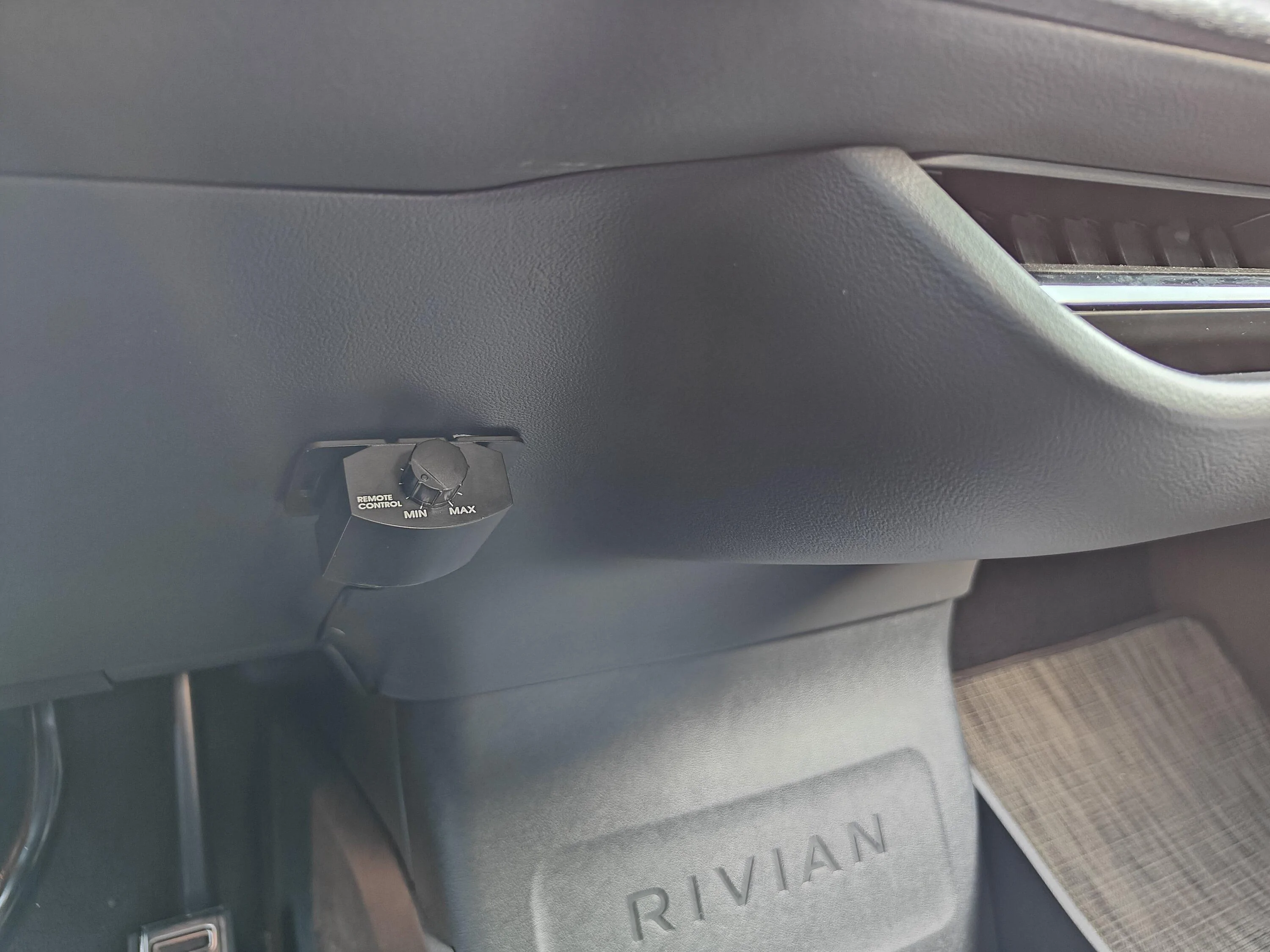

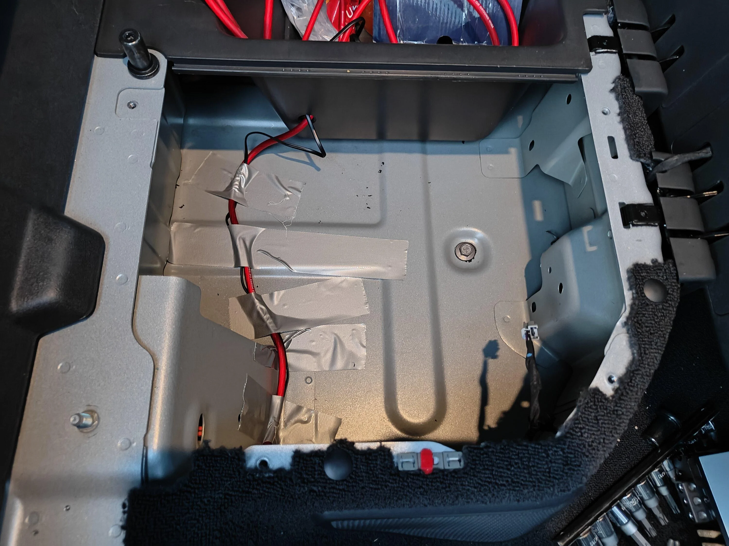

I used a soundstream PN1.650D mono 650W amp, factory sub wiring feeding the high input.
Sub is mounted in the storage area, and remote mounted by the driver side knee area.

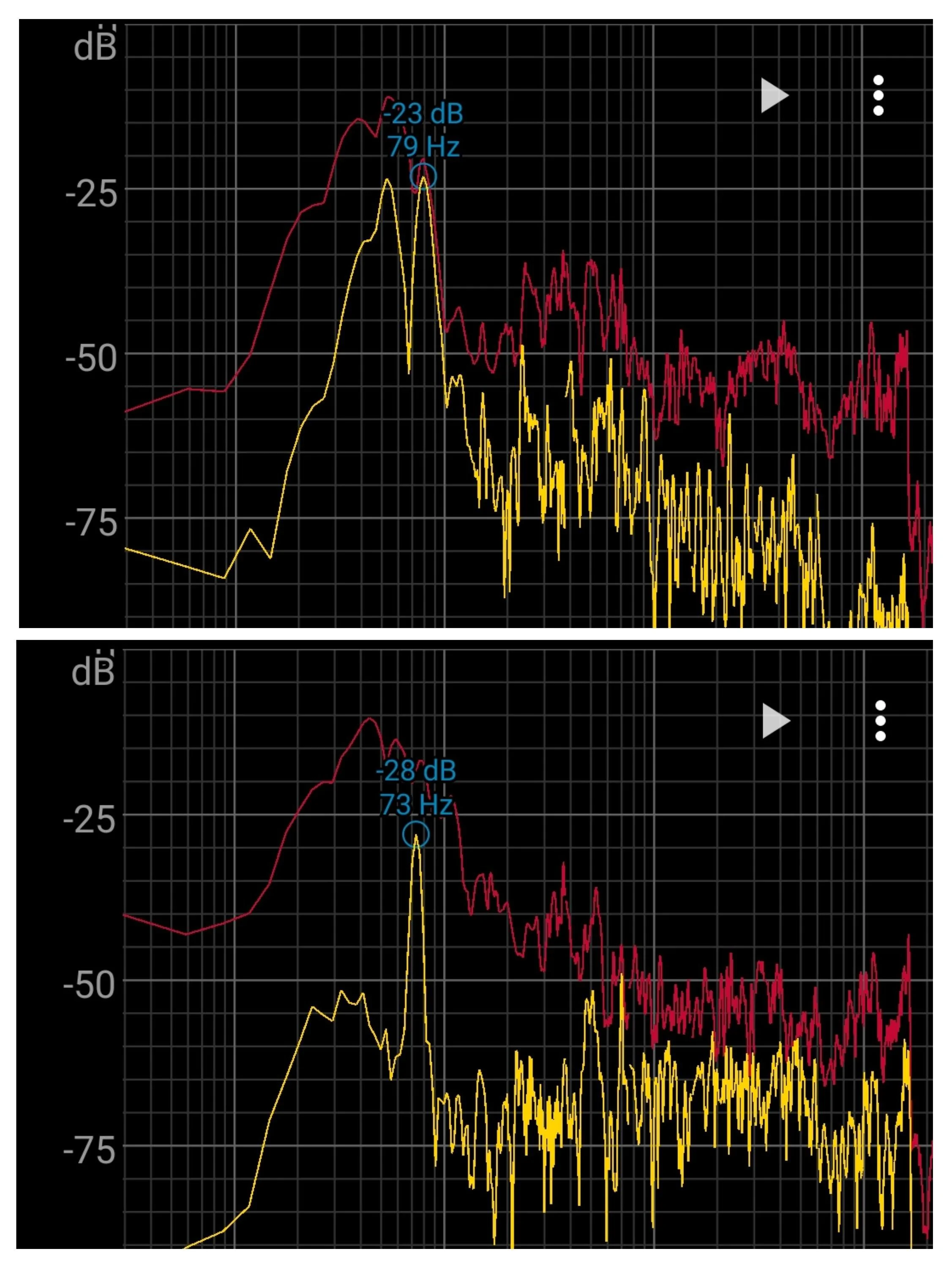

Overall I am pleased with the results, low end bass is definitively better at least 2X from the factory but its not as crisp as a 10 sub. I suspect some of that has to do with the limitations of the factory box.
I should have done a 150-20Hz sweep before and after, but didn't think of that until after. I did play a 15 second clip from Big Tymers - Still Fly 2:45 to 3:00 as the base hit at 2:53 is one of the more memorable ones I could recall in a song.
Rivian R1T R1S Aftermarket 6X9 subwoofer experiment in a 2023 R1T 20240209_105342-COLLAGE
Top is factory, bottom is RVL69W, you can see from about 110Hz picks up a few DB, an carries nicely in the low 10-40Hz range. This is same EQ settings base at 0, sub gain slightly higher so that the song sounds good to my personal ear (not maxed out) and volume at 15.
Increasing the sub volume, even without distortion cause all kinds of rattles within the car and just doesn't sound good. I just wanted something slightly better than stock. At least something comparable to my previous 2018 Model 3, and this setup meets and exceeds that goal. Bass hits much stronger than my model 3 ever did.
I regret not experiment with getting a smaller amp and trying to use the factory subwoofer, not sure what the results would have been but would have been interesting.

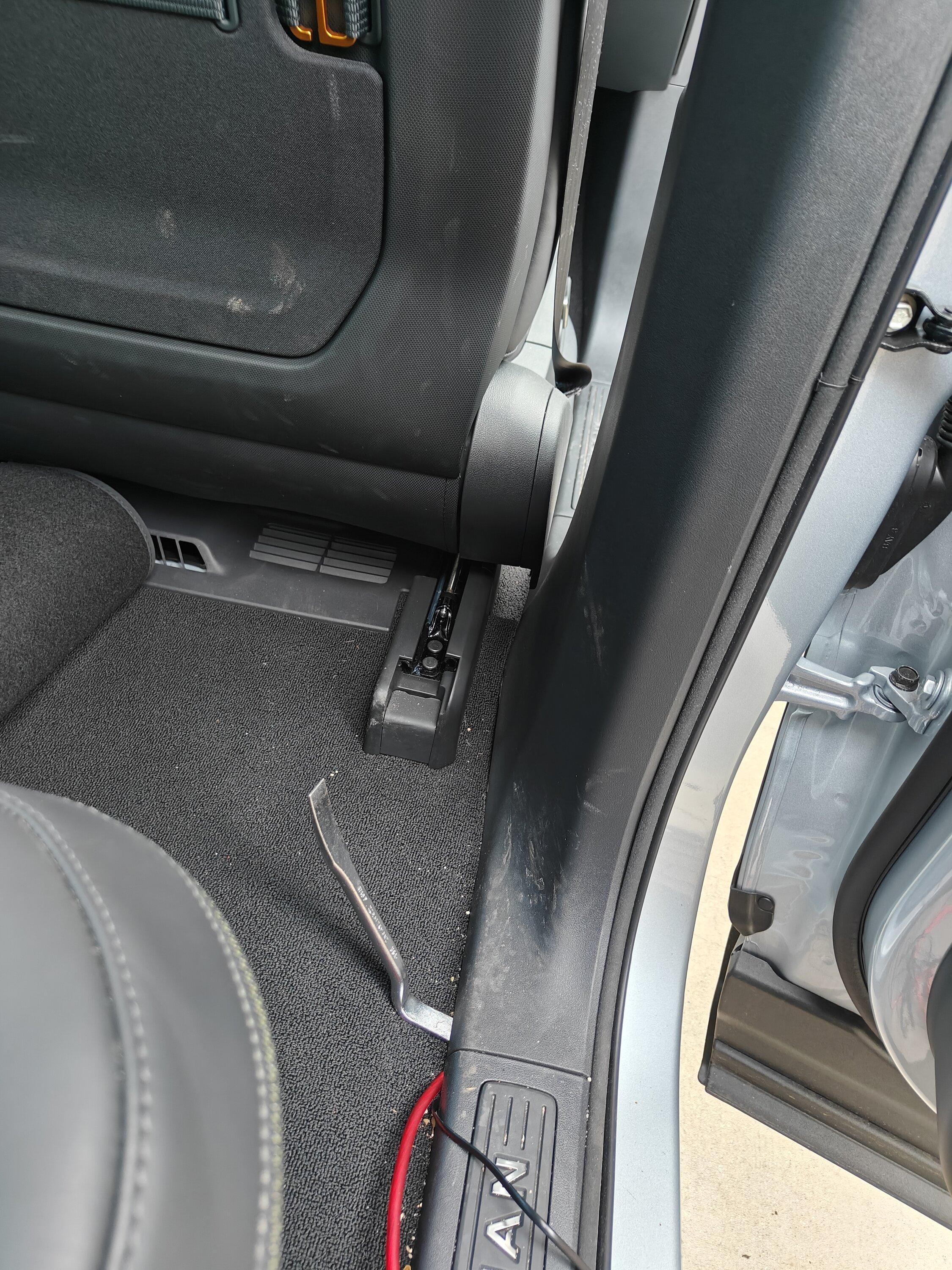

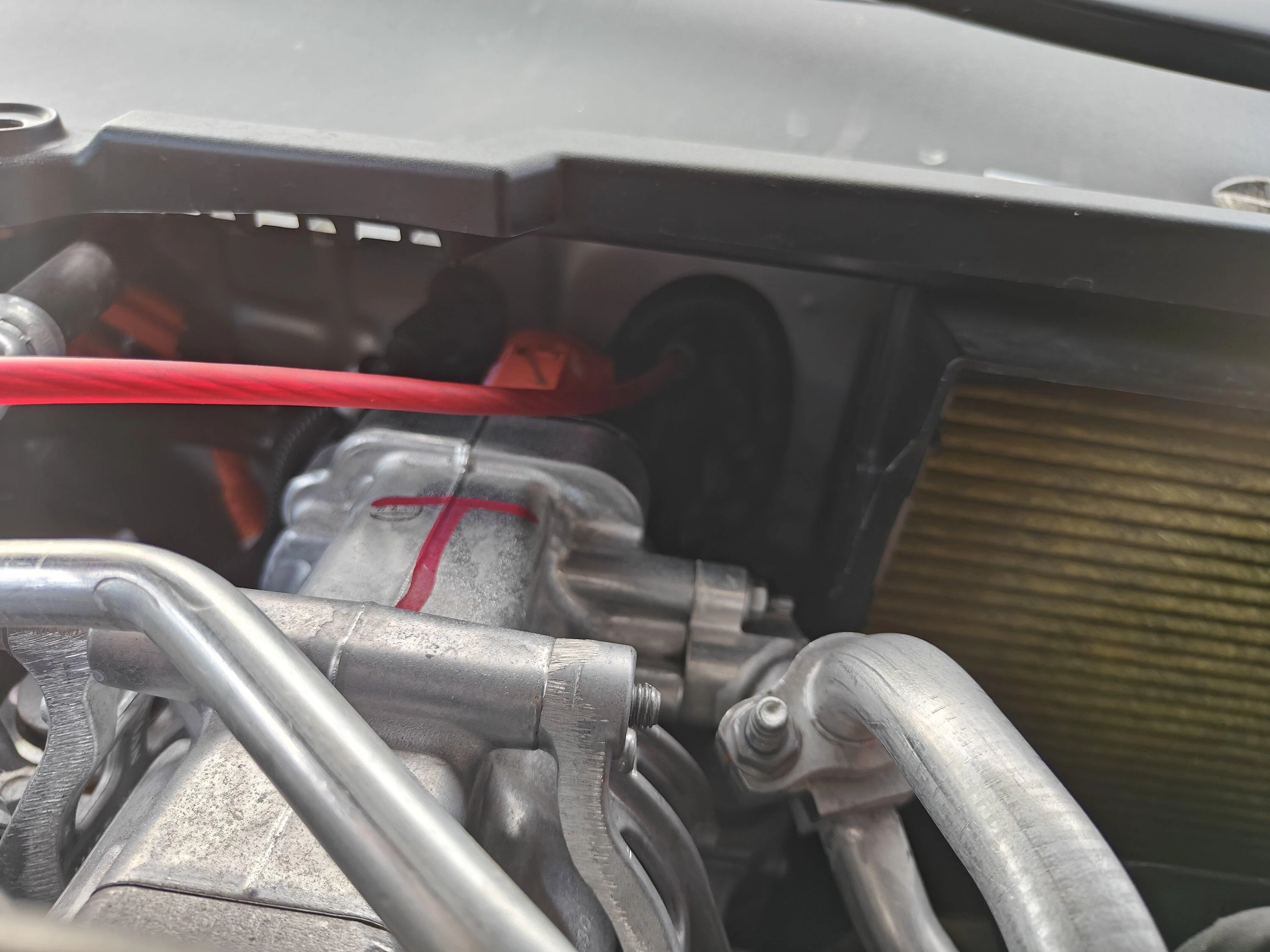

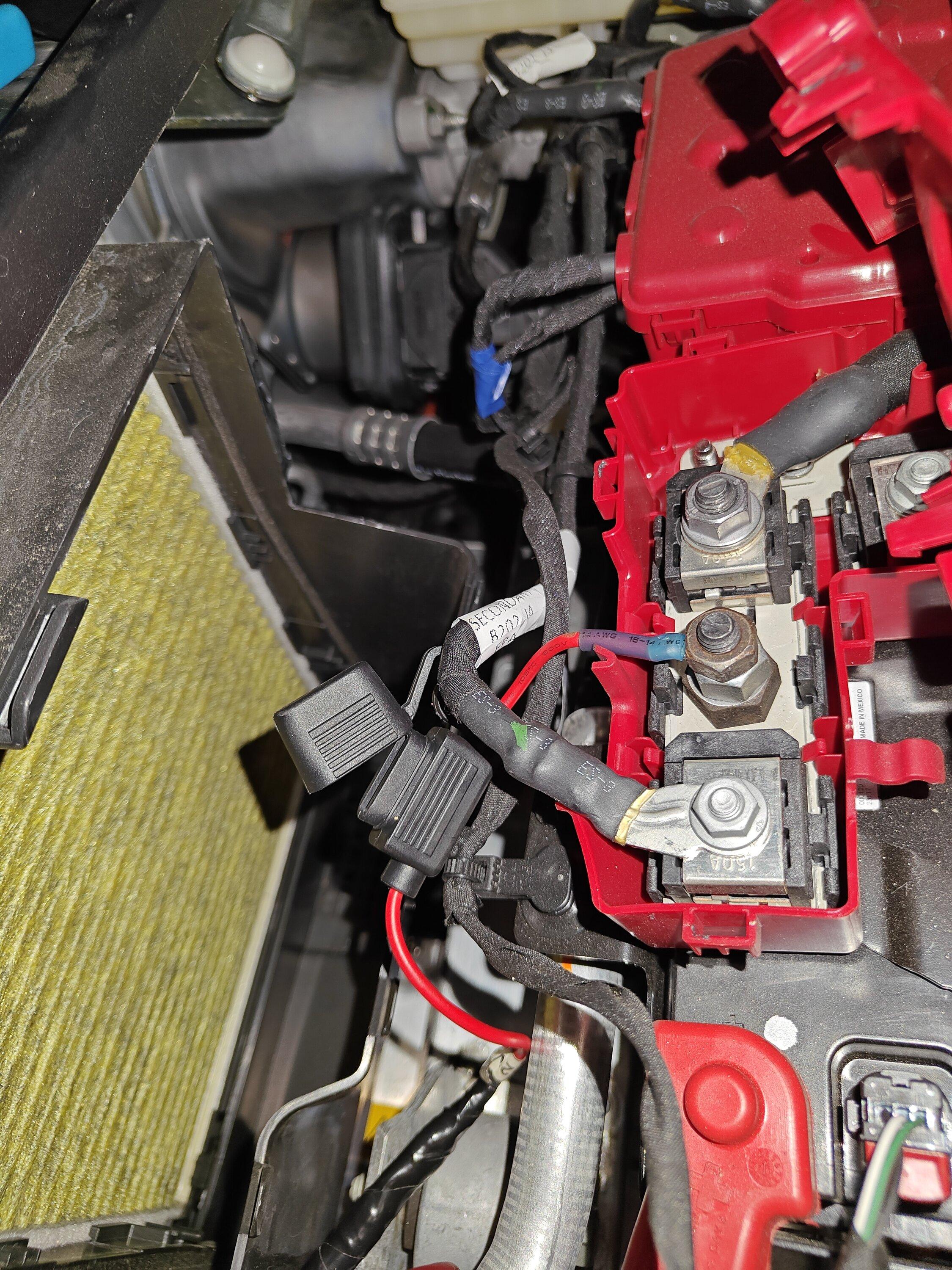

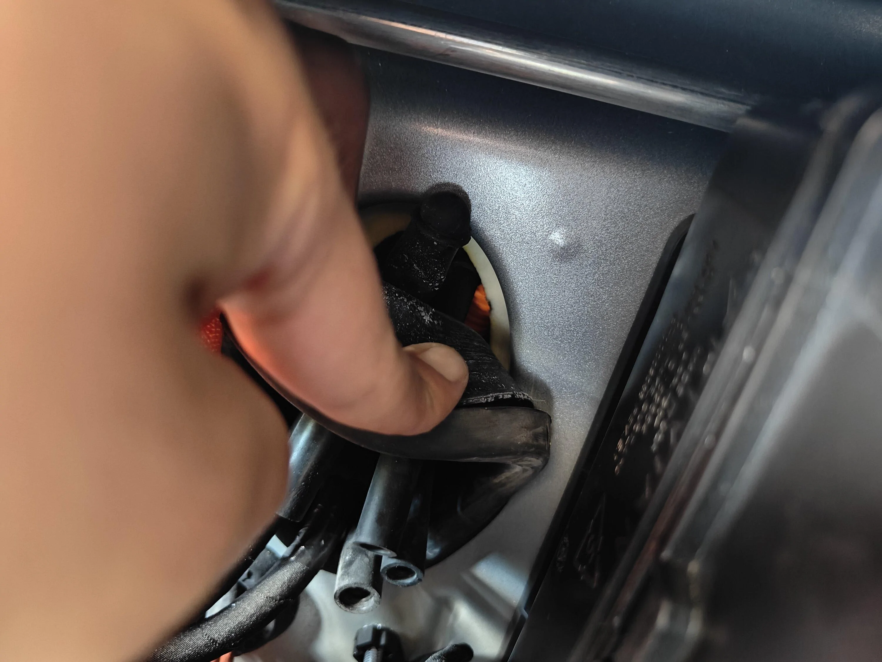

Yes, through the firewall directly to unused battery lug. Fused cable, with the fuse within 3" of the battery.
Here are a few pictures:
Rivian R1T R1S Aftermarket 6X9 subwoofer experiment in a 2023 R1T IMG20240208160052
Rivian R1T R1S Aftermarket 6X9 subwoofer experiment in a 2023 R1T IMG20240208160154
Rivian R1T R1S Aftermarket 6X9 subwoofer experiment in a 2023 R1T IMG20240208162659
Rivian R1T R1S Aftermarket 6X9 subwoofer experiment in a 2023 R1T IMG20240208163213
Rivian R1T R1S Aftermarket 6X9 subwoofer experiment in a 2023 R1T IMG20240208163308
Rivian R1T R1S Aftermarket 6X9 subwoofer experiment in a 2023 R1T IMG20240208173304
I did drill one hole into the storage bin, as that is where I mounted the amp. The amp does fit in the back side between the metal and the storage bin (top left area in the last picture), which was were I was going to originally mount it, but because I didn't want to remove the sub box when dialing in the sub I decided to just drill a hole and mount the sub amp in the storage area under the seat.
