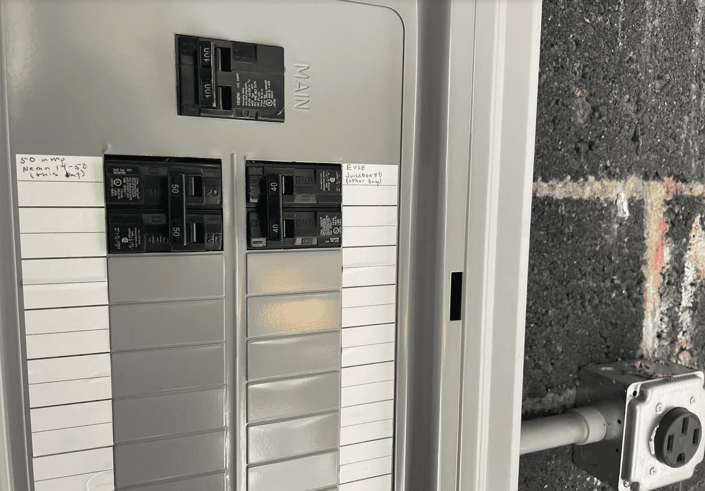

Sorry for the double post but here is how I did mine anticipating a dual EV household with either an R1T or F150 to slot in alongside a small commuter. I went with the 40 instead of the 48 because my utility had a rebate on the 40, otherwise I'd have followed my own advise (another reason to check your utility before proceeding):
Rivian R1T R1S Advice on the best universal wall charger 1648217251425
-100 amps pulled to a detached garage, 1 breaker for each bay
Rivian R1T R1S Advice on the best universal wall charger 1648217363991
-Hardwired Juicebox 40

If you're spending money, spend it right up front.
Buy once, cry once! ?. Have you seen the price of copper wire lately? :oops:
Seeing as that's a less than one year old installation to a detached garage and an 80' run going under several patios, sidewalks and driveways I'm intimately acquainted with both labor and copper current prices :CWL:
