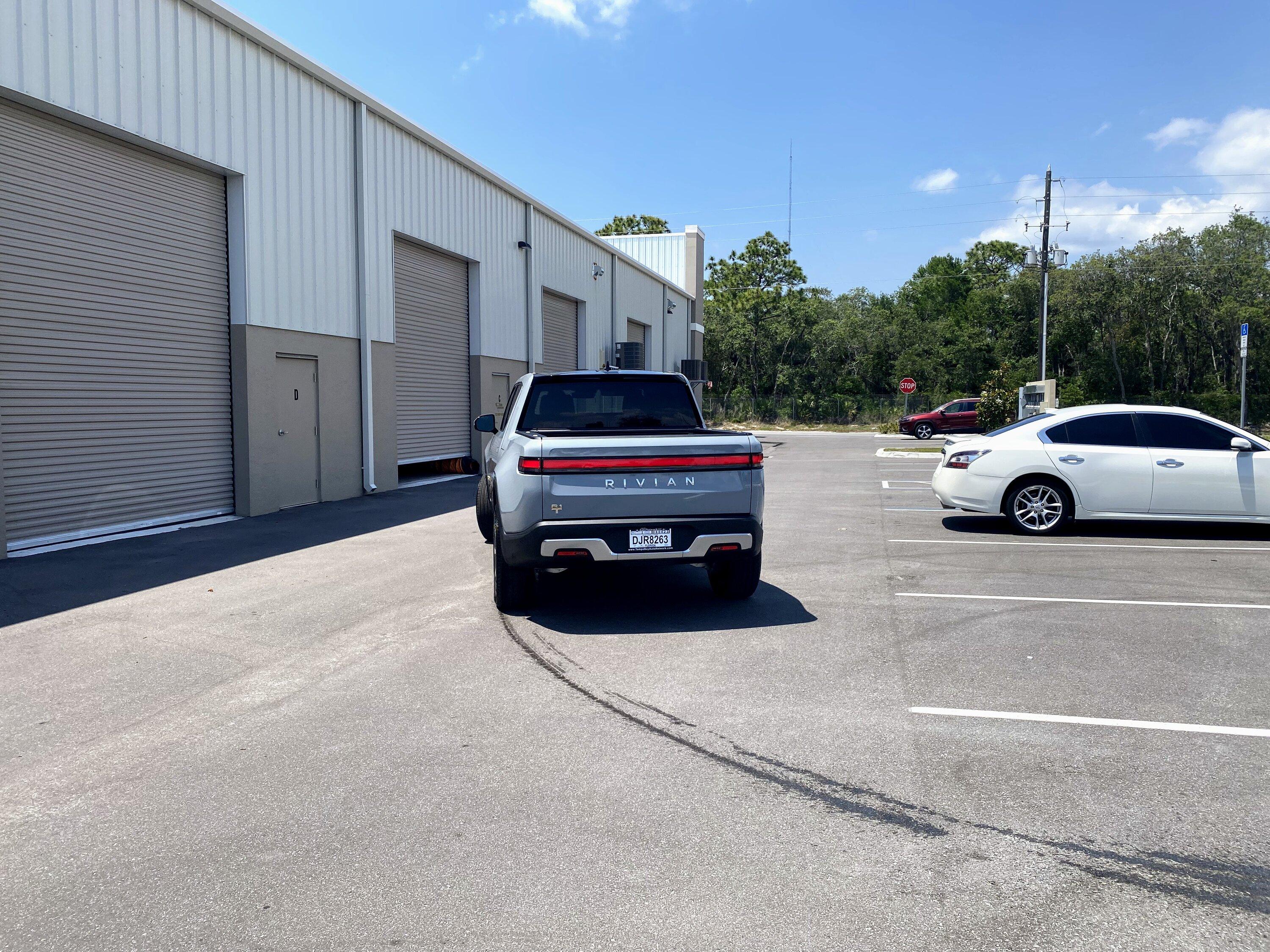

Rivian service should be able to see if something is overheating. If it goes away when you turn off the A/C then that sounds like it. What are the ambient temps and humidity like there? If it's hot perfectly normal for water puddles especially if it's been sitting in one spot with HVAC on.
I would give it the sniff test to make sure it's water. Rivian probably just wants to check it to make sure all is as it should be which I think is also a good idea.
Here is mine after sitting 15min in 90F Florida heat.
