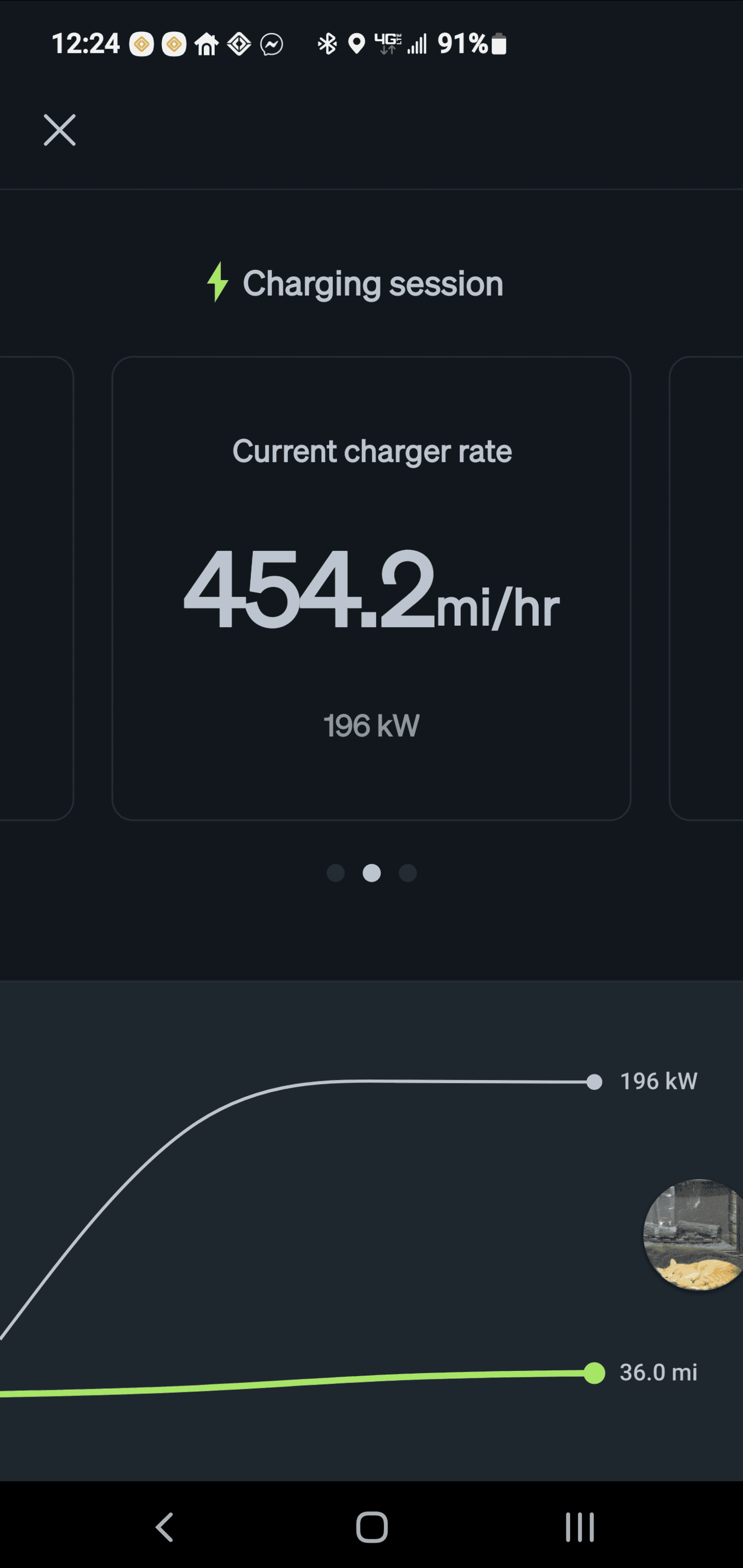

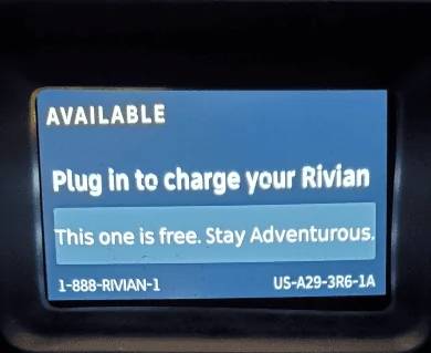

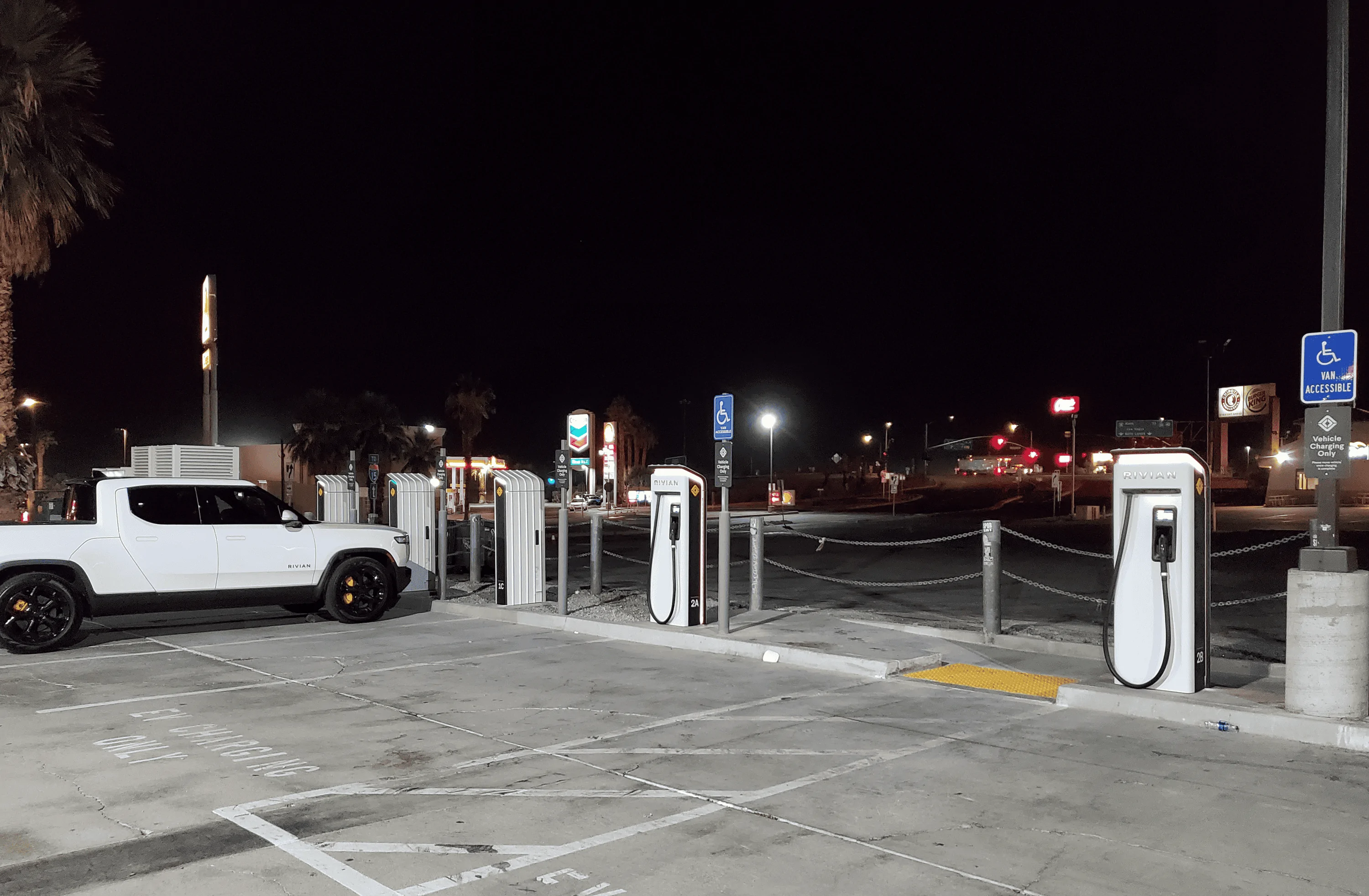

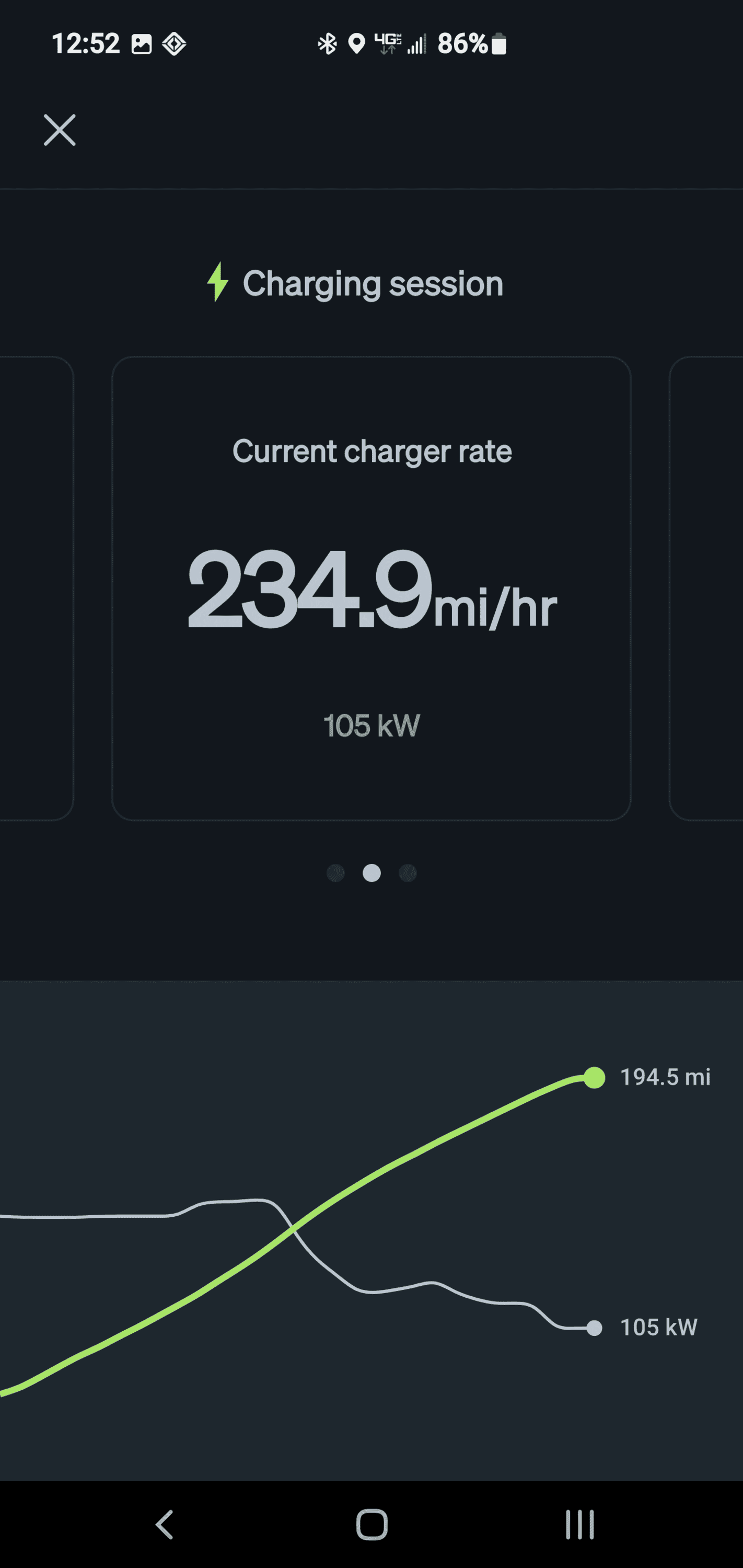

Today, entered my home as the destination and it kept pointing me to this charger I hadn't heard of and it wasn't an Electrify America charger, so I kept manually searching for the EA charger and entering that destination in. For whatever reason, as I neared Barstow, decided to see where Navigation would take me if I reset the destination and that's when I happed to just barely catch it was routing me to a Rivian Adventure Network Charger. Of course, I had to try that one. My first such experience. Thank you Rivian, reminded me of my Tesla days. Was SO EASY. Just plugged in and away it went. Got up to 196 kw delivered early on. After 30 minutes of charging, it was down to 105 kw after having added 160+ miles of range.

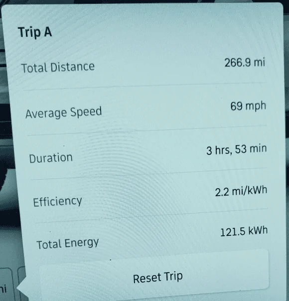

For my first time ever, as the Tesla would never make it that far, I actually completed my trip from Northern Los Angeles to my western / southern location in Vegas via a NON-STOP trip. Never remotely came close to being able to do that in any Tesla I've owned or driven.....
Home to Vegas
Rivian Adventure Network charger in Barstow!
Shortly after plugging in @ Rivian Charger...
After 30 minutes @ Rivian Charger

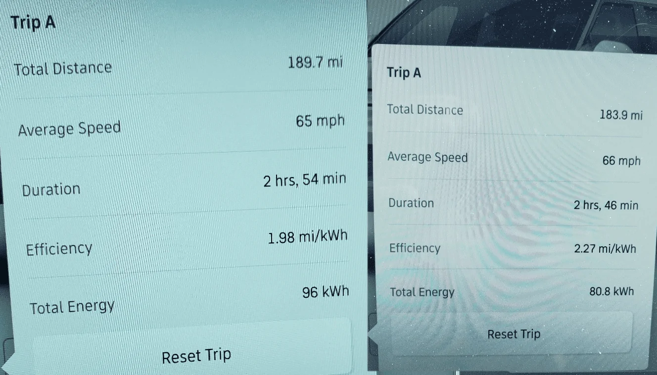

As a final side note. I made a similar trip to Vegas a few weeks ago on 20" All-Terrain Tires and got 1.98 mi per kWh. This time, 1 MPH faster, on stock 21" road wheels / tires, except with 5mm wheel spacers and no aero covers and got 2.27 miles per kWh. Was the difference of being able to make it to Vegas non-stop or not. While the Average speed was only 66 MPH, for much of the trip I was closer to 80 MPH on the freeway portions of the trip.
