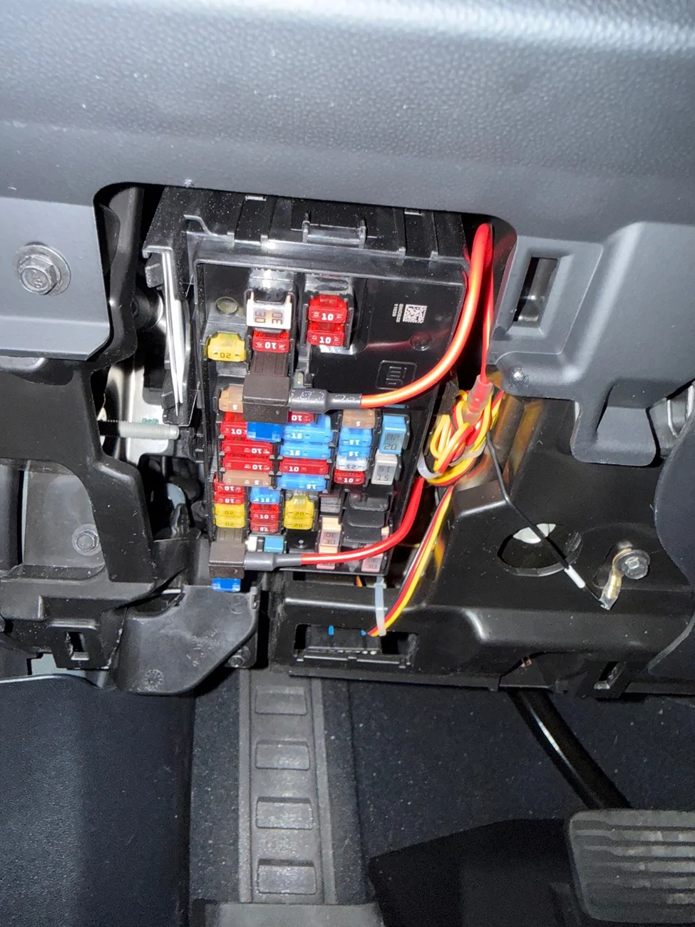

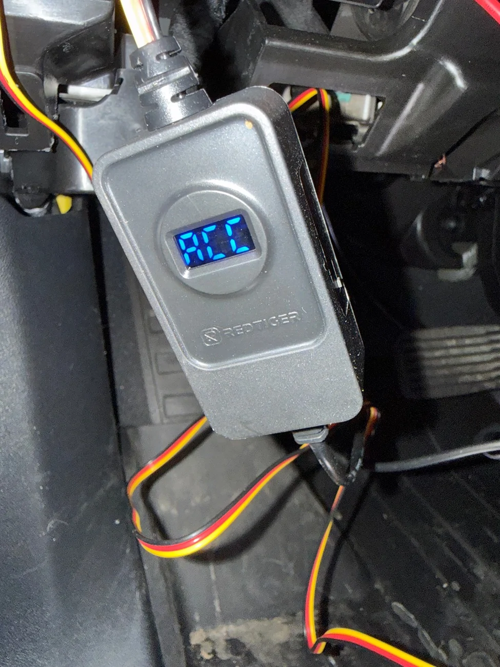

The kit also comes with a 12v USB C cable if you don’t want to hardwire it. But if you want to hardwire it they include a hardwire kit with three different sizes of 12v (15 amp) fuse taps. There rear camera connects to the camera/touchscreen unit with the included USB C to UBS C cable which is plenty long for even 3 row SUVs. The hardwire kit has a voltmeter that is adjustable for voltage so you don’t run down your 12v battery while in parking mode.
Since our G2 R1S already has dash camera installed I chose to install the F17 Elite in our 2026 GMC Sierra EV AT4. If you have a G1 Rivian the included 12v fuse taps will work just fine. The G2 Rivians don’t have an accessible fuse panel so I suggest purchasing and OBD2 to USB C power cable for the install on a G2. You can get a good one for about $15 on Amazon. I let RedTiger know that the G2 Rivians don't have an accessible fuse box.

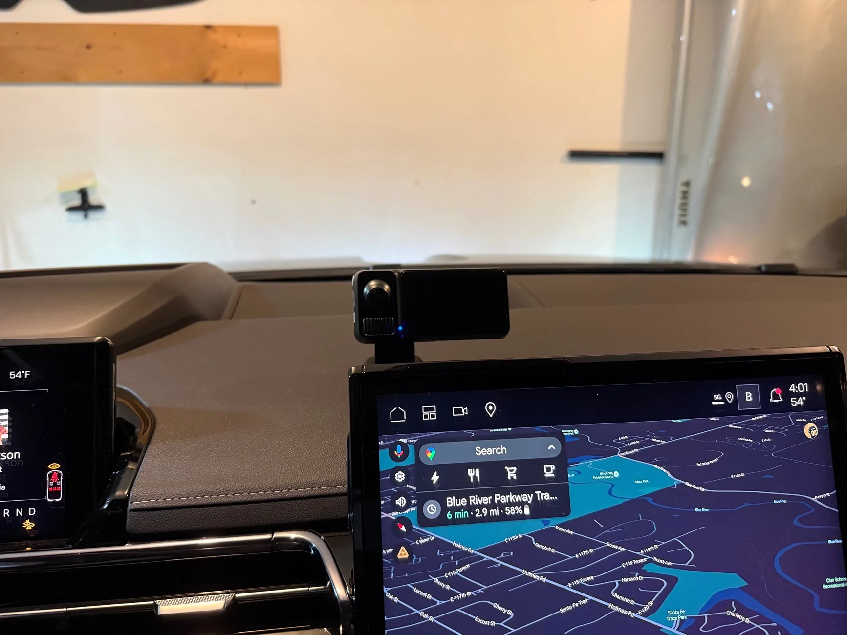

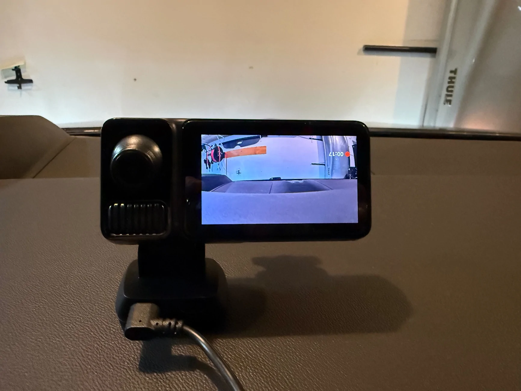

On our Sierra Install I determined that I preferred the camera/touchscreen unit to be installed on the dash. This required an upside down install which works great. The video automatically figures this out and reverses itself on the built in screen. Unfortunately the on screen display overlays do not reverse. It’s not a big deal as you just read them upside down and the OSD is only visible for a few seconds after using the touchscreen. RedTiger may include an option in a future firmware update to reverse the OSD.
The install on our Sierra was easy and I suspect the G1 Rivian would be as well. Once thing I forgot about fuse taps is that you have to install the fuse removed the from fuse panel into the fuse tap. Fuse taps have two fuses. One for the camera, and the other for the circuit that was tapped.
