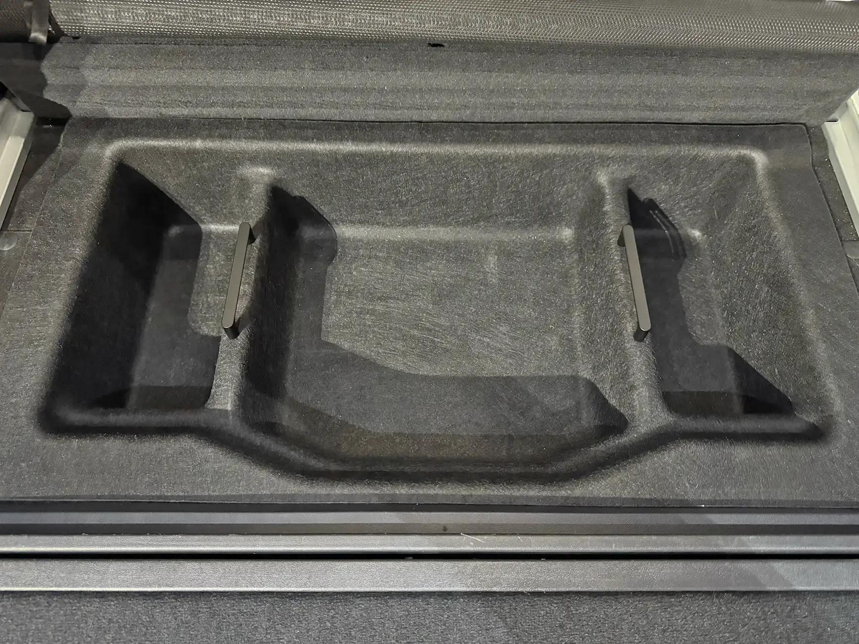

I use the lower cargo area quite often (I don't have a spare tire) and wanted to find a better way to lift the cargo tray up.​
The Project:
It's simple really....I just added handles to the tray.​
  1. Pick your favorite drawer handles for your local hardware store

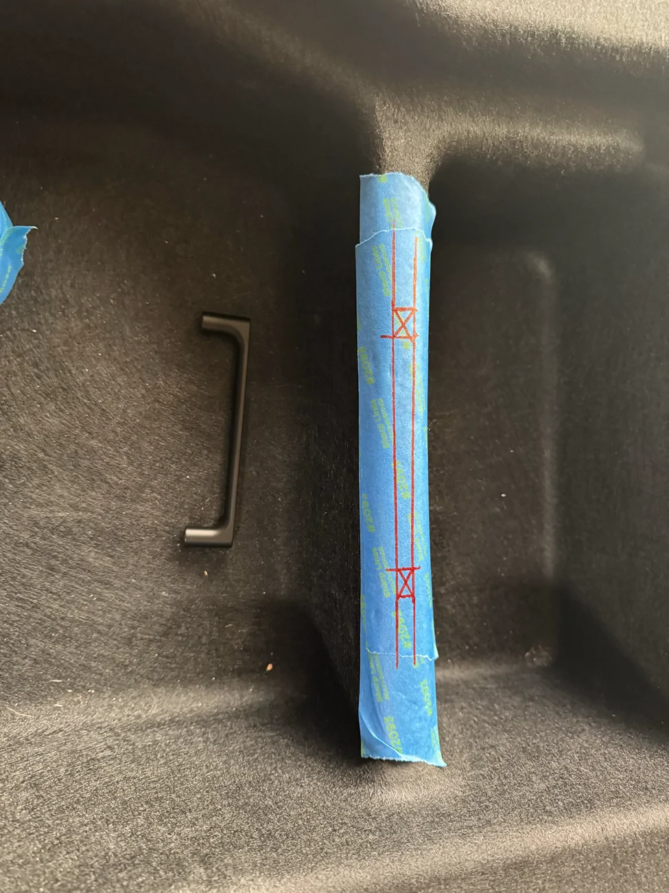

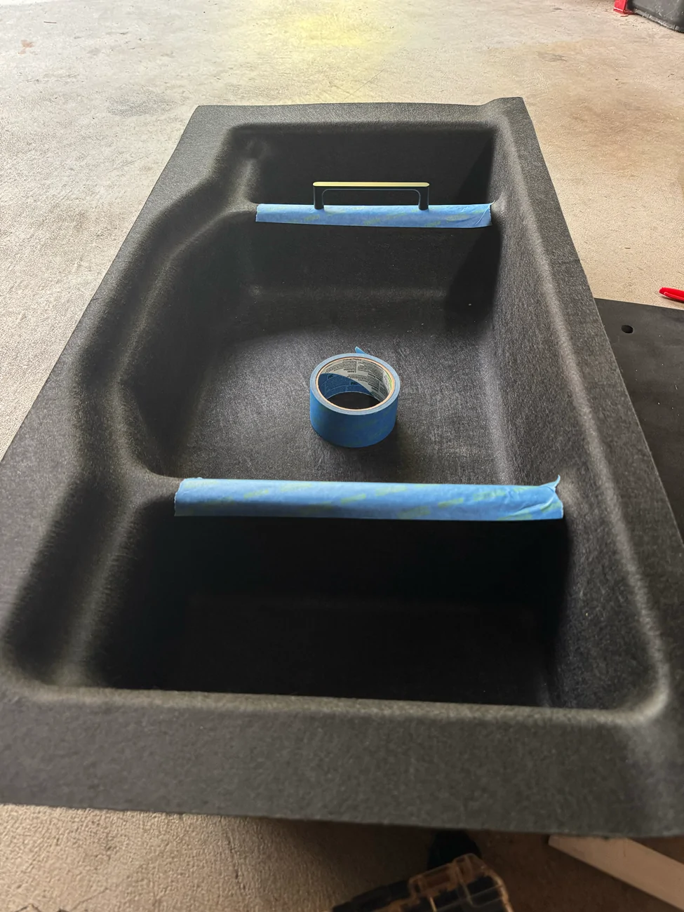

  2. Mark your holes, remember to measure twice
  3. Drill

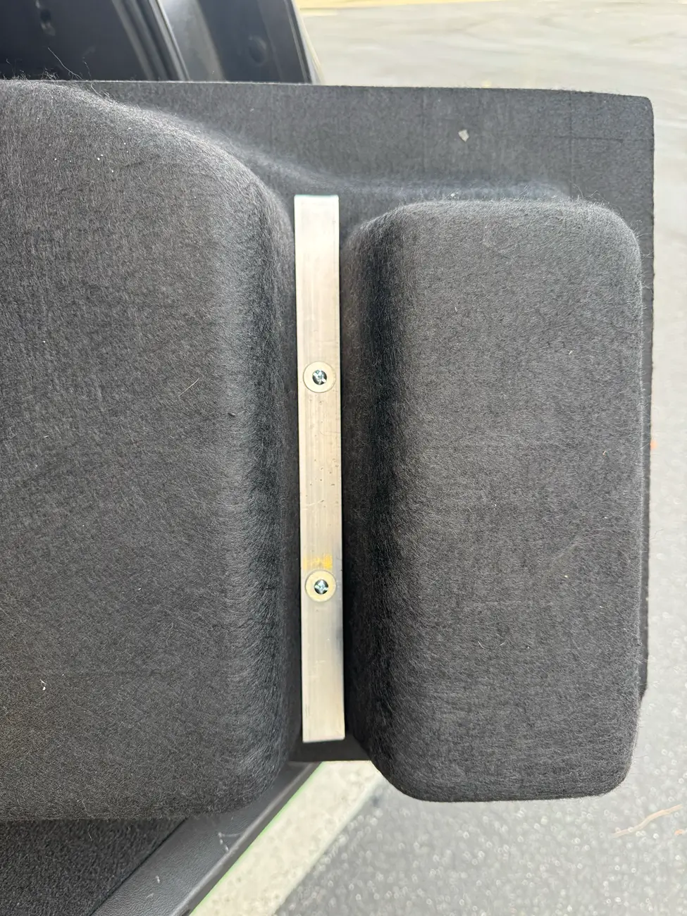

  4. Add a brace to the backside to provide support and space (since the screws might bottom out on the handles because they are meant for a thick wooden drawer) I used a scrap piece of aluminum, but it can be anything.

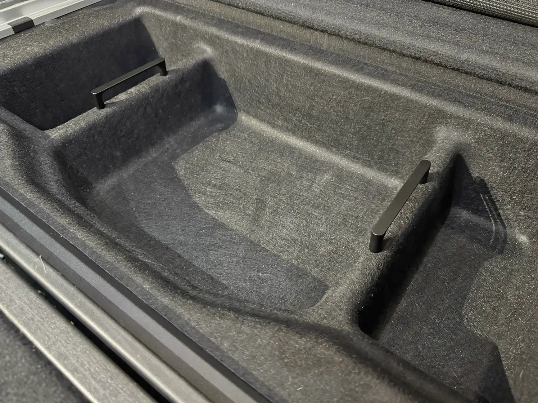

  5. Install the handles
  6. Done
Conclusion:
Overall, it worked like a charm and it feels more natural to lift the tray. Plus, when the tray is full of stuff, it doesn't sag or bow as much as grabbing from the edges.​
One added benefit is for my wife because the old method of grabbing the tray edges was a bit too wide for her shoulders. She did mentioned that it would be nicer if the handles were closer so she wouldn't have to reach over so far. Thus, if I were to do it again, I would get really long handles to match both our heights and arm lengths.​
