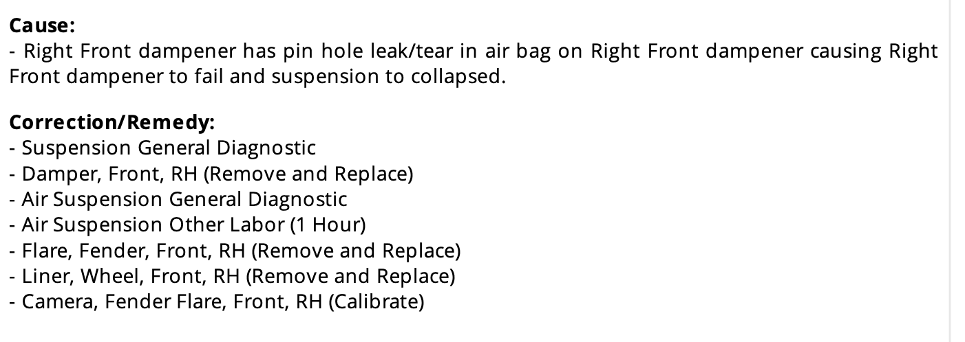

We did have 1 mechanical failure on the run, ironically at the top of the steepest section when we were all out of our vehicles for a photo op. John's front driver-side suspension airbag blew. We were all standing there when we heard it. The rest of the airbags deflated on their own to match. He called Rivian but we weren't thinking it'd be possible to get a flatbed up there. In the end, John chose to not only drive down the steep slope, but all the way out to pavement. I'll let him chime in more if he's here and wants to, but he said it was a really rough ride, but he didn’t mention any handling issues. My take was that it was good to know that even with such a failure, you could still get yourself out. We left the truck at the side of the road for it to be picked up today. It'll be interesting to see if it was one of the airbags or a hose.

Very strange that John was able to extract the truck with a blown front airbag. I blew my front driver damper 1/2 mile from my house on a paved road 10 min after delivery and the inner fender was sitting on the tire. Any attempt to even turn the wheel caused massive grinding noises and would have torn up the fender. Luckily I was able to get to a safe spot for the Rivian flatbed to come get the truck.
It has since been repaired and I have the truck but wondered how it could fail so massively.

How did the airbag go? Of its own accord or did a rock take it out?
No reported impacts. Still waiting to hear what the mechanic found. Not clear if it's the bag, or an air line at this point.

Update. The failure was the boot on the air strut. The loss of air resulted in the Air Suspension Unit that regulates suspension air pressure to overheat and fail. Both those, plus any damage from driving on a bottomed-out suspension are being covered under warranty. Repair time with parts shipping is 5-8 days. John's big takeaway was he should have pushed to have the service truck come out and repair it. They have the strut in stock and could have replaced it on the mountain. The only issue was timing because it was Sunday before a holiday, so he would have had to leave the truck at the top of the mountain for 2 days.
