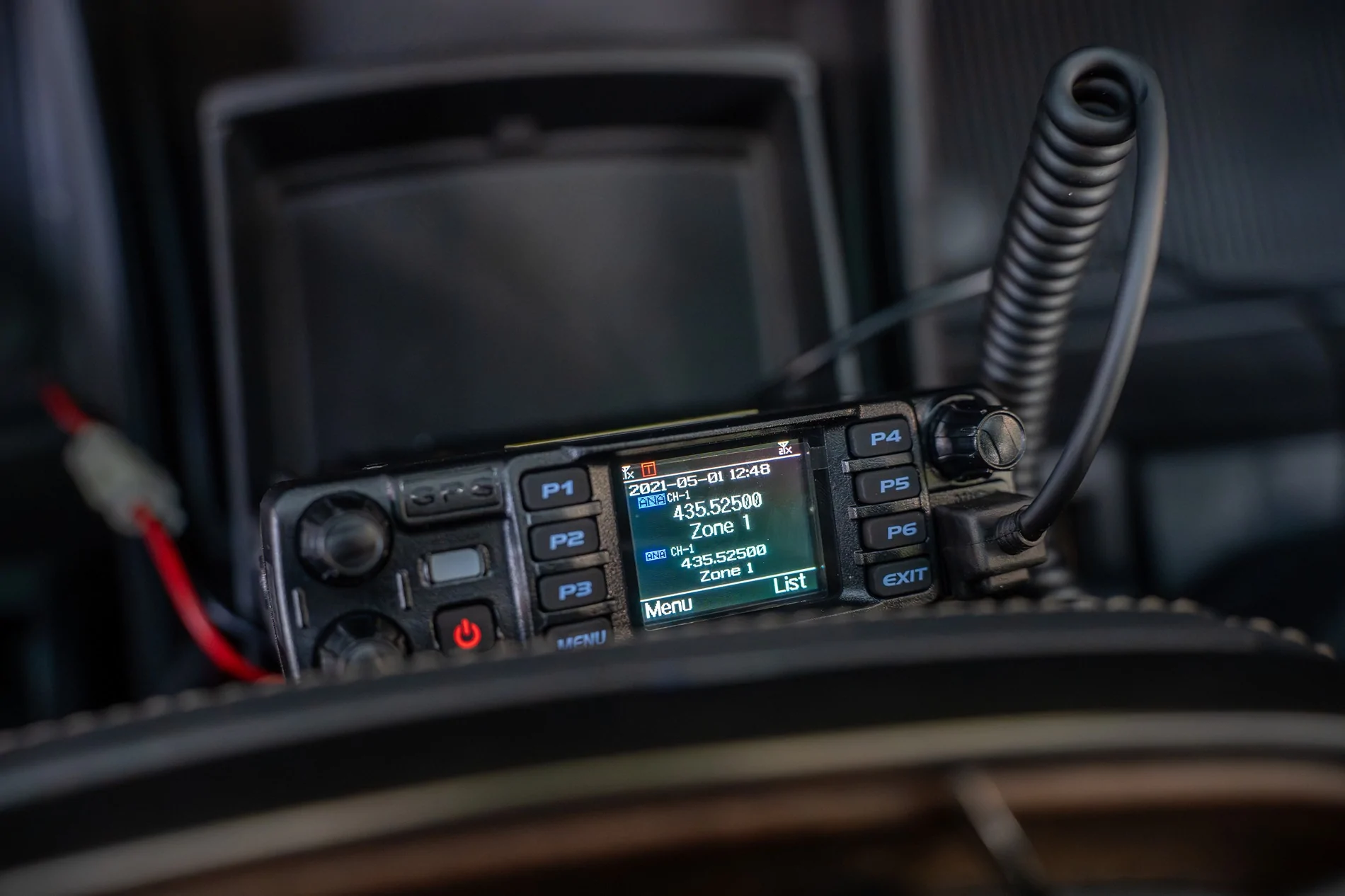

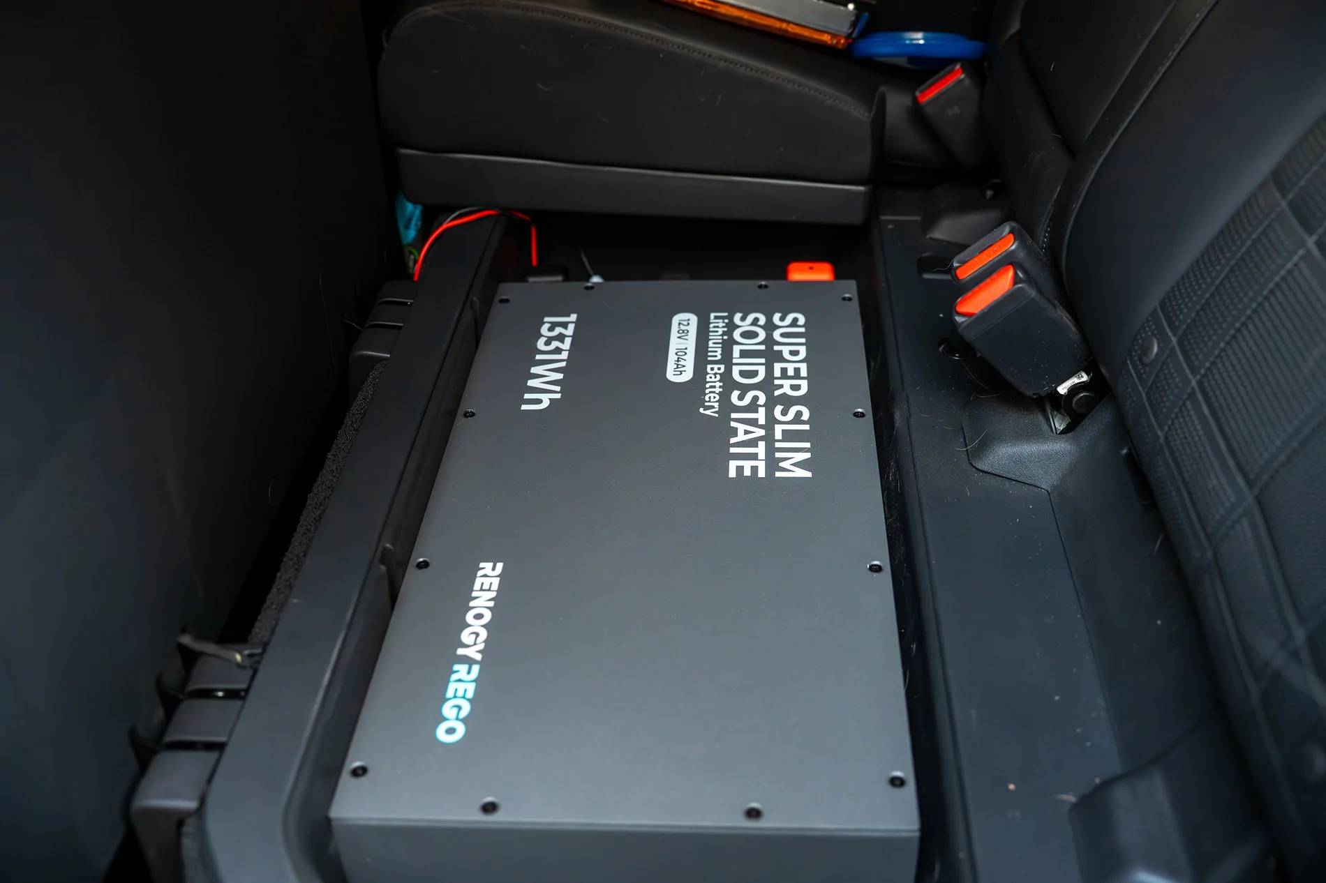

The goal was simple: reliable power for my VHF radio and later for lights during missions, fully independent of the Rivian. I went with the Renogy Rego Super Slim lithium battery, a 12.8V, 104Ah pack with 1,331Wh of capacity. It is slim enough to fit under the rear seat, strong enough not to overheat, and paired with my AnyTone VHF radio, my lifeline during searches.
I slid the Rego into an unused spot under the seat, then ran 10-gauge wire with 5/16 inch ring terminals, proper fuses, and a dedicated line for the radio. Wiring and crimping are not my strong suit, but with help from friends and the Rivian community I got it done. When I powered it up for the first time, the radio came alive instantly with no voltage drop and no drama.

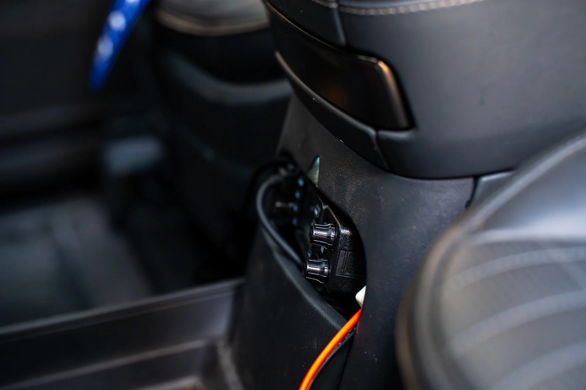

A battery is only good if you can recharge it, so for now I am using a Victron Blue Smart IP22 AC charger. It plugs into the wall at home or the Rivian bed outlet in the field, and the Victron app makes tracking simple. In a couple of hours it can take the Rego from low to full.

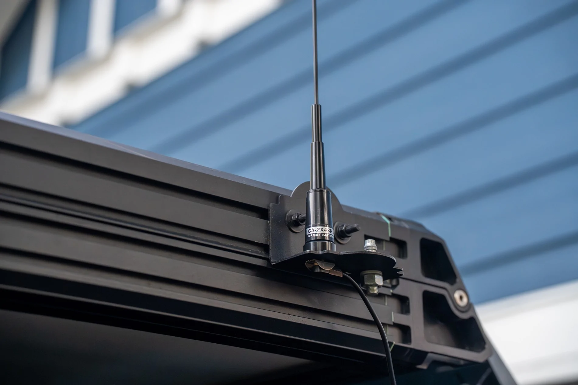

The radio is temporarily mounted under the seat with the antenna routed through a makeshift mount, but it works. After leaving the Rego fully charged for a week, it only dropped to 99.5 percent, which I am pretty sure was just the Bluetooth connection to the app.
The radio will be programmed and tested tomorrow so I will check back in with any interferance problems.

You could also charge "on the go" with the 120v outlet in the gear tunnel. Flip up the rear seat to expose the battery, connect the charger to the battery then run the power cable through the little access hole to the gear tunnel that's behind the center arm rest.
We have a plug in right below the rear screen that I am using.
