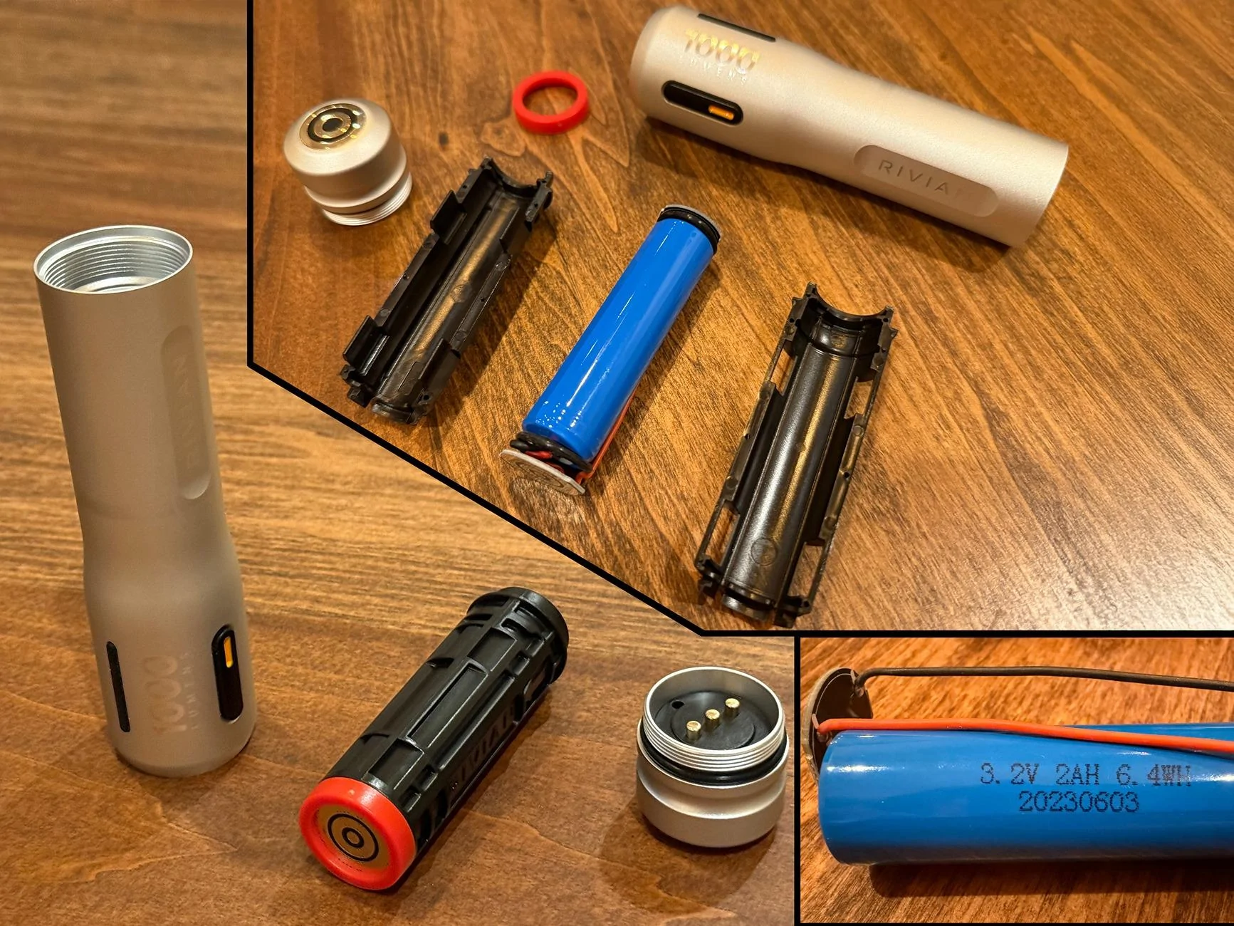

I was able to acquire a second Rivian Torch, but I can't charge it at home. You currently can't buy the Torch charger alone. Any site sponsors able to make one? I took apart the Torch, here are some pics.

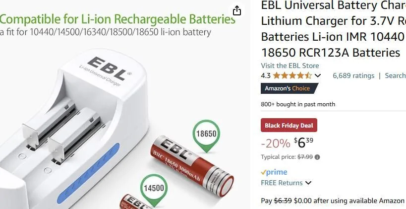

Not the most convenient, but you could buy a standard 18650 battery charger and use that. These are readily available on Amazon. You would have to remove the battery from the torch and the internal battery sleeve, but it should work fine.

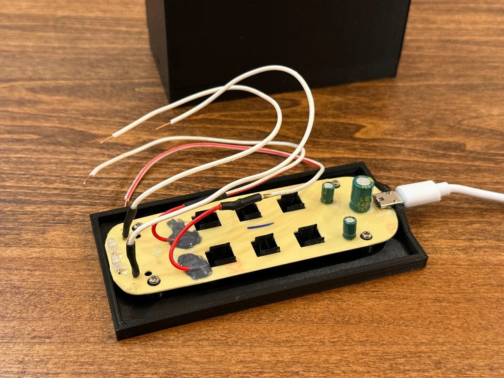

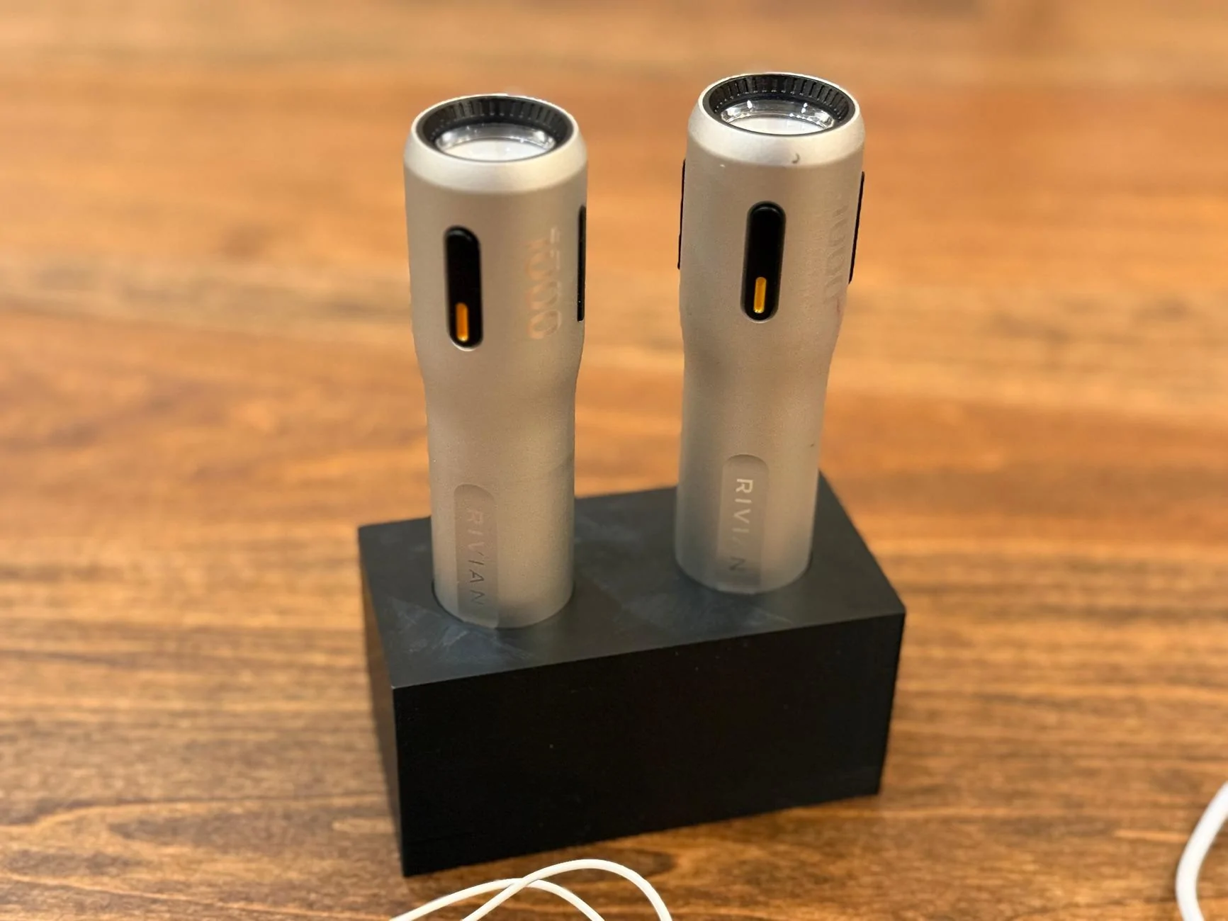

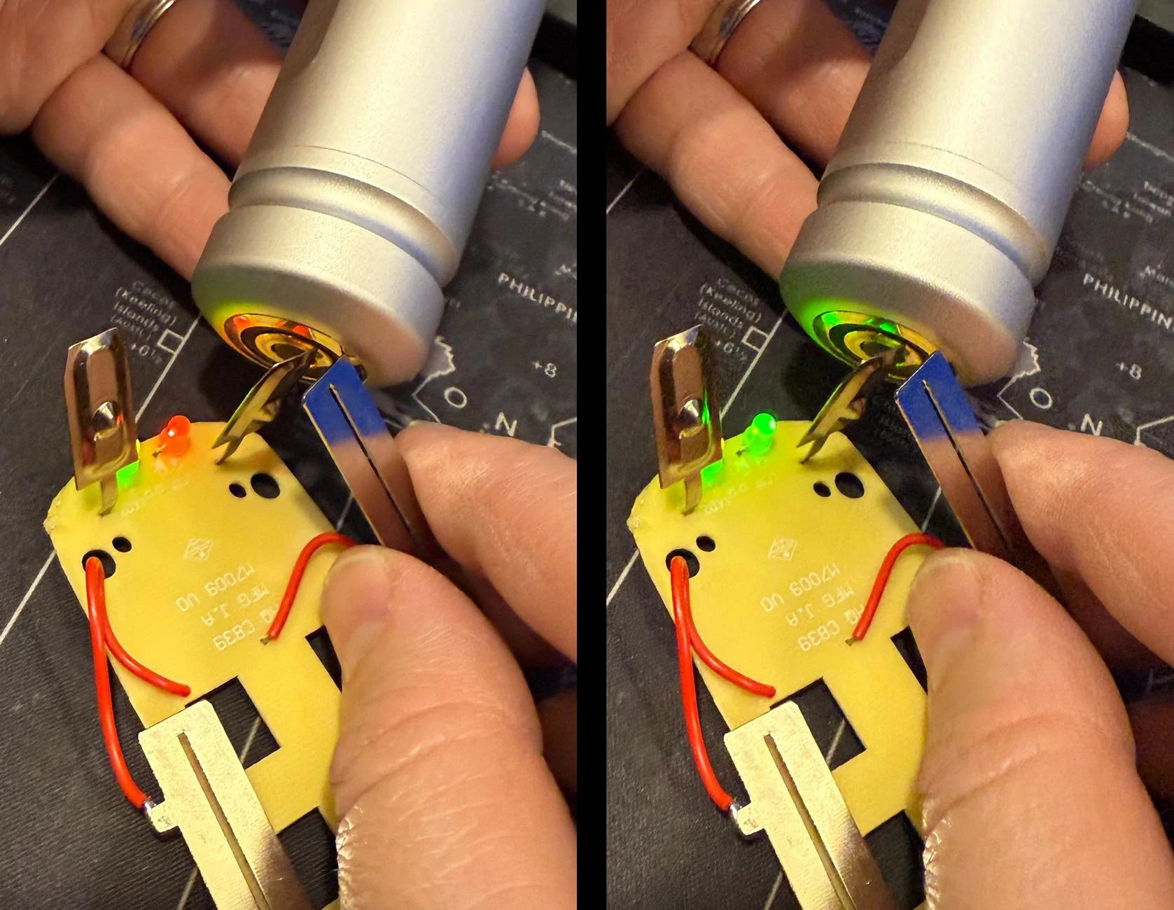

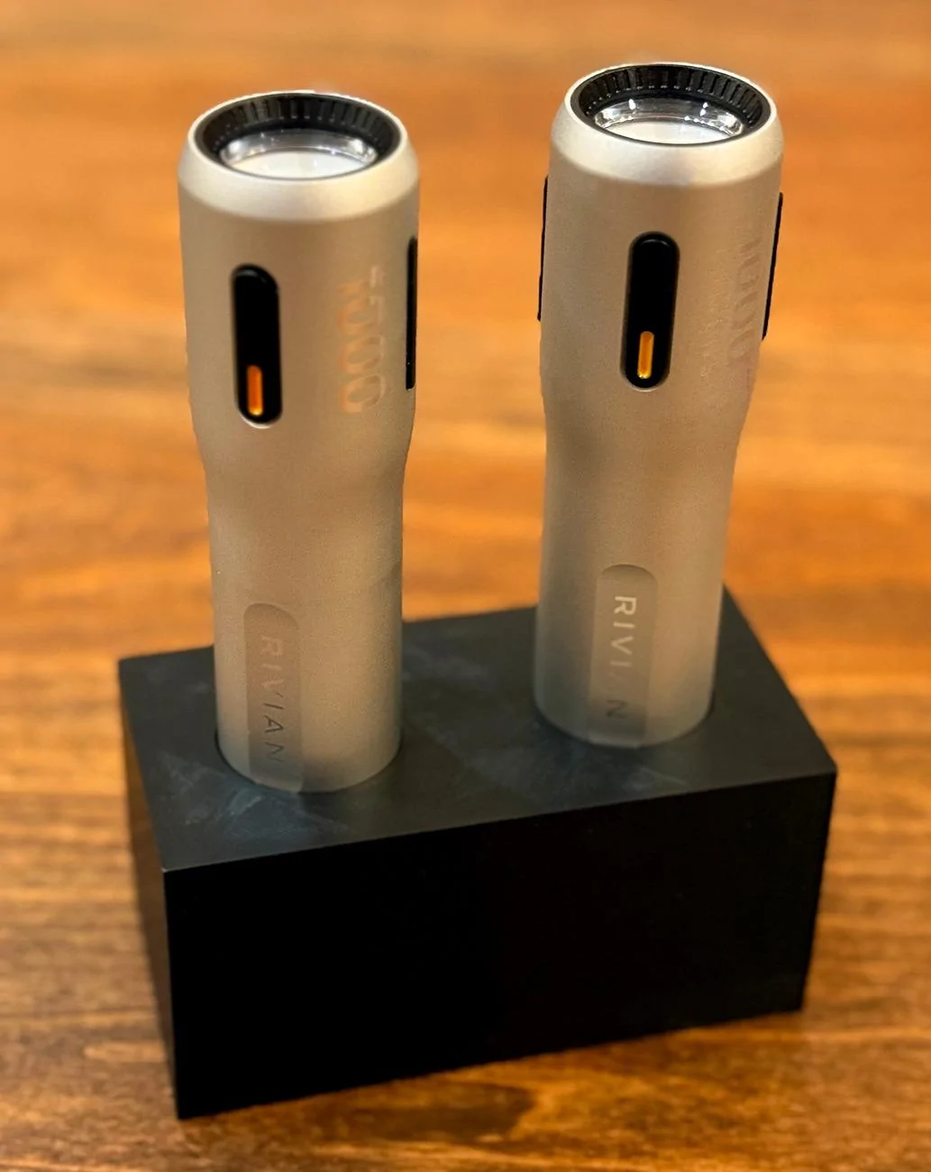

I bought a cheap charger and spring-loaded pins to make my own Torch charger. Will show it off here but will not share with the negative nancies!
Rivian R1T R1S 3rd Party Rivian Torch (flashlight) and Power Bank Charger? chargerTestin
Rivian R1T R1S 3rd Party Rivian Torch (flashlight) and Power Bank Charger? 1732659874714-p7
Rivian R1T R1S 3rd Party Rivian Torch (flashlight) and Power Bank Charger? 1732659907707-o3

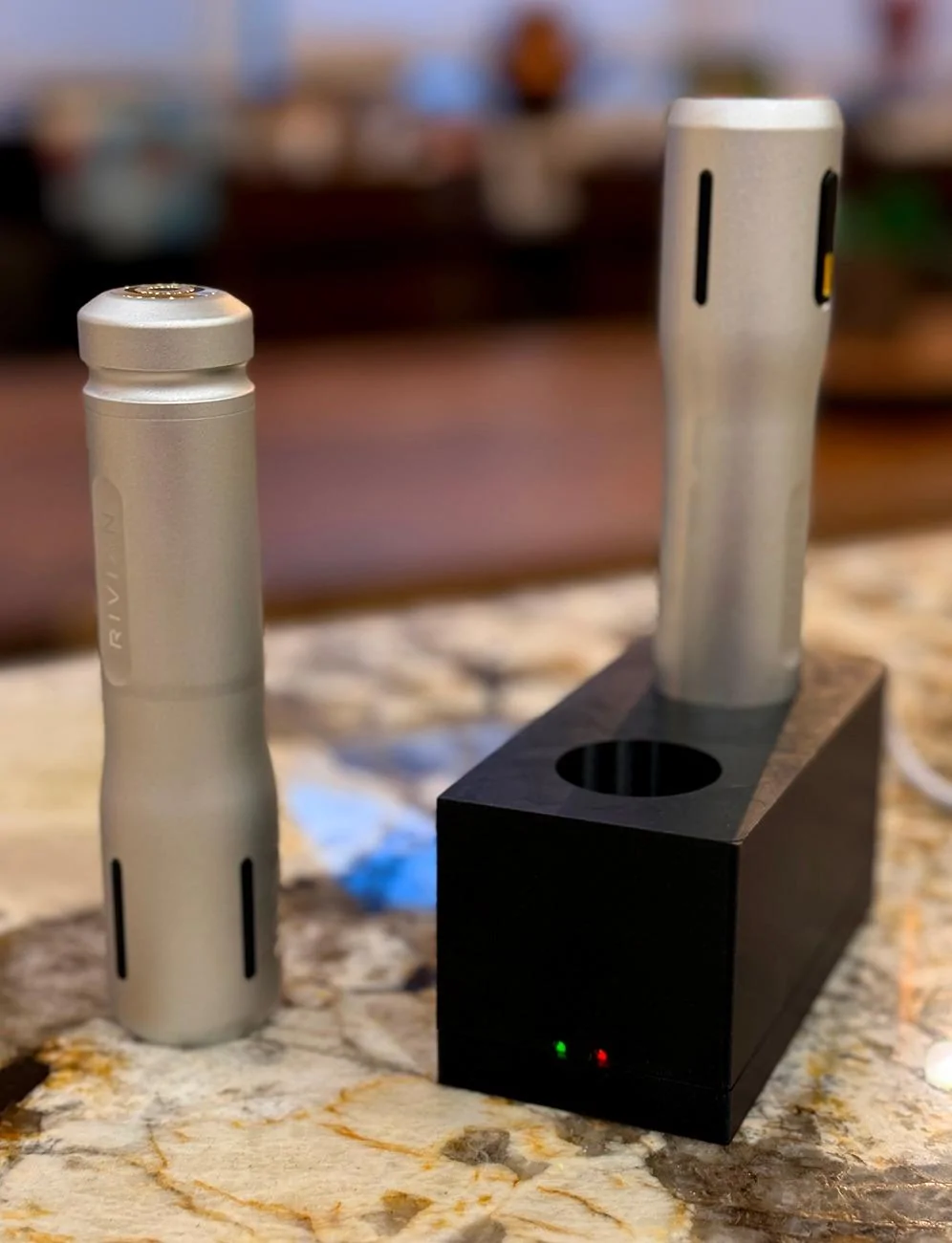

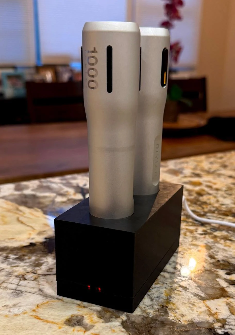

I already 3D modeled the Torch. Need to figure out how to fit the electronics into a base.

I've identified a potential issue. I have both the torch and power bank and the power bank does not charge with the reworked 1S lithium ion battery charger. On the power bank it says 5V 2A input which suggests to me that the torch and powerbank both have onboard BMS and we do not need to use a charger but instead apply 5V directly to the contacts. I tested this with a 5V power source and the power bank (which has charging lights) does indeed charge.
