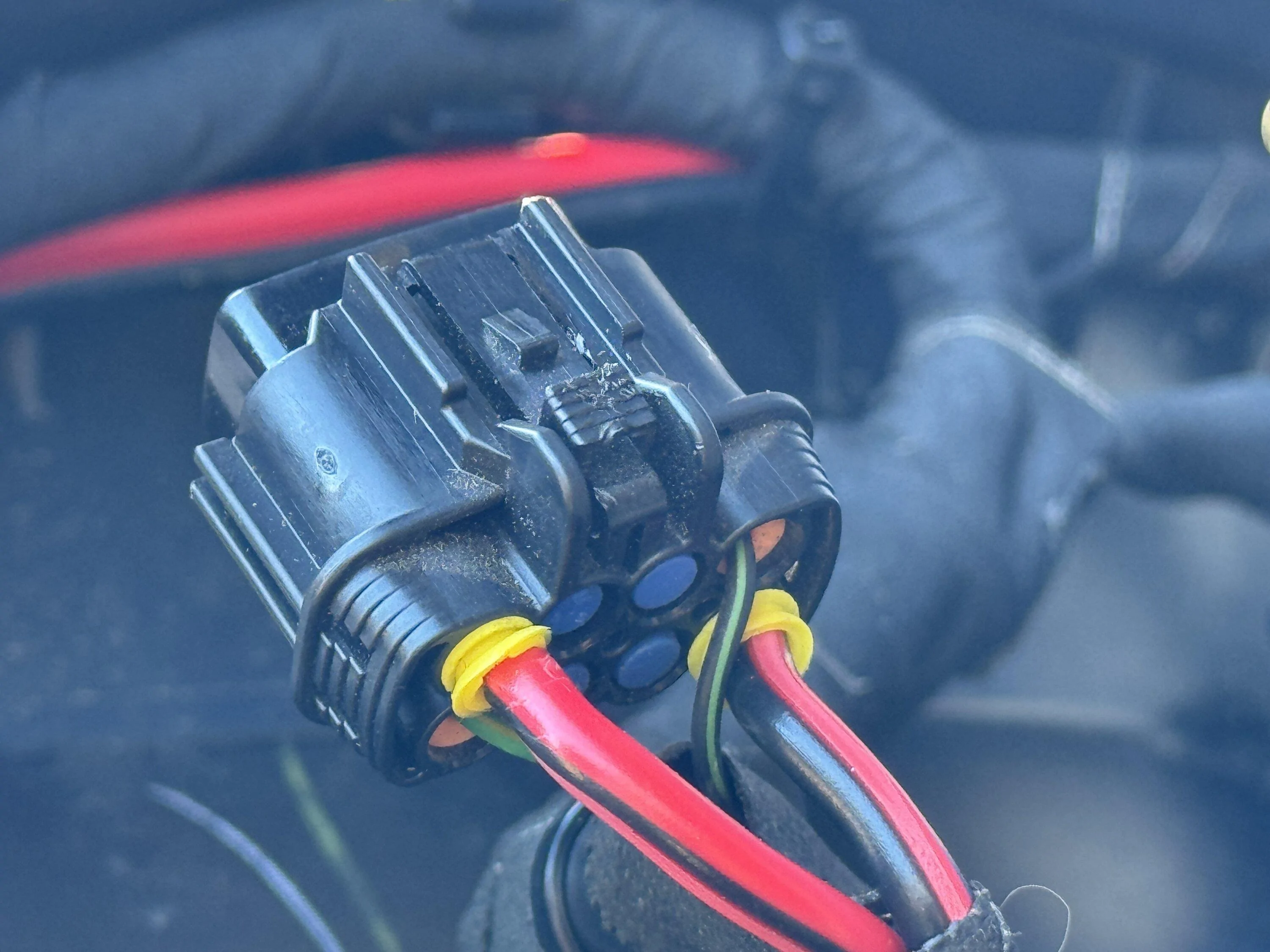

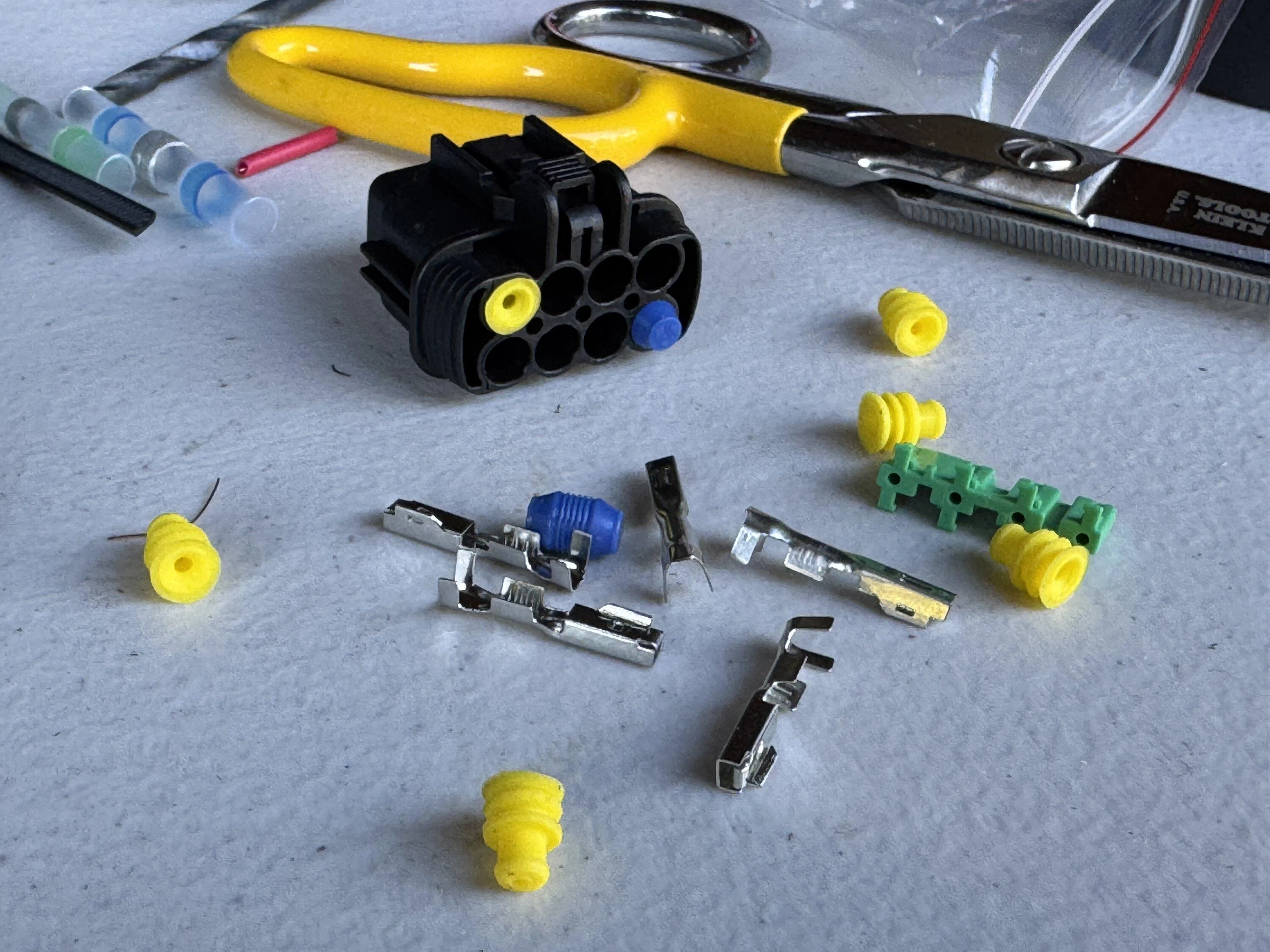

My OEM harness on the source side at the fender, had the wiring still in the harness (I believe all Gen1 models have this wiring. Maybe they removed it in Gen2); the harness into the frunk tub did not have the wire. I bought the correct connectors to tap in to the factory plug as shown - and utilized an Amazon sourced 12 V plug.
Rivian 12V in Frunk  - Factory OEM Retrofit Install Finished! {filename}
https://www.aliexpress.com/item/1005004519070612.html
That is the female harness I bought all I used was the pins and the seal plugs.

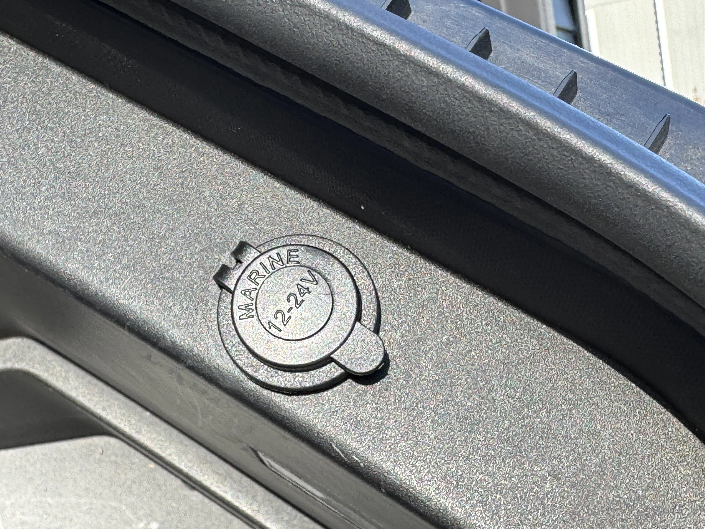

Any 12 V socket from Amazon will work. All I did for that was I measured and drilled into the factory location fit in the plug, secured it, and ran wire to the female side of the harness as shown in the pictures.

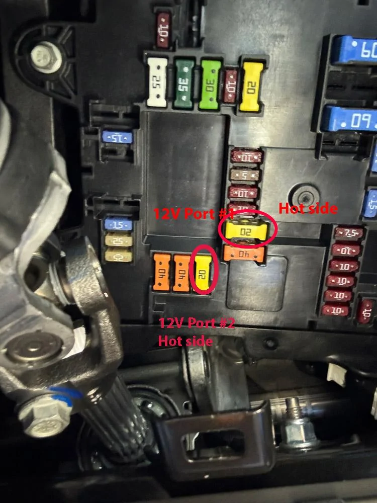

It’s a shared 20 amp fuse - the plug wiring itself I have a dedicated inline 15 amp.
About 180 watt - which is pretty standard for at cigarette adapter.

Great documentation. The fuse is #46, 20 amp on driver side.

What are you guys connecting in there? You can't run a fridge since it's sealed and very hot, and that probably means battery charging is sketchy too. I did use it once to test something, while open.
