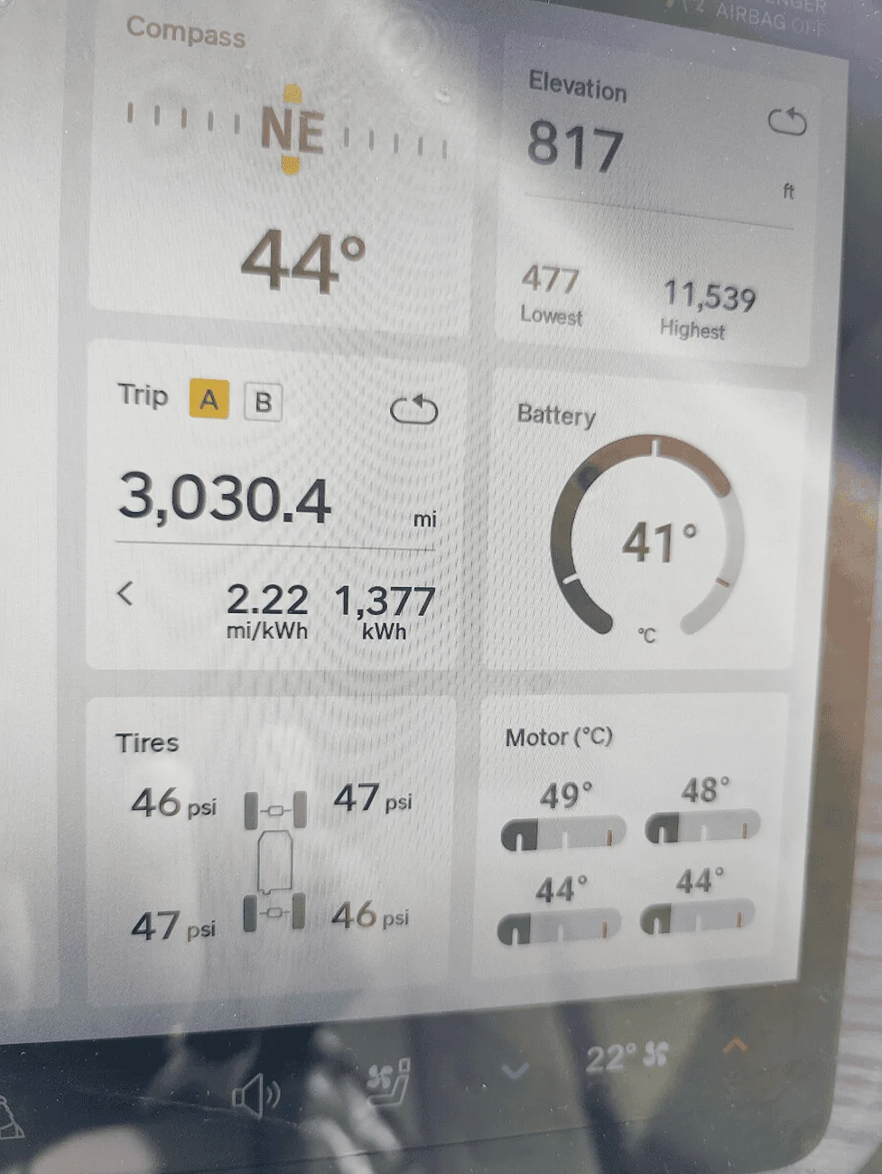

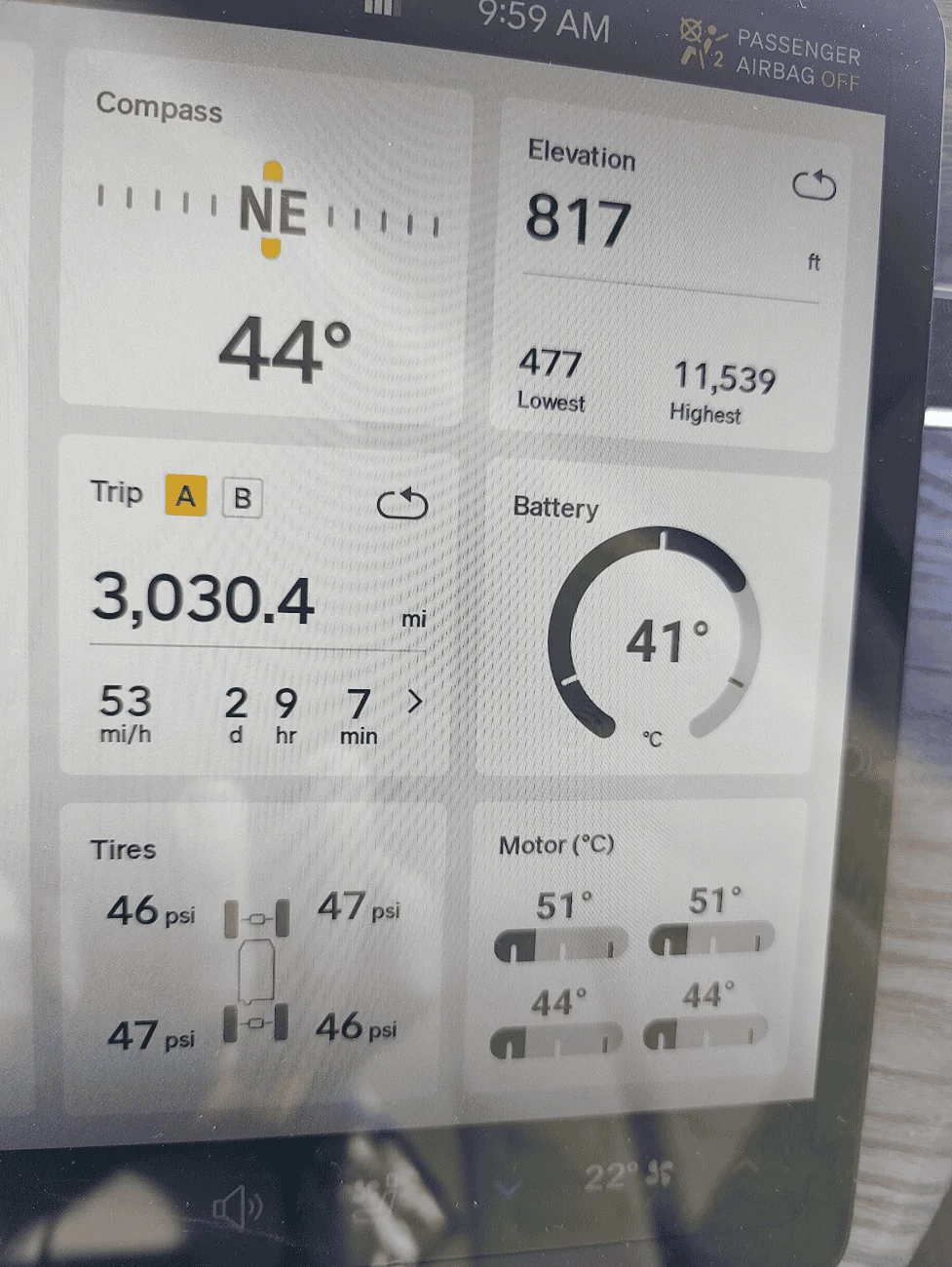

2. Goodyear RIV 20" Tire worked great for me - I got 2.22 miles per kWh: (truck with 2 people and fully loaded bed).
Driving 10% above the stated speed. (all temperatures are in Celcius)

Nice report, thanks for sharing! You might get even better efficiency if the tires are inflated to 48psi when cold (recommended inflation for the Goodyear tire).

Nice report, thanks for sharing! You might get even better efficiency if the tires are inflated to 51psi when cold (recommended inflation for the Goodyear tire).
I saw it somewhere - do you have a link for this? As I tried to find what PSI these tires are recommended for Rivian and did not find any formal info
The recommended inflation pressure is on the drivers door jamb sticker. I corrected my earlier post to read 48 psi when the tires are cold. Once they warm up, the inflation gets a little higher. I believe Rivian recommends 48 psi cold tire inflation pressure for all the different wheel and tire sizes.
Oh, that what I had, 48 psi cold in Texas when I left. Btw, that become 44 psi cold in CO ;)
I think I lost about 1.5 PSI over the entire trip.
