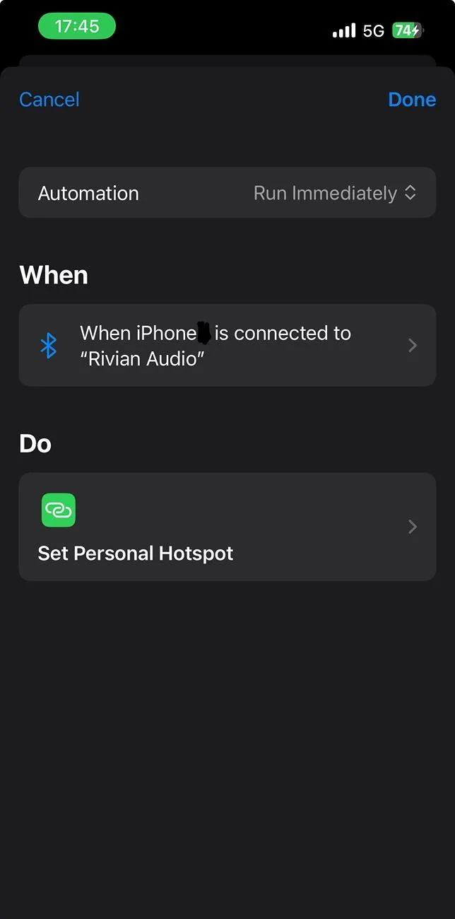

Using the Shortcuts app on iOS, you can set up a very simple automation to activate your iPhone hotspot for your Rivian.
Once your Rivian is connected to your hotspot once, it remembers it. This automation seems to re-activate the hotspot on your phone, and the Rivian automatically connects.
The action is set personal hotspot to “on “.
This will allow your infotainment apps to work normally without paying for Connect+.

Can you write up some steps on how to do this? I am iPhone noob
Open the App Store and search for "shortcuts". If you don't have it, download if not, select "open". You are going to create an automation. Then follow the screenshot above; automation: run immediately When the iPhone connects to "Rivian Audio". Do, "Set Personal Hotspot".
