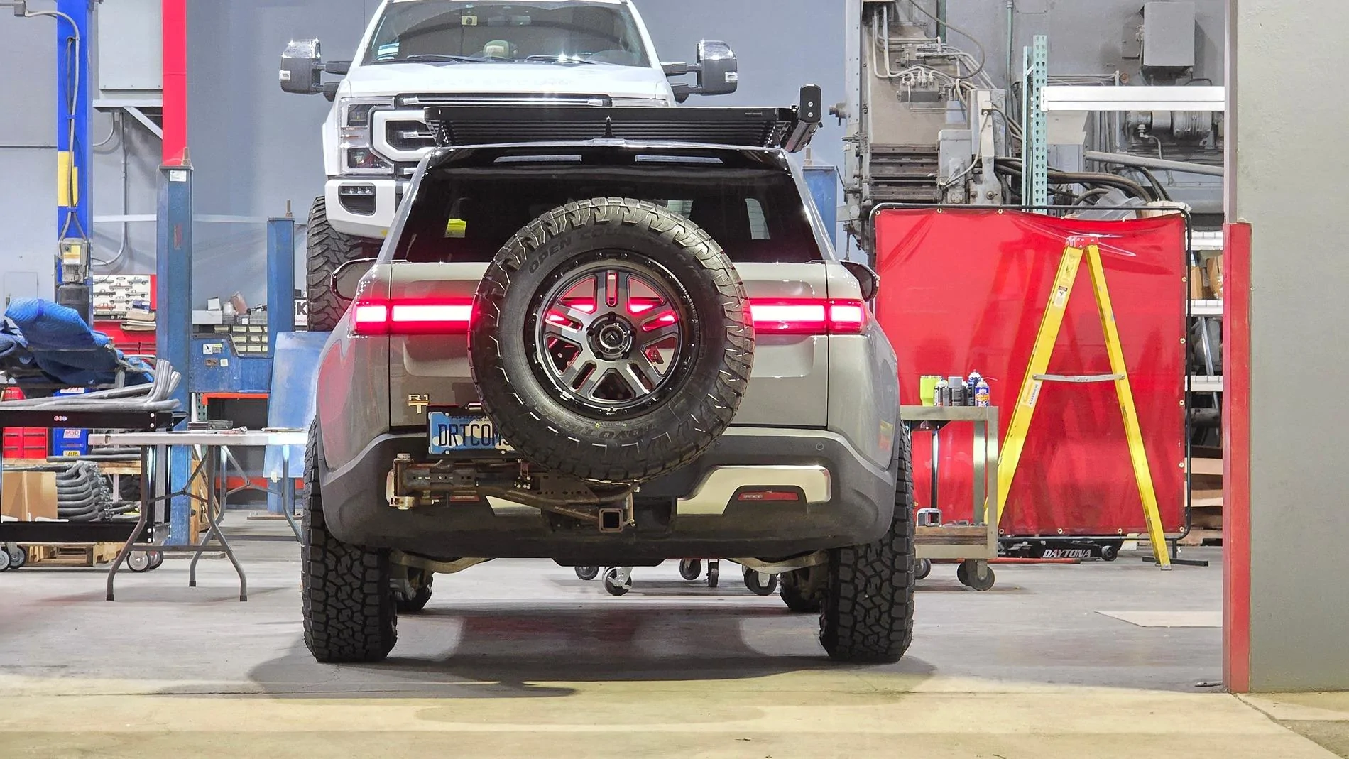

I know you're dirtcom, and you *SELL* the hitch mount, but does the larger tire even fit in the spare compartment? :)

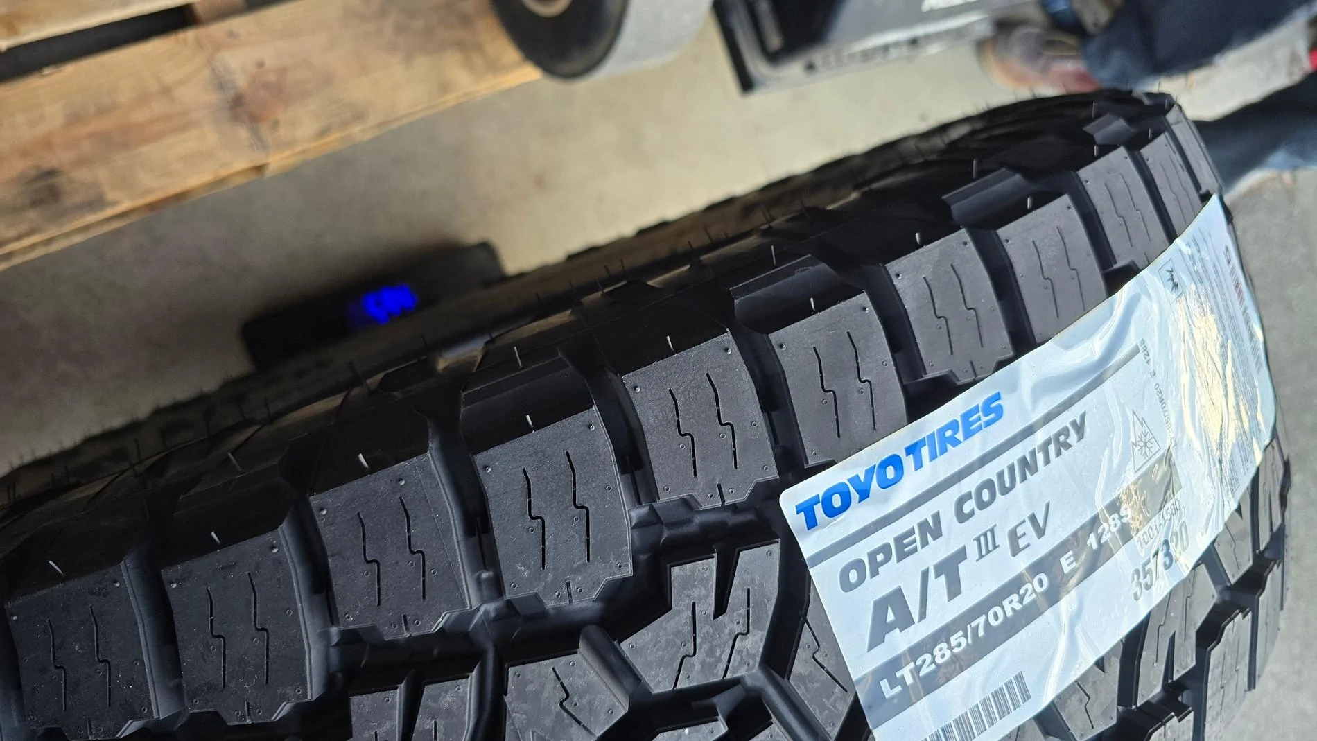

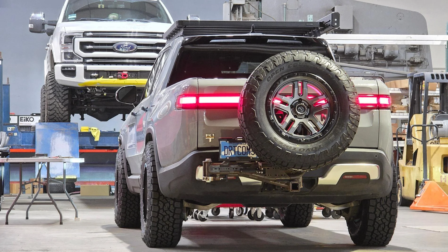

Got the tires in but I have to sit and stare at them until my tire appointment on Wednesday afternoon. Tire weight comes in at 59.4 lbs (1.6 lb under 61 lb listed spec)
I can definitely try to fit it once they're mounted for educational purposes. Bigger issue for me is it's a very inconvenient place for a spare. Especially when your bed is loaded up with all types of camping gear. Especially with the back breaking extended tailgate design. The beadlock 295s I wouldn't even bother. Over 100lbs would be an annoying task to lift out of that spot.

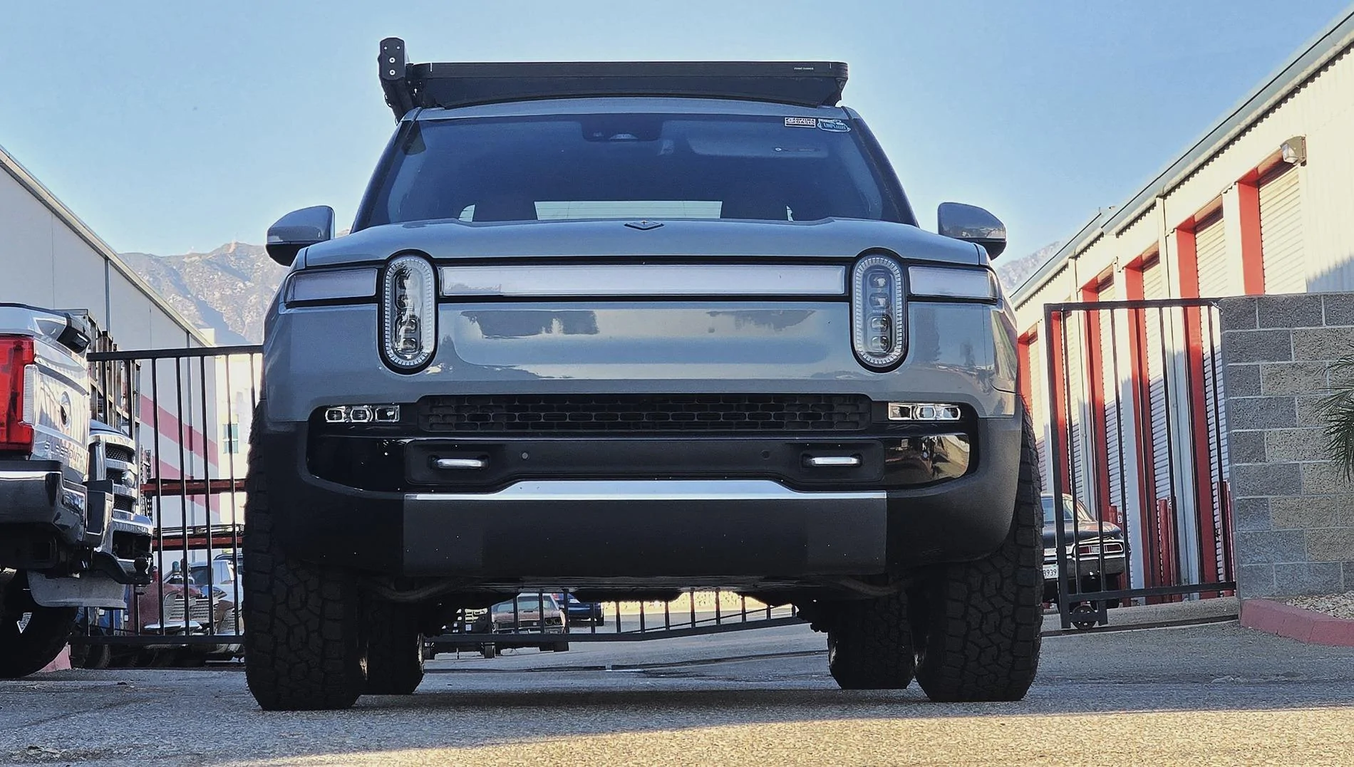

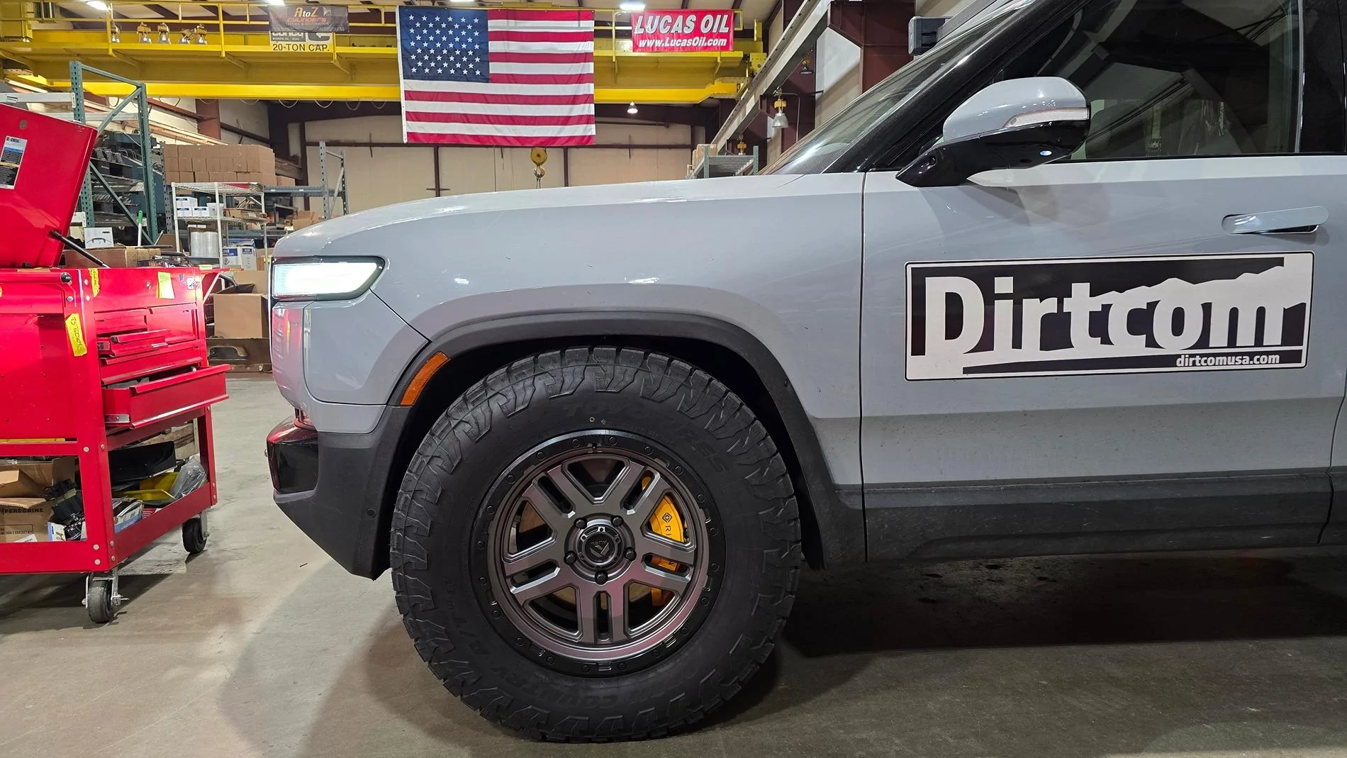

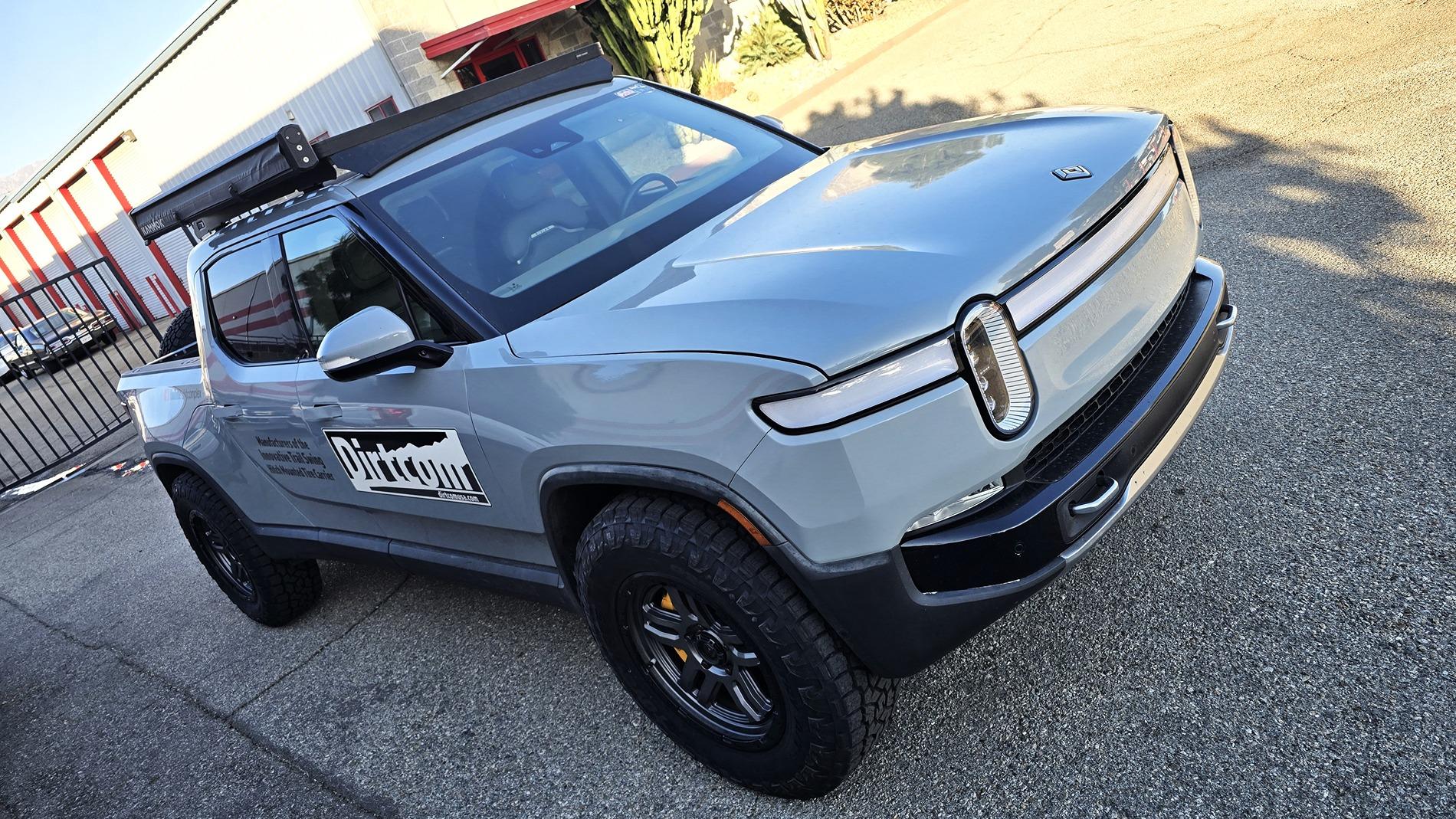

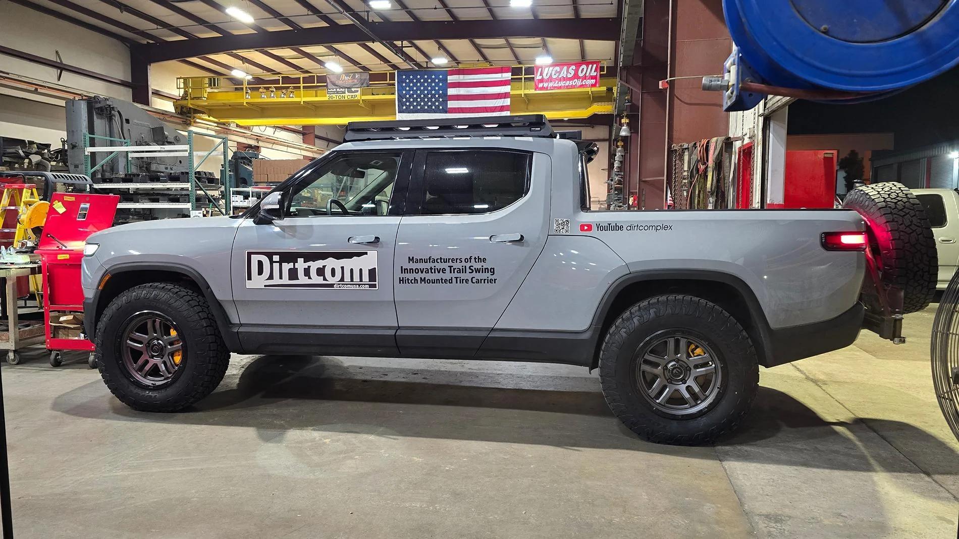

HERE THEY ARE!
Tires: 285/70r20 Toyo AT3 EV
Wheels: 20x9 +20mm
Rivian R1T R1S 285/70r20 Toyo ATIII EV going on R1T 20241204_190202
Rivian R1T R1S 285/70r20 Toyo ATIII EV going on R1T 20241204_190213
Rivian R1T R1S 285/70r20 Toyo ATIII EV going on R1T 20241204_191026
Quick Notes on Vehicle Mods
My Wheels vs Stock 20x8.5 +48
Front aero flap cut on lower bumper
Suspension ~1" over factory settings

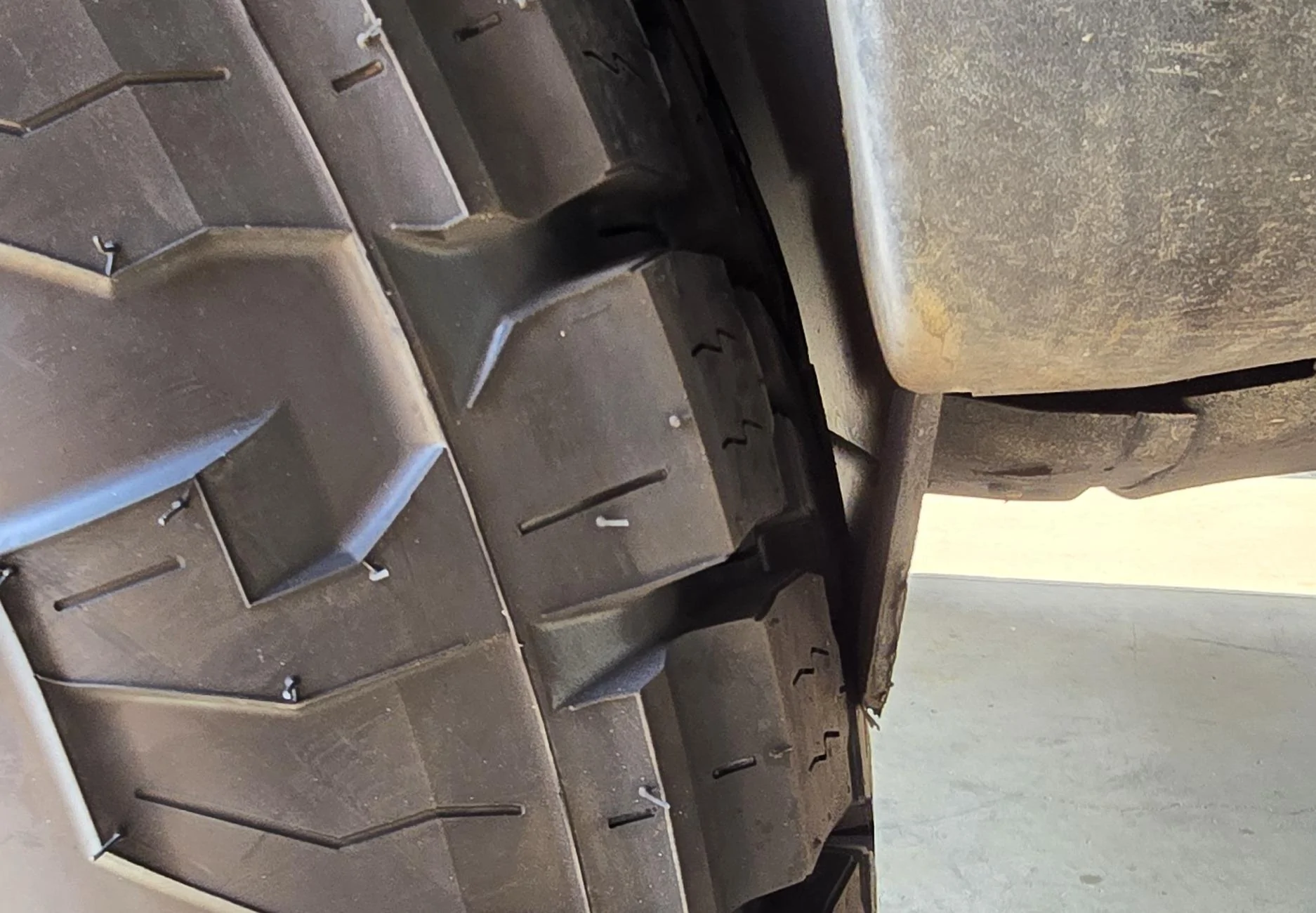

My wheels push the tire out .25" (half wheel width difference) + 1.10" (offset difference)= 1.35" out compared to factory wheels. I am running a fairly aggressive wheel setup and suspension is about 1" over stock height. Even with these wheels they are clearing the plastic fender wells at full lock. The outer edge of my tires at full lock barely touch the fender lining, but it's not enough to make an audible sound. Which means in the parking lot I don't get embarrassing rubbing sounds when I park. That is actually great news for anyone running a less aggressive fitting wheel. The diameter of these tires are most likely the max that the stock fenders can handle clearance wise. This means a less aggressive wheel setup will definitely clear. The narrower profile of this tire is definitely a plus! Again the caveat is I am 1" over standard heights.
I did run on low conserve setting on the highway and I made it back without rubbing, but I'm certain that any hard bumps or aggressive turns my tires will rub at the center of the fender flare (top) due to my wheels sticking out so far.
FULL DROOP Suspension fully extended on jack (pass. rear pictured below) Most likely I may have to cut the aero flap if it becomes annoying offroad, but this would never touch in street driving.
Rivian R1T R1S 285/70r20 Toyo ATIII EV going on R1T 20241204_124316a
FACTORY "STANDARD" HEIGHT Pictured below shows front wheel at factory standard suspension height.
Rivian R1T R1S 285/70r20 Toyo ATIII EV going on R1T 20241204_192027

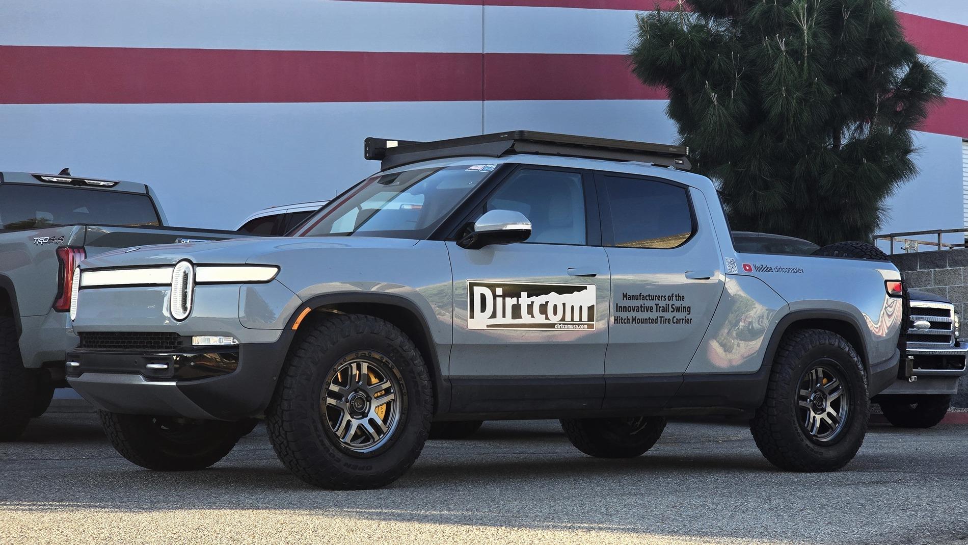

Here are more pictures
Rivian R1T R1S 285/70r20 Toyo ATIII EV going on R1T 20241205_151130
Rivian R1T R1S 285/70r20 Toyo ATIII EV going on R1T 20241205_151050
Rivian R1T R1S 285/70r20 Toyo ATIII EV going on R1T 20241205_151213
edit- I'd like to add that the wheel design makes the tires look fatter and taller. On a wheel design where there is no lip, and/or spokes go to the edge of the wheel, the tires will appear less "meaty"
