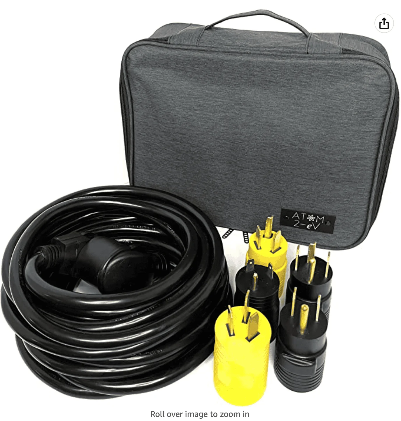

The Rivian charge kit can handle two of the three outlets that campsites use - 50amp and 20amp. For 30amp, all you need is something like this:
https://www.amazon.com/gp/product/B07XNSXWM4
I've used this at RV campsites without issue but be aware, 30amp 120v will only give you about 4 mph with the Rivian charge kit.
