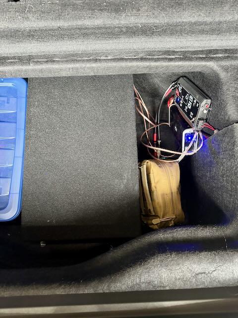

Rivian R1T R1S Subwoofer Upgrade Advice and Review: NVX amp &  JL subwoofers (dual voice coil 4ohm shallow mount) IMG_3474
(no this isn't the final wiring, but just wanted to show how it all fits in there. It is cleaned up now, don't hate me.

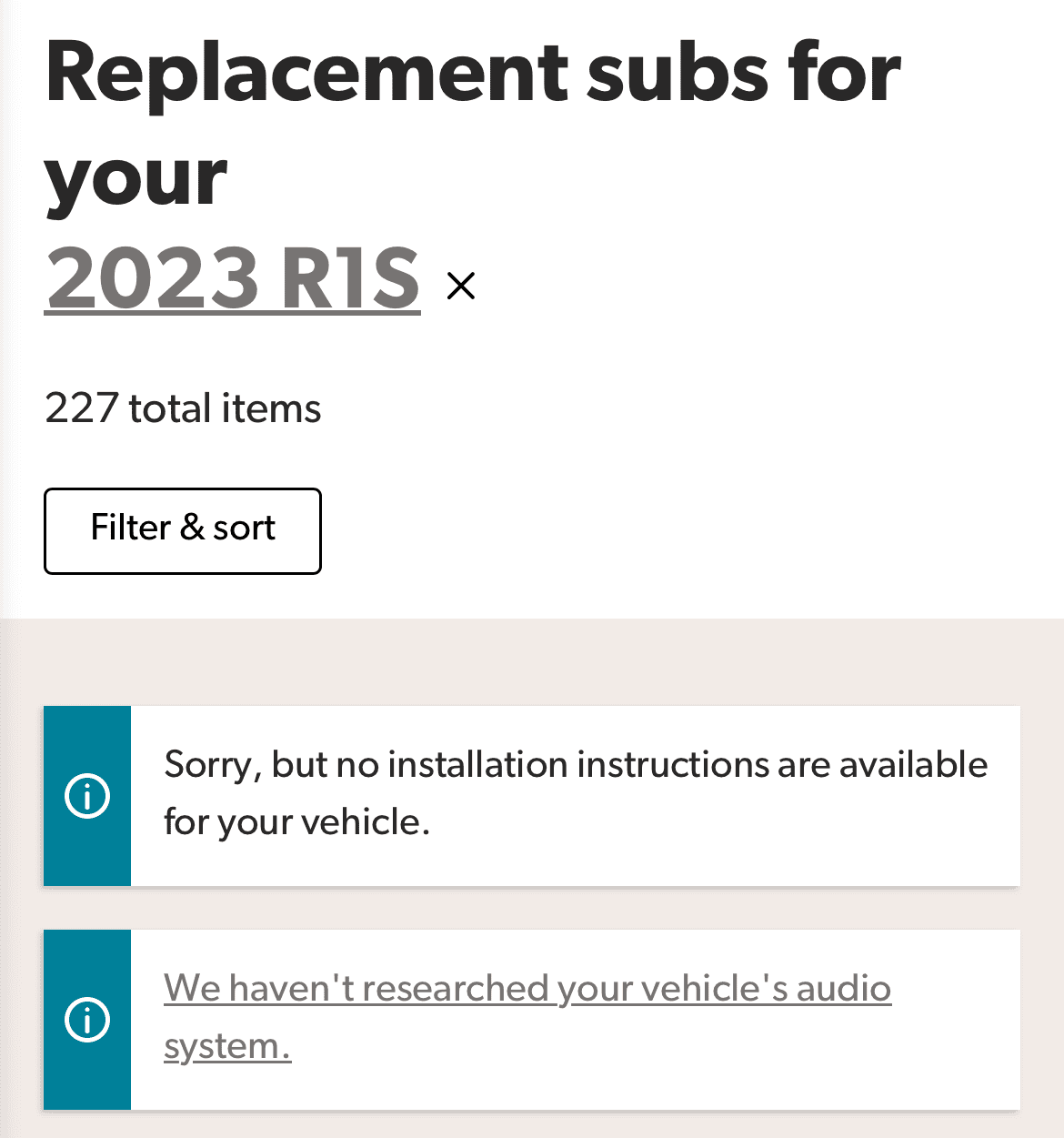

Way cool! I see that Crutchfield has R1T ( Rivian R1T Audio – Radio, Speaker, Subwoofer, Stereo (crutchfield.com) ) and R1S specific links. I've gotten lots of home stereo equipment from them and have always found them to be very good on pre and post-sale support. Wondering what your experience was. Did you use/find useful their vehicle specific installation instructions?

I did not use any of their instructions. Everything I needed was in this forum. Really just need to know where one wire in the back is.

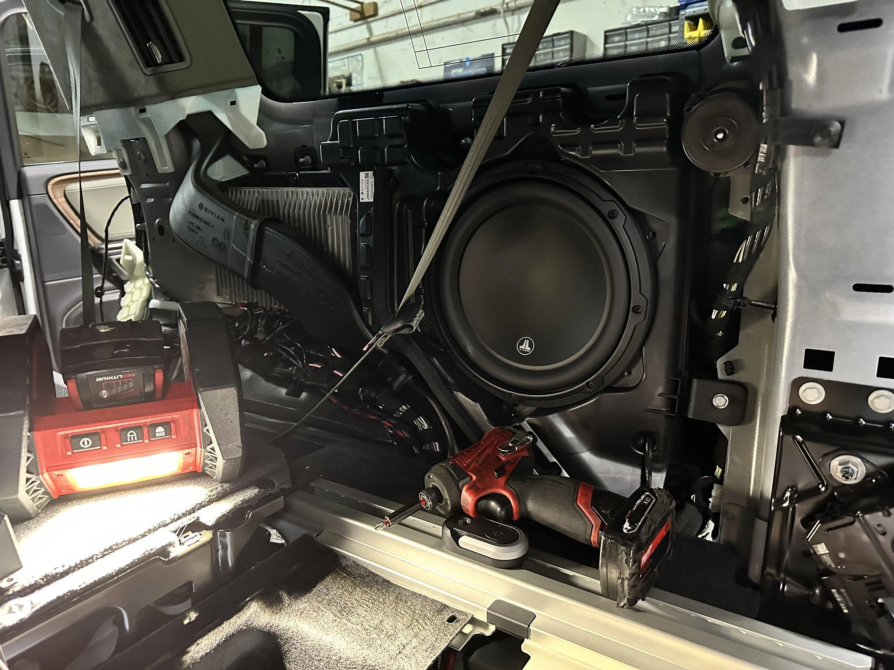

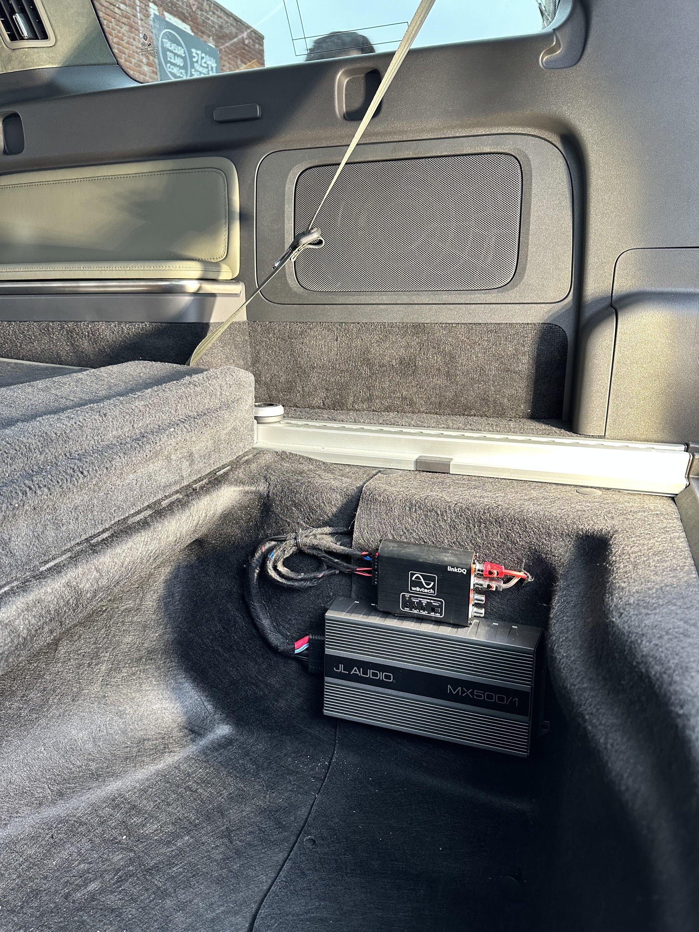

Note: It’s installed by a professional shop and directly connected to the 12v in the frunk!
Components: JL10w3V3/2, LinkDQ and JL500mx/1
Outcome: Its amazing and day and night difference between this and the stock
Rattling: Yes, the stock enclosure is made of plastic and it cannot withstand too much of bass. How much? It’s way beyond my usual levels so not that concerned. Sound deadening is all over the box and on the body of the car, but it’s the box that’s weak.
What I would do differently if I do it again?: It would cost a bit more to build a custom box that can sit on top of spare tire, replacing the tray. There is enough room to add 2 subs if you would like to. Additionally you can also add a separate battery to handle the setup without impacting the existing 12v, which could be charged from the same source as current 12v

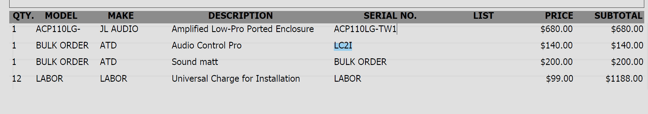

While we're on the topic of stereo upgrades, he's what a good local shop proposed. We're looking at putting it in the spare tire well. I know very little about custom stereos. Any feedback? Look good? The plan was to run the controller up near the dash.
