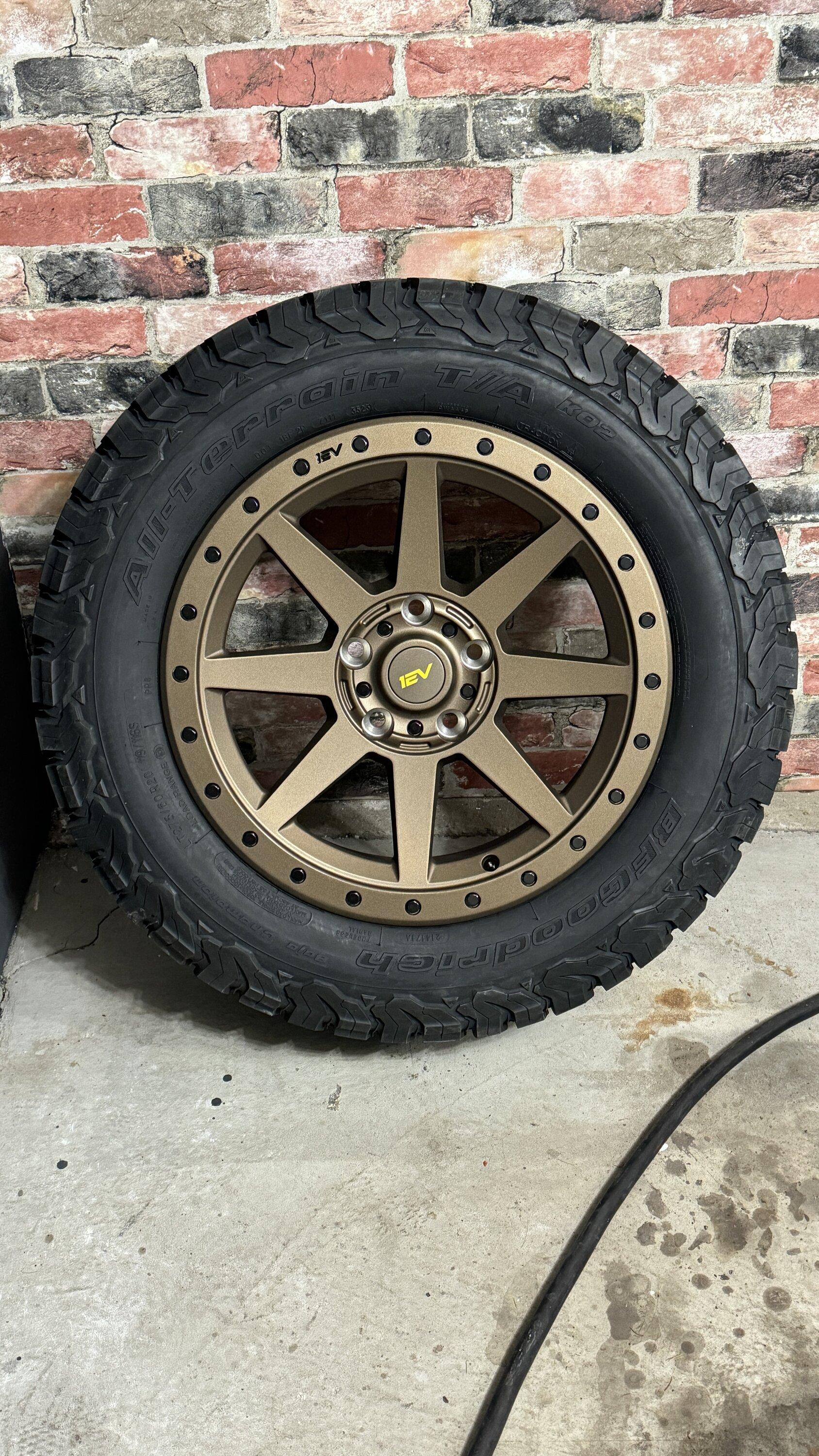

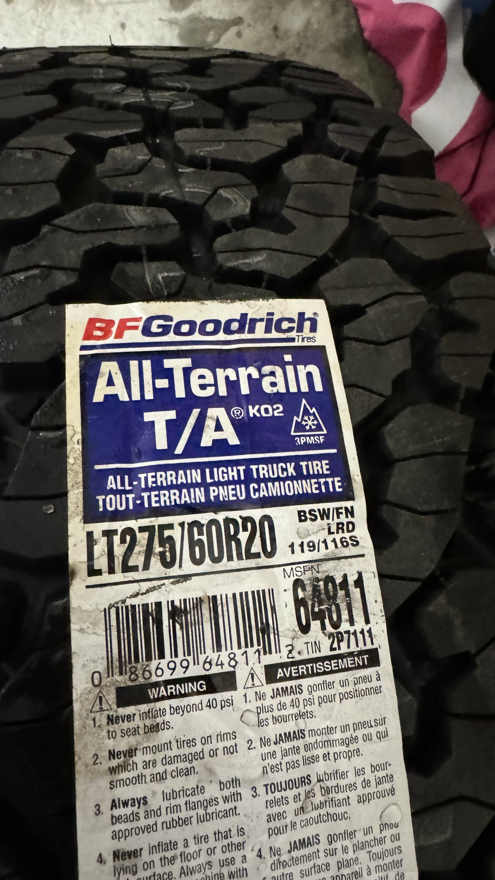

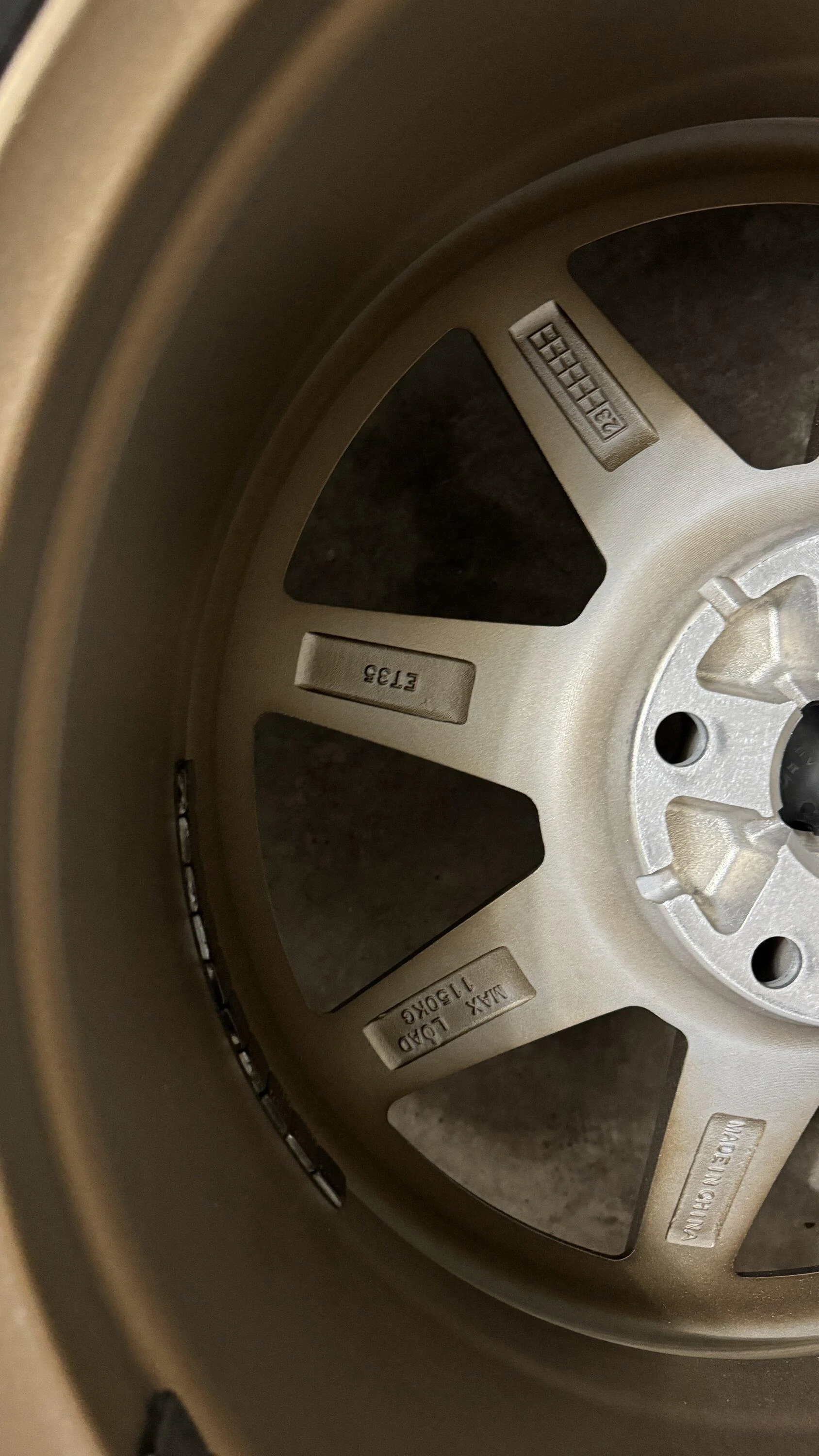

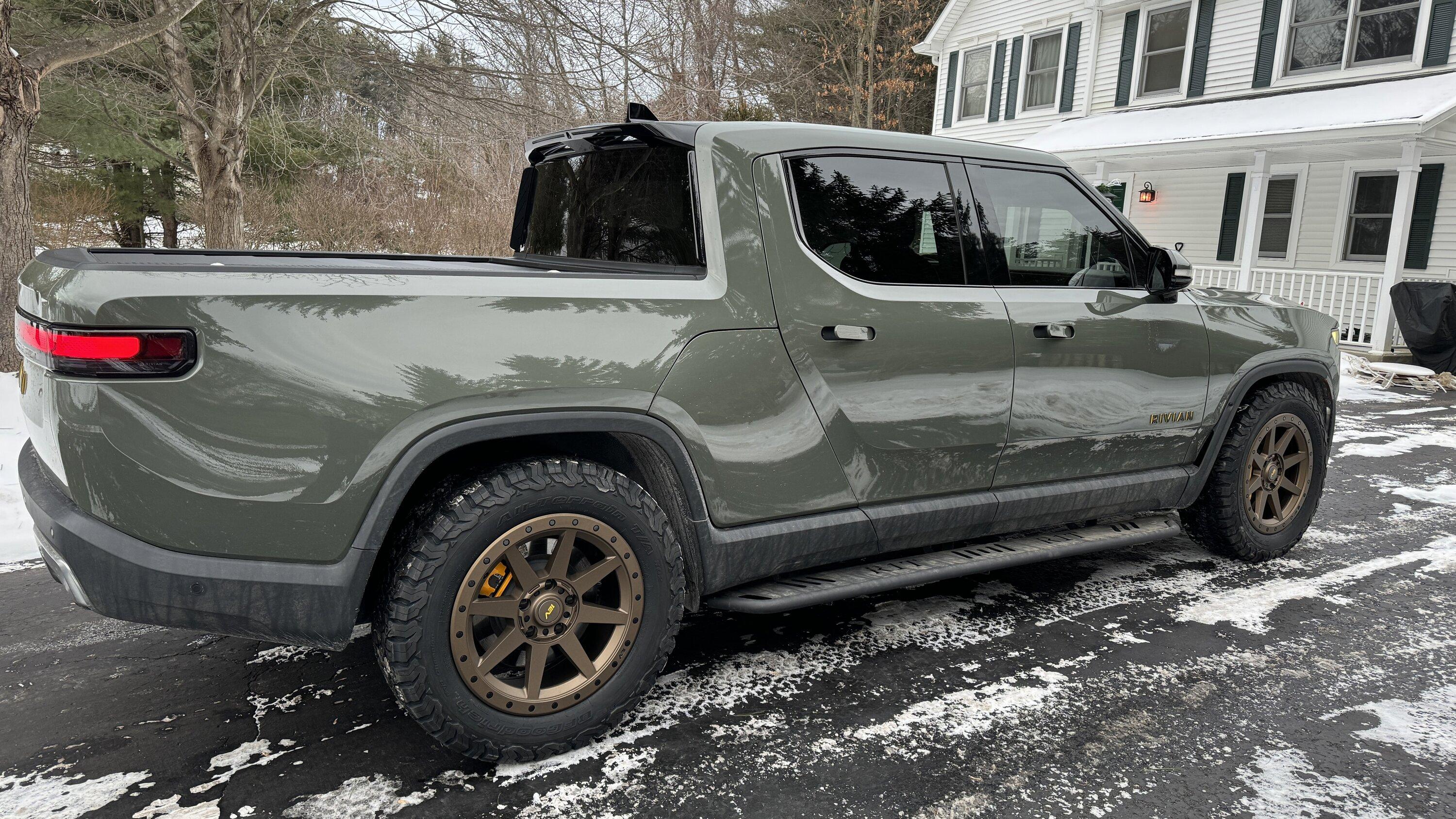

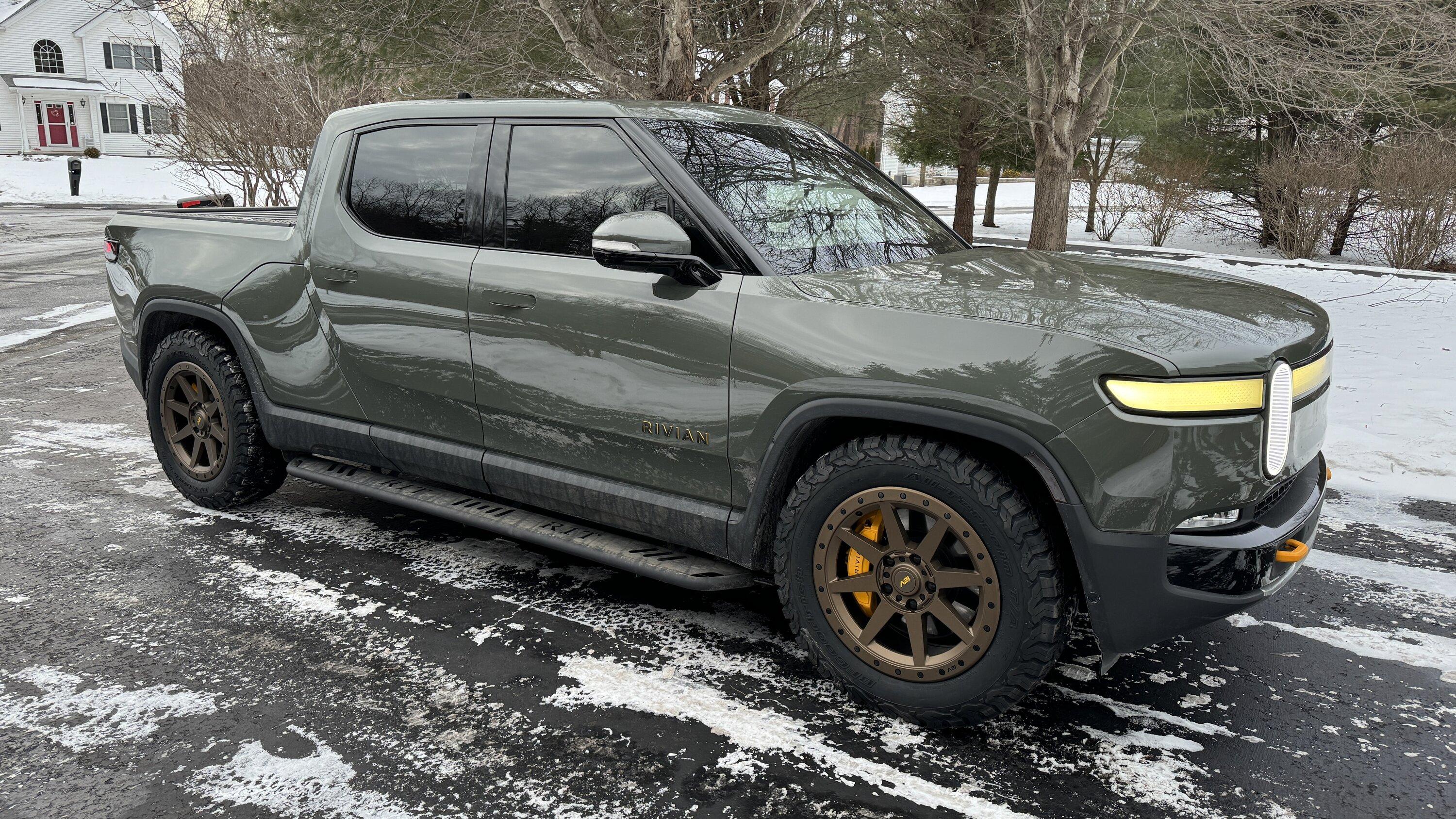

The title says it all! I pulled the plug and finally got me a set of 20" with A/T Tires. I walked in from the garage and I don't have many miles at all. They look completely amazing on my Launch green R1T. There are a few things I wanted to mention that may help some of you out in the future.

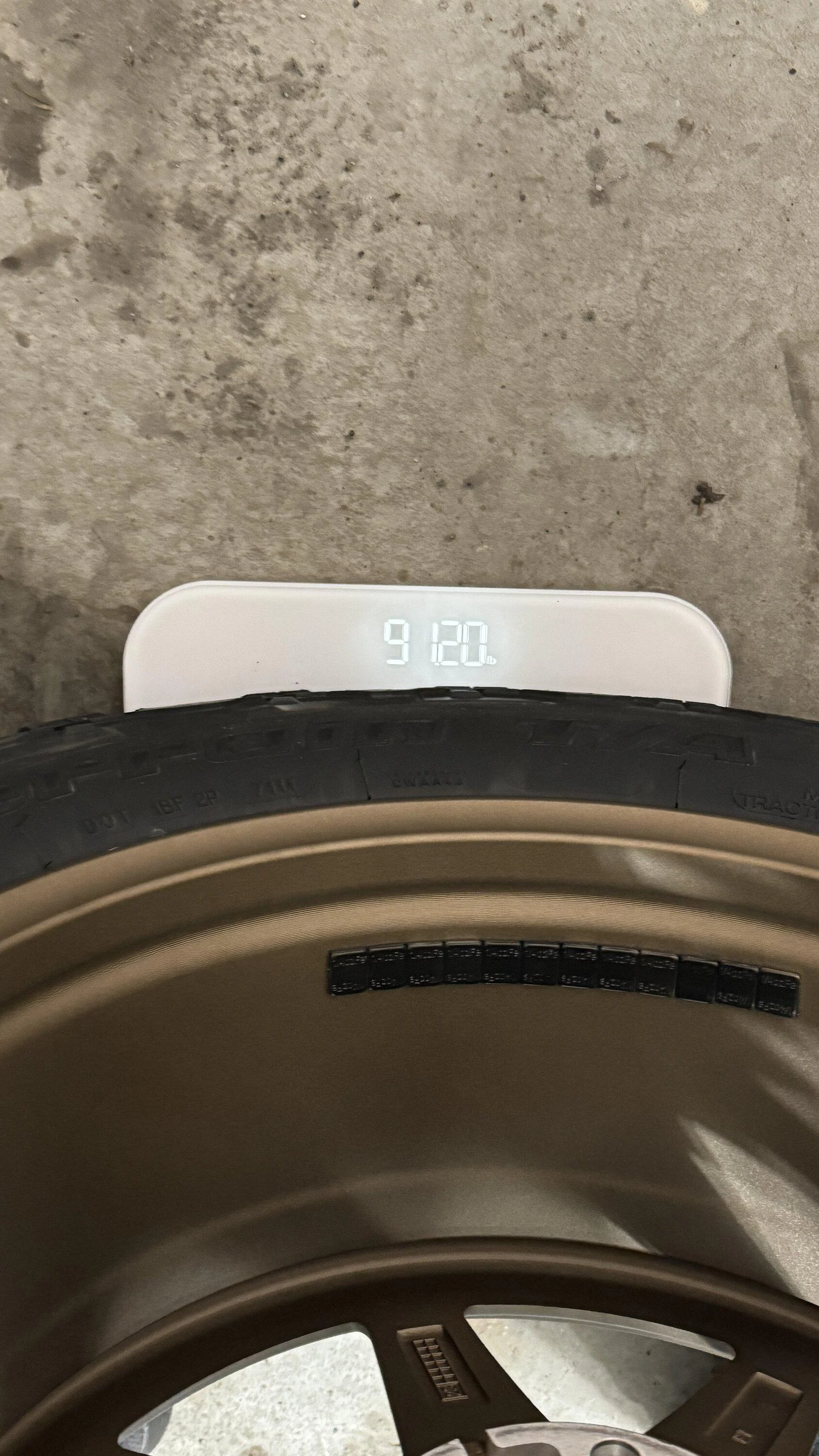

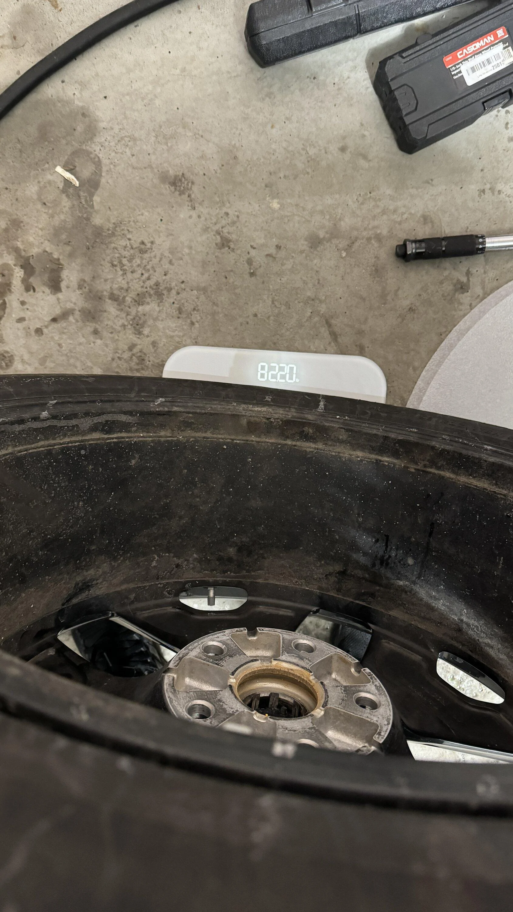

1) Stock 22" Dark with 50psi came in at about 82lbs give or take 1lb.
2) R800 20"with 275/60 KO2 came in at about 91lbs give or take 1lb.

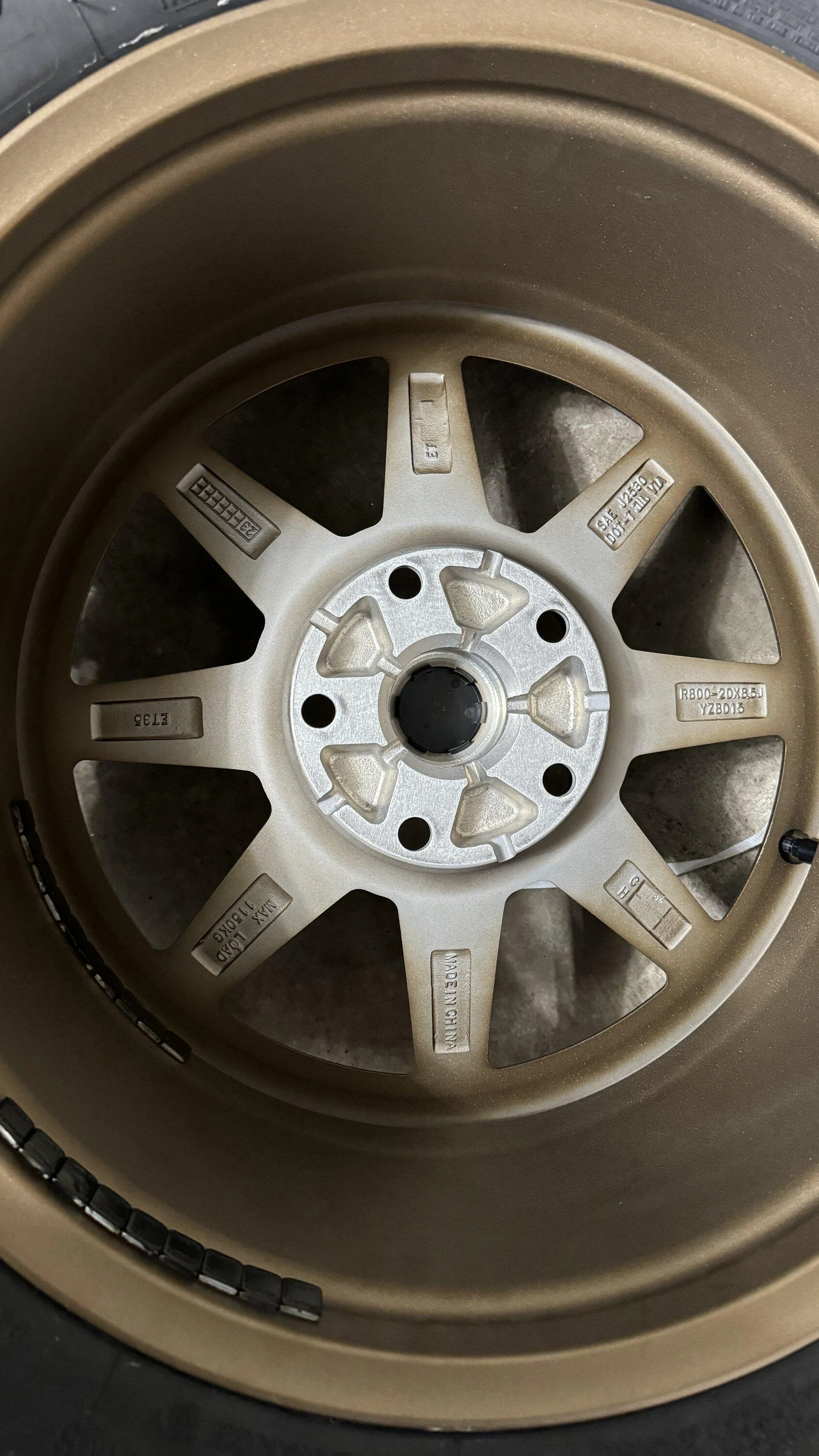

3) It appears if you order a Rim Tire package of the R800 in bronze, they will all be +35 Offset and, not the stock +48. I am happy as I wanted some of that wheel stick out the side ( more of an aggresive stance ). I did a full lock-out to both sides and experienced no rubbing issues on the standard AP setting. I will have to reach out to EV1 on the phone when I order a spare set to ensure they ship me a +35 and not a +48 offset R800 in Bronze.
4) I dove about 10 miles up to 55mph and the ride was smoother for sure but it was also louder than the stock 22" Pirellis (of course they are A/T Tires right ) I wouldn't say obnoxiously louder but you can 100% hear that its a tire noise and not wind at least up to 55mph. I will drive my normal comute tomorrow with up to 70mph and see how they do at that speed.
5) I decided on 52" PSI Cold tire pressure but may change it to 53" depending on how the chaulk test results come out.
6) @EV Sportline , Order on Tuesday night and had them delivered Monday morning (CA to NY). So thank you for the fast turn around!
Check out the photos :D

I completely understand. Honestly though the offset difference is so small i don’t think it’s even an inch. Can’t see that causing that much of a difference. Now the weight and rolling resistance is where I think I maybe screwed by. I barely drive far and charge at home so loosing some miles per charge won’t be to bad :)

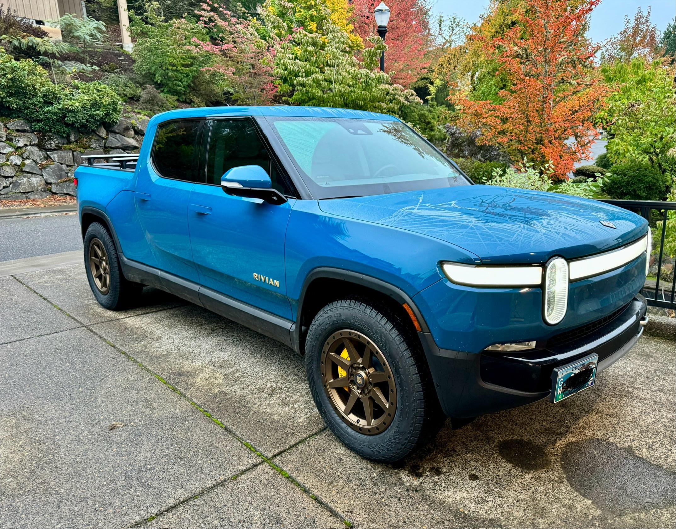

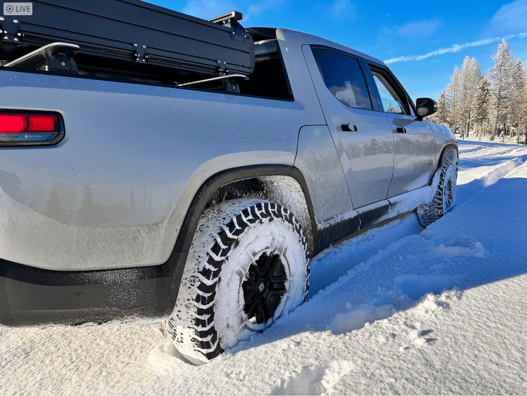

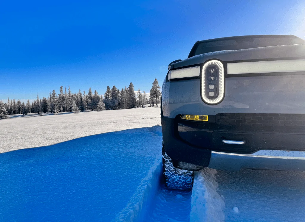

I went with the same wheels but with Nokian LT3s for winter. The offset piece is really interesting because I have feeling they stick out more than stock. This actually might be an advantage as I’m considering running chains. (See ice picture as to why I’m considering chains)
