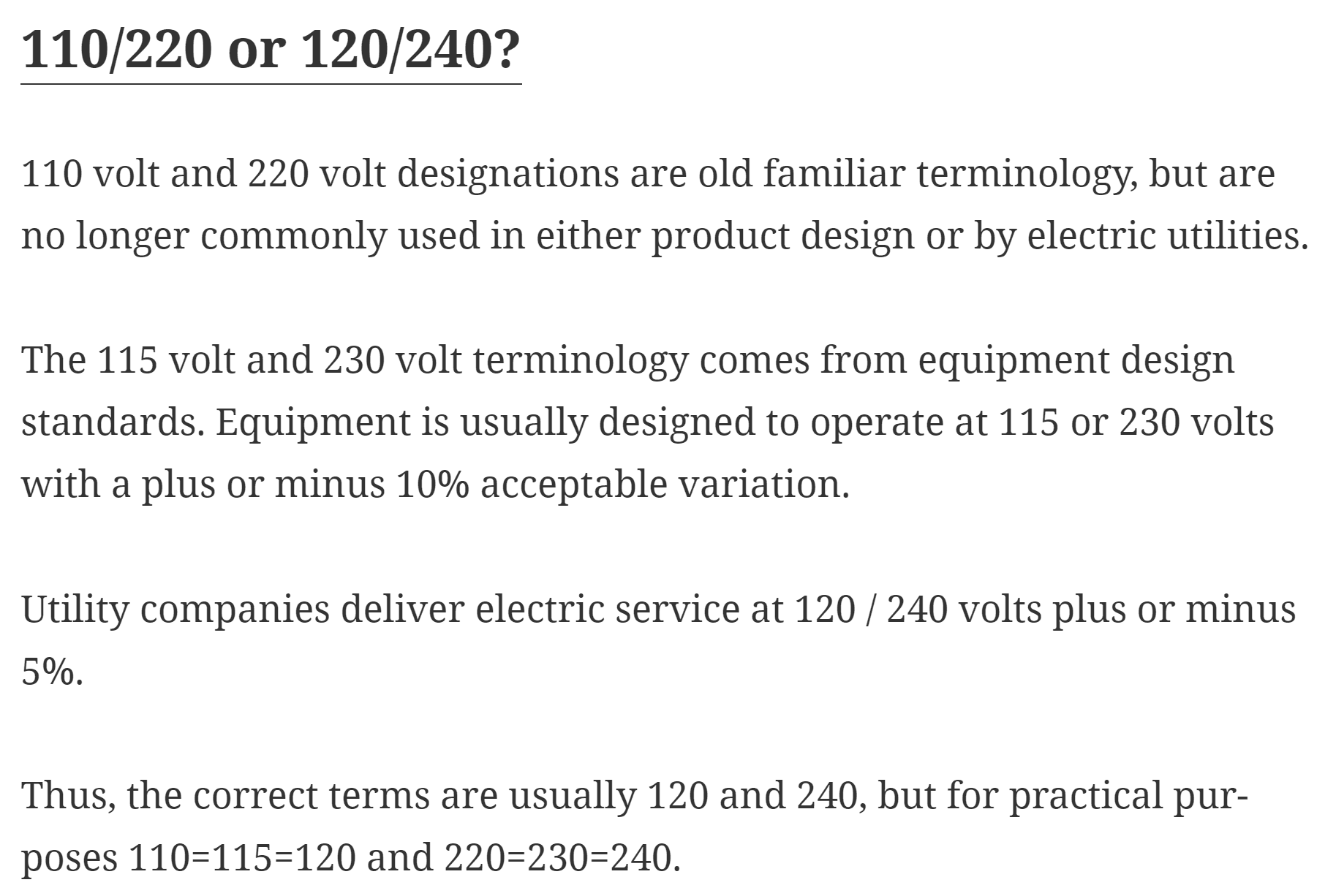

Hello folks - I am building a new home and I have requested a 60A/240V circuit for my R1S. My builder keeps telling specifying a 60A/220V circuit. From an electrical perspective, I often see 220/240V called out. Should I insist on 240V or is it a distinction without a difference?

They are exactly the same. Don't worry about it!

They are wired exactly the same, the voltage difference depends on your power company and the requirements in your area.
For a real deep dive into why this is the case, I recommend this video by Technology Connections, but in case you don’t have 25 minutes, here’s a TL;DW.
The reasons for this difference in specification is 2-fold. The video I linked to discusses this reason starting around 17:56. First, some people just like referring to standard mains voltage in the USA as 110V. I’m not sure why. In reality, the voltage in your house can vary anywhere between 110V and 125V, and everything that plugs in will deal with it. This variability occurs as part of load management on the power grid, as frequency is the most important variable in the grid, and sometimes utility companies let the voltage sag or surge a bit to maintain the correct frequency. 220V is double 110V, so he says that. He’s not necessarily wrong, but it’s weird.
The second reason is because of split-phase power. The video discusses this at 18:45. In apartment buildings and most commercial buildings, the power supply is 3-phase 240V power. The lower voltage 120V circuits are just one phase of the 3-phase power, with a ground wire, providing 120V. If you take 2 phases of this power, you get 2 120V phases that are only 120º out of phase with each other, instead of the 180º you’d get from a residential split-phase transformer. Because of this, high-voltage circuits in commercial and apartment buildings run at ~208V instead of the higher 240V. That’s why anything with a high-voltage plug in the USA is rated for 208/240V, and can really handle anything between about 205V and 250V.
As long as you have the higher-gauge wire and 2 phases available in your garage, you will likely have 240V available for charging, since you probably have split-phase residential power.
