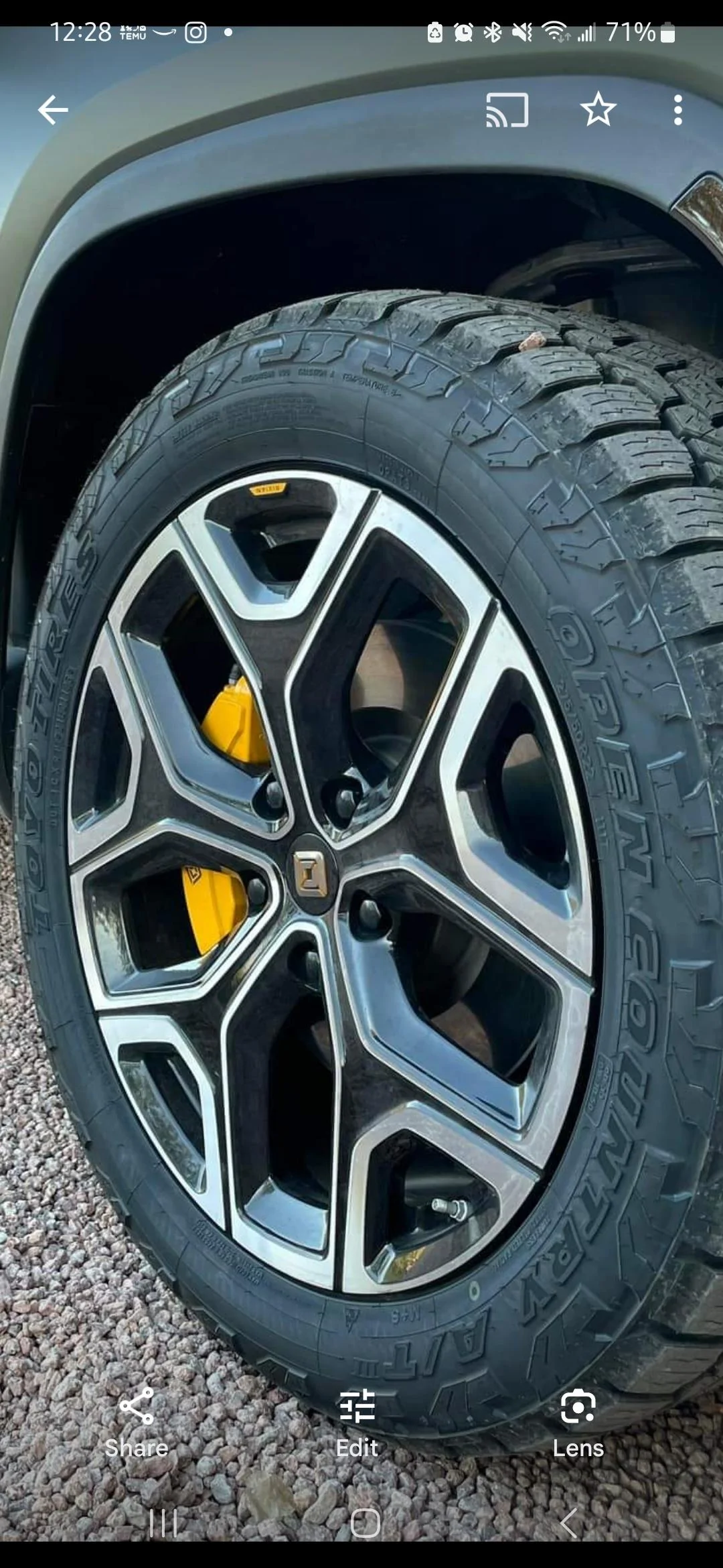

I've seen an older post someone put on Toyo Open Country A/T iii's on 22" R1 Sport Brights.
Rivian R1T R1S 22" Michelin Tires @ Costco for under $2K installed (compatible with Rivian 22" factory wheels) Screenshot_20230918_122803_Photos

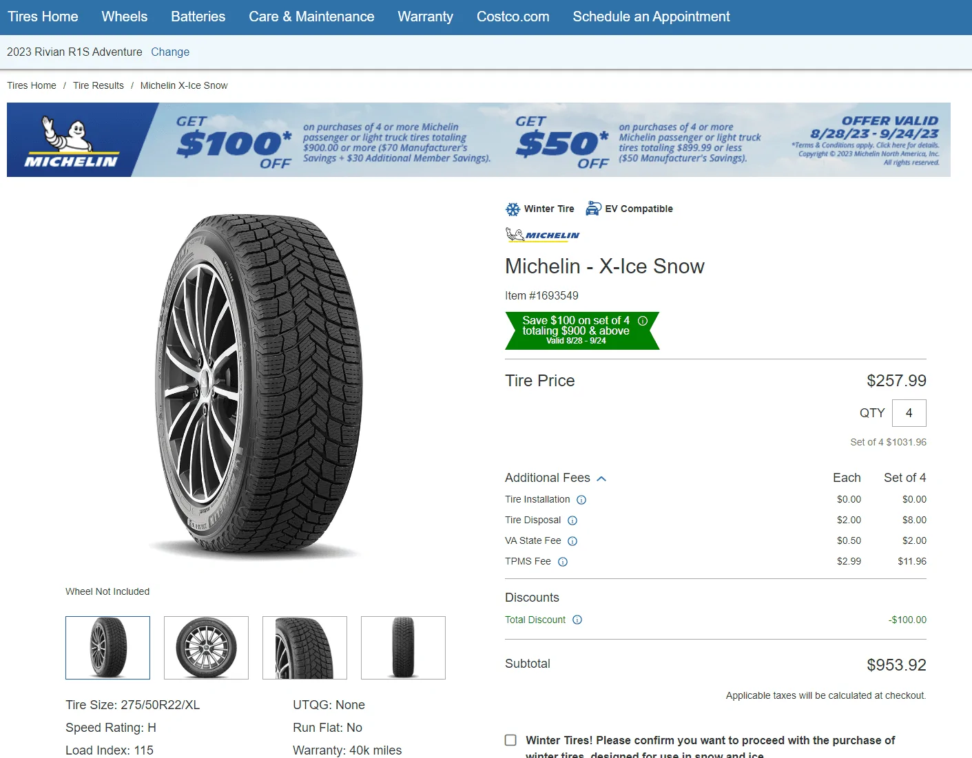

I've used Michelins in the last 30 years, and they have been great! Yes, Costco has a Michelin replacement but it's the Michelins with only 40K mile warranty. For under $1K, it's not bad at all. One can use the Costco Tire Selector to find out if what's available in their area. https://tires.costco.com/
I have attached what's avaialble in my area.
Rivian R1T R1S 22" Michelin Tires @ Costco for under $2K installed (compatible with Rivian 22" factory wheels) CostcoTireInfo
Those are snow tires.
