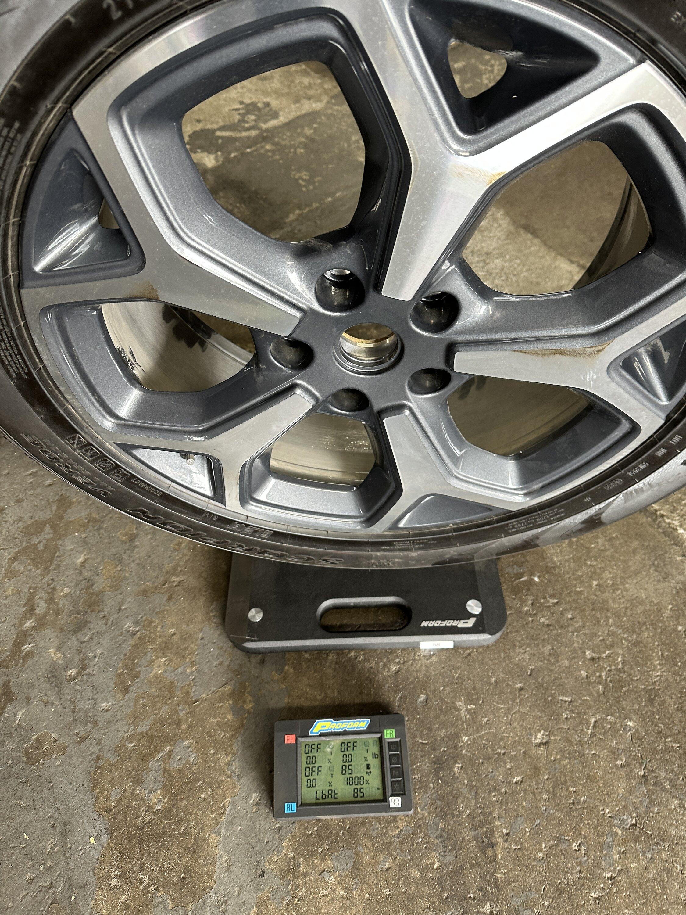

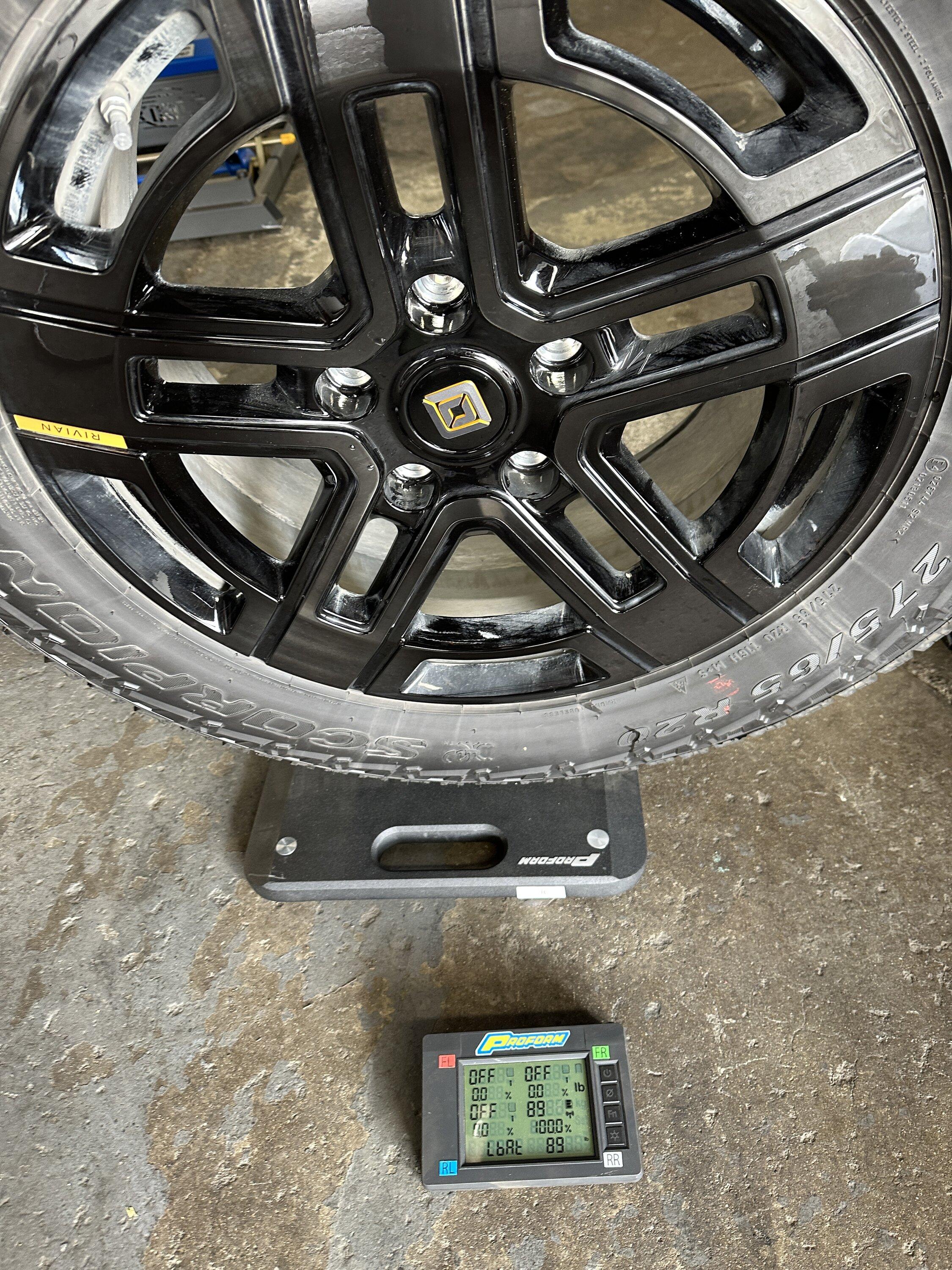

Not sure if you ever got the info you need, but I weighed the 20's and 21's today. Both have about 1000 miles on them. I got slightly different numbers than what I've seen posted here, but only by a pound. Probably the delta between the two is what is more interesting. Anyway, here's my findings.
85 pounds for the 21"
89 pounds for the 20"

85 pounds for 21 wheel/tire combo? Sounds high. Rivian gear claims 79 pounds for the 21s. Per Tirerack the 21" Pirellis weigh 37 pounds, that would imply that the stock 21" wheel weighs in at 42 pounds. Now I'm really considering getting the Atomic wheels, the aw01 weighs 27 pounds, and a 20" 275/60R20 tire with the proper load rating and tire pressure capability weighs 39 pounds. That would end up being 10 or more pounds lighter at each wheel.
