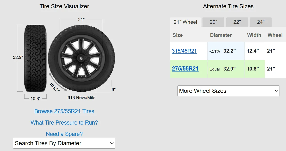

Go enter the size here to see.
https://tiresize.com/calculator/
You'll find that you'll rack up miles on the odometer and your speedo will be off by quite a bit.
You need to goto 305/50/21 to maintain the same OD and keep the speedo accurate.
No option there for 305/50/21 . Next closest is 315/45/21 , which come up 1 from Pirelli
Also for the wider tires like 305 or 315, you'll need a wider rims and not sure it will even fit within the fender well of Rivian.
This is exactly why many people have opted for 20" or 22" wheels.
Currently, if you get/have 21", you're pretty much stuck without options.

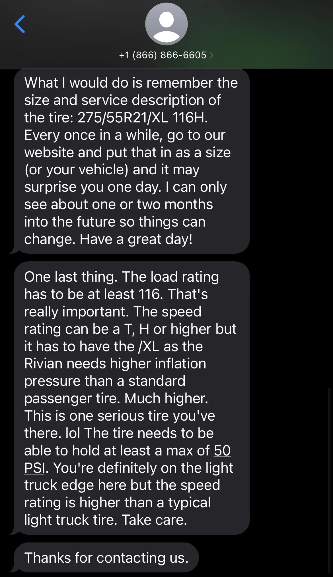

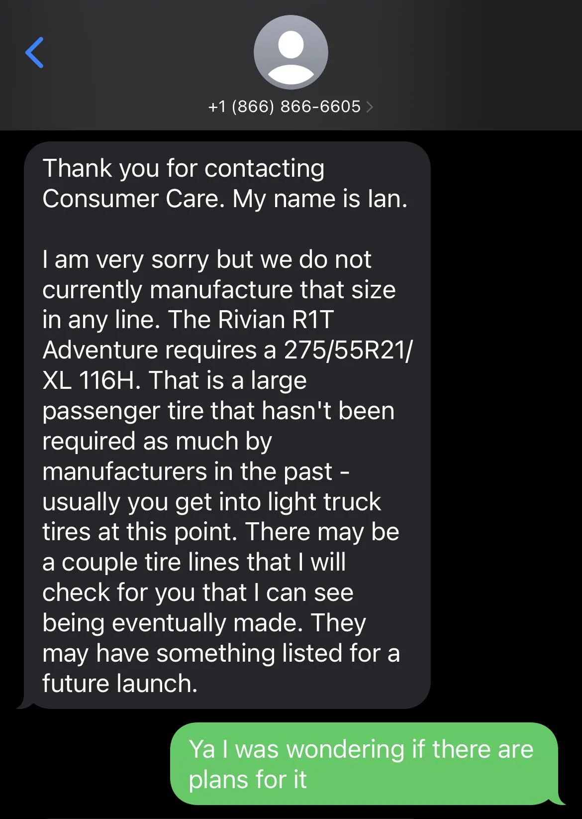

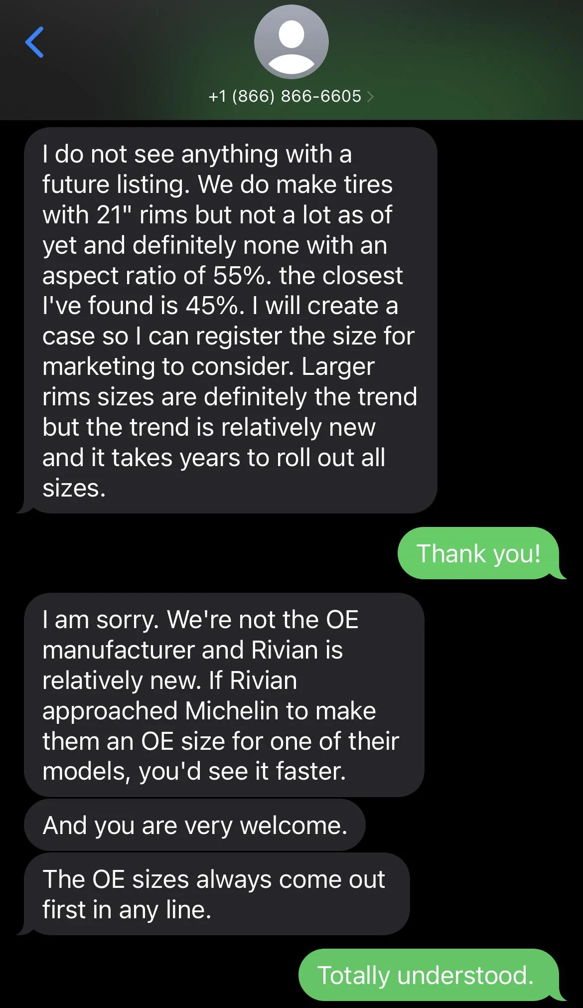

I texted with Michelin customer service today about a Rivian OE size tire. Not hopeful but really impressed with the quality of the customer service! Screenshots below.
Rivian R1T R1S 21" tires options IMG_7593
Rivian R1T R1S 21" tires options IMG_7594
Rivian R1T R1S 21" tires options IMG_7596
