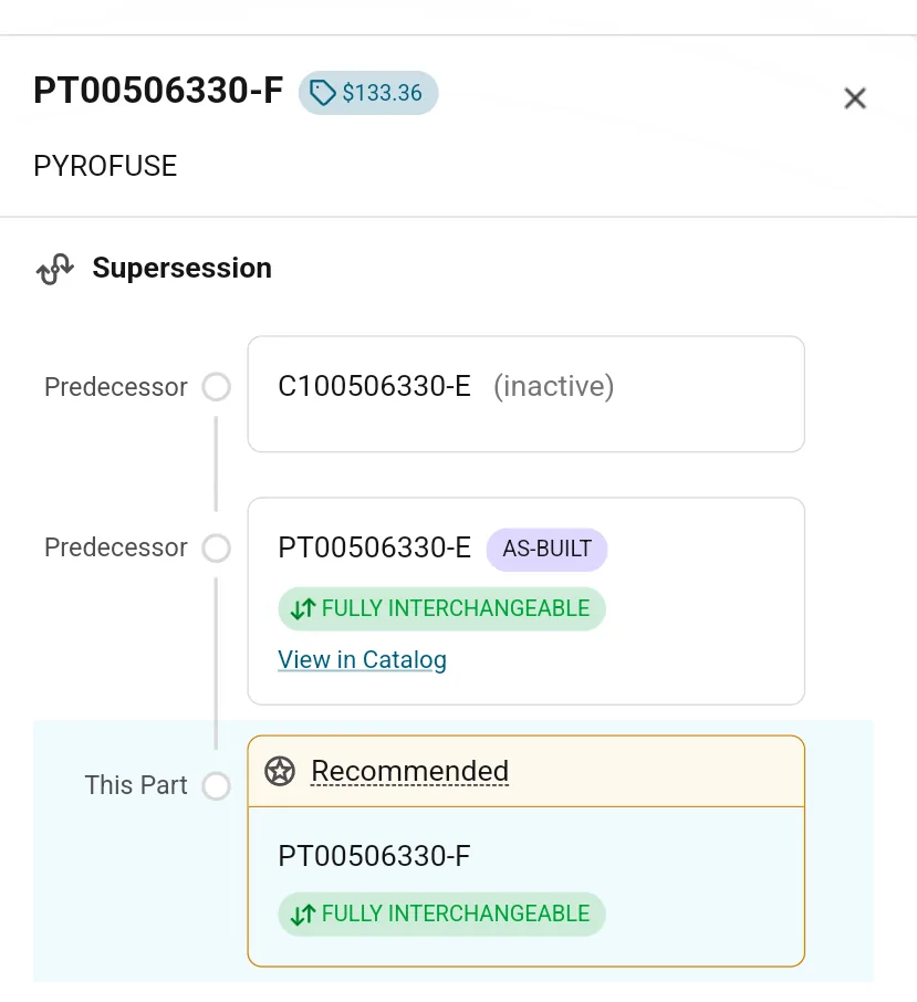

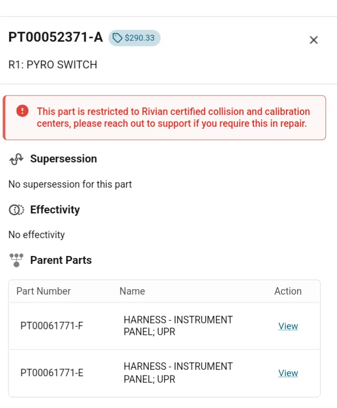

Ah ok I see. I appreciate you getting that info for me. Any idea where I am able to supply the pyro fuse or it is the same fuse for Gen1?
Mar 29, 2021
105
5,803
9,455
Kitsap, WA
It's definitely not the same, and they likely won't sell direct, big red letters on this one.
Gen1:
Rivian R1T R1S 2025 Rivian R1S Pyro Location 1000003693
Rivian R1T R1S 2025 Rivian R1S Pyro Location 1000003698
Gen2:
Rivian R1T R1S 2025 Rivian R1S Pyro Location 1000003700
Rivian R1T R1S 2025 Rivian R1S Pyro Location 1000003699
Throwdown
Mar 14, 2023
384
426
R1t launch edition#2650
Technician
Gen1:
Gen2:
That's wild that they restrict the sale of that. A 90 year old grandma can walk in buy one from our parts department on the cars I deal with.
