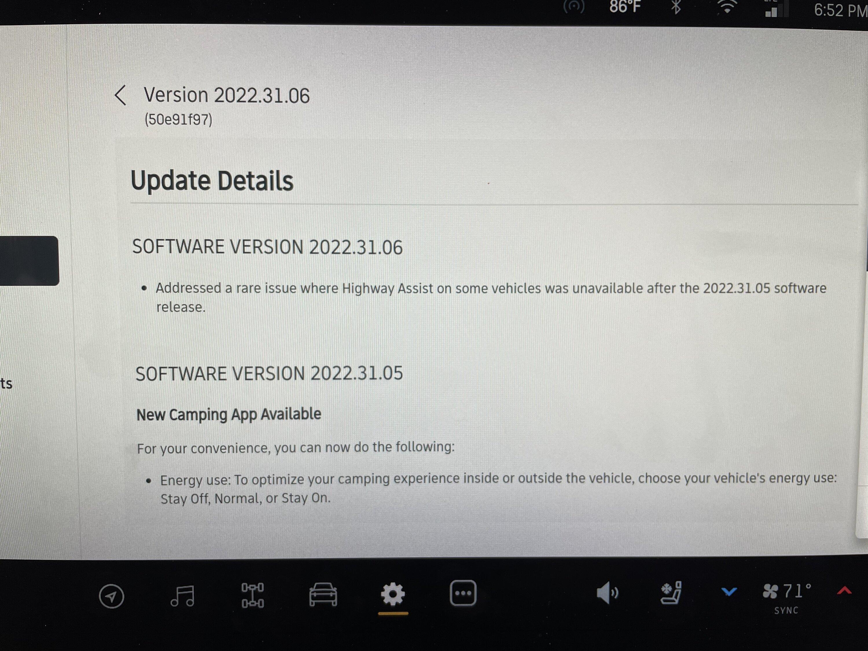

Huh, this almost feels like a personalized OTA:
Rivian R1T R1S 2022.31.06 Software Version 6752D7F6-E8B9-41A4-914F-F164CC43F4BA
Scotsol
Oct 25, 2019
New Jersey
R1T, BMW M3
I just received this update as well. I had lost my Driver+.

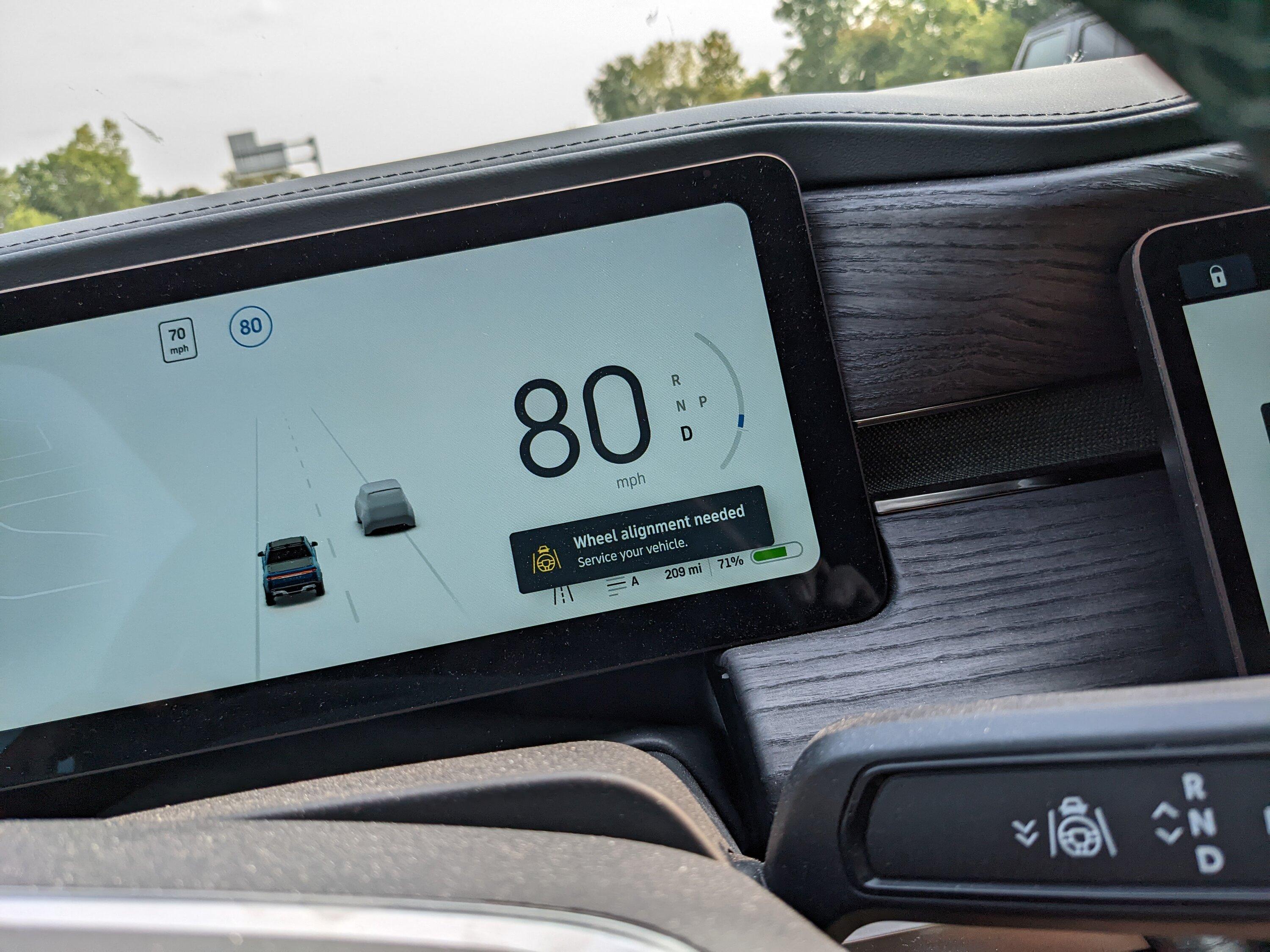

Lost mine too. It would strangely say “Wheel alignment needed. Service you vehicle. “ (this was literally 2 days after a wheel alignment was done. )
What errors were you getting?
Luckily my wheel alignment is actually terrible.

Well I’ll be damned! It fixed my Driver+ problem!
The first time I tried to engage it I got the same “Wheel alignment needed” message. But the 2nd or third attempt to engage Drive+ highway assist and did so for the rest of the test run.
I think it got nervous when I got my phone out to take a picture of the warning and decided it best shape up else get towed another 12hr round trip!

...using .05 and used Highway Assist this morning!
I wonder what the common denominator is for the Driver+ issue with some running .05.
