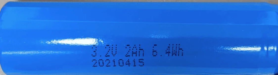

anyone tried opening the flashlight to look at the cell?

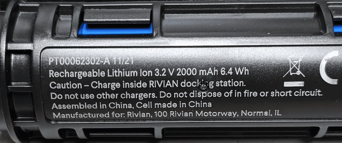

I know there was a lot of assumptions about it being the same cell, but it's an 18650, not a 2170.

I know there was a lot of assumptions about it being the same cell, but it's an 18650, not a 21750.
Interesting I wonder why they could have easily gotten that into the light then it would have been the same cell and probably cheaper for them with their bulk buying of the other cells right?
I'm not sure, but if the 3.2v on the cell is correct, that means it's likely an LFP battery. I didn't actually measure the battery and I don't have other 18650s here unwrapped so it's possible I just misremembered the size of them. If I have time tonight I'll do the same thing with a loose 18650 for comparison, but I'm pretty sure this is too small to be a 2170
I think you are right because I would assume a 2170 AH would be higher.

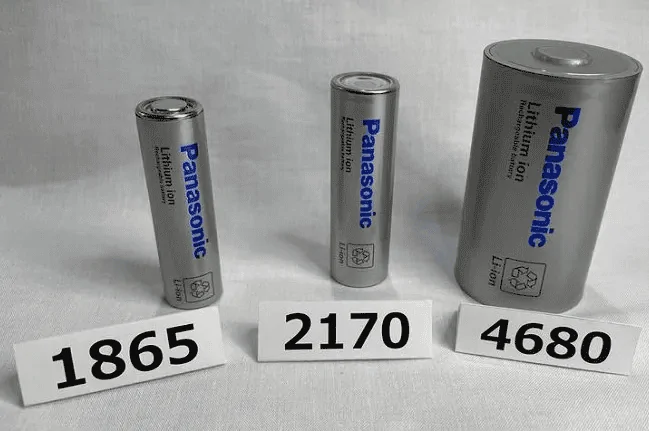

The size difference between the two cell formats isn't huge, so it'd probably be easy enough to mistake one for the other if you aren't looking at them at the same time. Here are som Panasonic cells side-by-side.
Rivian R1T R1S 1st batch of R1Ts delivered use what battery? 1652984329846
And yeah, 3.2V is too low for the high-nickel Samsung SDI cells that we believe are in the vehicle's packs. Those should be 3.6-3.7V.
The Flashlight battery is not the same battery as in the R1T’s pack. This has been misstated over and over. I’m fairly certain it’s a 18650 in the Flashlight, 2170’s in the pack.
At ~ 17:30 RJ states they are not the same battery as the one in the Flashlight is slimmer.

For reference, the 2170 cell in my Fenix flashlight is 3.6V and 5000 mAh.
