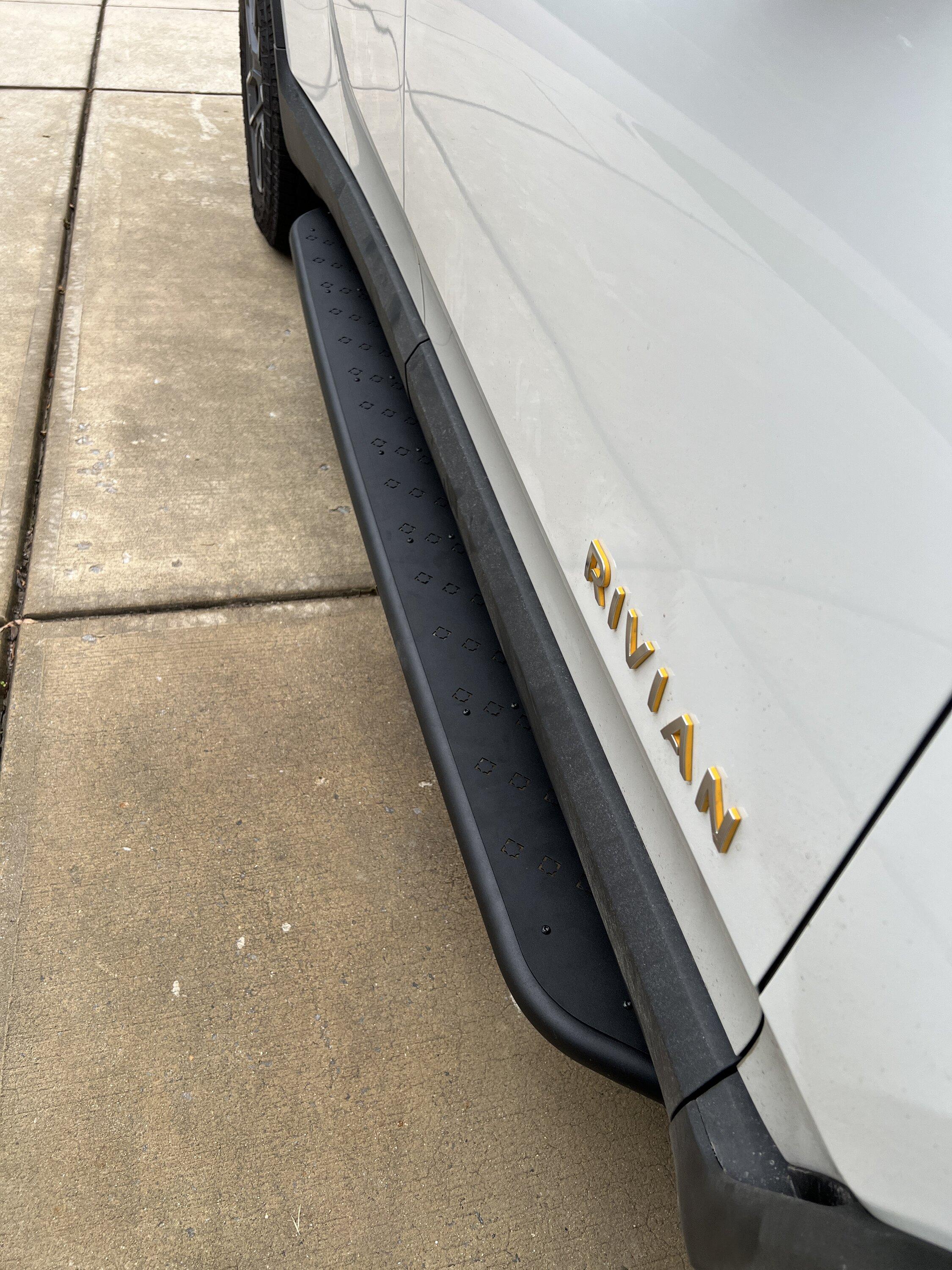

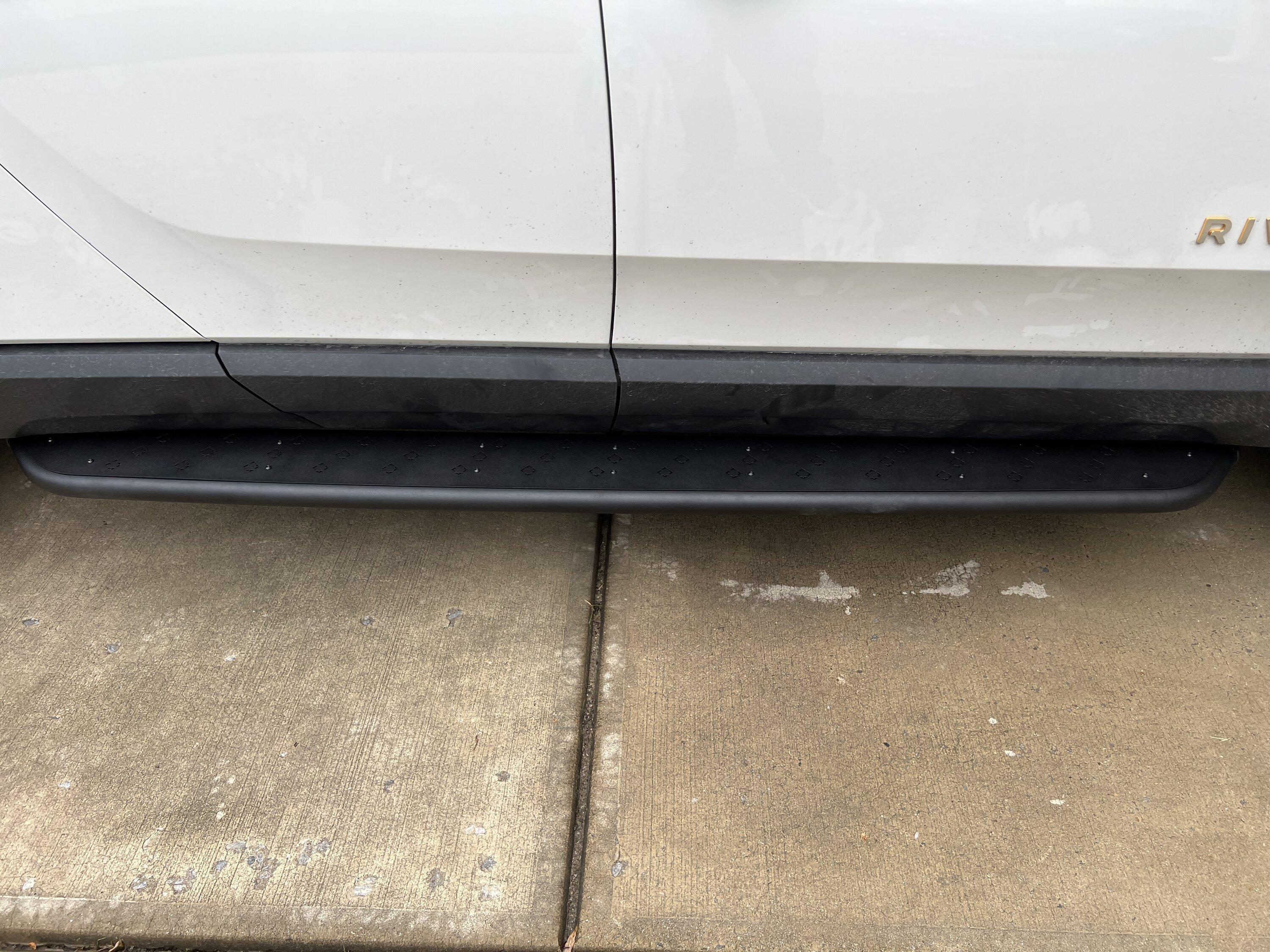

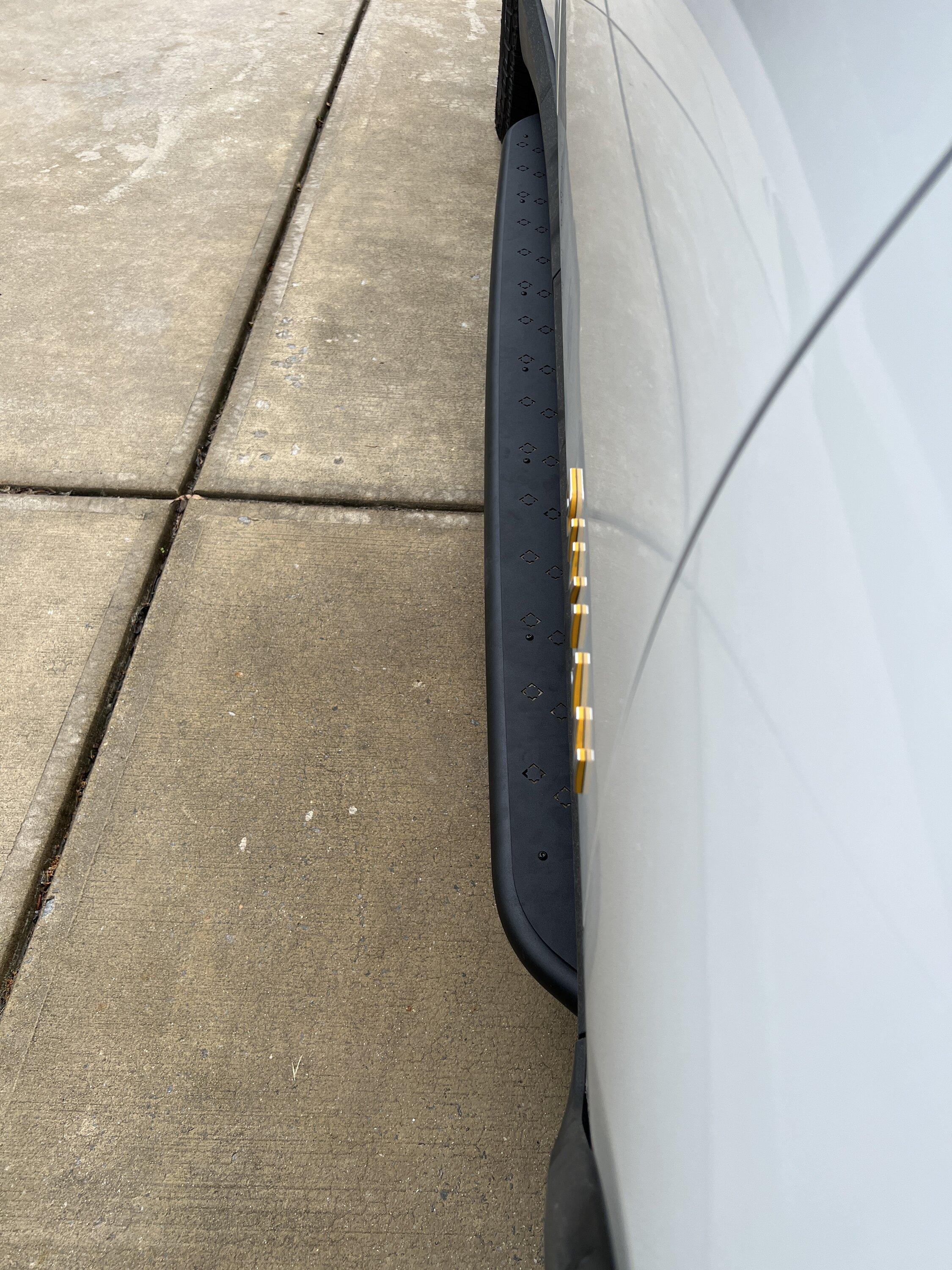

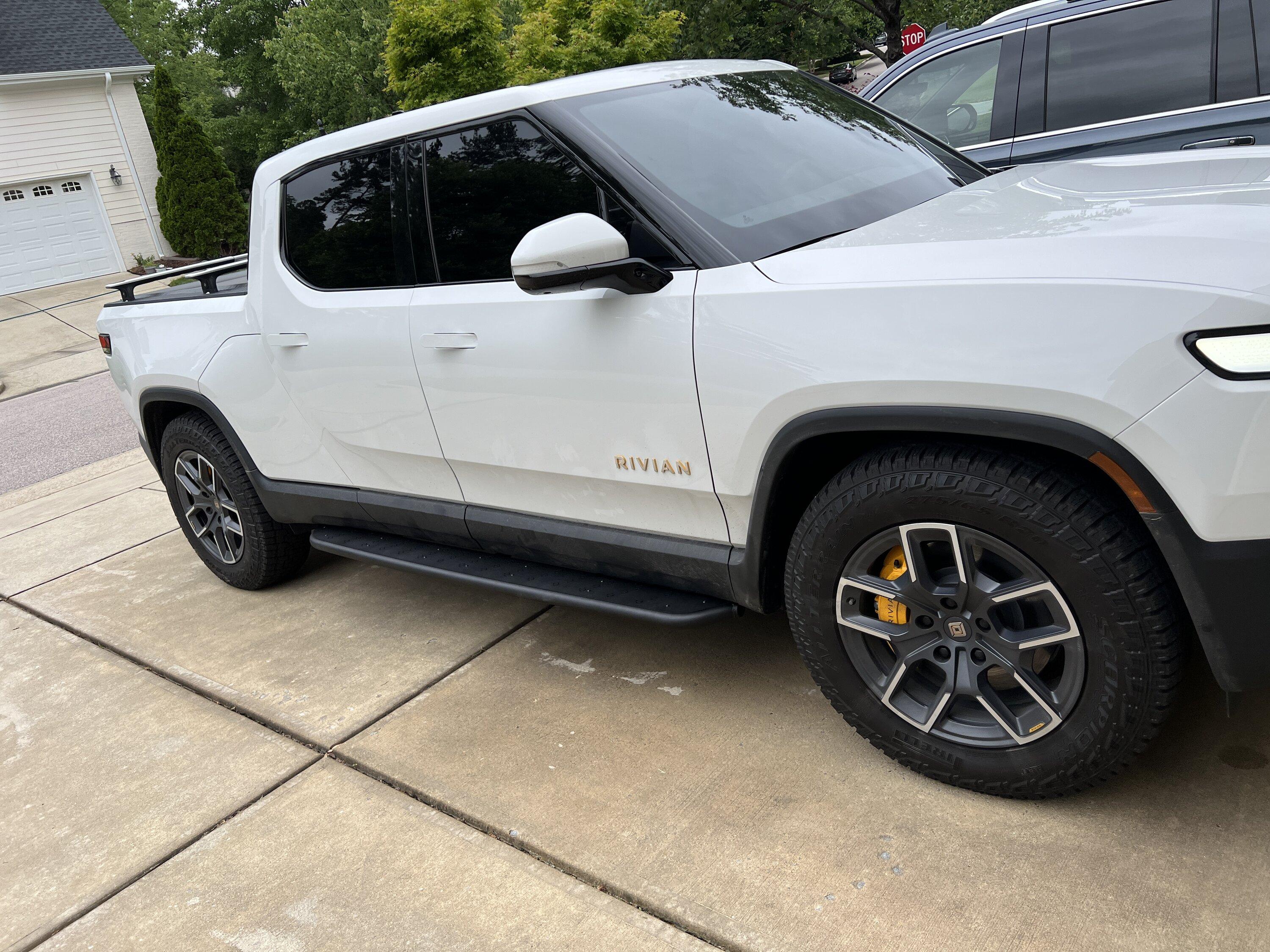

Wanted to show the running boards installed.
I decided to go with the 4” hole option and am waiting for some 4” rubber grommets to fill the holes with (after some slight modifications).
- the printed templates were spot on from 1EV.
- I got the 4” hole saw from them. The pilot drill bit broke after hole 5…so I had to do an audible to get them finished. Might be best to order that elsewhere as the bit was super flimsy…if you get one from a hardware store, pickup 2 just in case and return 1 if you don’t need it
I’m thinking about offering install in Raleigh for anyone that wants to order these in our area or if they want to bring here.
once I get grommets installed I’ll add pictures of the bottom.

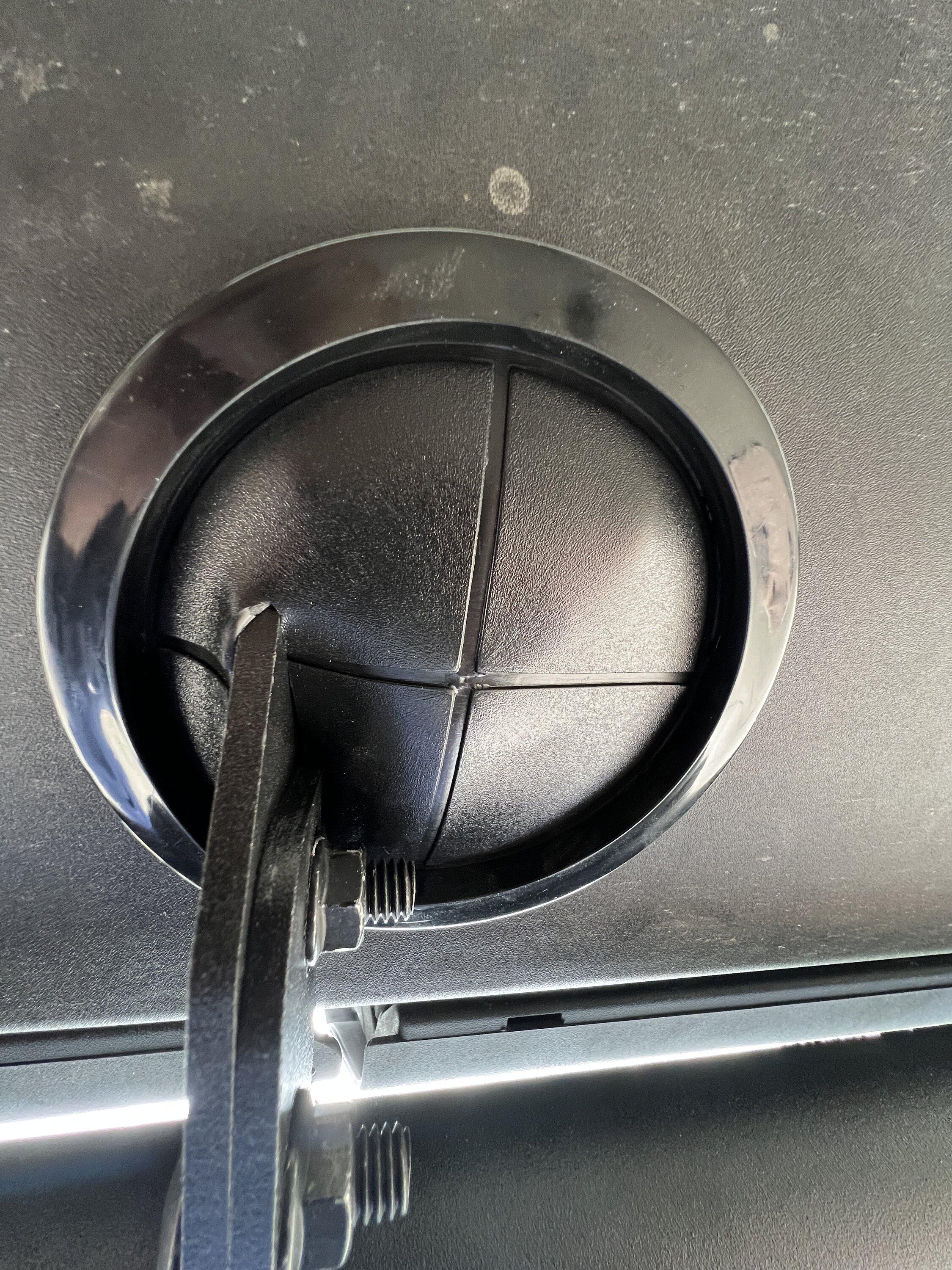

Grommets working perfectly!!
The middle has enough play to allow a slight bump from the bottom of the bracket.

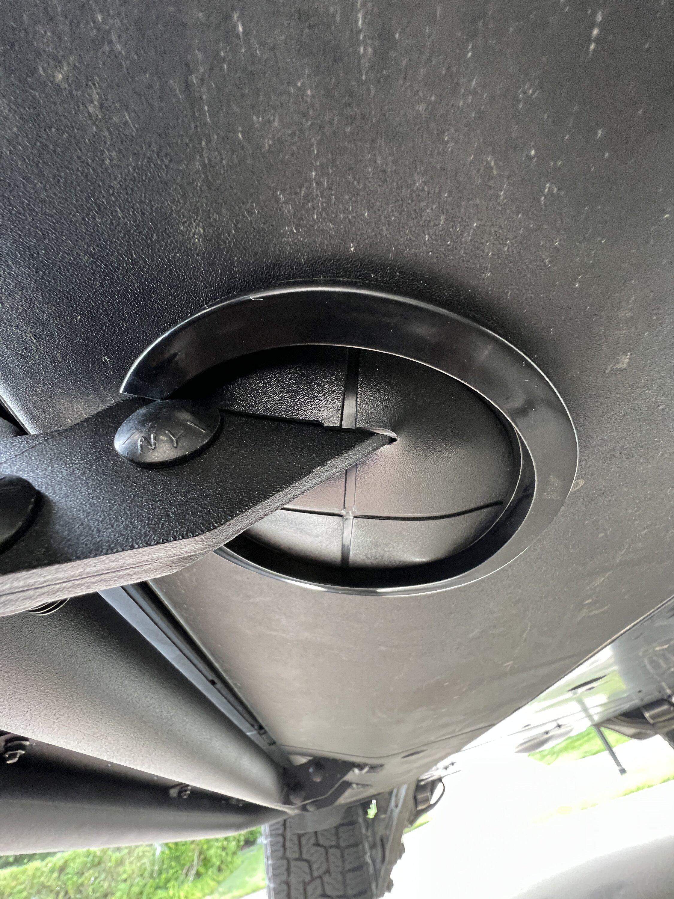

I used a small pair of tin snipes….marked where the edge had to be cut to allow for the bracket then slowly cut a slit until I was happy with the way it looked.
each one is custom cut. There is no make one, then cut them all as your holes may be slightly off center of the bracket.
Small flat head screwdriver to peel back, then push the inside lip behind the plastic.
I can take some pics tomorrow..I only had time for 1 side today…so as I do the others I can send a few more pictures.

I was really happy that the grommets I got are flexible in the middle, and not precut. Other than the cut I made, they are solid to keep debris out.
