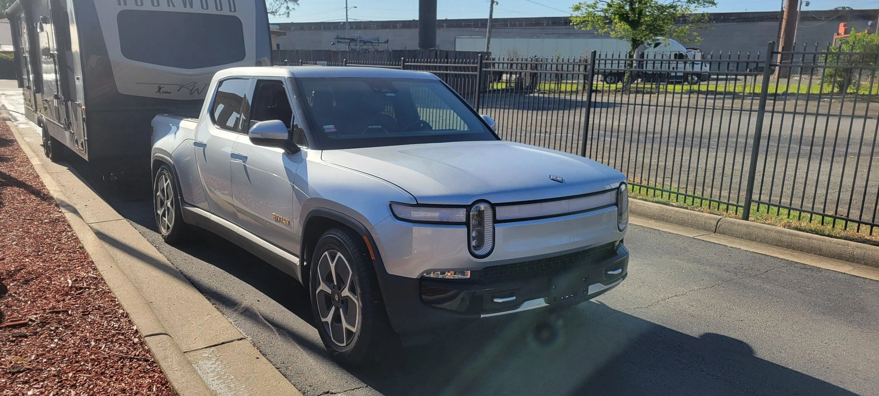

Hi I am new here. We have are on a road trip in our new R1t, towing 7500 lbs, getting 106 mi on 100% to 0%, air conditioning seems to be a factor... obviously I guess . The truck is amazing to drive ! Even at 50 mph, conserving t h e juice e. L after guys

106 on a full charge would imply you're getting 0.78-0.82mi/kWh, is that right? That seems really low if you're only going 50mph. How's the wind?

7,000 lbs, despite the truck being rated for higher, is pushing it. 100 miles in range sounds about right. Much of that is aero disadvantage. Also, looks like the tongue weight might be a little on the high side as the rear appears to be sagging?? If that's the case, hurting your aero even more with lowering the rear of the truck, thus the air heads downward then smacks the face of the trailer. If you can keep the rear of the truck up higher, should see some improvement in aero.

Truck should auto level. Maybe they hadn’t driven yet after hooking up (pic)

100% on the Aero. I get ~1.0-1.3mi/kWh on mine towing (~6500lbs) at 60-70mph. I'm more surprised at the .8mi/kWh at 50mph. I would have expected around 1.0 at 50 with that trailer.
