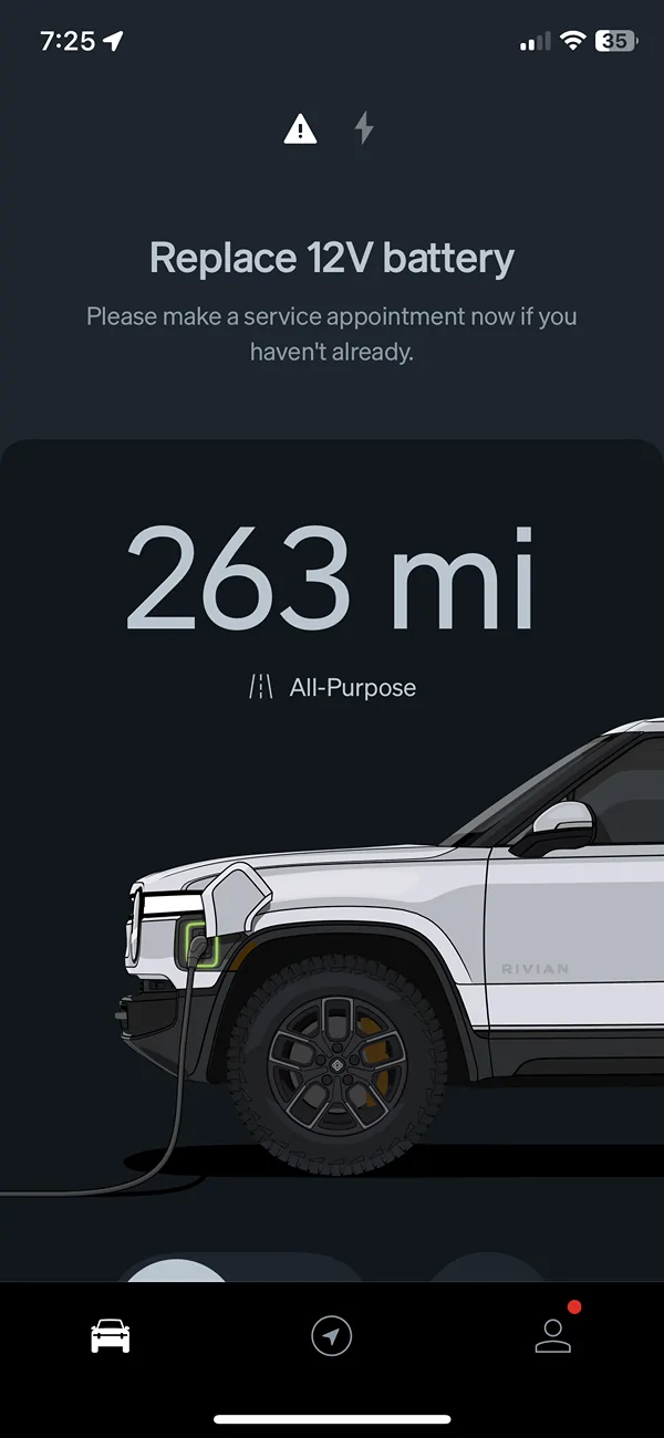

I just got the notice on my app that the 12 Volt battery needs to be replaced. I’m not really sure what that controls. Not wanting to be stuck somewhere, what are the issues if it can’t be replaced in a timely manner by Rivian.
